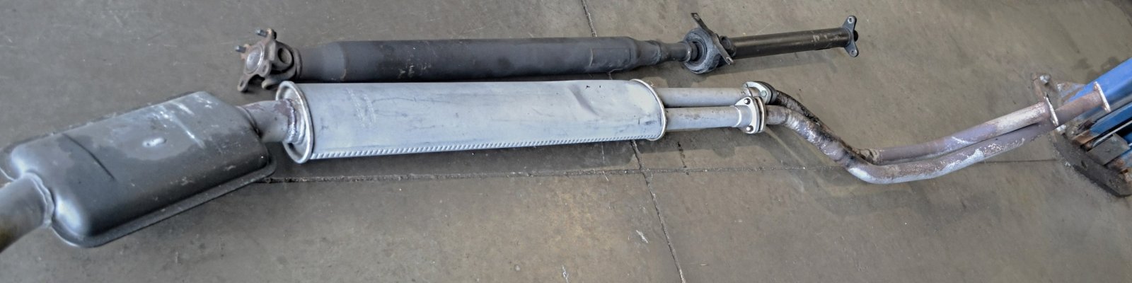

I think they got a little carried away with the ”denting”
and yes… my rear muffler has the little indentation in it. That looks very “machine“ made.
this looks like someone smushed it with a 2 x 6.

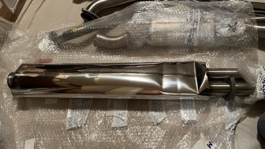

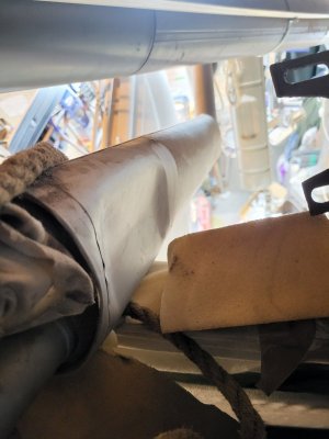

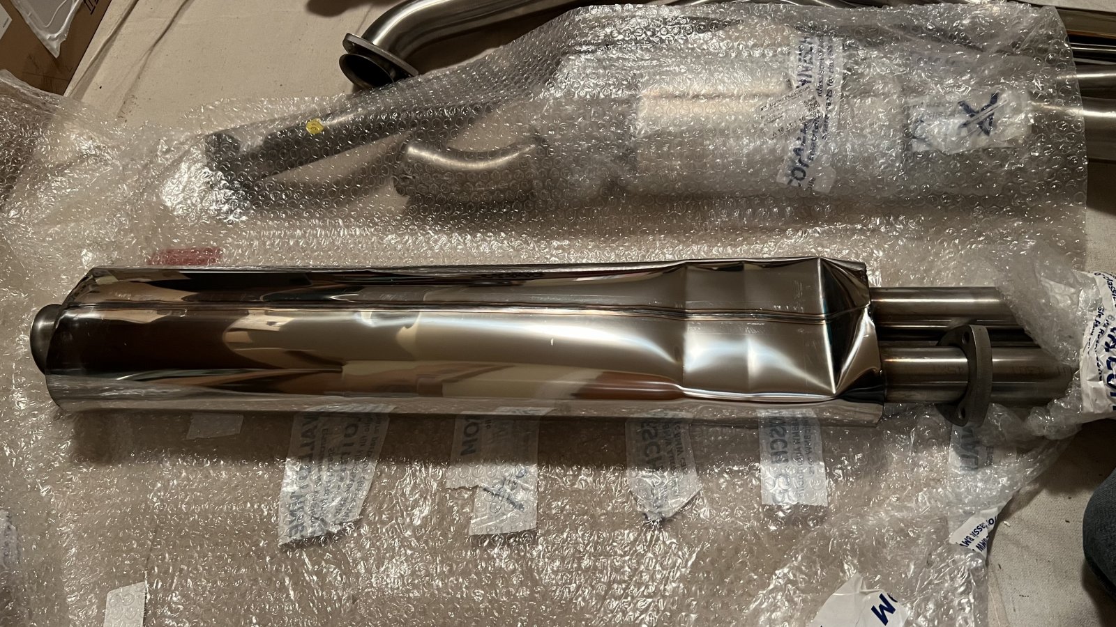

So I was very excited today... finally got the package from Germany.
Unfortunately it showed up a little mangled.
Since I have no experience here I have no idea ... but doesn't seem right to me.
I was alarmed to see the size of that deformation. I did, though, recall my stock one had something similar, but not quite so severe looking.
yes, the stock drawing on realoem shows a formed recess ... but not something that looked like it had been beat to death with a baseball bat and left for dead.

Well this is the strangest thing ever.
So I have been corresponding with W&N concerning the exhaust system situation. First off let me say that they have been extremely helpful and very responsive. Over and above good service which is rare these days.

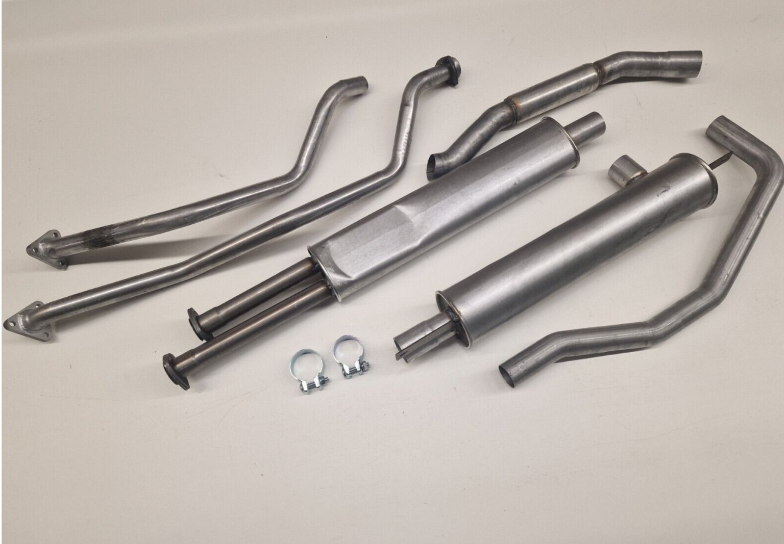

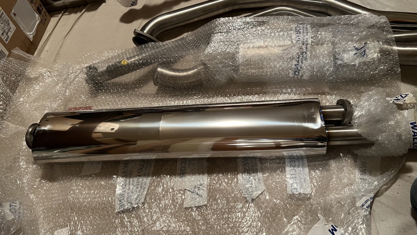

Apparently, this is how the center silencer is supposed to be .... that dent in on purpose. I mean it did look a little purposeful but with the condition of the packaging I just assumed it was a problem.

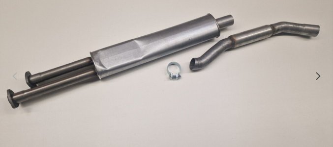

Again... seems peculiar to me but okay I guess so. The rep even sent me a picture of one from their inventory (attached).
Just an FYI for those of you that do purchase this system. It is on the top of the piece so it does not exactly show.

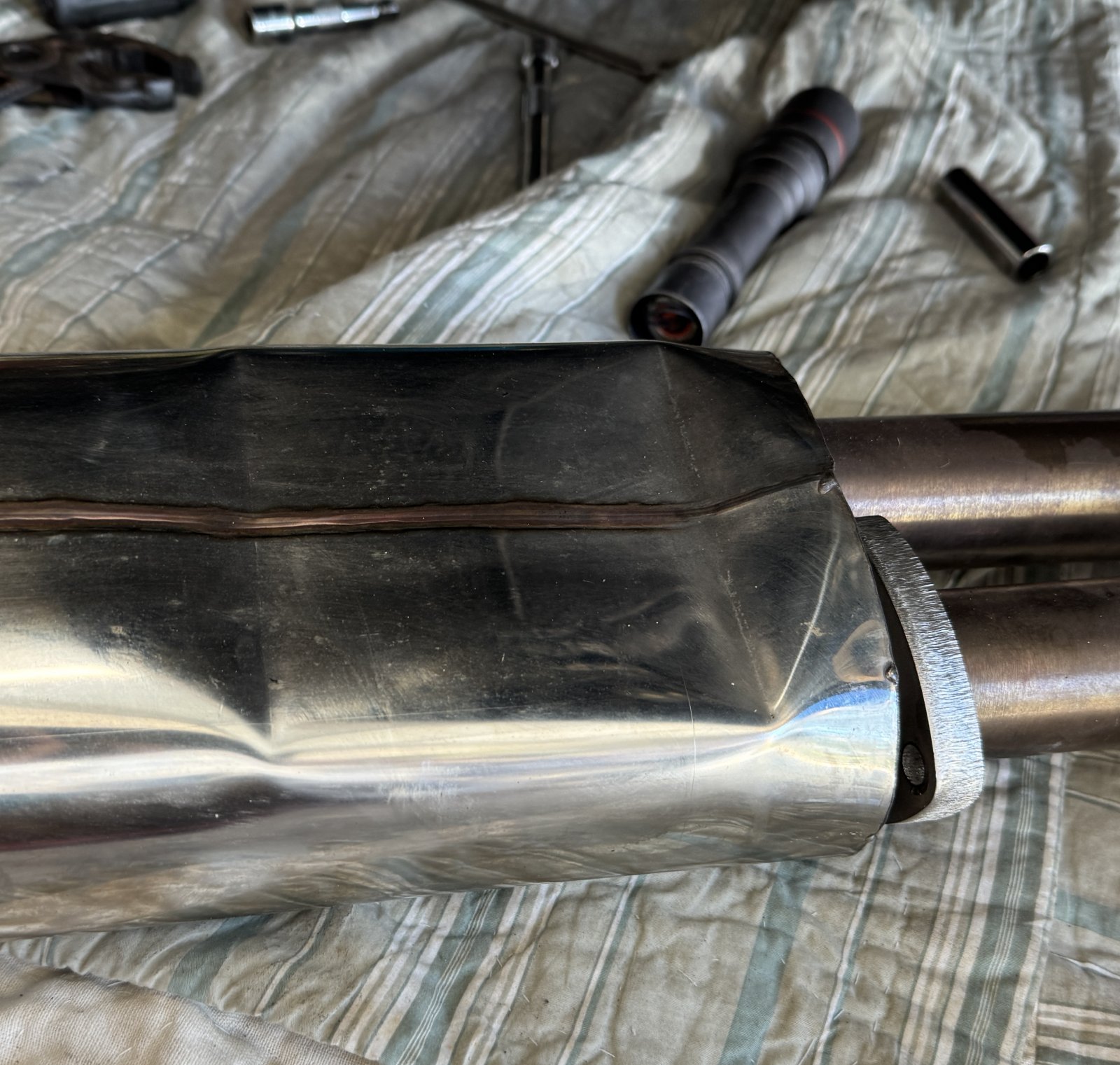

Hello! Fun to see your purchase and read about your progress. Welcome to the E9 restoration adventure! I will confess that I've been on it for about 10 years now. I also bought the stainless steel exhaust system from W&N. The first system came with a significant amount of damage. They promptly sent a second system with minor shipping damage but considerably less so I decided to keep it. I just grabbed my center unit from storage and am attaching photos of it from both sides for your comparison. FYI, although WN said nothing to me about returning the damaged unit, UPS asked for it when they delivered the new system. I did not have it ready so they had to come back for it later.

Looks like a rack of exhausts fell over at the factory and somebody drove a fork lift over all of them. That severe degree of dis-forming should come with a disclaimer about appearances.
Yes, I mentioned that to them and they said they would consider this.

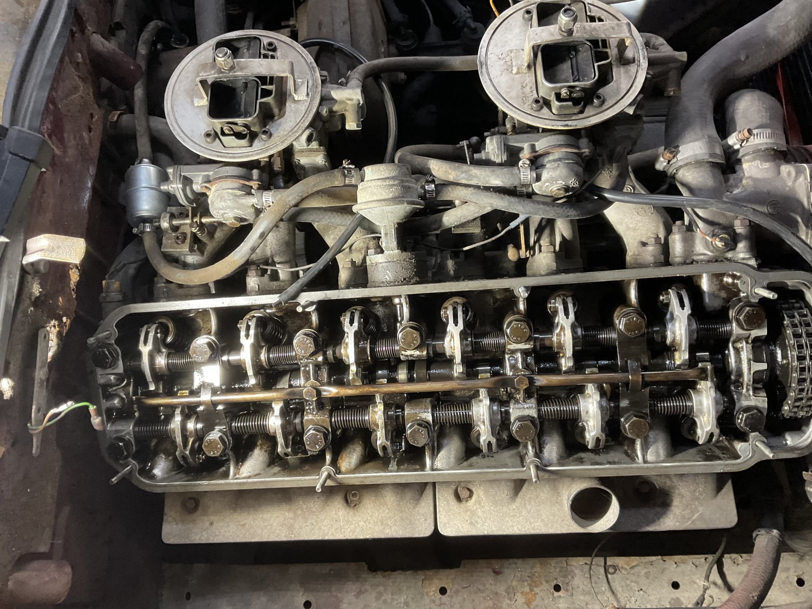

Did a valve adjustment today. Wow that’s been a hot minute. Did remember how to do it after I overtightened the first two.

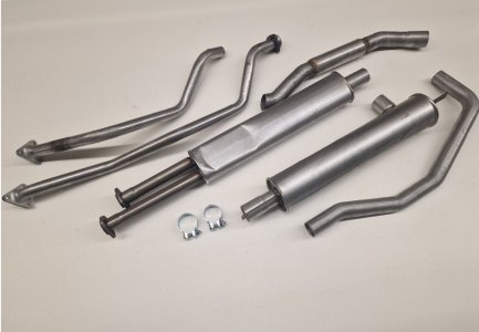

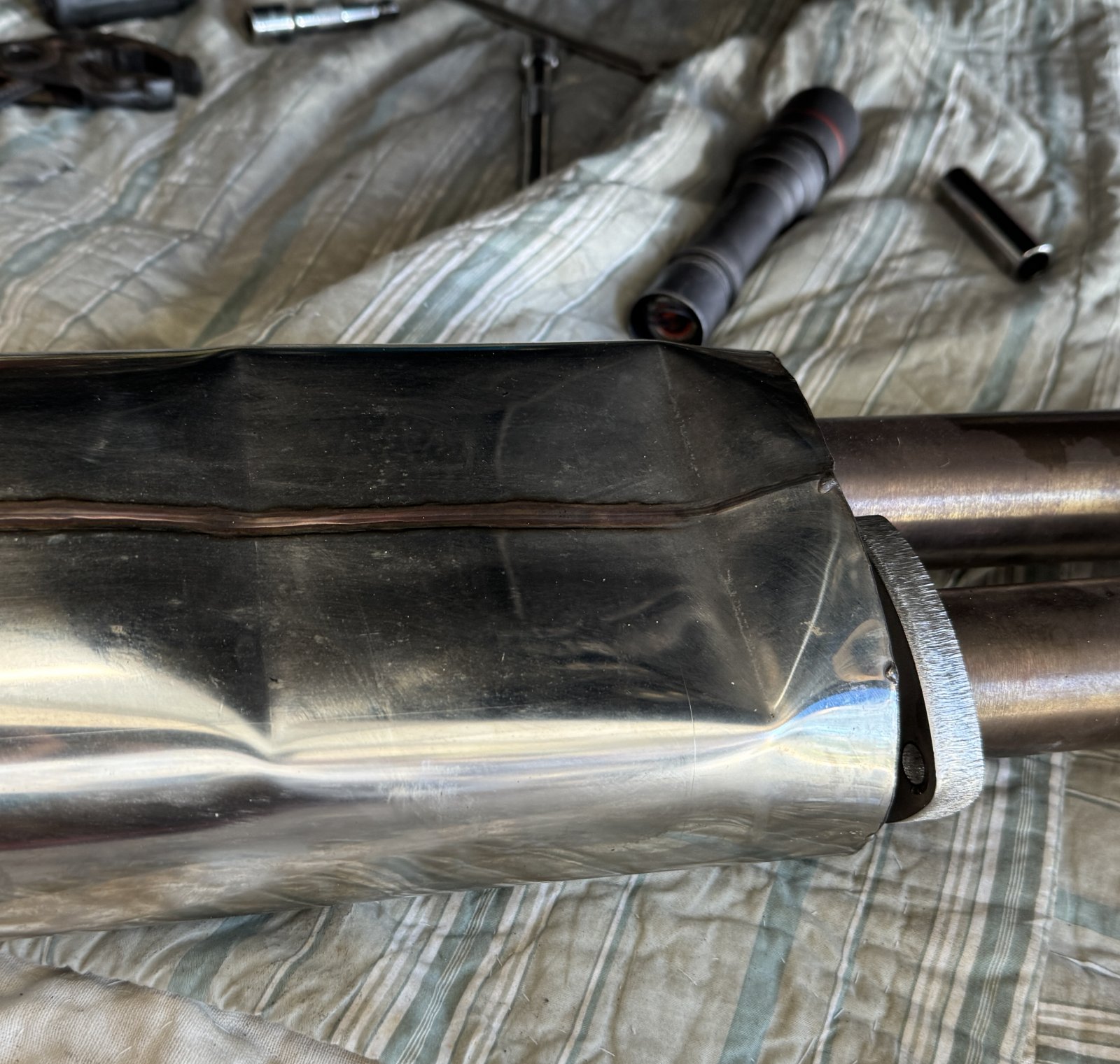

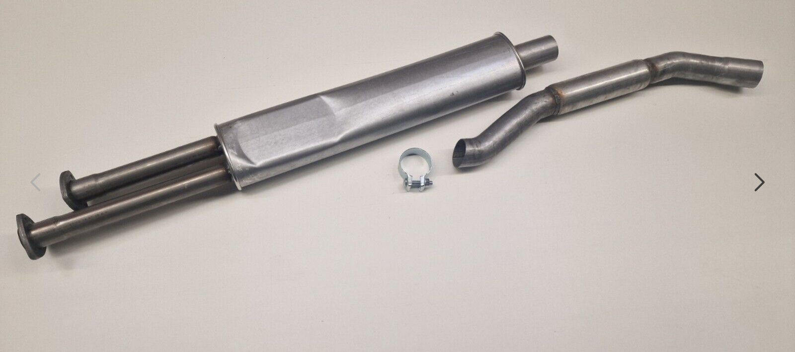

i thought the 'strategic dents' were only in the rear muffler behind the diff. i do not remember seeing them in the center resonator. i just looked up pics of the system on Fritz's Bits - NO strategic dents ... but now that i think about it, that's the underside of the resonator. mine isn't here at the house to go look at - anybody else have 'strategic dents'?
Apparently it does……
as i remember, the original 2800cs resonator did not have the big strategic dent at the front, there was a small indention in the middle of the smaller resonator. also, the 2800cs did not have the middle muffler muffler between the resonator and the rear muffler. @tdgray the strategic dent was for the hanging mount on the 3.0cs - which also mounted the heat shield

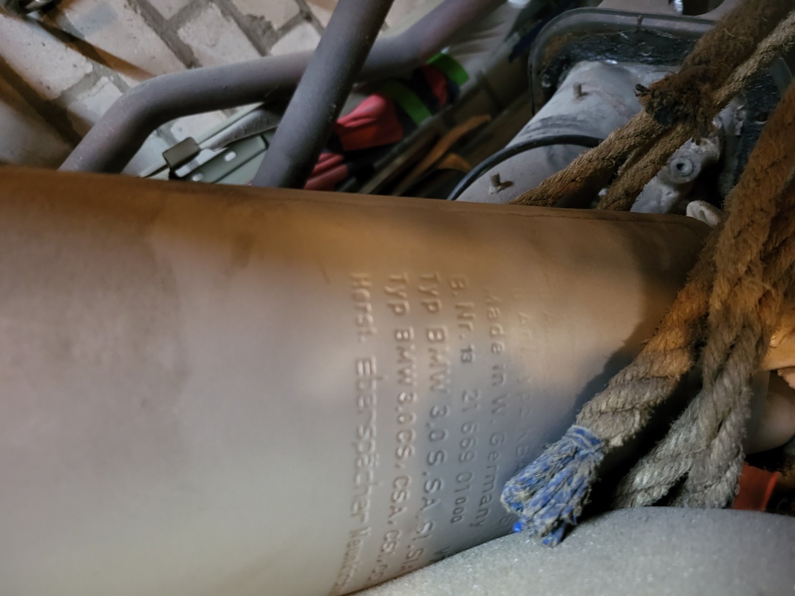

I have my system out as well, and I build it with a new, old Eberspacher part. It even identifies itself as fitting for an e9, but also e3 types are named.
Not sure if this was bmw issued though, as stating e3 and e9 fitment seems a bit "aftermarket".
Anyway, it clearly also has the dent. The dent looks to be made after the oval end cap is welded in.

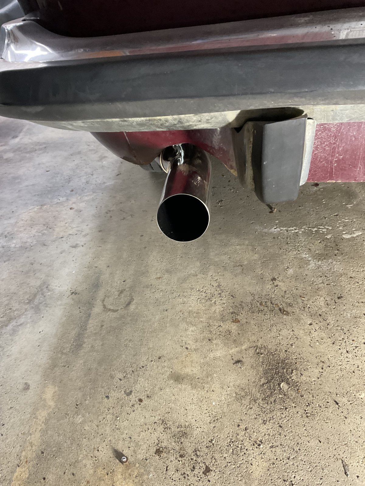

Made a new hangar for the tailpipe. It’s better.

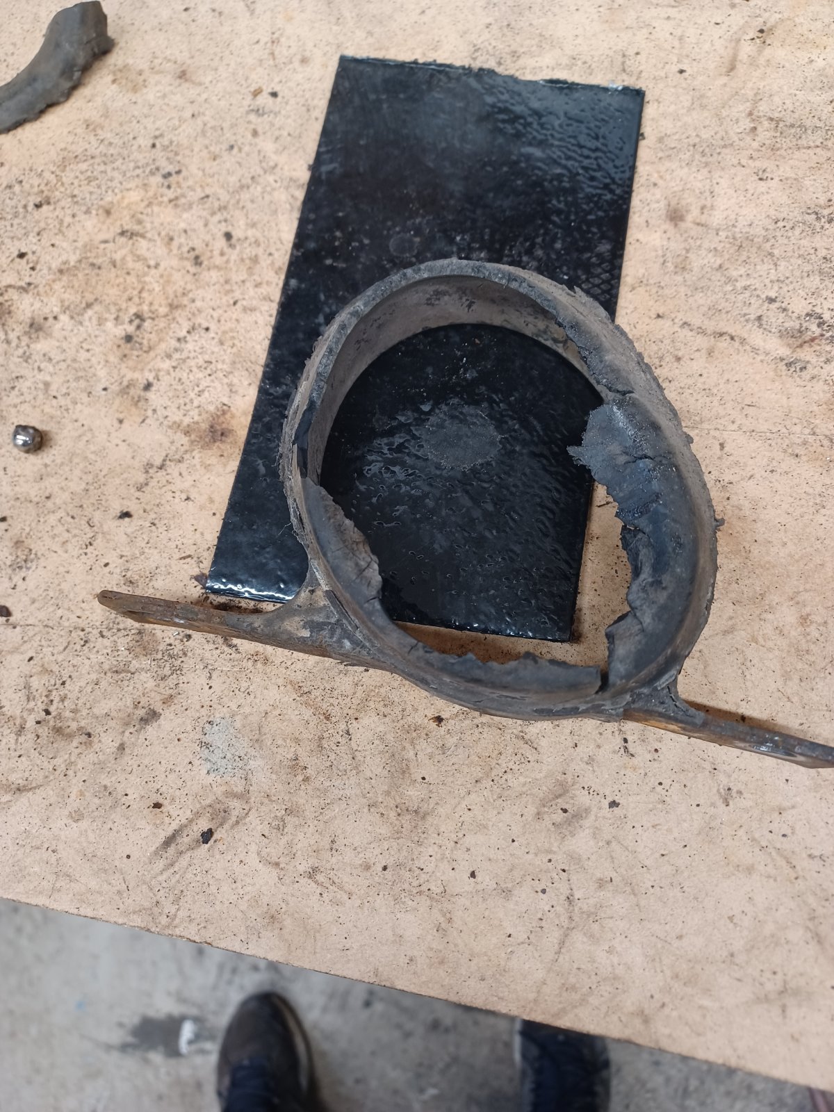

the Differential mount is absolute toast. Will replace the transmission mount at the same time.
