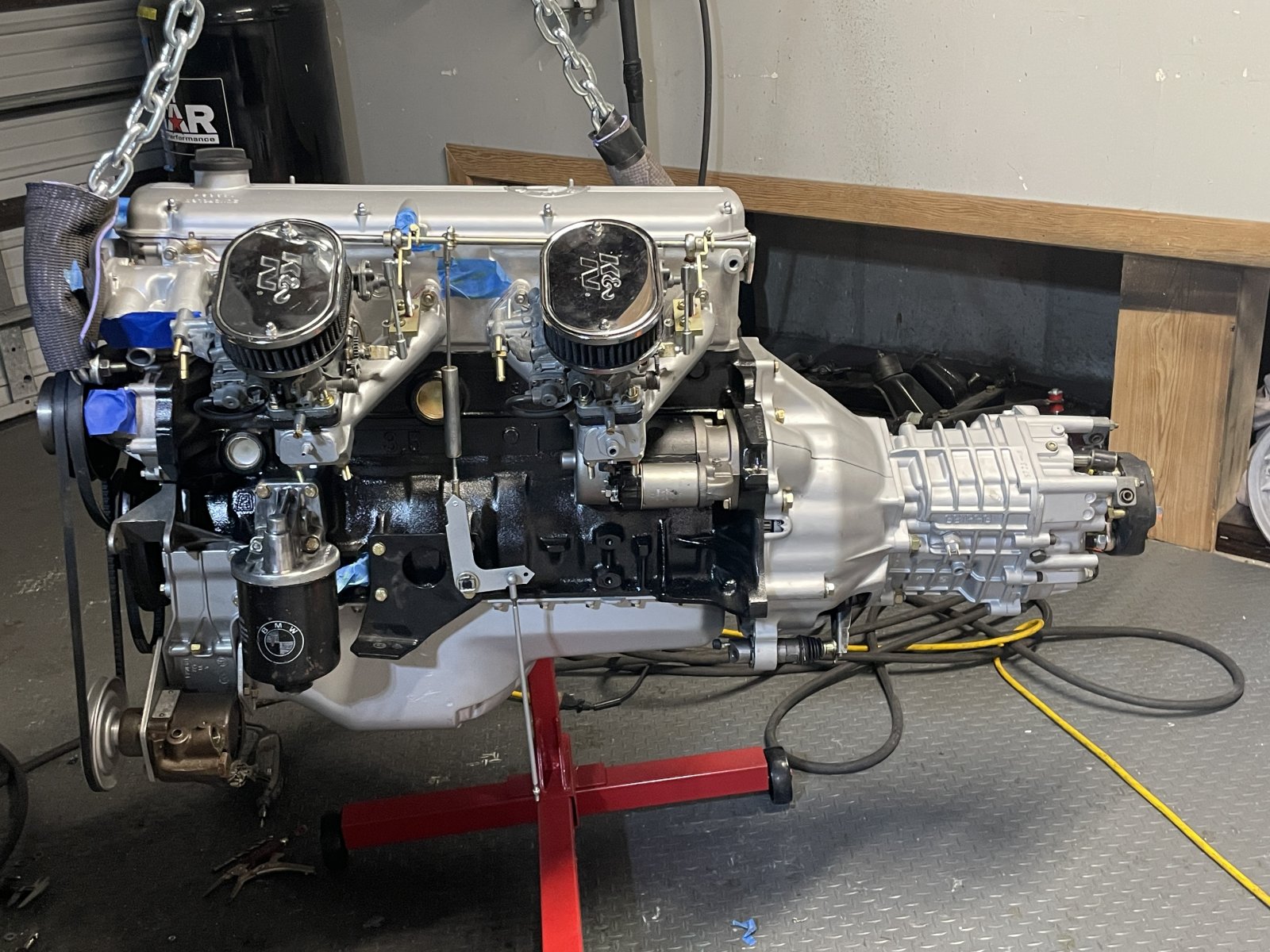

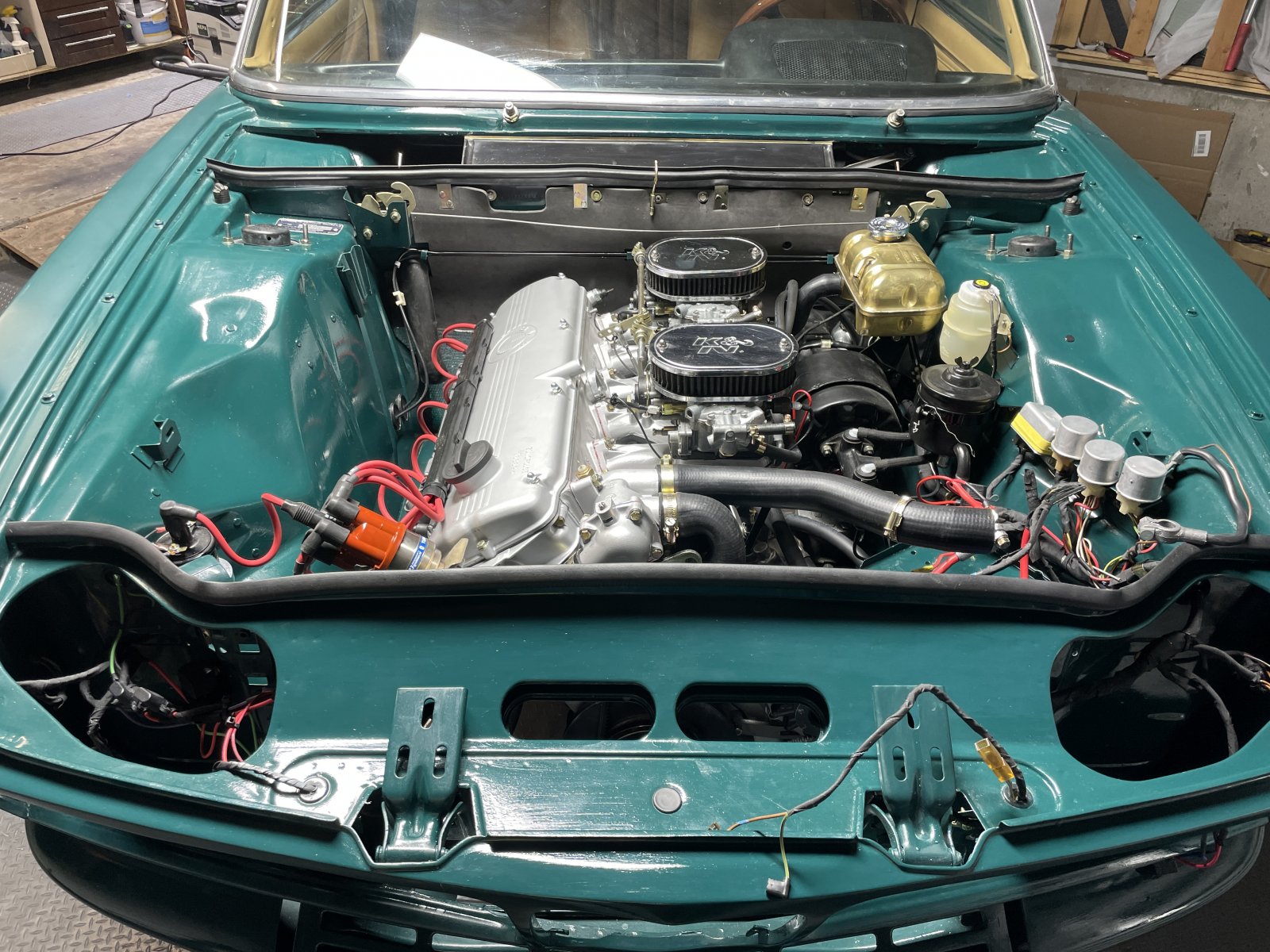

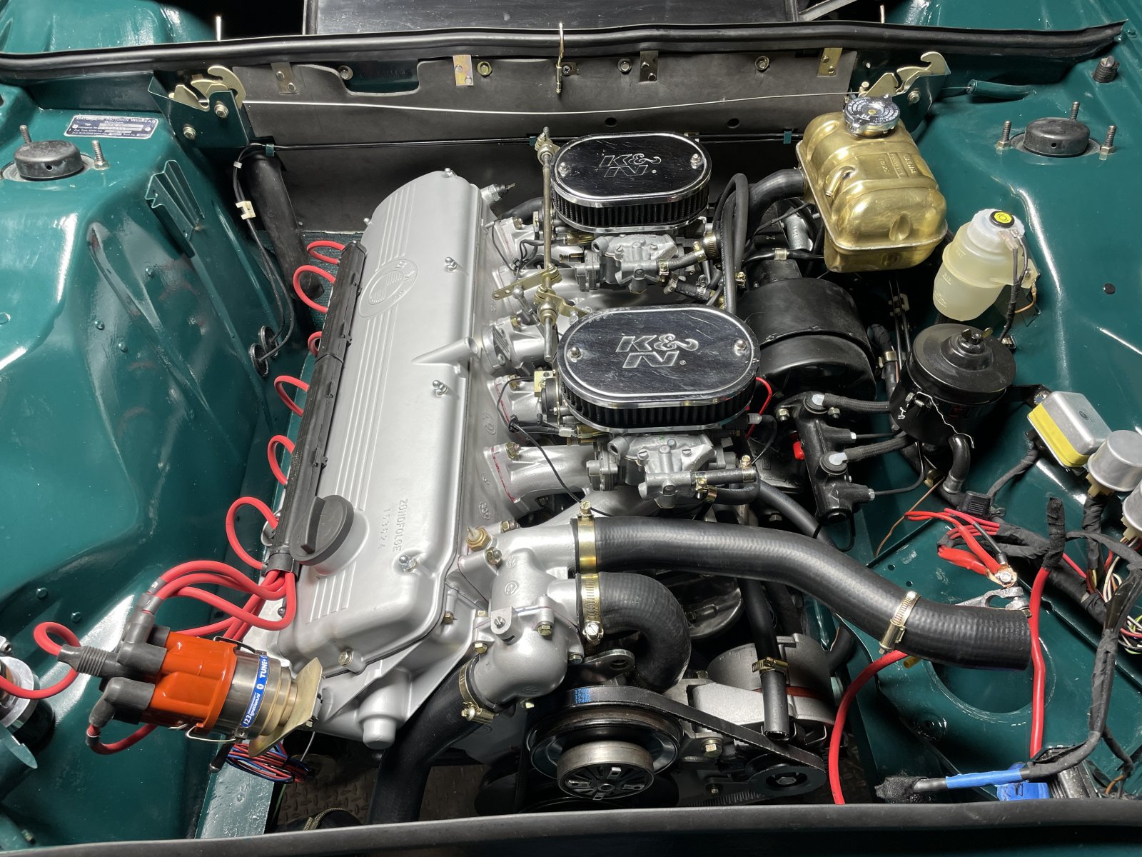

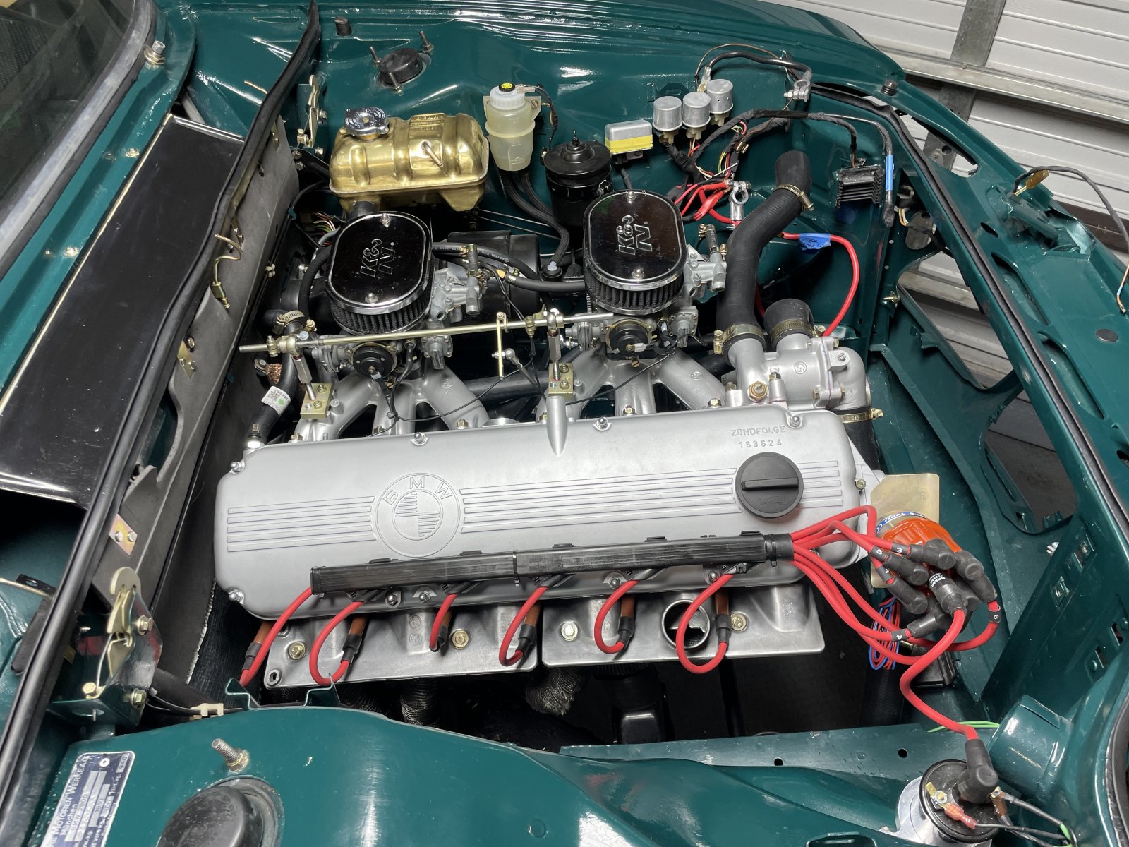

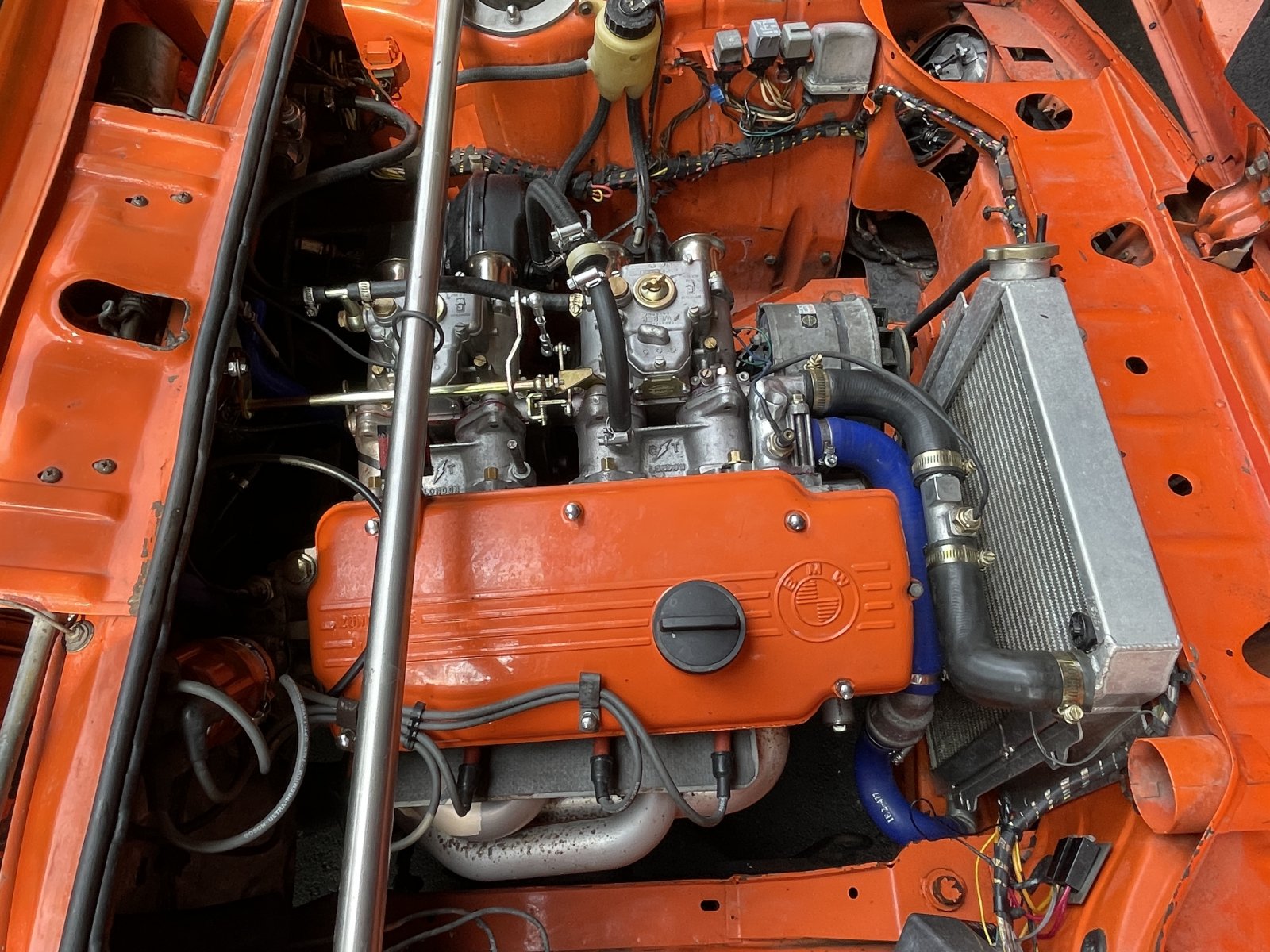

It’s been a good week. Between working on the E3 and waiting for the motor, etc., I got involved in putting dual for dcoe,s on the Inca 2002. Some initial advice from Stevehose as well as Top End Motorsports.  And after considerable effort trying to understand exactly what I was doing, and further as a precursor to perhaps triple side drafts on the 3700 rally motor, I, to my surprise them running exceptionally well. The 2002 has a 2300 rally motor from MM which for the past eight years has run on a single 38 downdraft.BIG DIFFERENCE. A bit sluggish under 3500 but after that, it’s a bad ass machine! of course it sounds great too. Just need some filters.
Without a doubt, the biggest problem I had was vacuum leaks, and thanks to the advice from top end motorsports to check this with either. It was quite obvious that my initials set up really SUCKED, pun intended. Ended up, redoing it twice and using significant amount of gasket sealer both silicon and heavy tack. After that, it was just a matter of adjusting the mixture and idle. it’s got a 130 main, 190 air jet and a F8-55 idle jet.
I can now get onto the task of installing the “Jewelery”, as Dick calls it, into the project the subject of this thread. Given my success at this trial run of side drafts, I’m probably gonna be looking for 3 45 DCOE’s!
