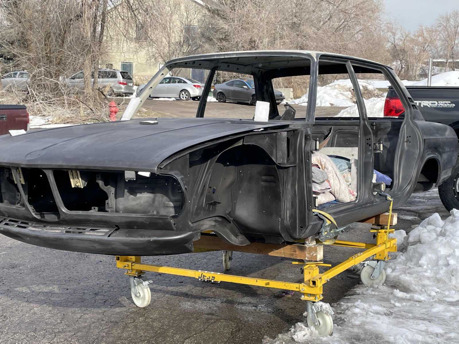

Update on Project:

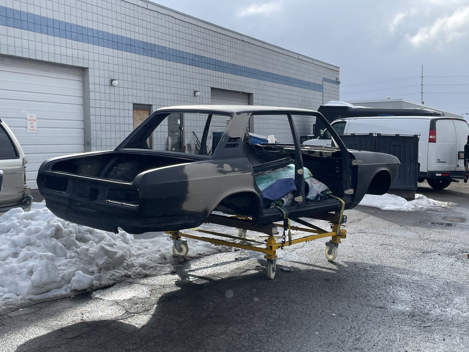

After a great deal of sanding, priming, resanding, repairing, sanding and priming, etc. etc. add Infinitum the car has finally arrived at the painter. Trailering it was a bit of a white knuckle flight as it sat so high on the jackstands.

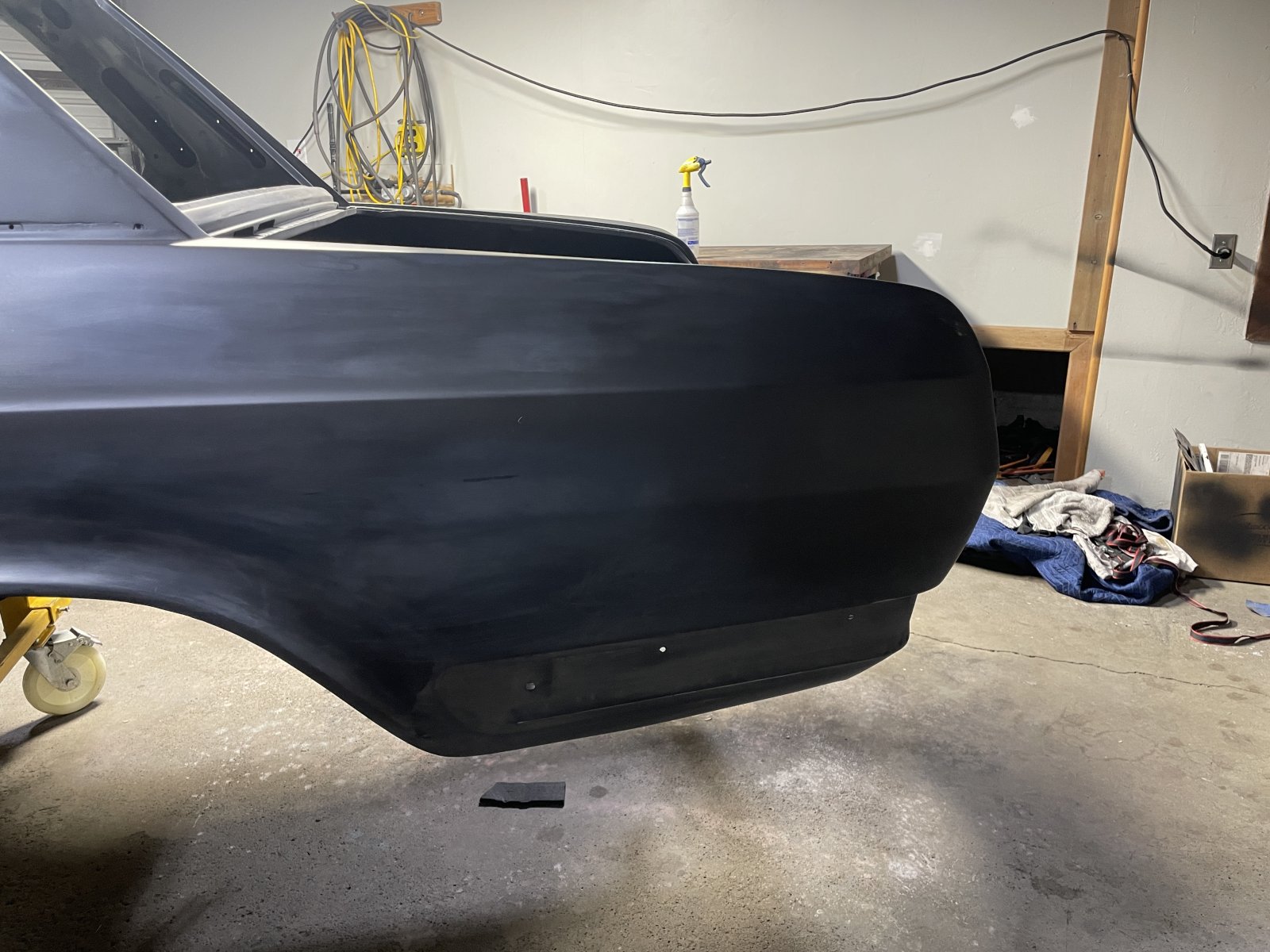

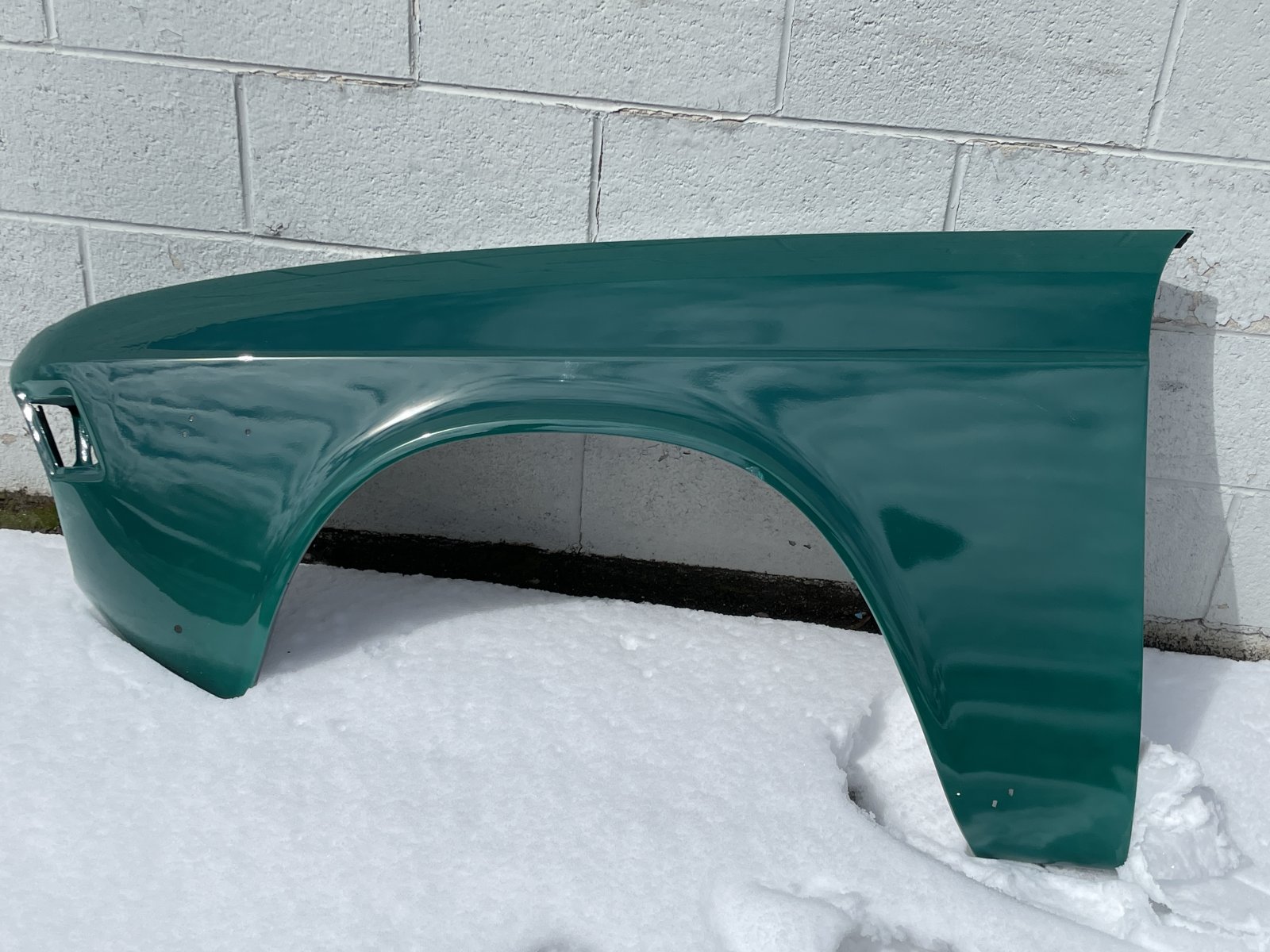

I decided to go with the deletion of the real light markers to look more euro. Otherwise it was fairly straight. I gave up on the driver side fender and was able to find a new one through BMW, Monterey awaiting delivery. The vehicle has apparently been pranked in the corner. There was a previous repair,(not very good) rust, and the pendant was somewhat deformed. After looking at the fender that came with the car, the guys at the body shop were pleased with the order of a new one. Basically it would’ve cost more to fix than to get the new one.
Need to source carpet, headliner, and seats, and or seat fabric and Carpet.I may go with aftermarket front seats from Stephen at.GTS Classics, looking at the Monte Carlo for two front seats. Still need covering for both front and rear end. Likely will go with leather.

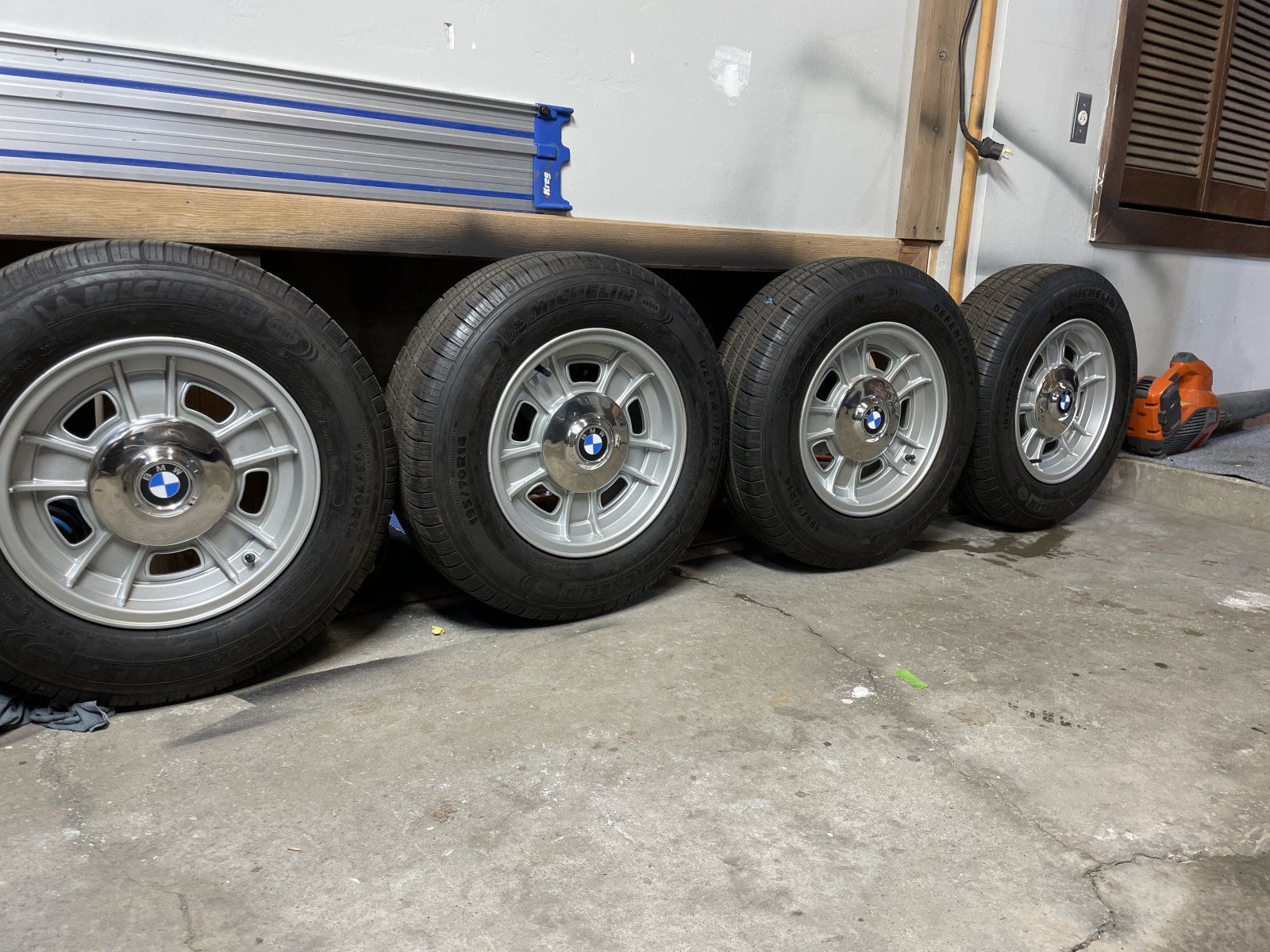

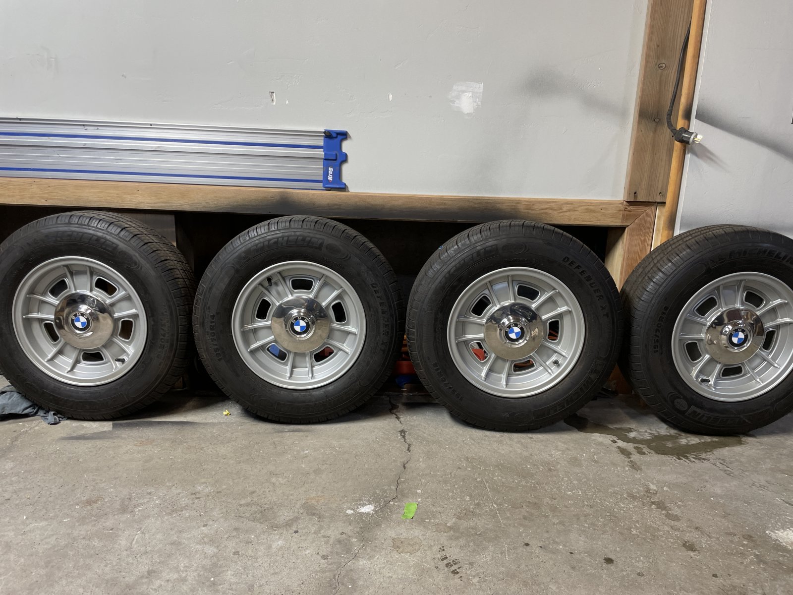

The rims are being refinished, and should be ready shortly.

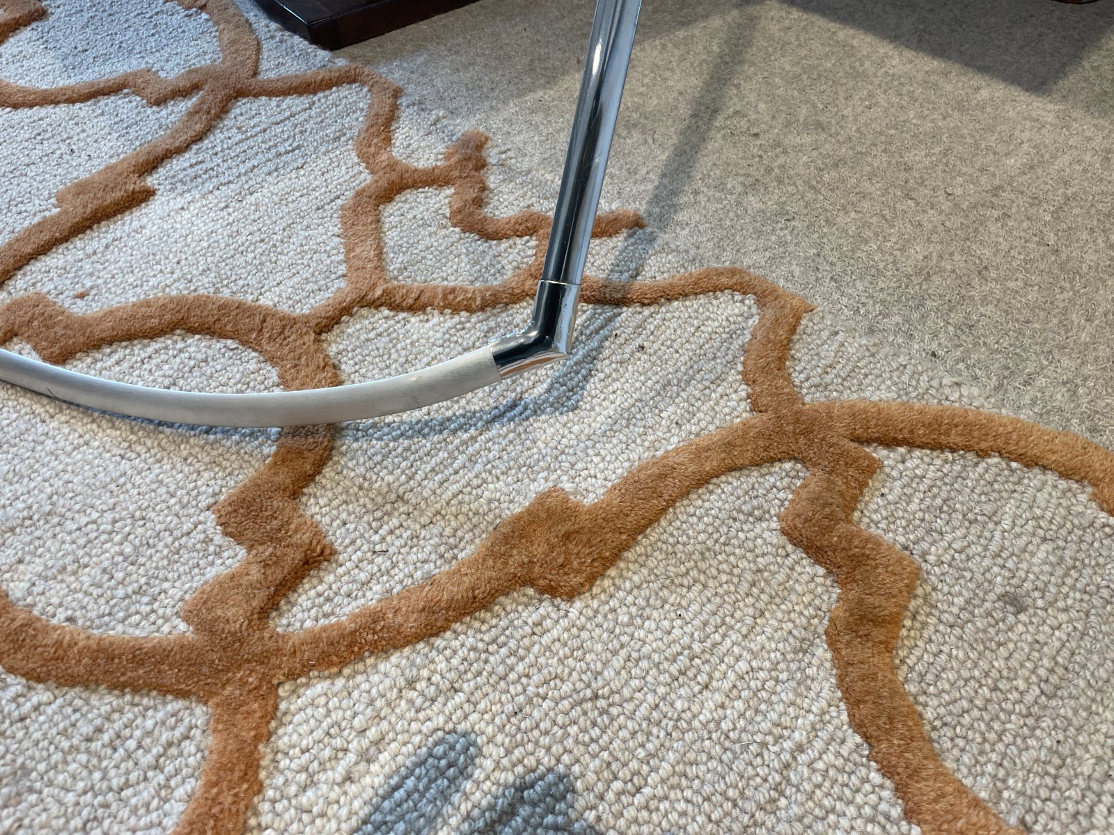

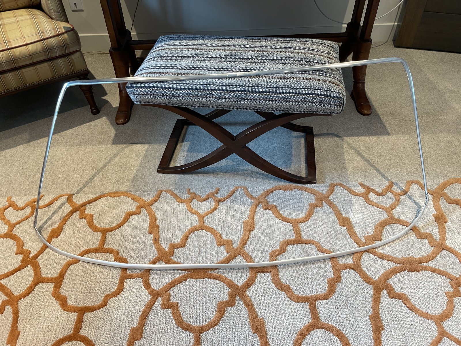

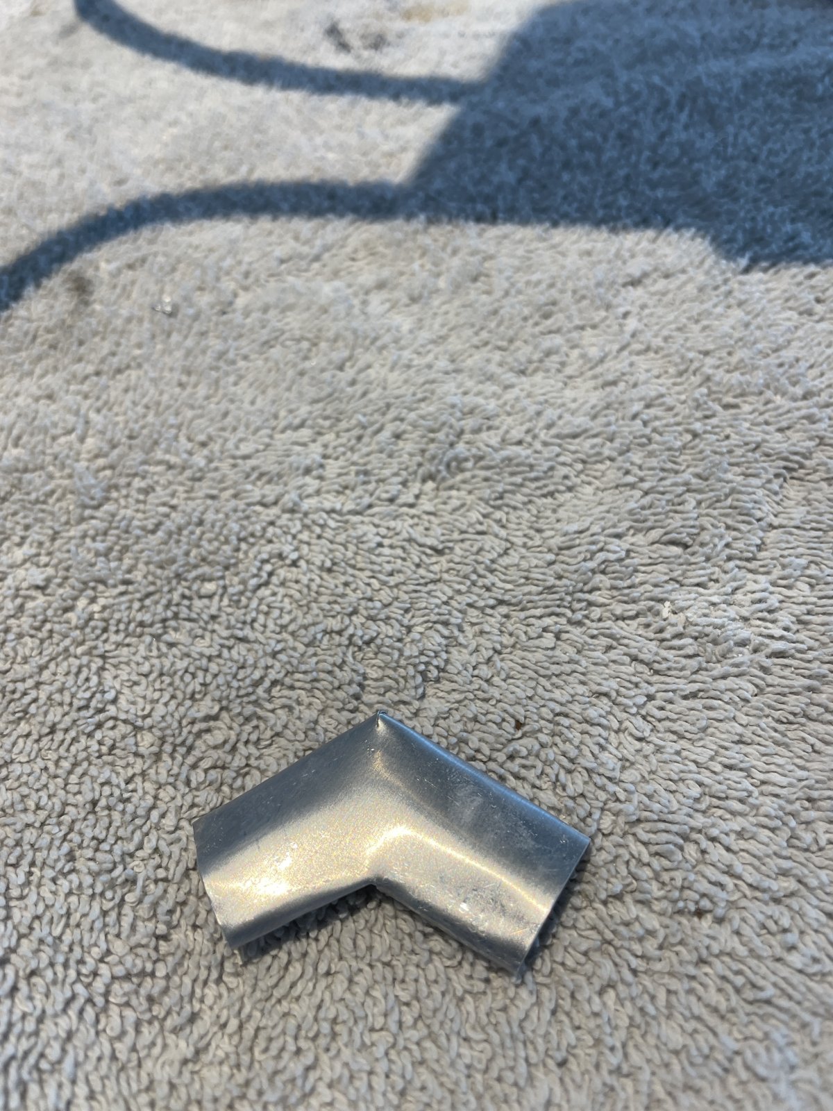

The only thing that I’m missing is a rear window gasket. I’ve checked it out and I’m fairly certain I can use a front windshield gasket for the rear by cutting and pasting. (Fortunately, The one I removed is in good shape, and I have a new one as well.)
Should someone know this to be impossible, please speak up, because rear gaskets don’t seem to exist.

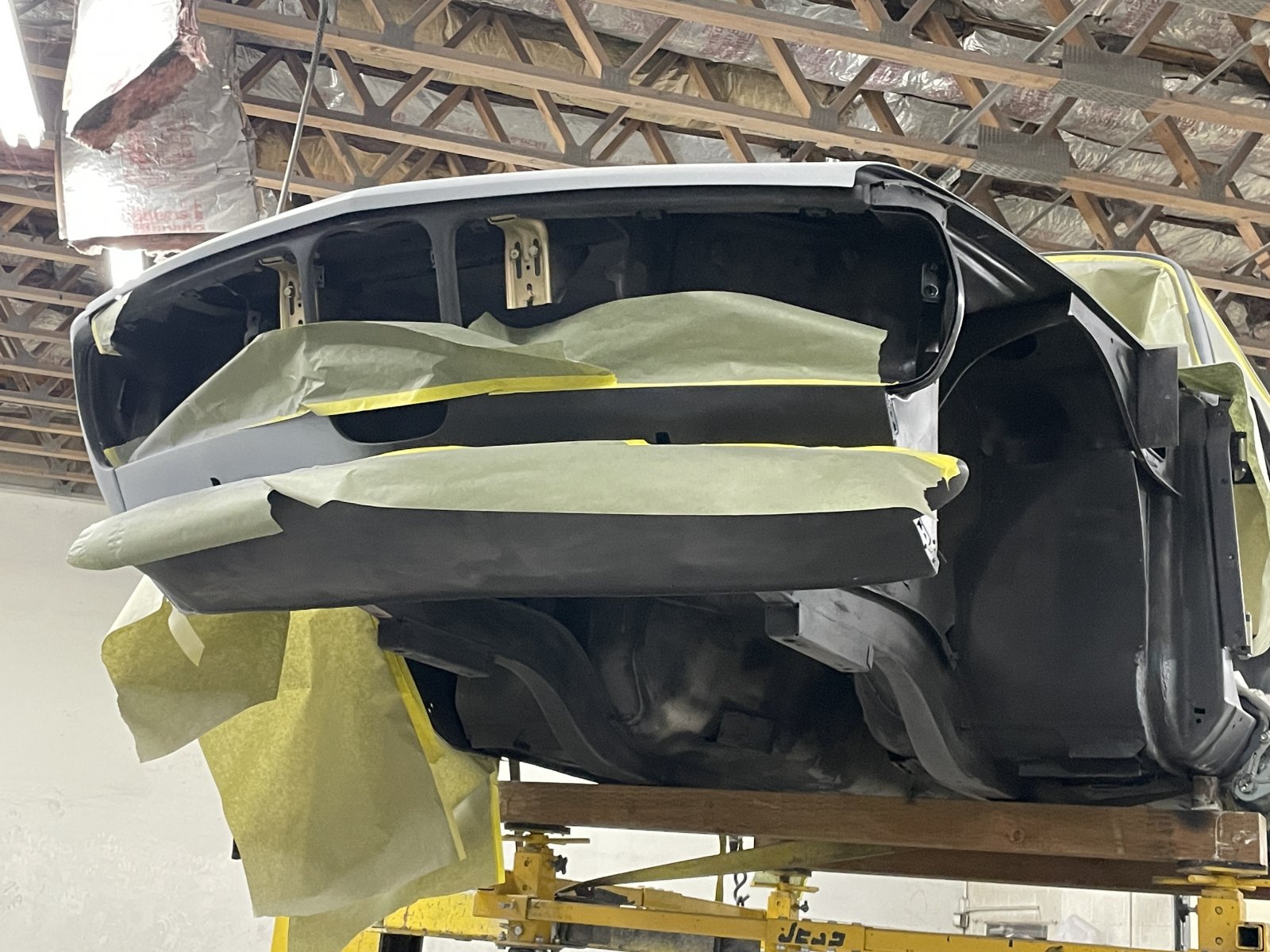

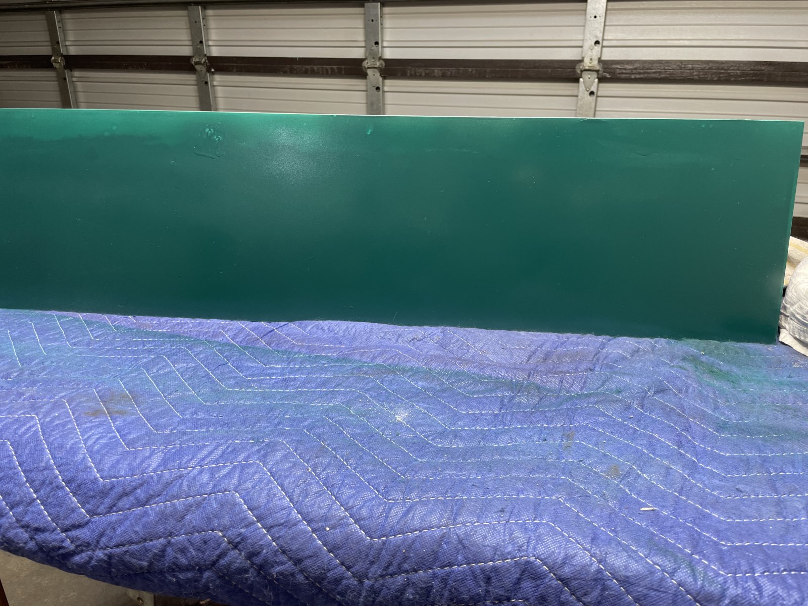

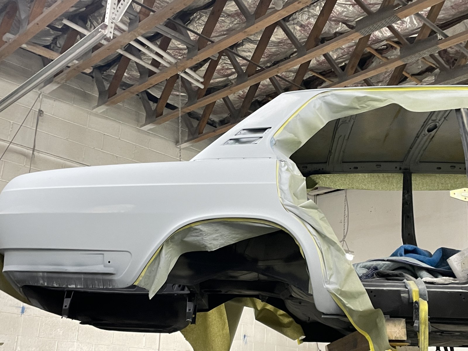

I visited the car at the paint shop today in Salt Lake City. Hadn’t seen her in four weeks. It’s coming along overall. I’m told it was in very good shape. Just a few things left to do. All body work is done. I need to doing only thing left is to put another coat of primer and black sand, looking for imperfections.
The shop it also made up about pint of the pink color and I got about a half cup. I sprayed it on a piece of metal which was only partially primed. Agave is pretty tricky, don’t want it green but don’t want it too dark. I’m getting hesitant on the color but we’re going to spray a couple pieces and tweak it. Here’s what I did. The lighter part at the top was just raw metal with no paint or stain on it. I think the lights gonna depend on the color of the primer. I’m thinking we should go with black.
What is the pink color for?
The high build primer is for sanding. Color doesn't really matter. The car will (should) get a coat of sealer just prior to the color. Your painter should have an opinion on the prefered sealer color.

It’s just with this green/Agave, I need to be very careful. I need a deep, dark green and not a mint green.
I would think a good quality paint brand would have the color code for Agave and that it should be very close to the color BMW used. Do you have anything you can compare a sprayed sample to?
