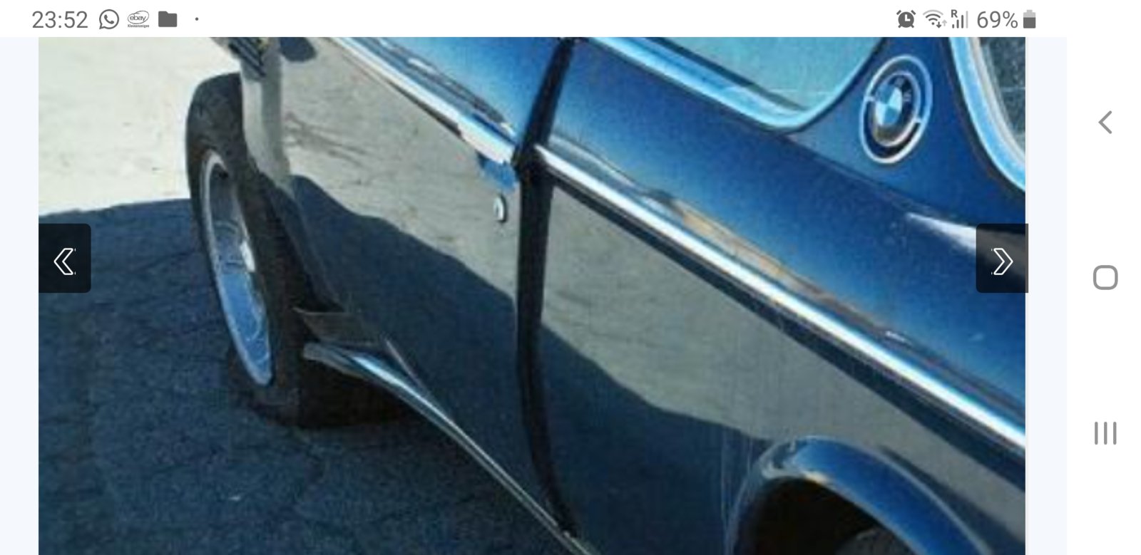

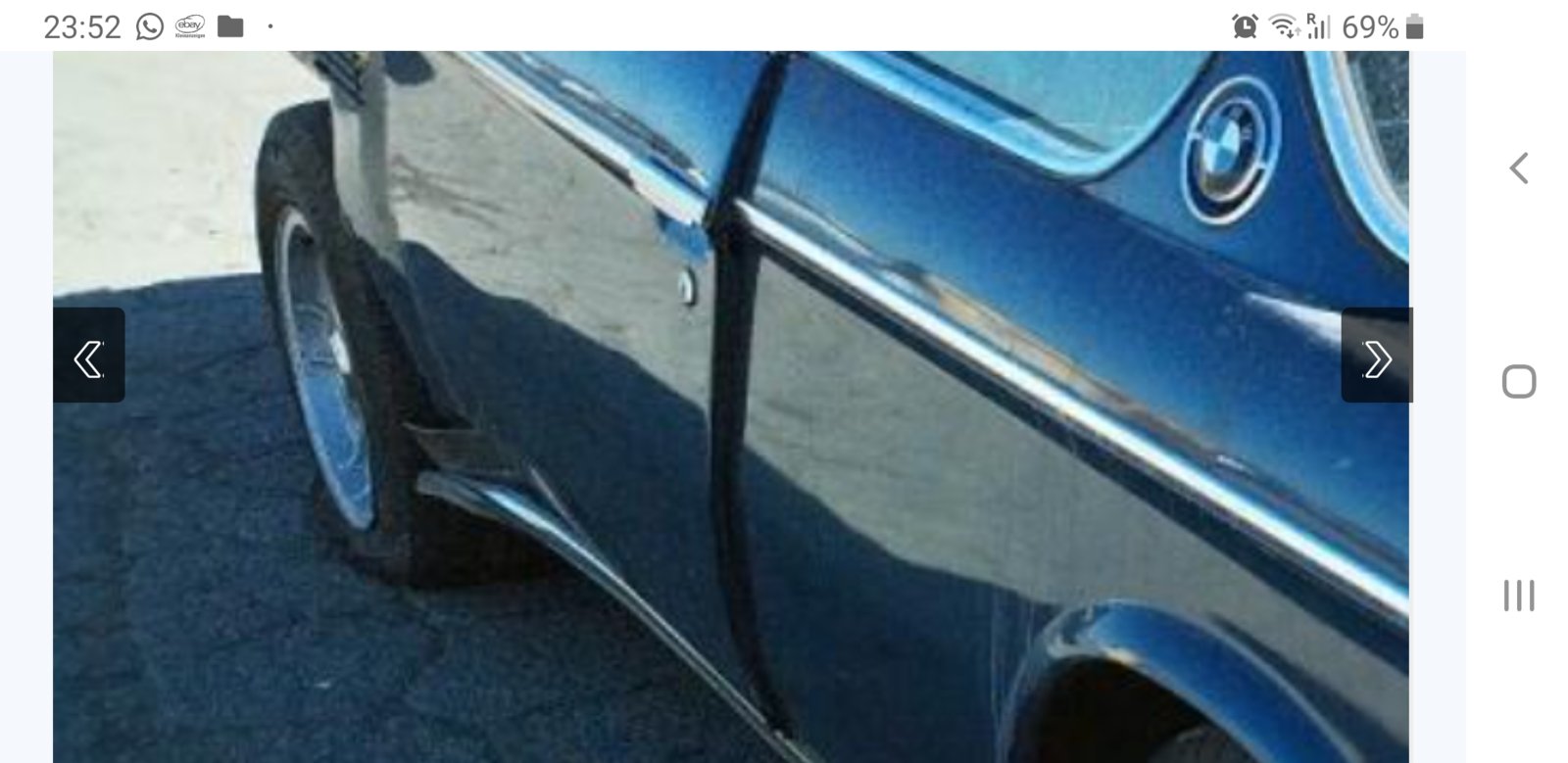

I think the left front wheel has been pushed inwards toward the A pillar:
- it looks like the face of the rim is not vertical anymore
- the sill cover and alu trim is pushed / buckled.
- the front fender is also wrinkled between the wheel and the door.
Now did the front A pillar got displaced? I think yes, as the door doesn't seem to close, nor be able to close. And it is likely also the reason the window popped out or cracked.
I would also question if the strut mount is still in the right location.
Nevertheless, seems savable, but requires quite some work. Hood seems to ok.
Count on New left fender; 2 or 2.5k usd for the part. Inner fender parts around the strut mount; 750.
Strut+ dampers, not sure, 500?
Full nose ( no fenders) 3500-4500 usd.
New front bumper corners 600 usd.
Grilles, lamps, alu trim another 1k.
Unsure: front subframe, hood torsion system, battery tray, A pillar.
I do hope the sills are untouched and rust free....

If the car isn't rusty the body damage will be WAY easier to fix.

Left fender and nose would need to be replaced at a minimum. Right fender is questionable.

I did not like the look of the front wheels, I would say the toe in was about 30 degrees. Suspension mounting points probably badly distorted.
