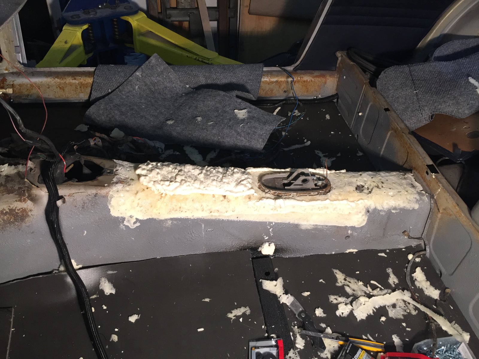

P Patton Well-Known Member Site Donor $ Messages 791 Reaction score 687 Location Atlanta GA Aug 24, 2021 #23 Use expanding foam, then trim smooth, to make the transmission tunnel smooth and easier for carpet to lay flat. RP
Rek Well-Known Member Messages 1,221 Reaction score 463 Location Islington London England Aug 25, 2021 #24 I like the idea of using expandable foam. It is used so much in luxury cars nowadays. I like that engine too!
P Patton Well-Known Member Site Donor $ Messages 791 Reaction score 687 Location Atlanta GA Aug 25, 2021 #25 Rek said: I like the idea of using expandable foam. It is used so much in luxury cars nowadays. I like that engine too! Click to expand... Thanks, Rek. I used the foam in the pedal box area, too, to eliminate the big hump, letting the carpet lay smooth. RP

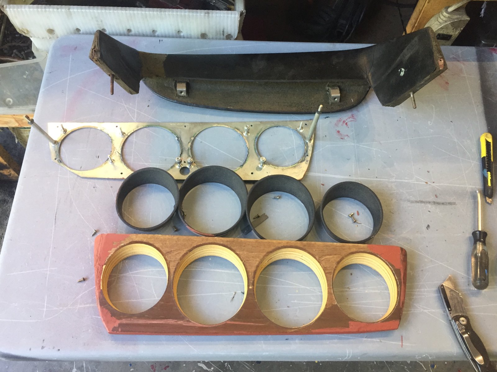

tferrer Well-Known Member Site Donor Messages 2,204 Reaction score 2,431 Location San Francisco, CA Aug 28, 2021 #35 Perhaps I missed it but where you going to replace/restore the wood dash?

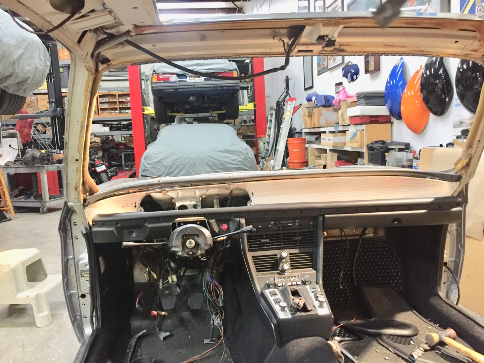

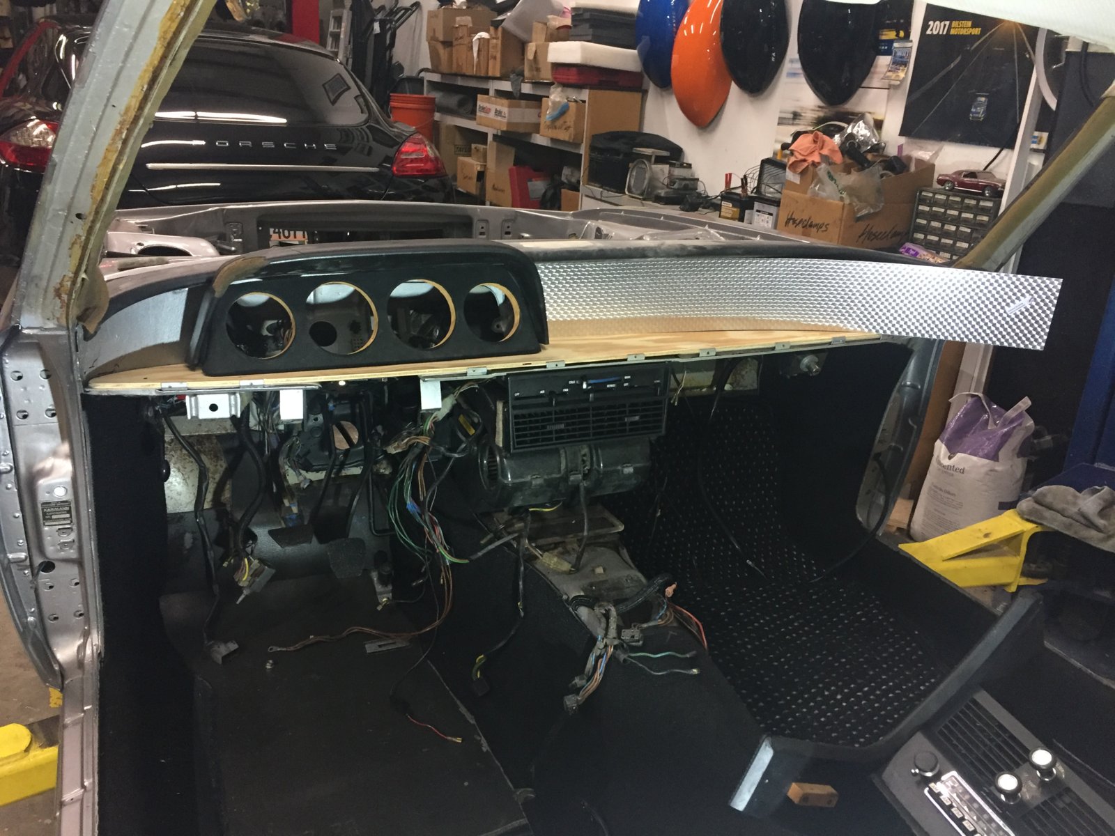

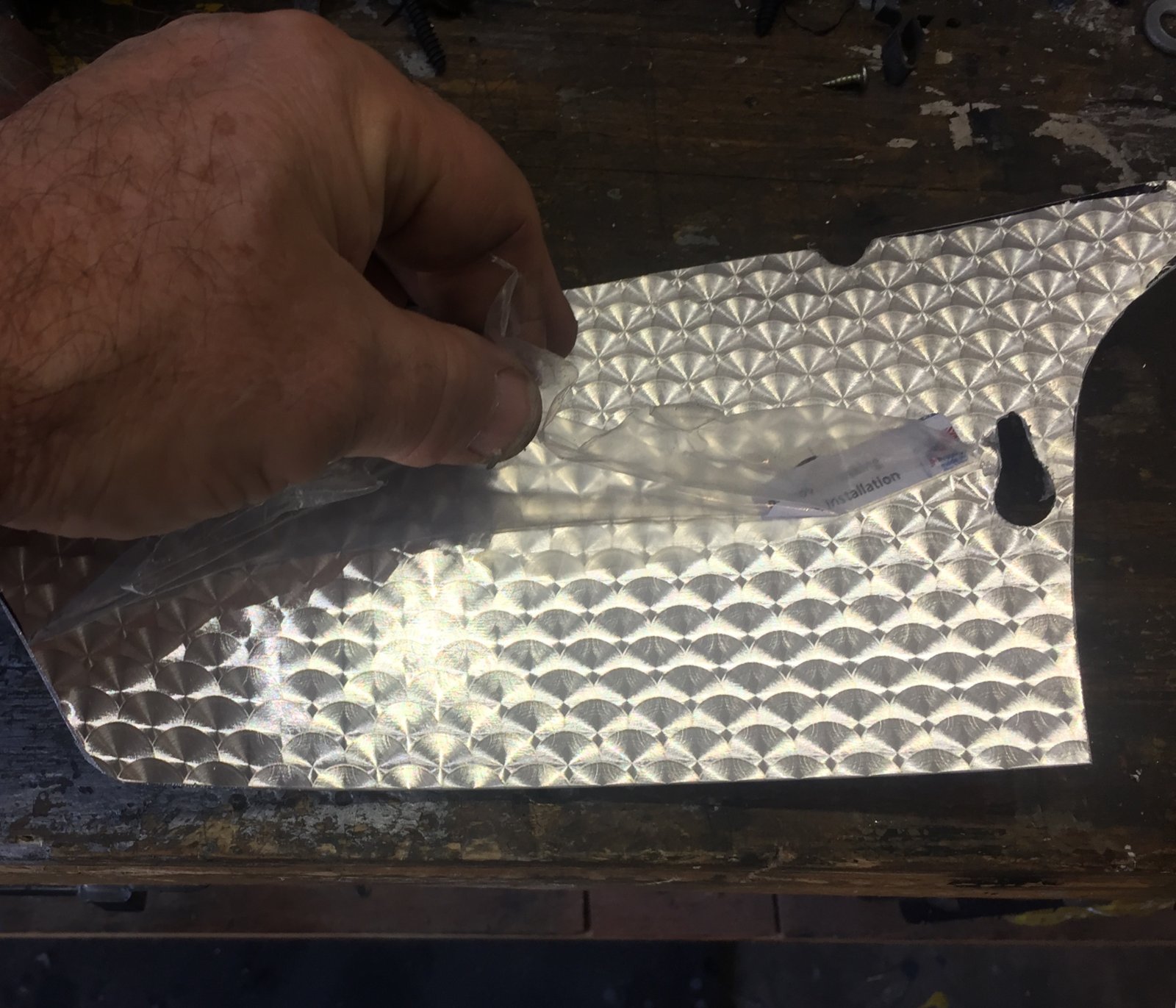

P Patton Well-Known Member Site Donor $ Messages 791 Reaction score 687 Location Atlanta GA Aug 29, 2021 #36
P Patton Well-Known Member Site Donor $ Messages 791 Reaction score 687 Location Atlanta GA Aug 29, 2021 #37 Paul, no firewall modification was necessary. tferrer, the wood was replaced with a thin, bendable sheet of machine -turned metal. RP Last edited: Aug 30, 2021
P Patton Well-Known Member Site Donor $ Messages 791 Reaction score 687 Location Atlanta GA Aug 29, 2021 #38
tferrer Well-Known Member Site Donor Messages 2,204 Reaction score 2,431 Location San Francisco, CA Aug 30, 2021 #39 Got cha. That wood looks awful good in the coupes!
