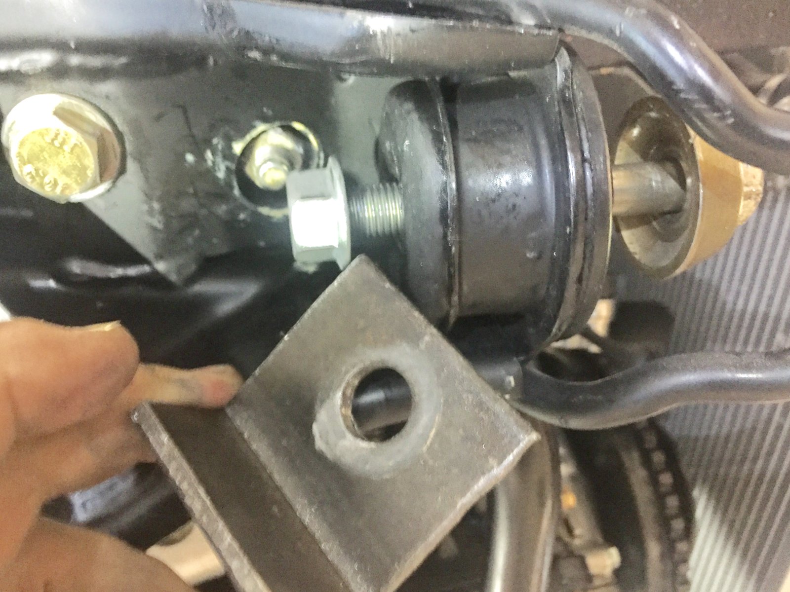

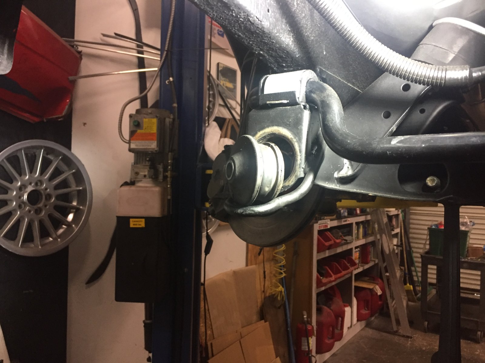

Removed “crumpled” 47 year old bushing from control arm and wondered how to get the new bushing into place…
Great fun.
RP
me too replaced those bushings once and couldn't get them in. I suppose those ( W&N parts ) were bigger in diameter then oem.
I cut them in half , so i could mount them as a front and rear piece. Even then i needed quite some force with a bolt/washers and impact gun.

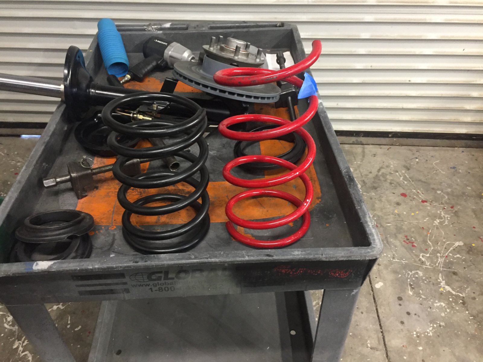

HOPE IT RIDES WELL W/ THE CUT SPRING
SEEMS TO BE A DEBATE ABOUT IT
Thank you for the kind comments. I’ll let you know how the springs work out once the car is drivable.

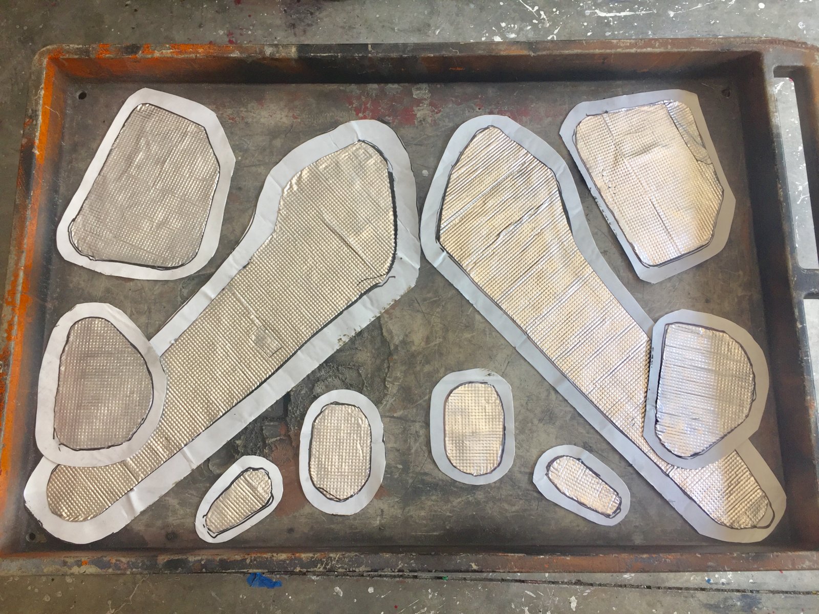

B-Quiet water protection inner door panels had to be removed to realign the doors and windows, again.
So, I cut them out, flipped them over and reattached the to another outer “skin” of B-Quiet that I’ll use as the new water protection barrier.
Double Quiet?
