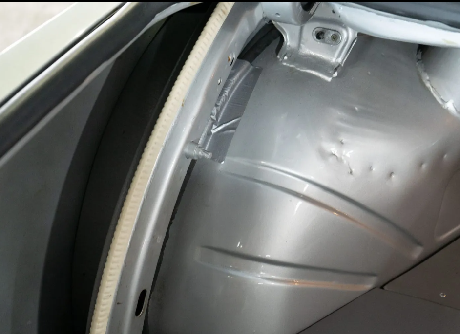

Im thinking out loud here. I didn’t get an answer on the 12k € aluminum bits, but this car’s aluminum boot would reinforce this theory. The striker rivets look period, which I can’t say for the rest of the restoration. They used hex screws on the door hinges so I can’t imagine that they sourced the proper striker rivets if the aluminum boot lid is a repop. That leads me to believe it is original. Also not sure why one would intentionally use an aluminum boot with a bat kit if they were knowledgeable of the original configuration during restoration.
If I may on your last point and I am certainly not saying this is what has happened.
But one would use an aluminum trunk in a restoration for a possible few reasons. One, it enhances the offering to non knowledgable minds. It is often presumed that all CSL's have all four aluminum openings, with a little knowledge, a buyer can understand the steel trunk issue and with a little more knowledge, one can understand how many CSLs actually had standard door skins, so to say "look all four aluminum panels" pleases the non knowledgeable and excites those with a little knowledge.
On another point, if somebody is restoring a CSL and you had access to an aluminum trunk or you had to purchase the aluminum panels, as this car seems to indicate , the temptation to add an Aluminum trunk would be appetizing to say the least, especially considering the other non factory changes on this particular car, it could make sense.
Again, I am not saying this is what happened, just answering the hypothetical question of "why"

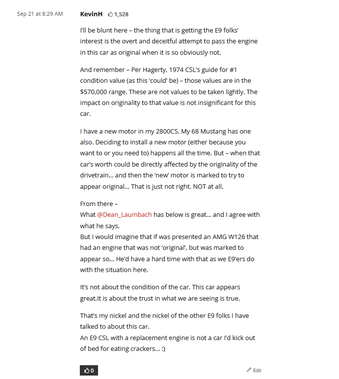

Posting this here before it is flagged for removal:
I would say I feel sorry for the owner of the car here...
But, then I remember the engine VIN thing and... No. Not really much sympathy. They had to have a hand in what went on.
This is too bad. The car could have been presented honestly and forthrightly and received a welcoming response as such.
A 50 year old CSL with a replacement engine is not a car I'd kick out of bed for eating crackers... (don't know why I said that - but it is appropriate here - LOL).
But - the mess this listing has really shows the current reduction in 'the value' of what BaT has become now (IMO anyway).
Will be interesting to see where this one goes.

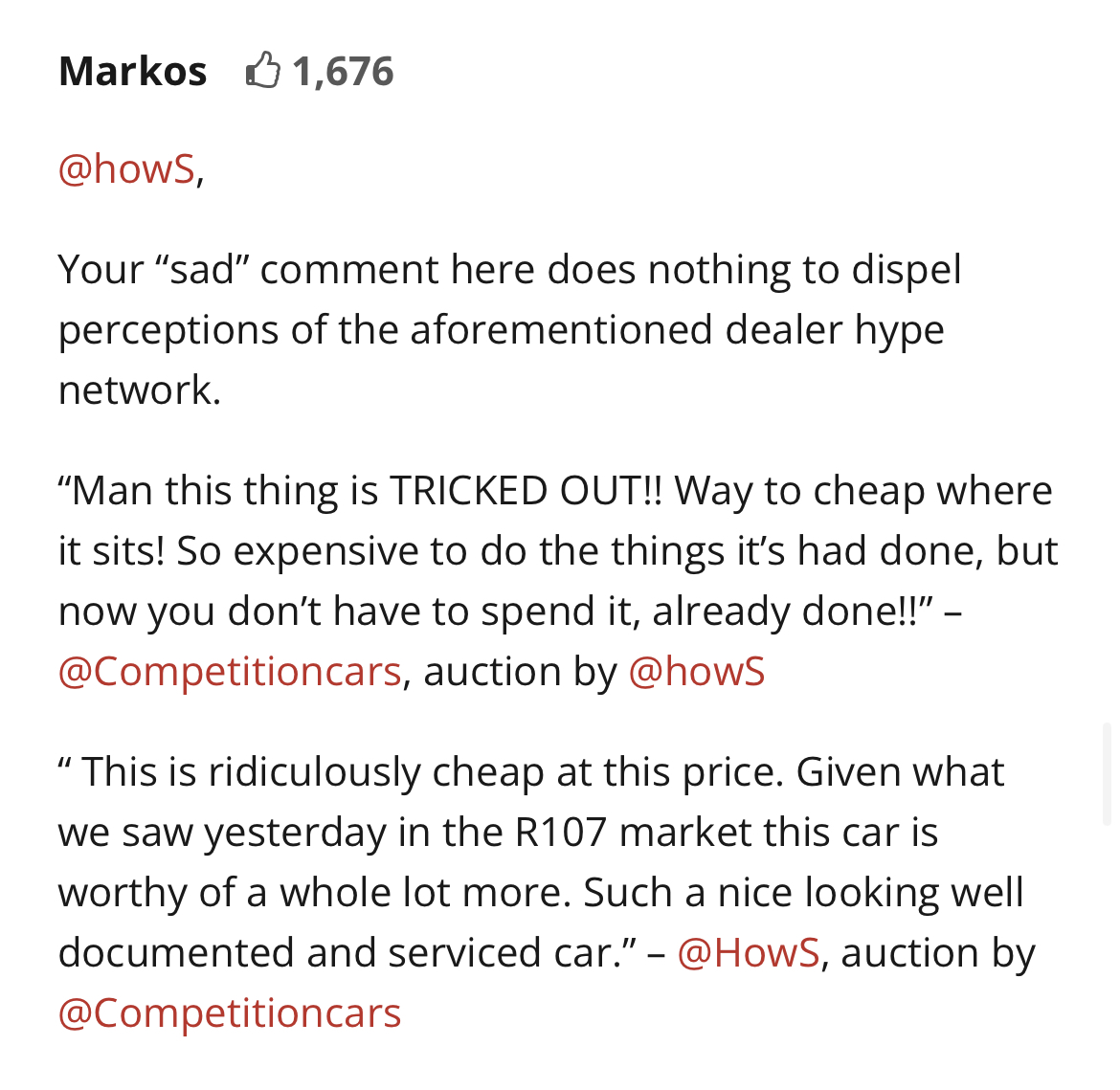

As Markos has done...
In case my comment goes away also....
Which basically says -I will sell anything with wheels and describe it as perfect because I liked driving it.....
Or, perhaps more pointedly, - because I want to make a mint on it and since I am such a god, whatever I claim to like, so should you, the great unwashed -
