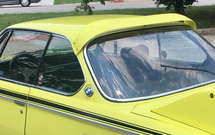

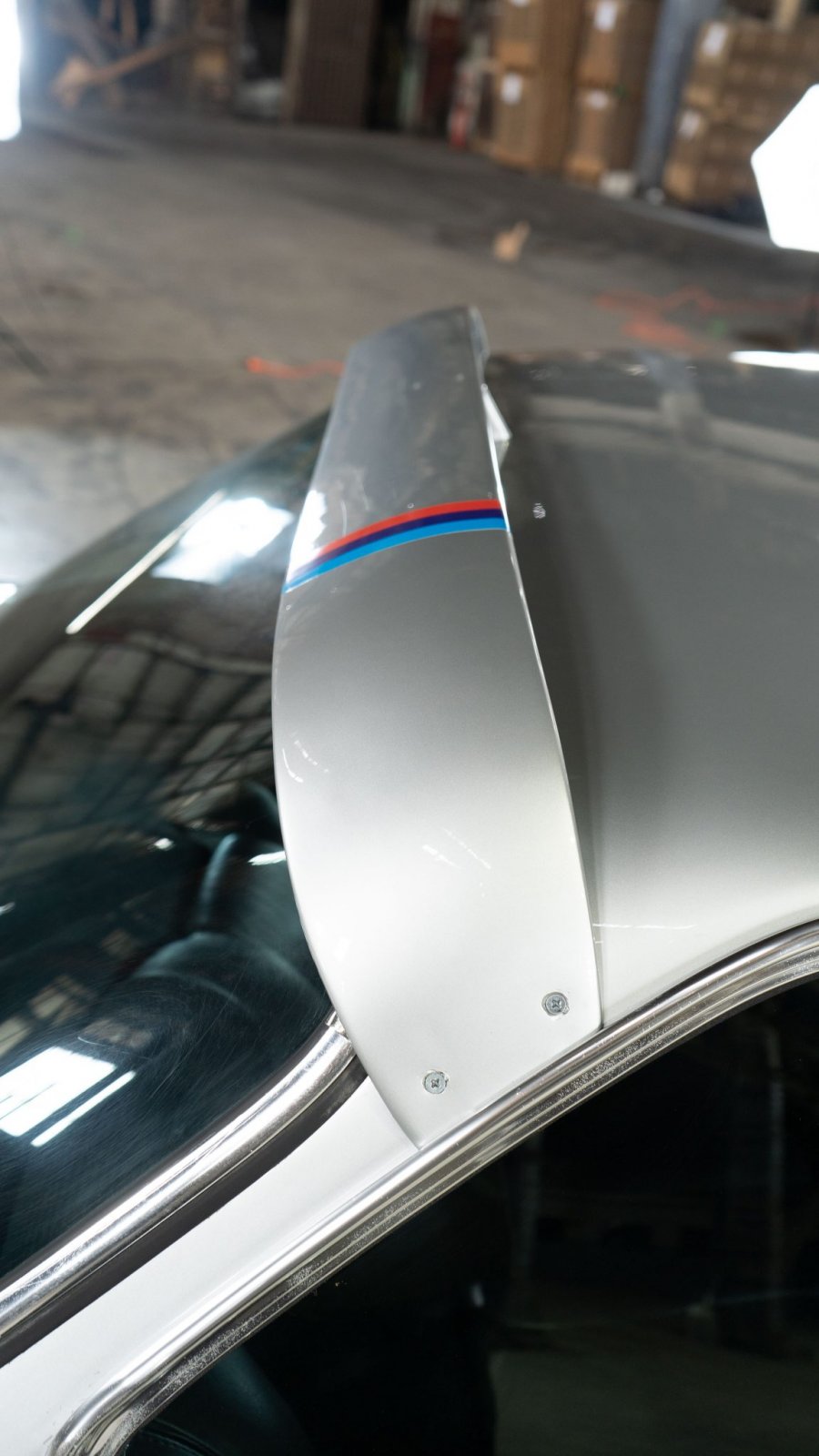

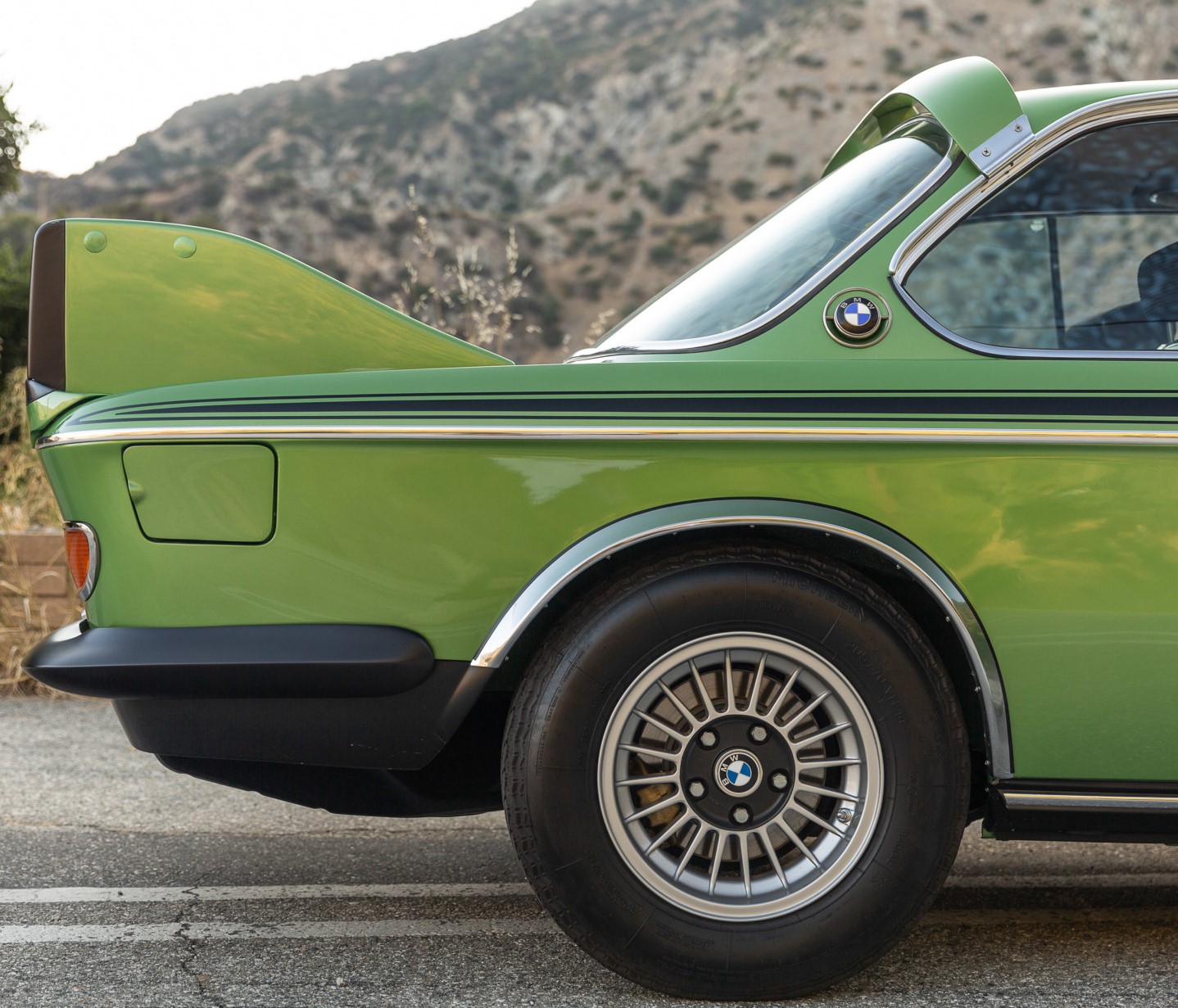

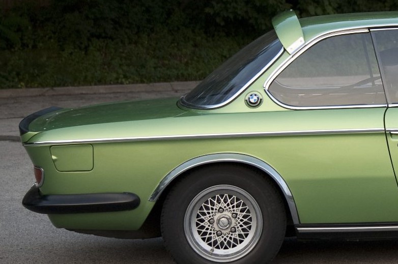

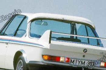

Lots of little things to correct on this car, but this one intrigues me the most. It appears that the hoop is screwed right into the edge roof. It was my assumption based on highly correct batmobiles (not shown below), as well as BMW Info Arvchiv's own photos (shown below), and other Bat examples (shown below) that the roof hoop should be clamped onto the drip rail as seen below. Am I mistaken? Is the hoop still screwed to the roof but has an outer support that is missing here? How about the center post?
BaT: CSL at auction:
BMW Archives:
BMW Archives:

165 - as mentioned, the connection of the rear hoop

The exhaustive list is really really long, but most can be corrected pretty easily.
Agreed in full on the air damn. Perhaps an expert can chime in on series 1, but certainly the series 2 chin should indeed be black (like the wipers haha!). Note the motorsport stripes don’t go limp also.
Also, the brochure has a good pic of the roof hoop clamps:
....but have a look at the photo of 1978. For me it seems this is the same as installed now!?
Thomas
....also have a look at the Werks-Coupes 1975 onwards, same fixing. What I only miss is the centre support.
So what you see is just state of the art, "honi soit qui mal y pense"
Thomas
