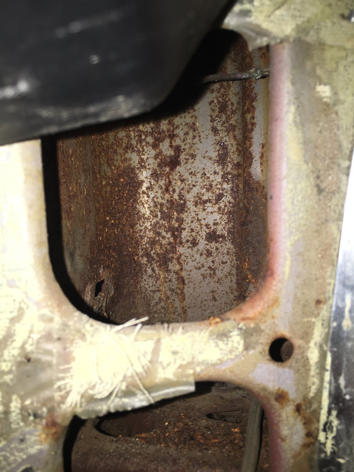

Before this thread fades away. A helpful tip for the serious PPI. If you remove the kick panels on the car, you can clearly see the outward facing side of the a-pillar structure. Inside the fender (with cover plate removed) showed the front, inside the kick panel shows the outside, and the door jamb shows the rear. Point being that it isn’t a mystery area that you can’t examine to a degree before purchasing. What you can’t see well is the bottom corner. That piece is often replaced and you can buy the small section from w&n!.

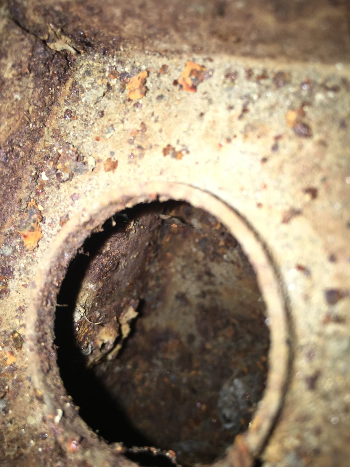

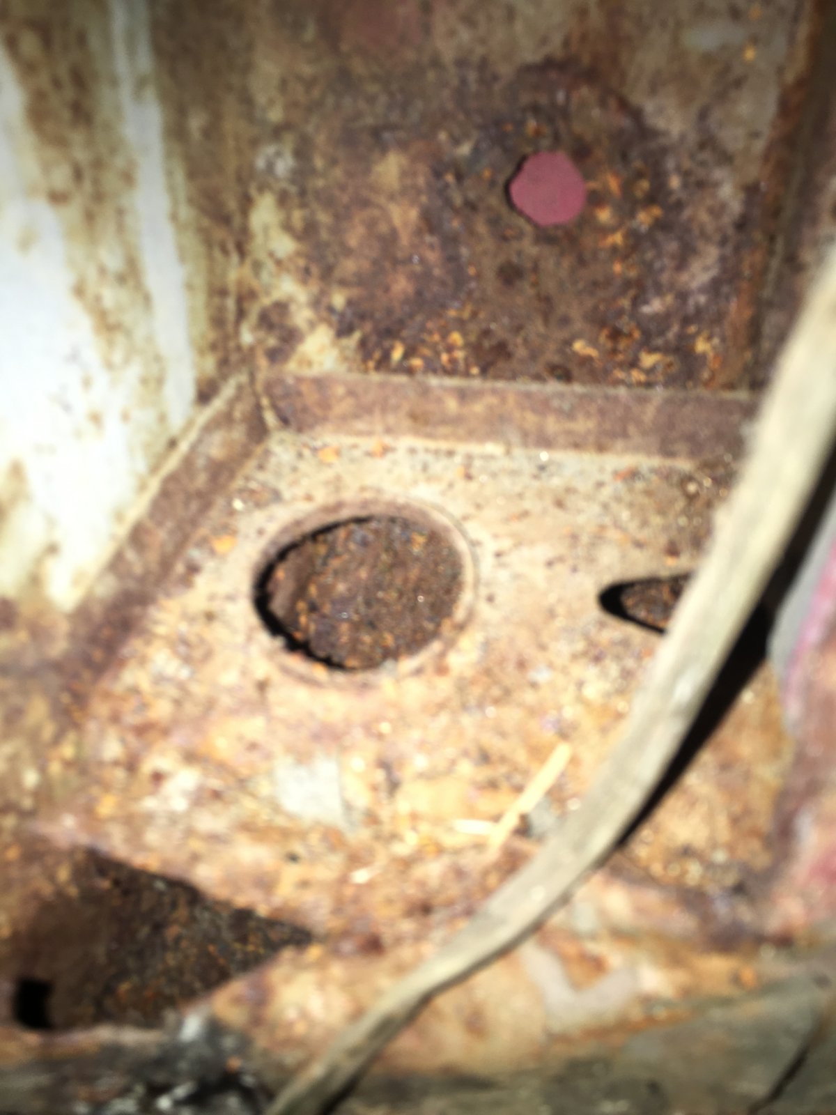

Here is the a-pillar on my rusty project car. The rust seen is surface scale. I’m confident that the lower corner will have structural rust.

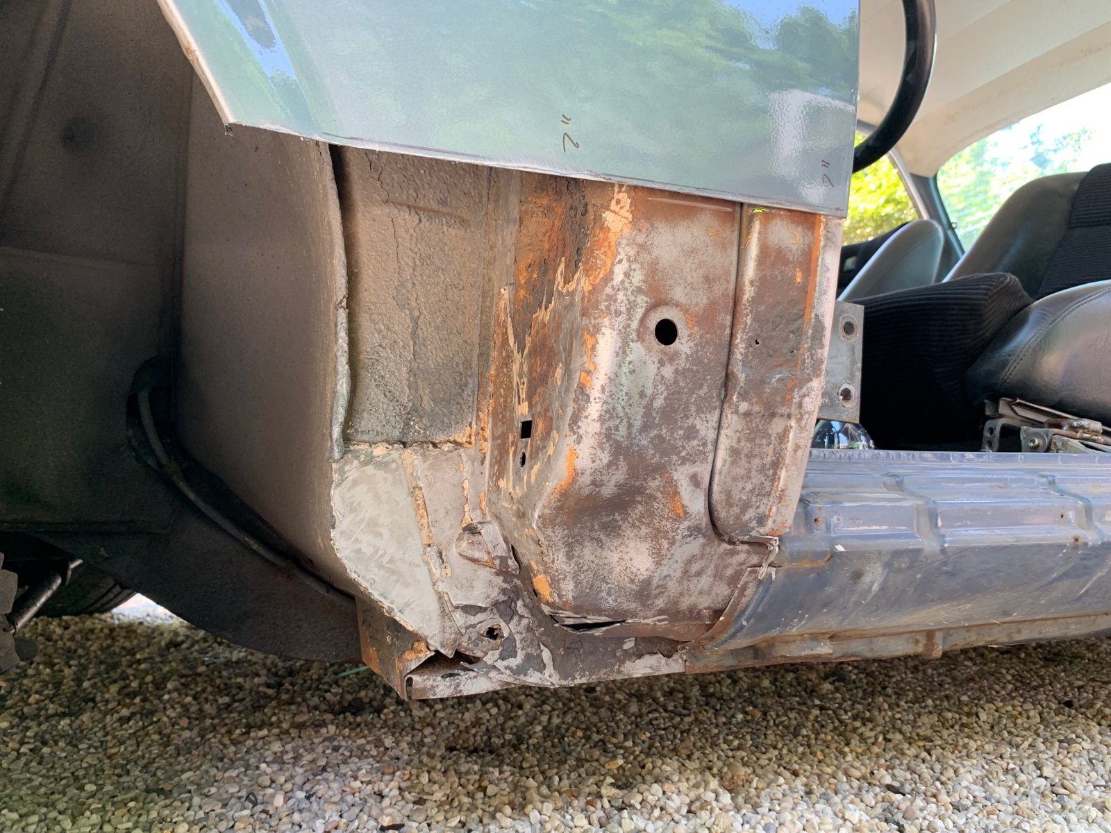

Here is a pic of what we are looking at. Those holes are supposed to be there:

I have a tiny u bubble there on each side. I bought w&n patch panels and I was planning on cutting that lower fender piece just like that last picture. Just to make sure all is sound there and put tons of rust prevention there.
