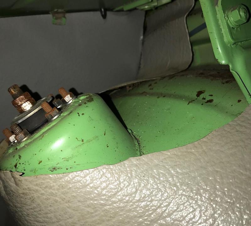

What's going on with this shock tower? That's an odd looking repair.

I noticed that. Looks to me that it blew out. They repaired with a washer from the underside secured with bolts, rather than welding on a new plate.

Which is to say it's not repaired because that top metal is very thin and brittle and it will blow through again at some point
