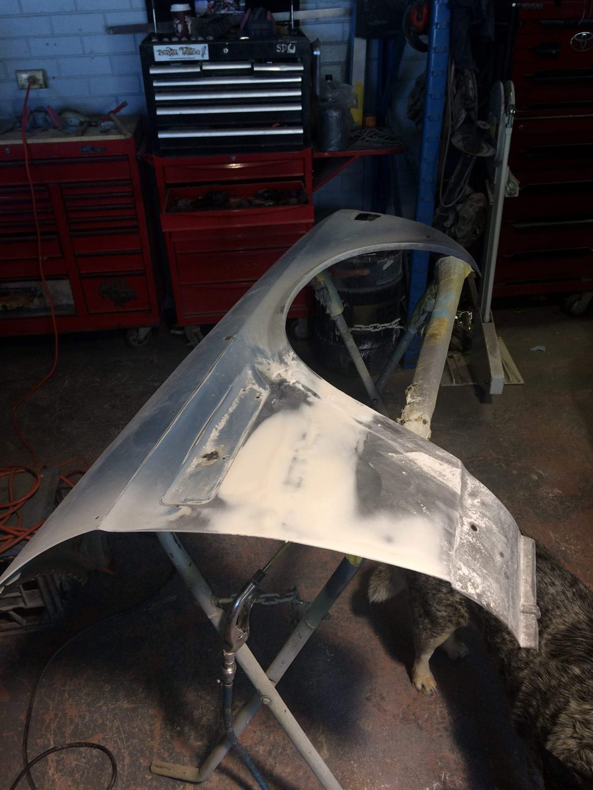

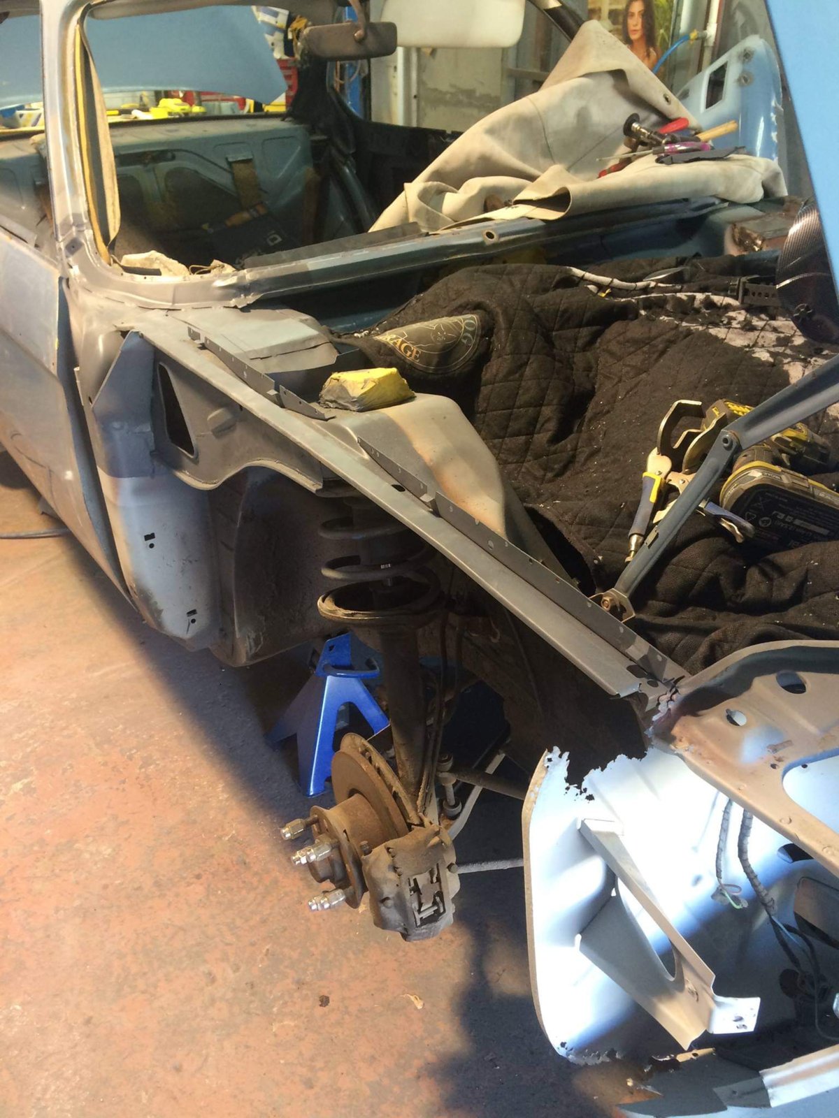

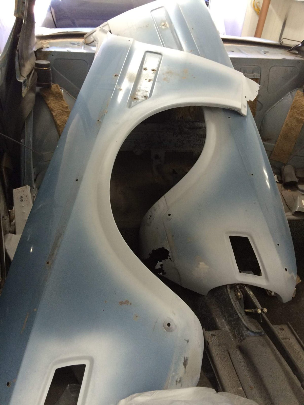

And after a few hours of careful unpicking the fenders were off and remains of the rusted sections removed, no turning back at this point :)
Be carefull about your setup now; as the fenders are part of the load bearing structure, I would advice you to either lighten the load, or support some mass with jack.
There is a risk that you deform the shock tower, and then you will have nearly impossible task to get anywhere near acceptable panel fit.
Cheers Erik, much care with moving and measurements were taken...

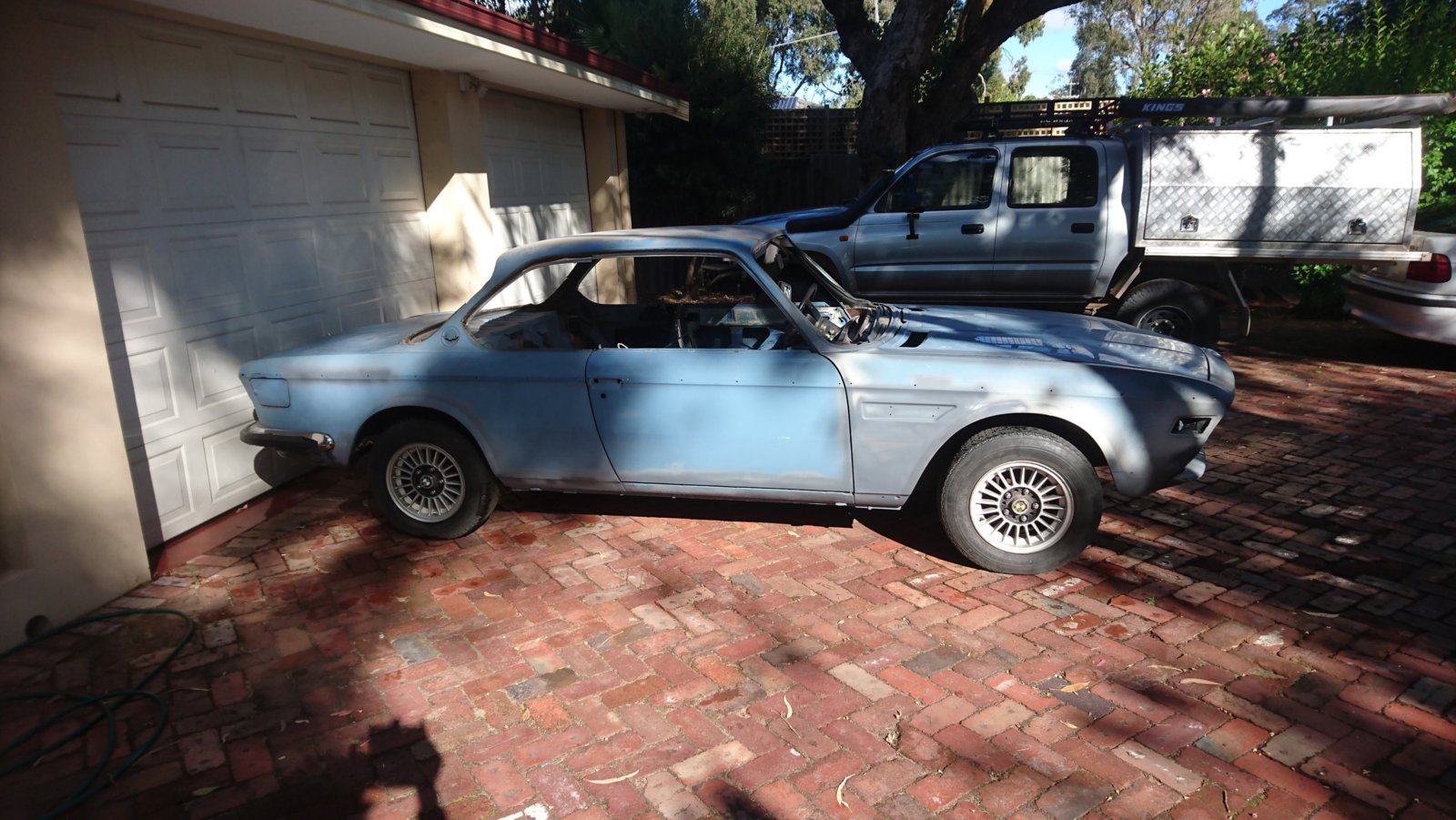

Nice to see another 2.5CSA ... I looks there is very small difference in numbers between Your and mine E9 (<50!) :oops:
Could it be they have been produced same time! o_O
Interesting to see options on your E9:
- rear electric windows (only on demand for 2.5CS)
- automatic gear indicator (no mark of it in my car)
- rear left corner lock (I would expect Alarm switch). It could be even OEM or BMW Garage option
Lack of right mirror and manual from windows is common.
Officially 2.5CS has 14" steel wheels, chrom caps and aluminum rings. I see CSL like rims here (special option?)
Was the car registered in Norway (rear glass sticker) or it was exchanged from the other car?
Have you already check with BMW Classic the VIN?

yes maybe they are brothers ;)
the rear left lock was aftermarket, its gone now...
The BMW 2.5 CS Automatic VIN 4315173 was manufactured on May 30th, 1975 and delivered on June 10th, 1975 to the BMW dealer Müller in Düsseldorf. The original colour was Pastellblau, paint code 044.

As for the Norge Sticker, I never got to the bottom of that , maybe it moved up there at some stage , maybe just a tourist sticker...
