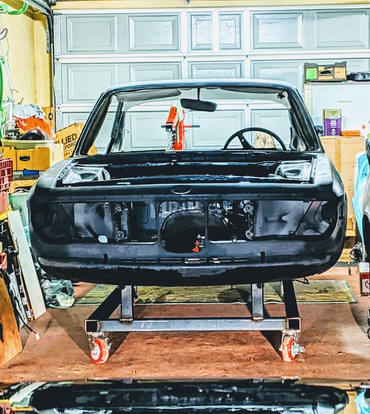

was good to get it all lined back up, but that was really just the first stage, now the real strip down starts.
I had to keep the car more complete for longer than I wanted to while I made some space at home for the full disassembly...
Those who have done this know just how much space a car takes up when it comes fully apart !
I've submerged myself even further into the abyss with multiple cars at different levels of stripped and boxes on top of boxes of bits and pieces getting mixed up and the pain of spending an hour trying to find that one Bolt...
Even with extensive photo taking, labelling and storage of everything we all still have the most simple things sometimes slip through the net......

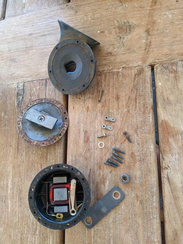

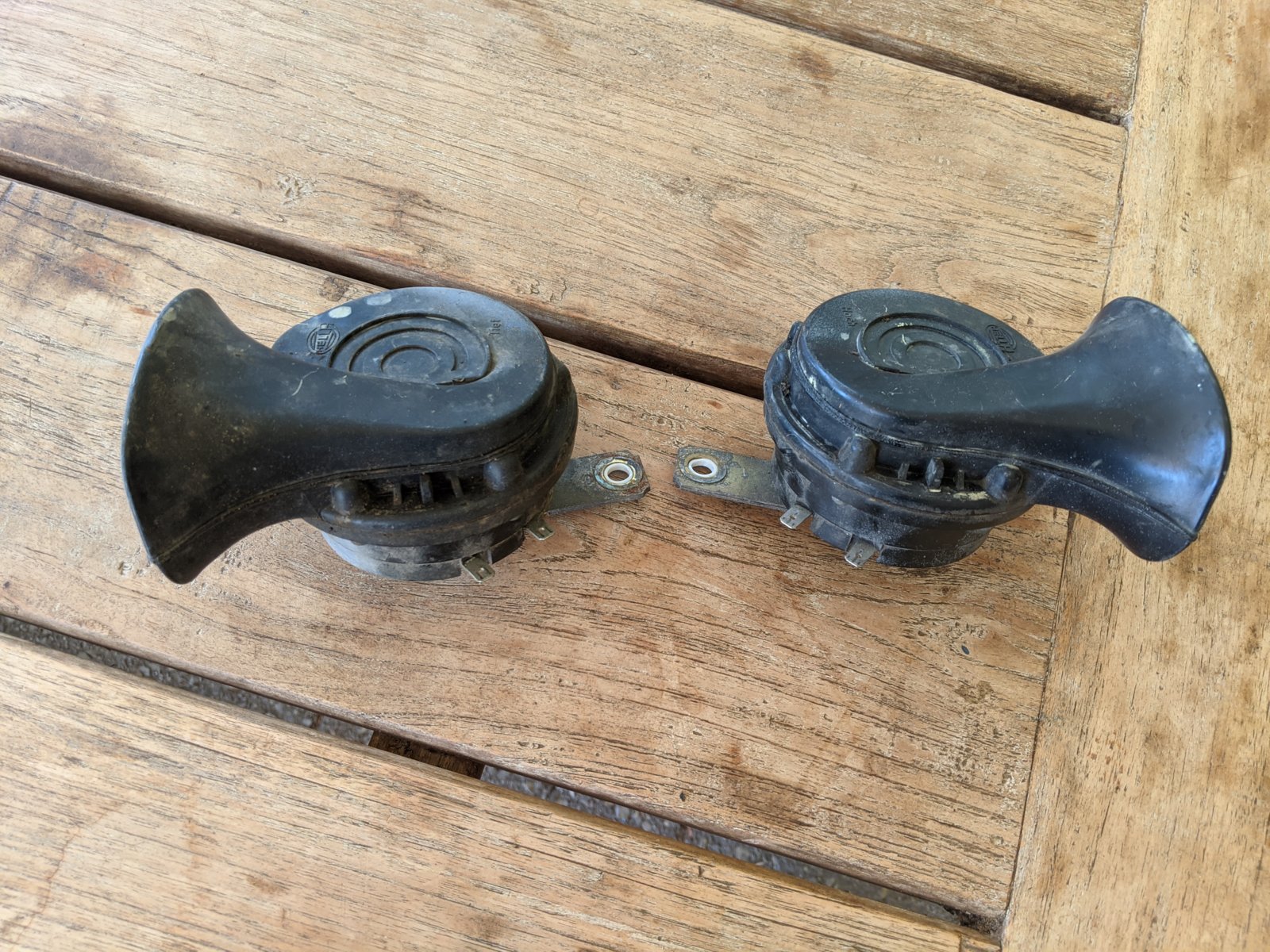

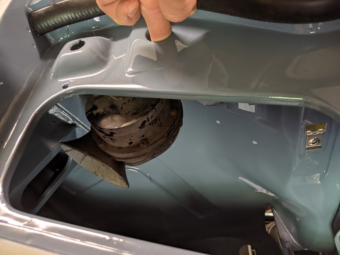

Horns !

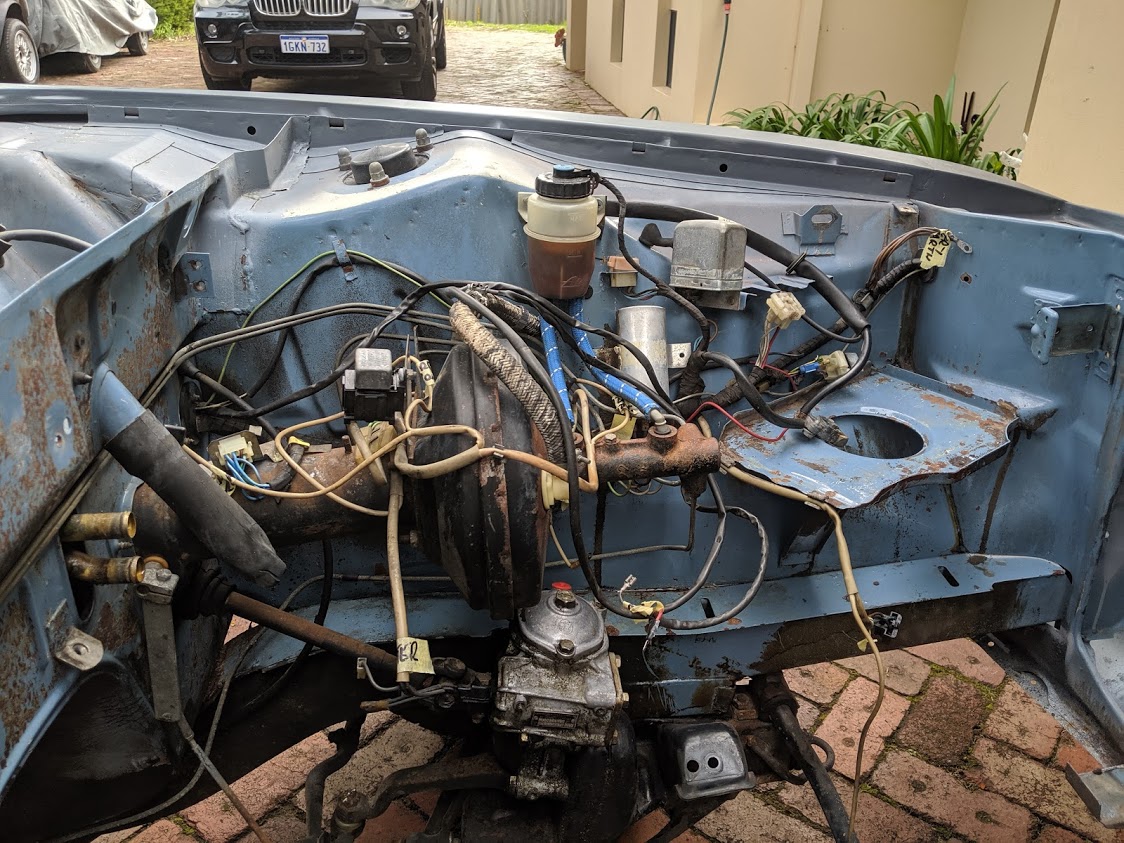

Where the hell do the horns mount ??
Somehow I have no pic with the grills out and horns in place, I'm assuming somewhere in front of the radiator but I don't want to just guess.
Like I said - The simplest of things !
For anyone getting stressed by the above pic,
Don't worry they aren't going back on the car looking like that !
Refurb / Deep Clean first of course...

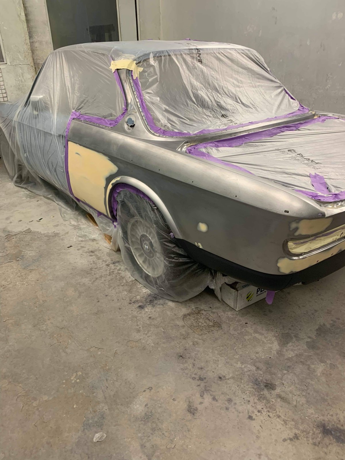

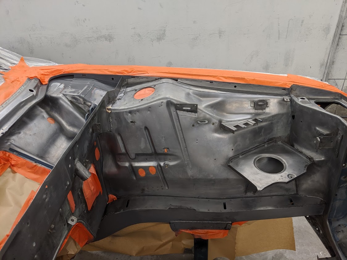

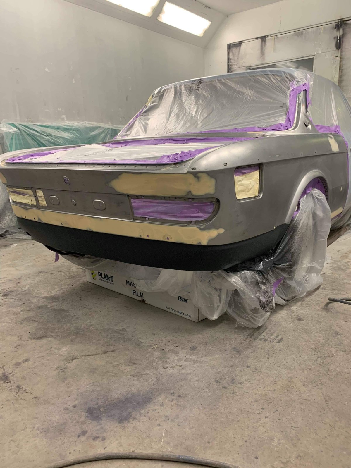

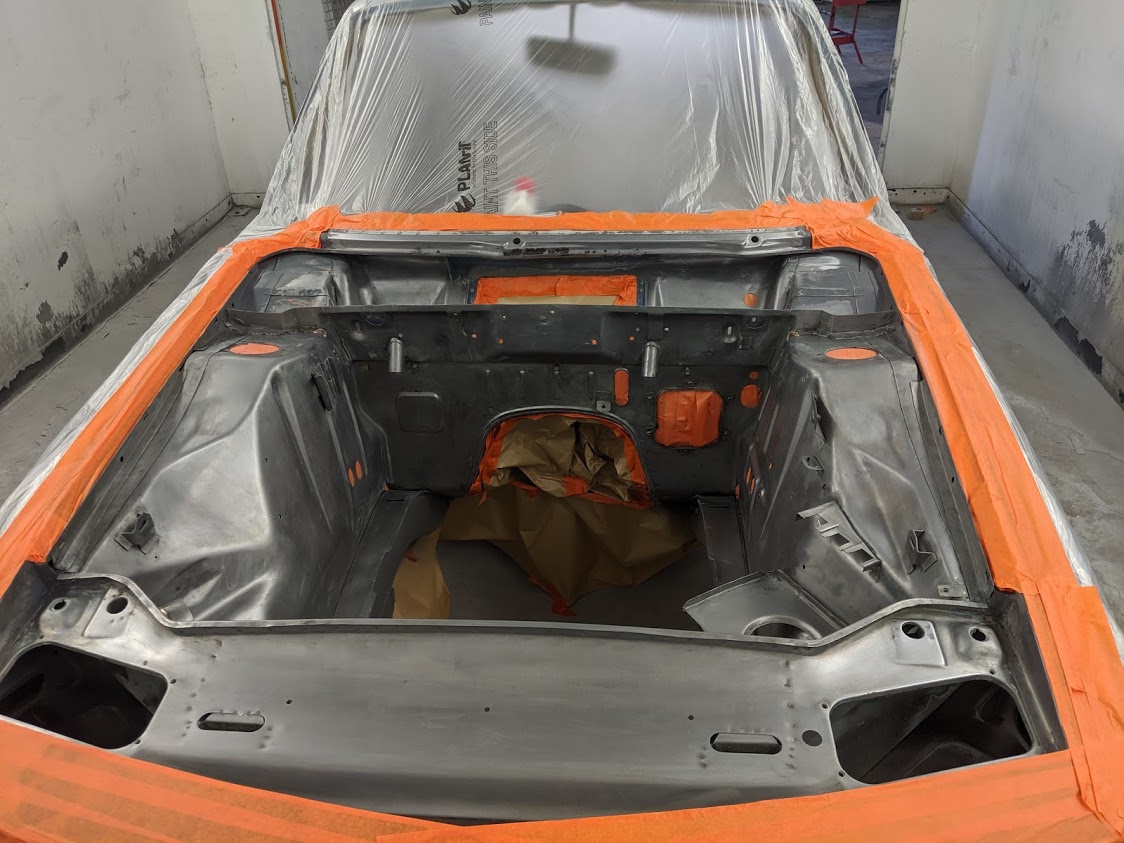

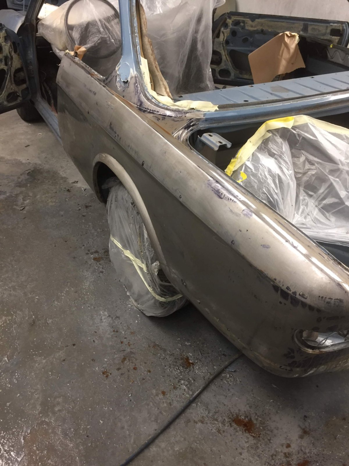

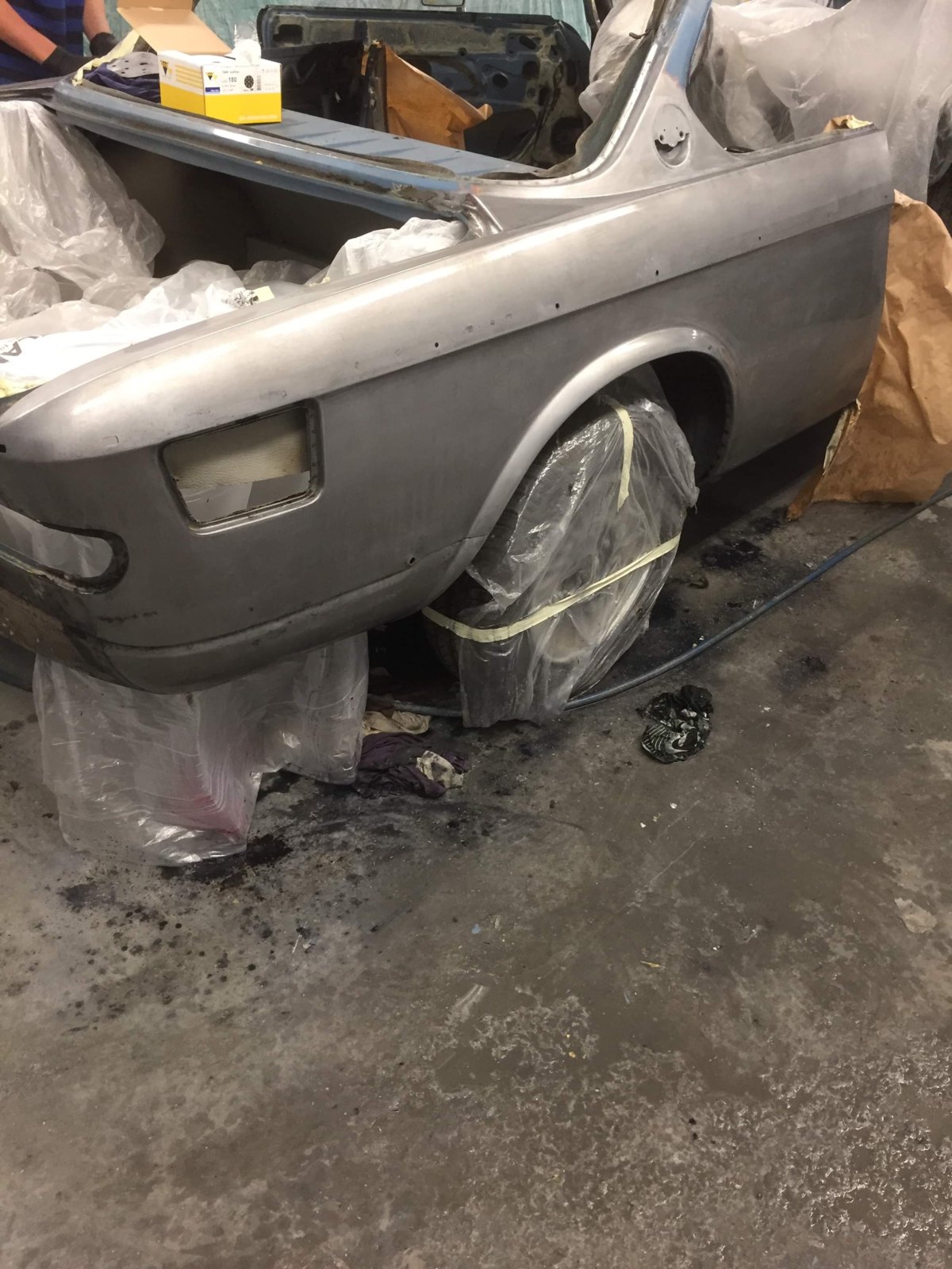

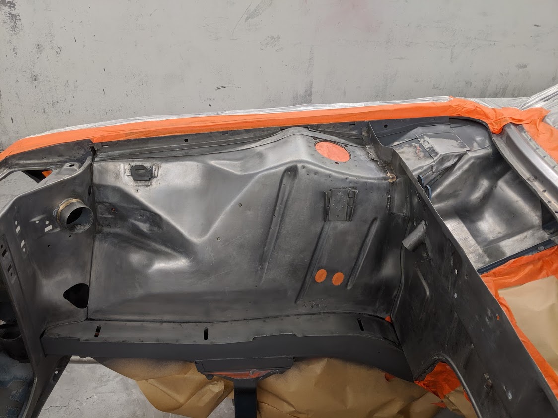

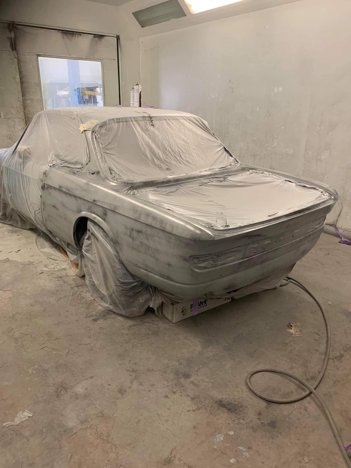

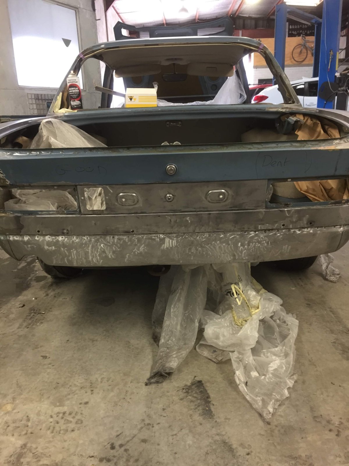

okay moving forward on the catch up we are on to some bodywork and paint prep..
I was soon approaching a stage that I knew would be hugely rewarding, but at a cost.. blood sweat and tears here we come :oops:

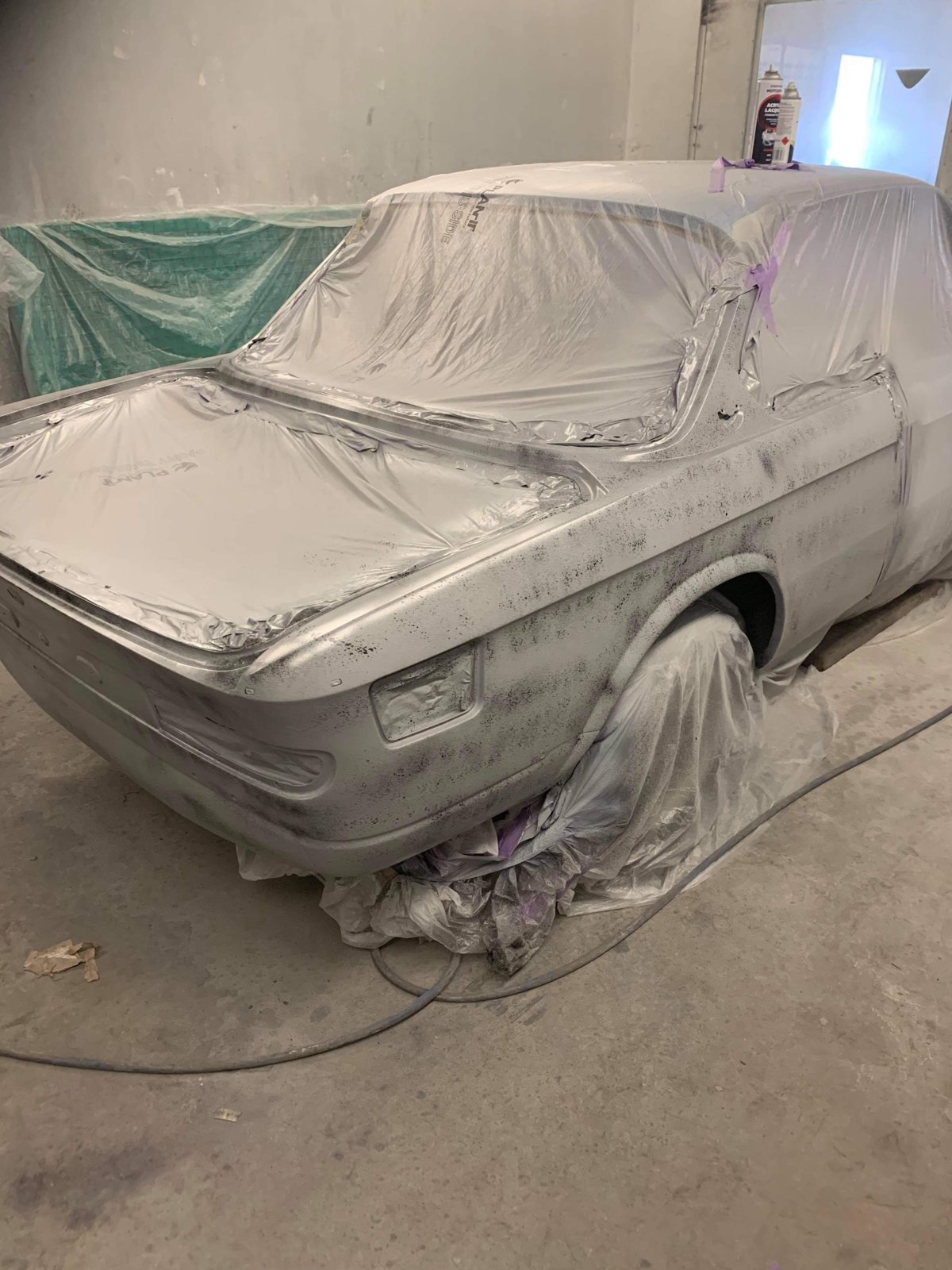

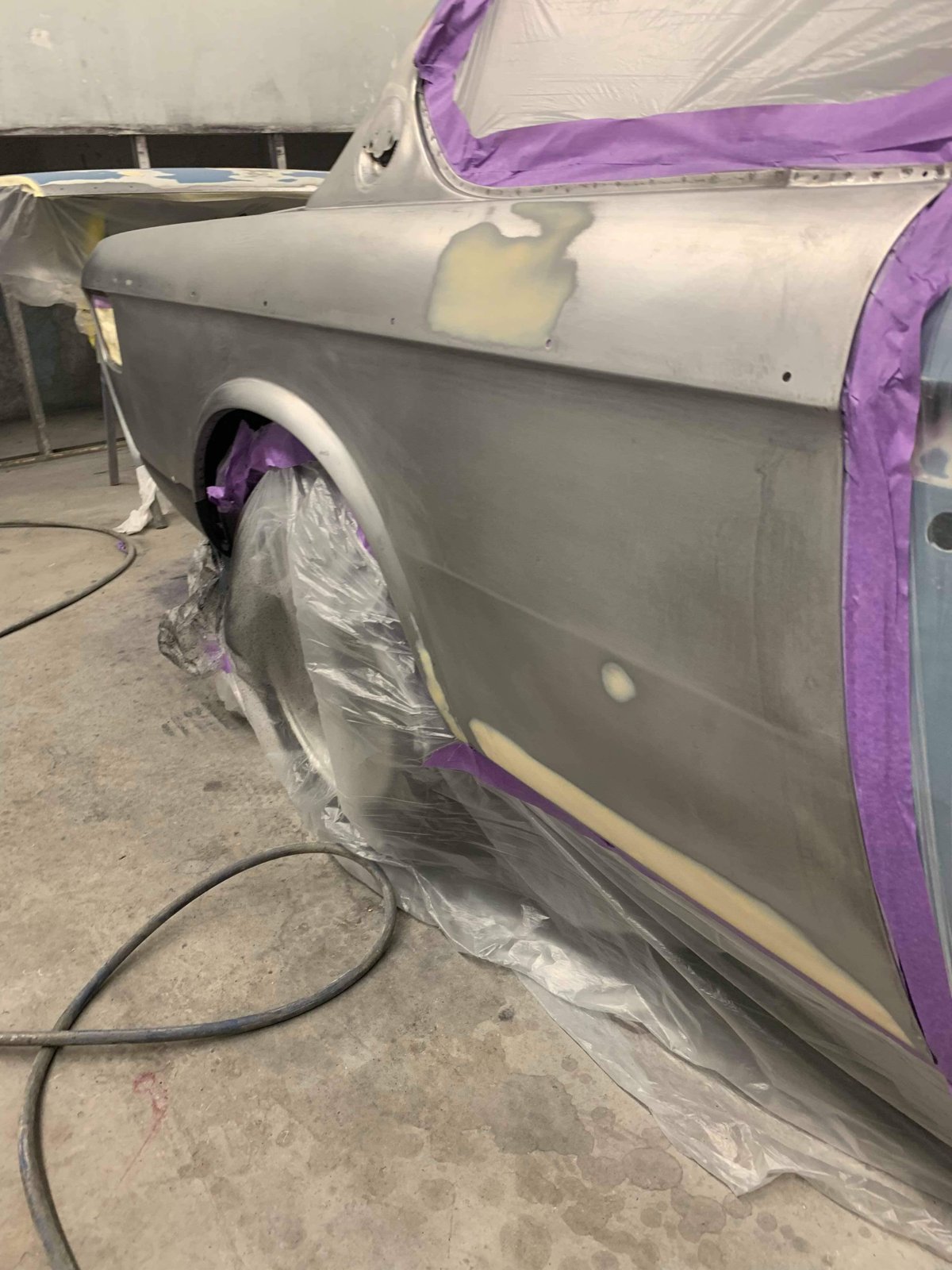

While she was still on wheels and easy to move around we took the opportunity to start the outer body prep, my good mate Glenn was heavily involved with this and made some quick progress.
The condition of the body work was very pleasing, I was over the moon with just how straight it all was and the lightest skims of filler here n there was all that was required
New Stone chip applied...
Nice to see your car in on a way to be driven.
I was told once putty should not to be applied on bare metal as it has acid like PH and what is even more it is hygroscopic. As a result it is making a rust source under the paint of potential bubling. I still expetriencing many body shops doing the same over years.
I have had a "pleasure" to discover such a hidden (under paint) rust. It ended up in removal of the whole panel...
But maybe this is some new super generation of putty which can be applied directly on a steel. I hope so for you.
Etch primed first mate

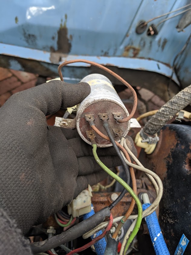

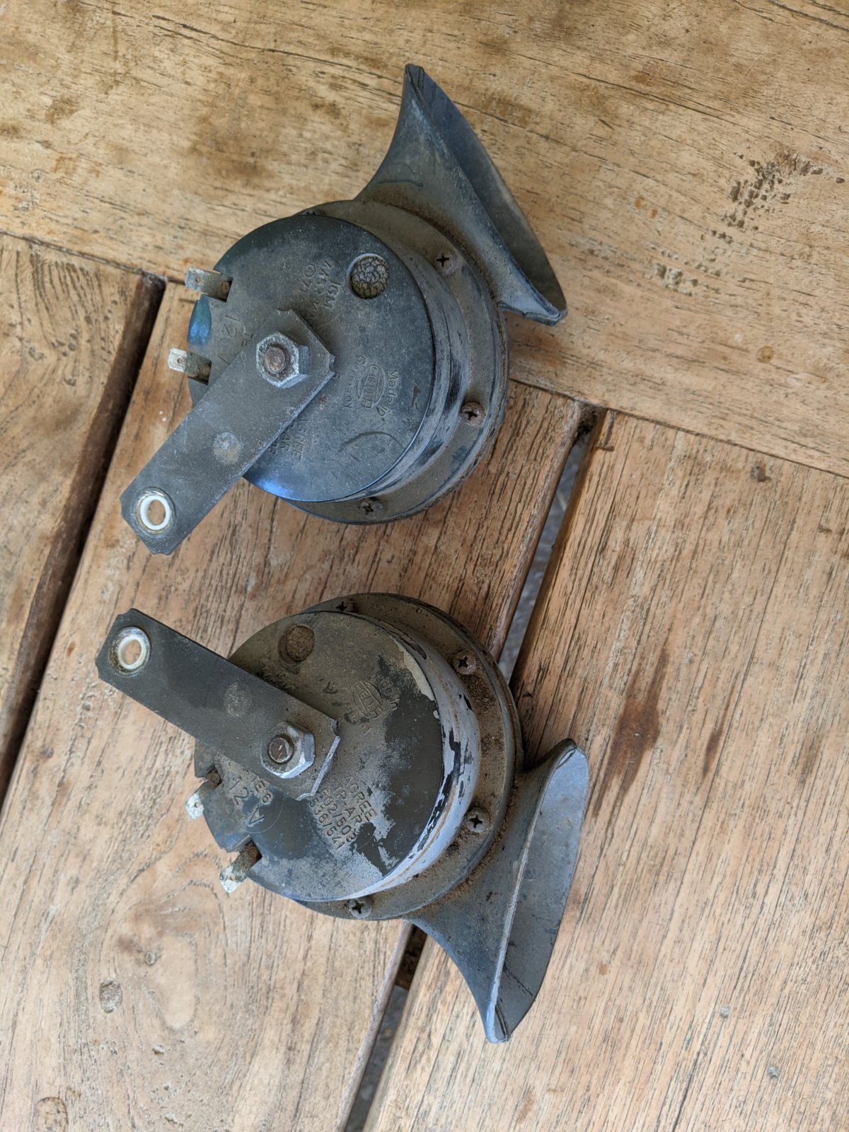

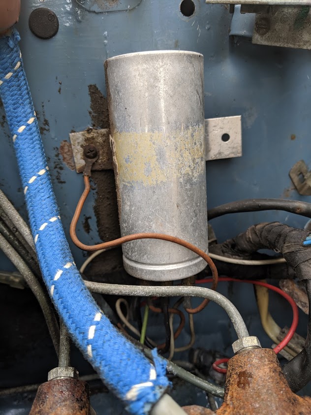

Some help please,
What is this ??
Also, is that where it should be mounted ?

Connector with a plug is a diagnostic socket. It was used at BMW Service to check basic electric parameters related to starting, running and charging.
