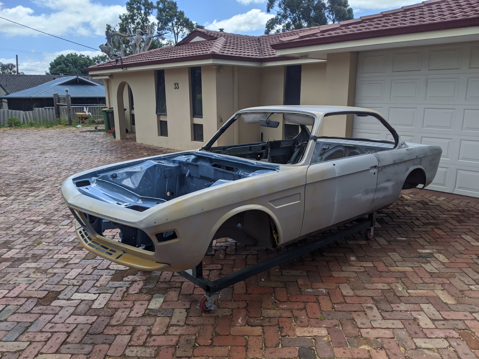

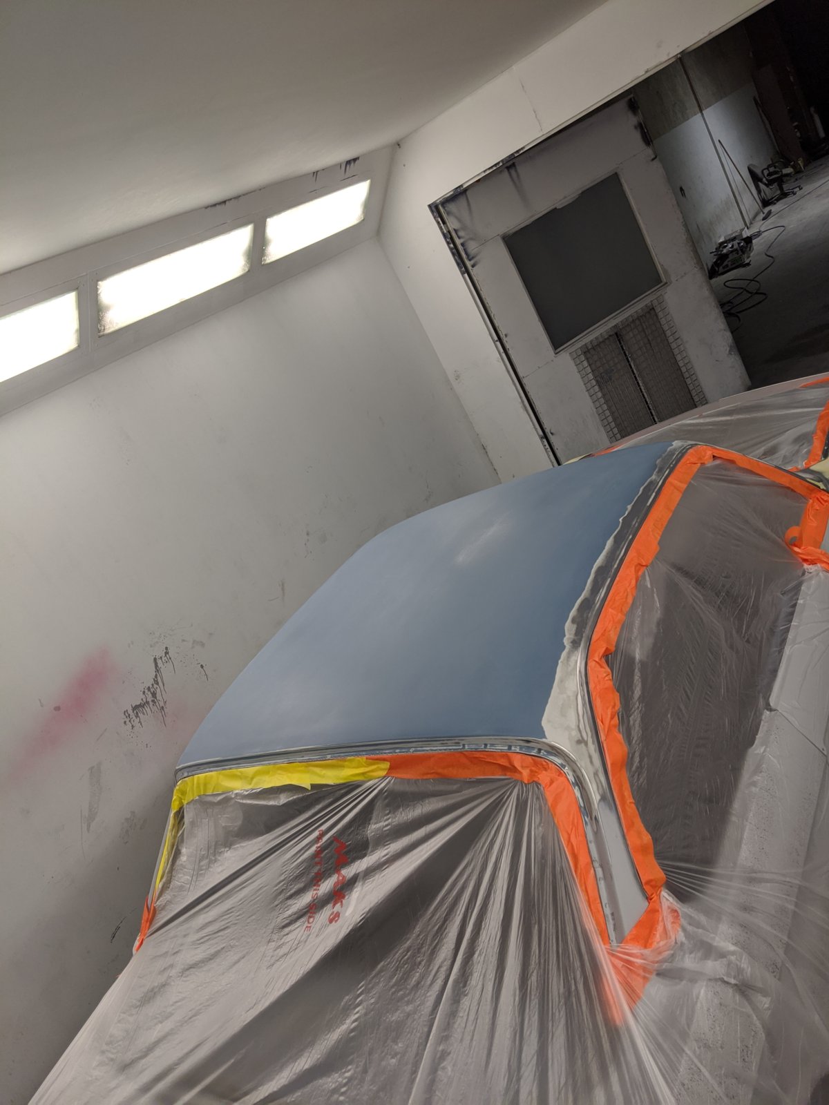

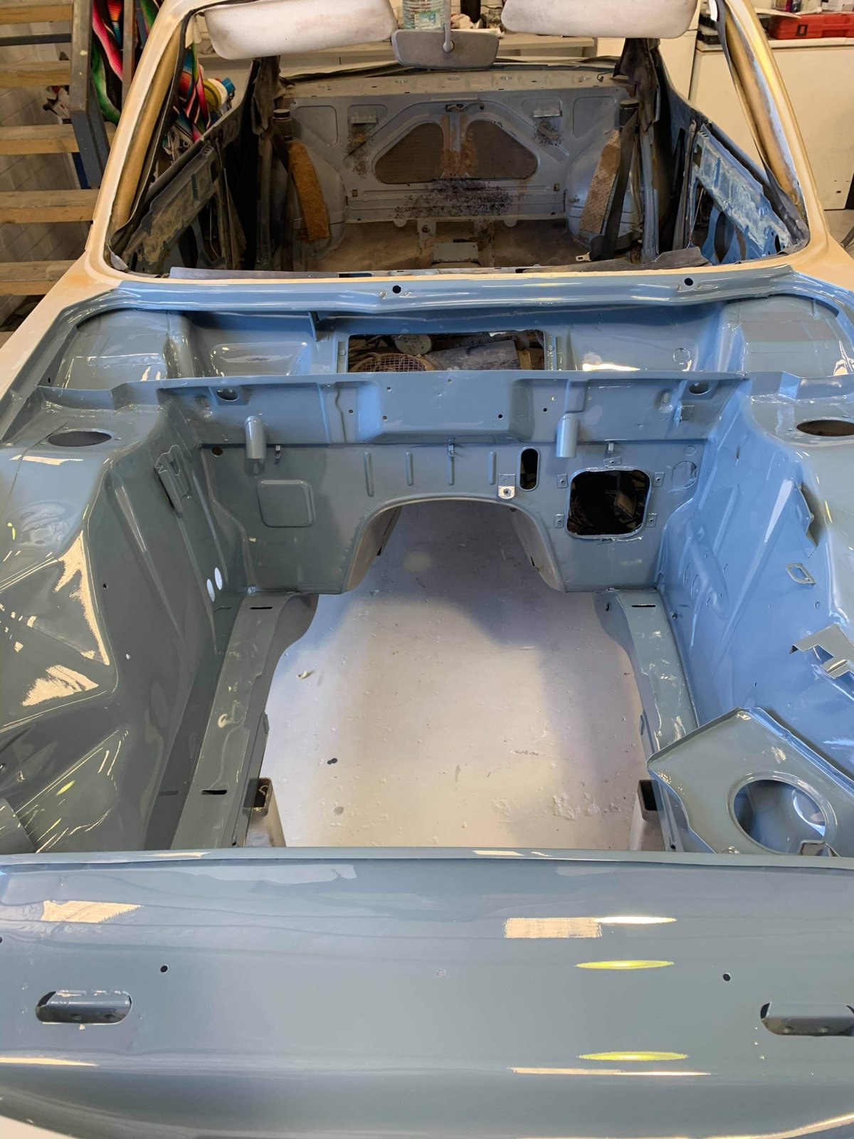

1975 Pastell Blau 2.5 CS

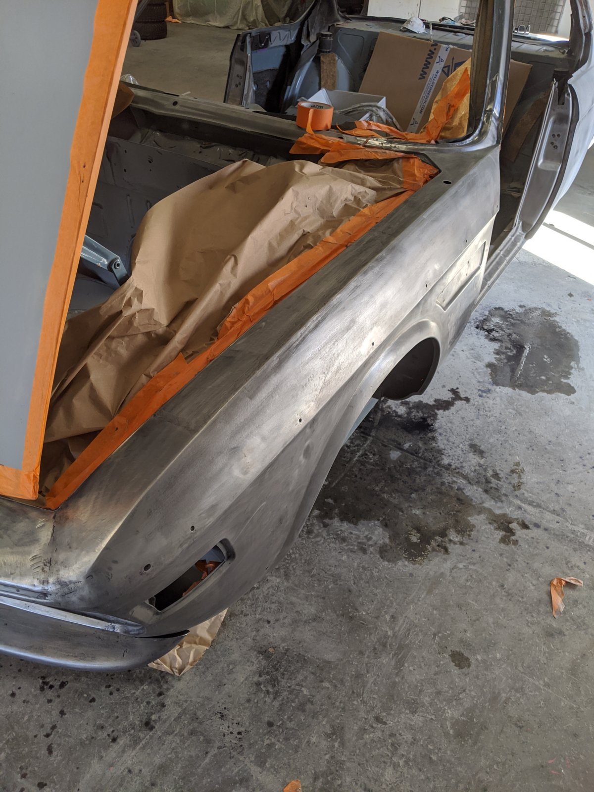

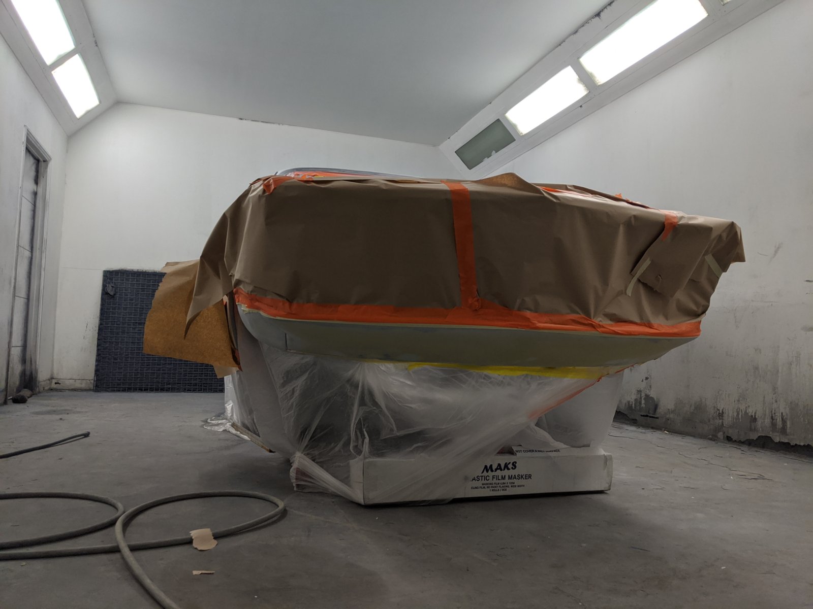

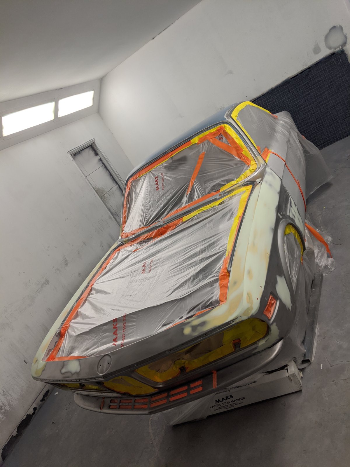

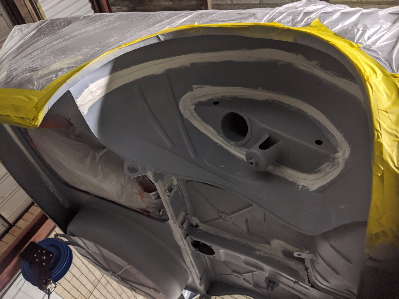

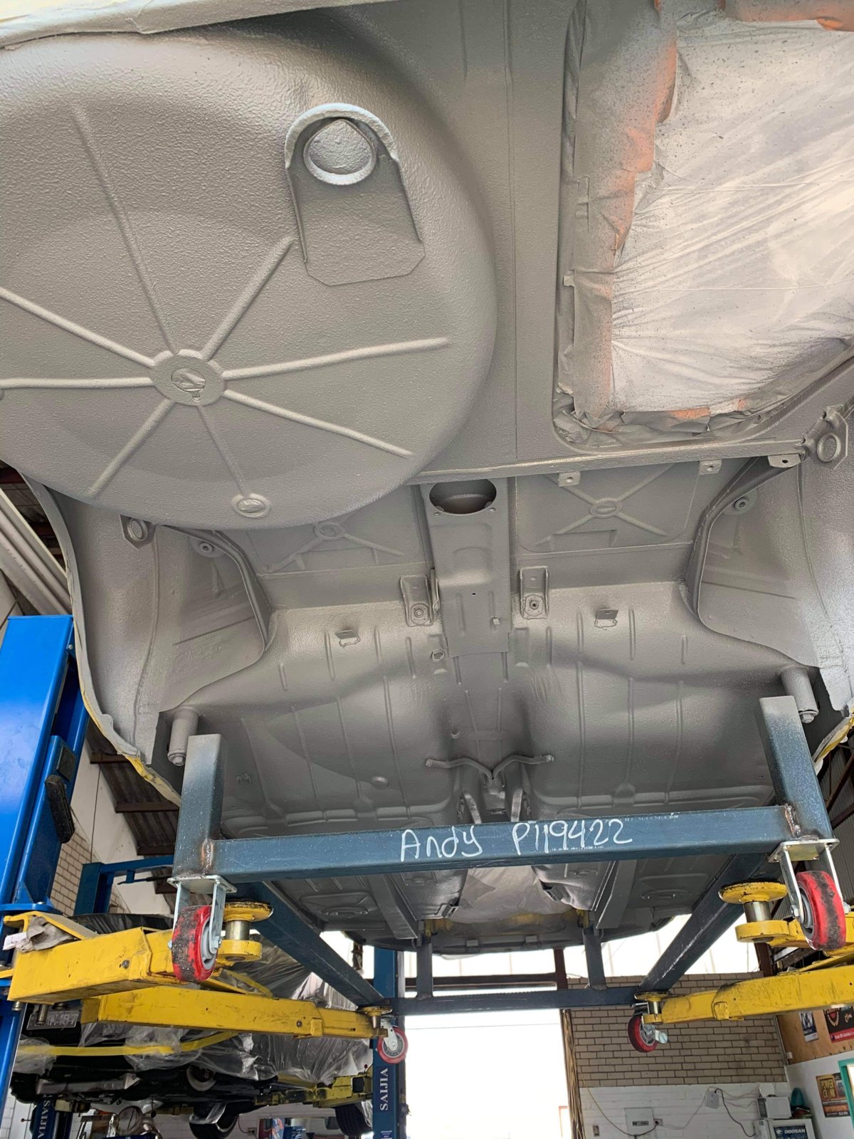

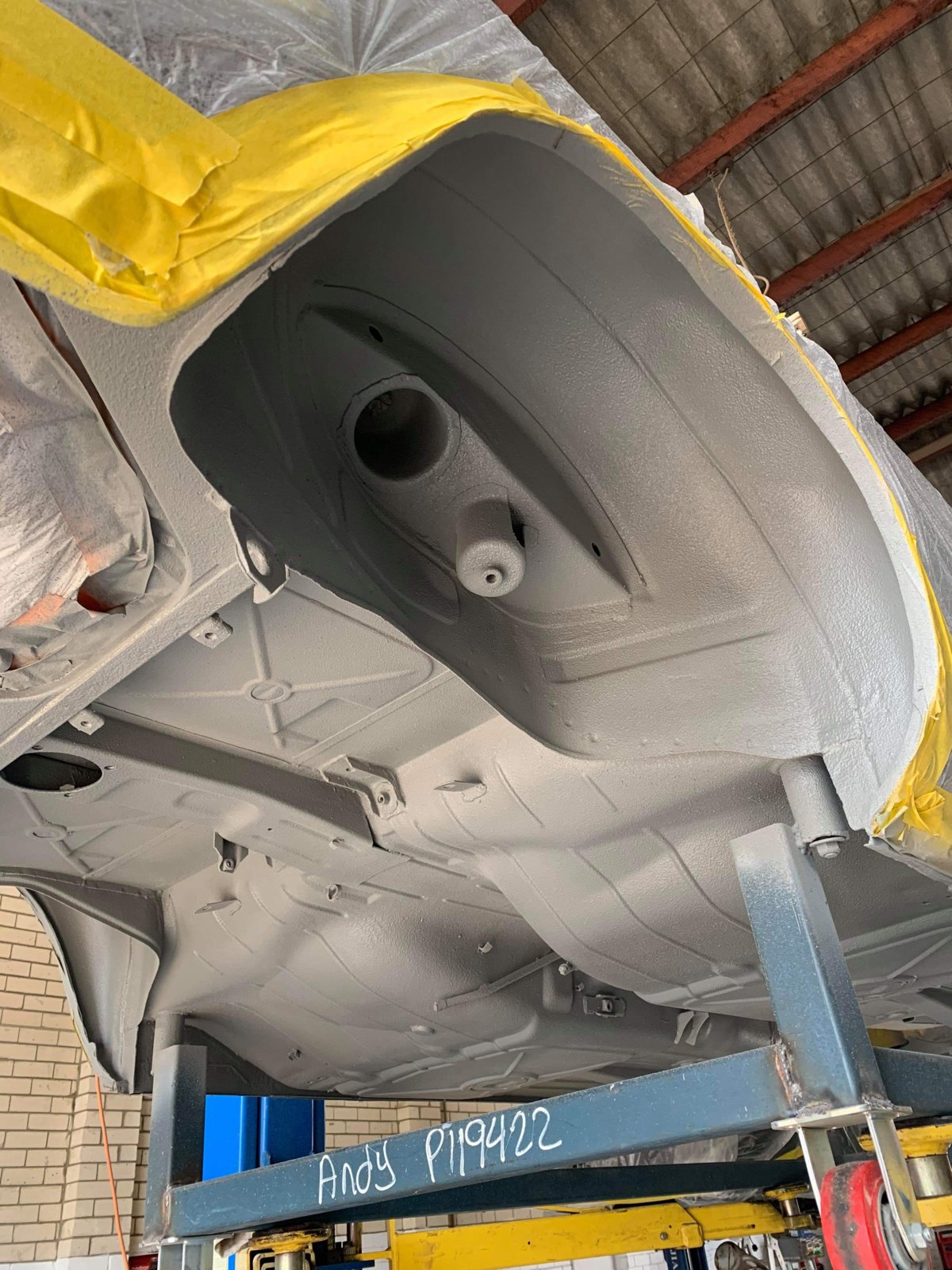

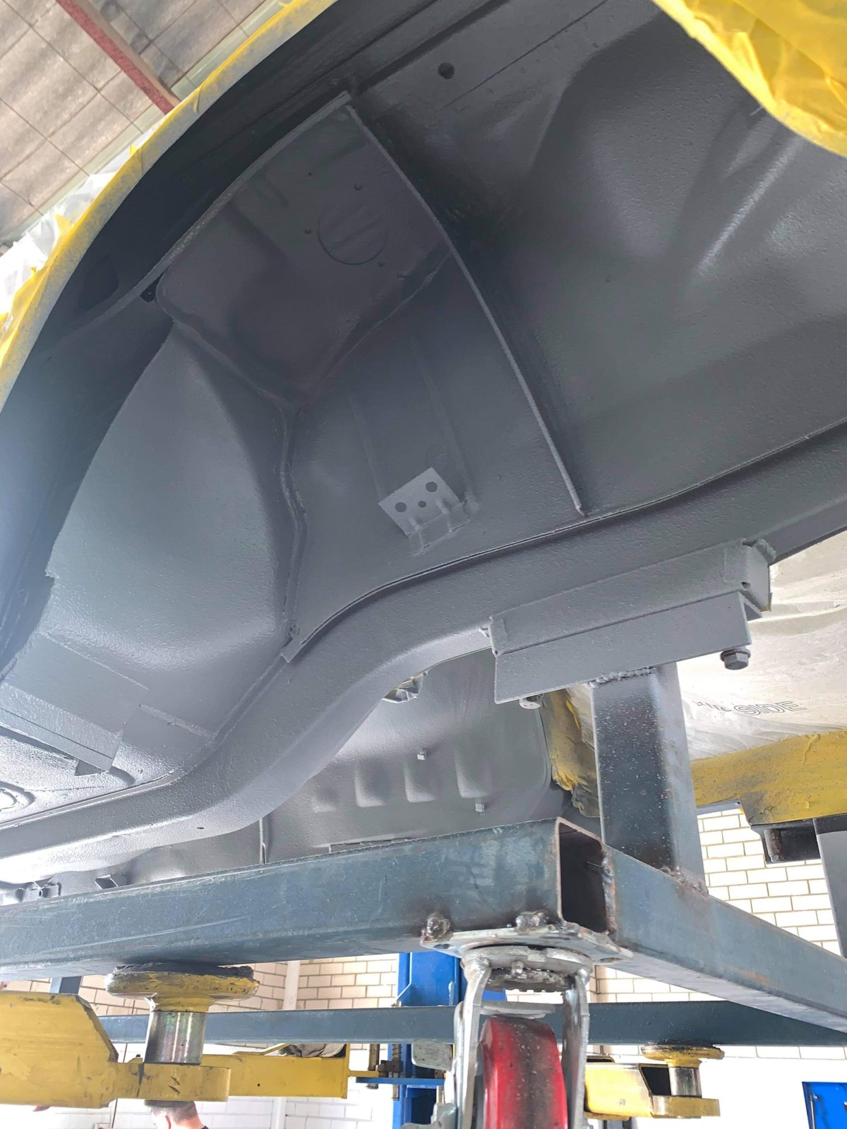

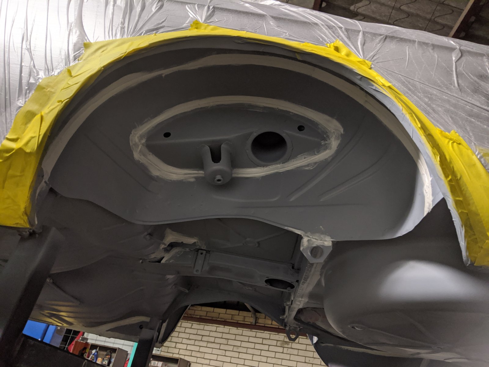

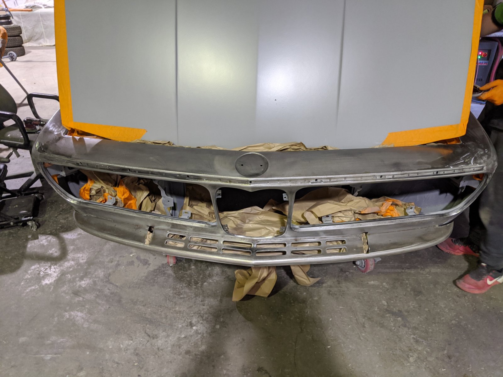

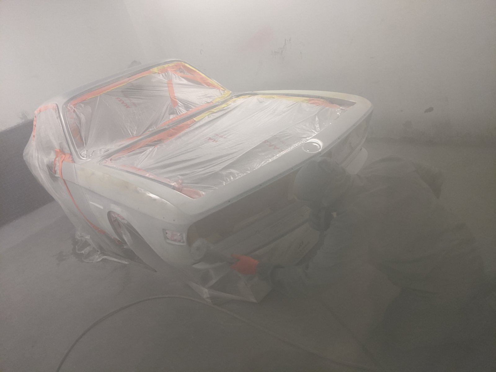

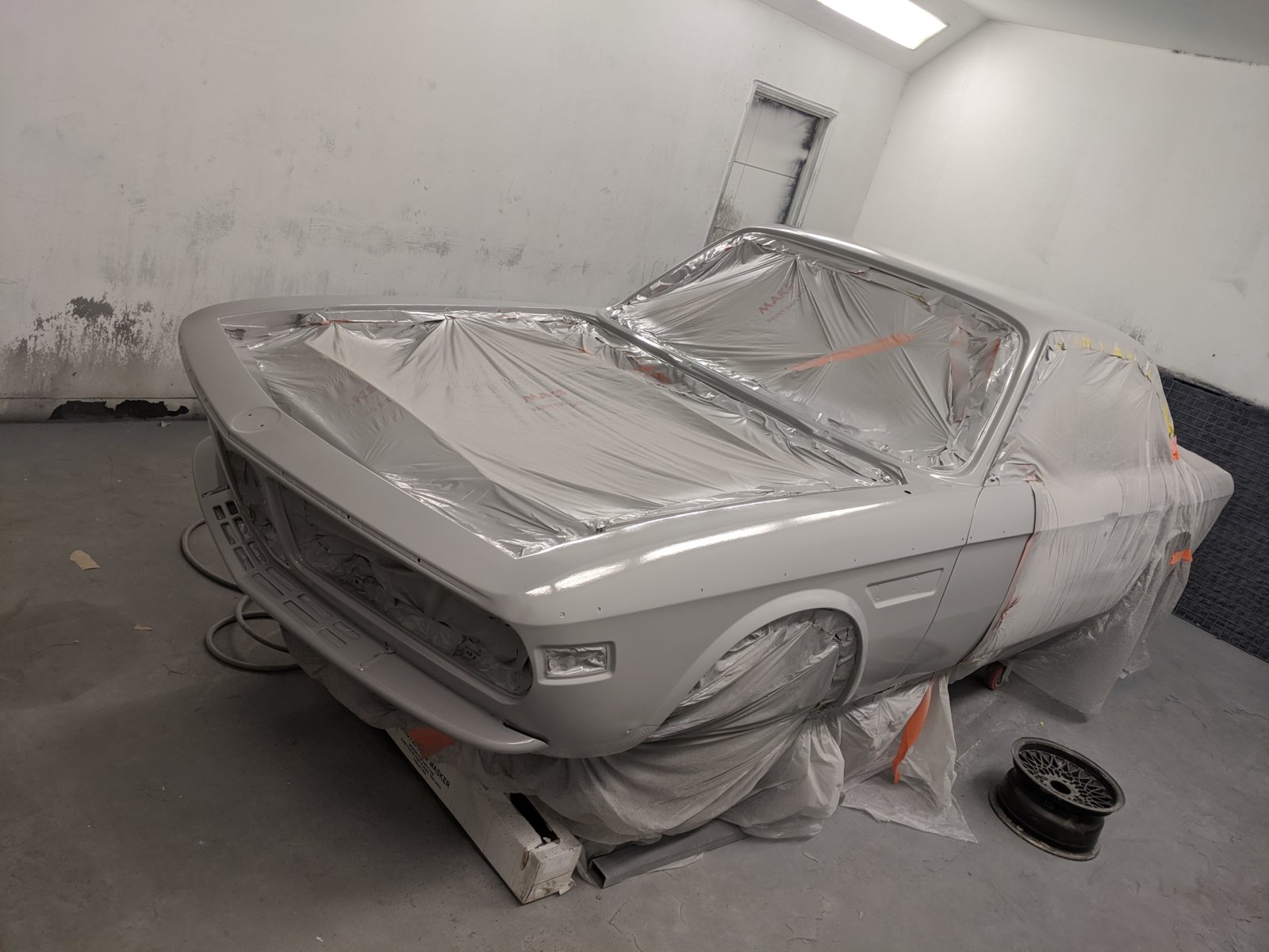

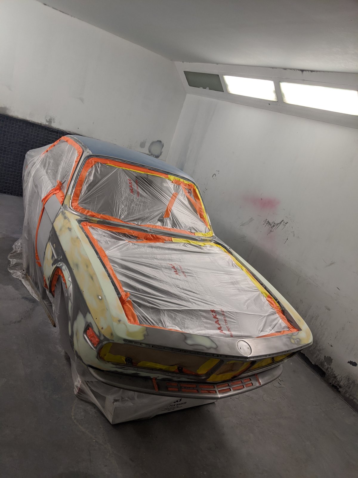

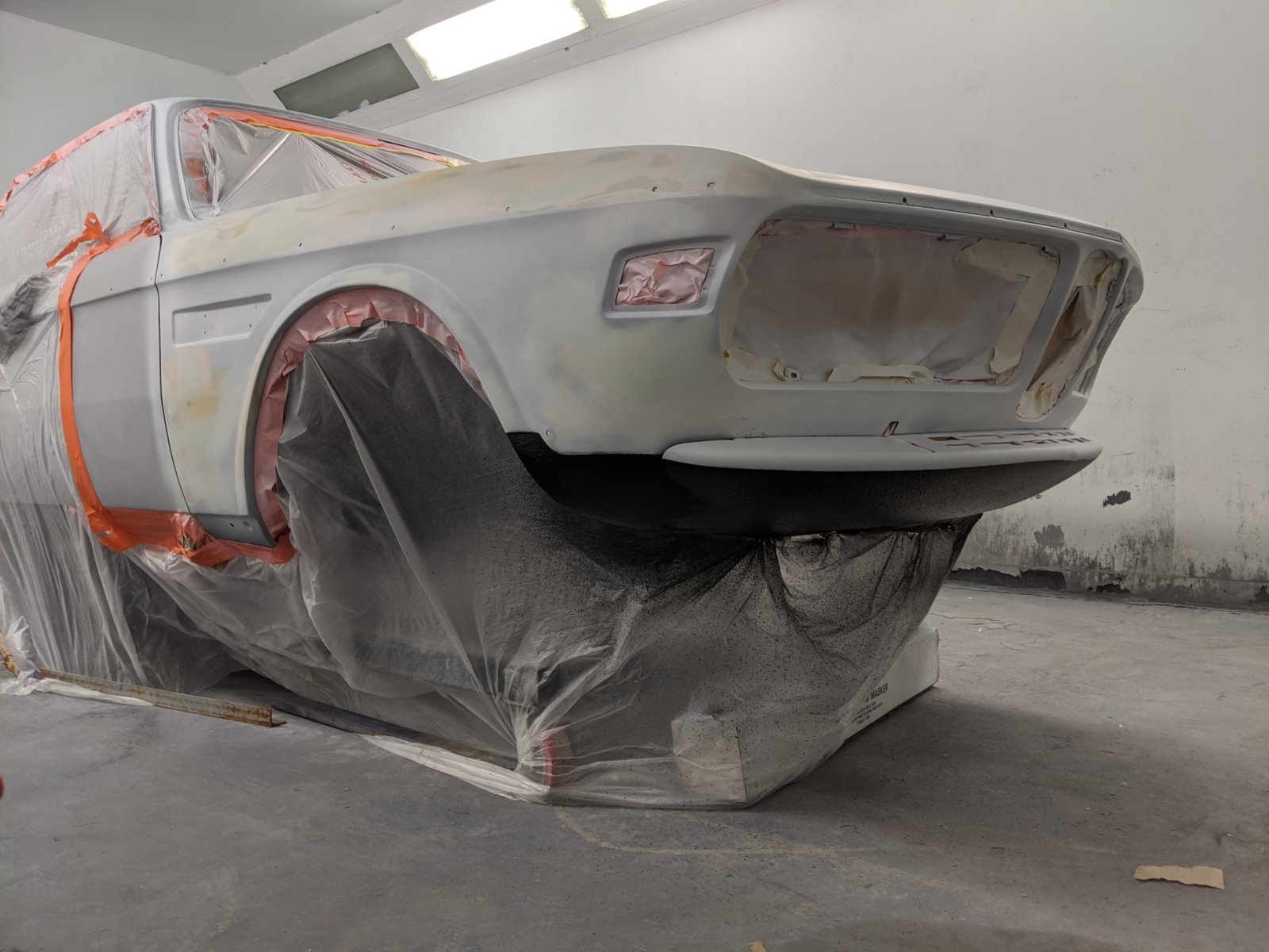

Then etch, sanding, high build primer, sanding, seam sealer and more primer....

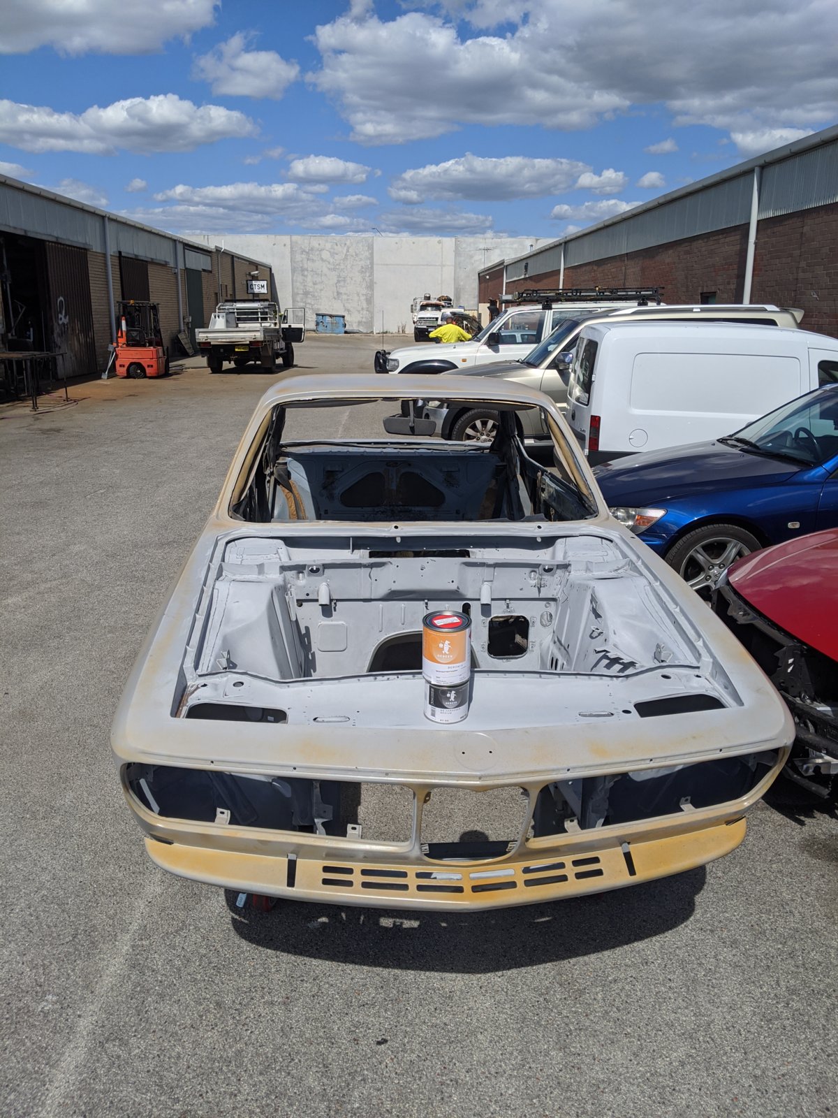

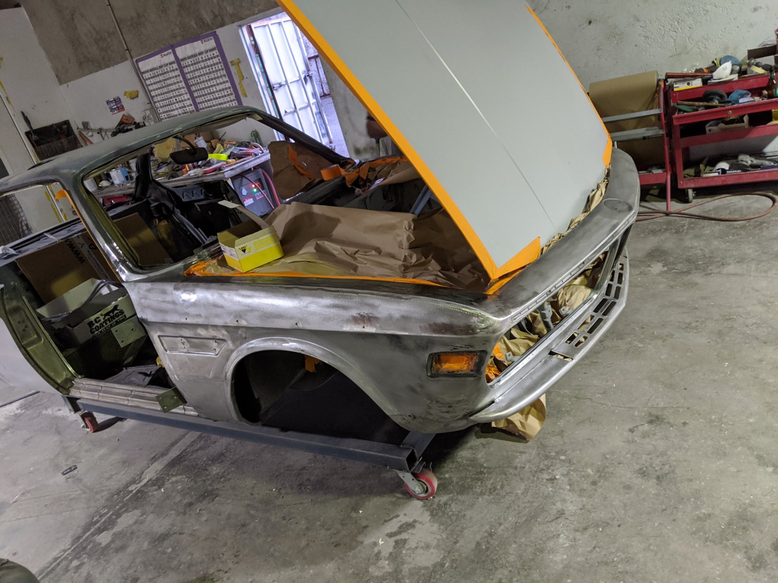

The front half was then stripped back again , and after a time I'd rather forget was bought in line with the rear....
So with the bulk of external bodywork torture taken care of it was time to get into some serious self abuse......

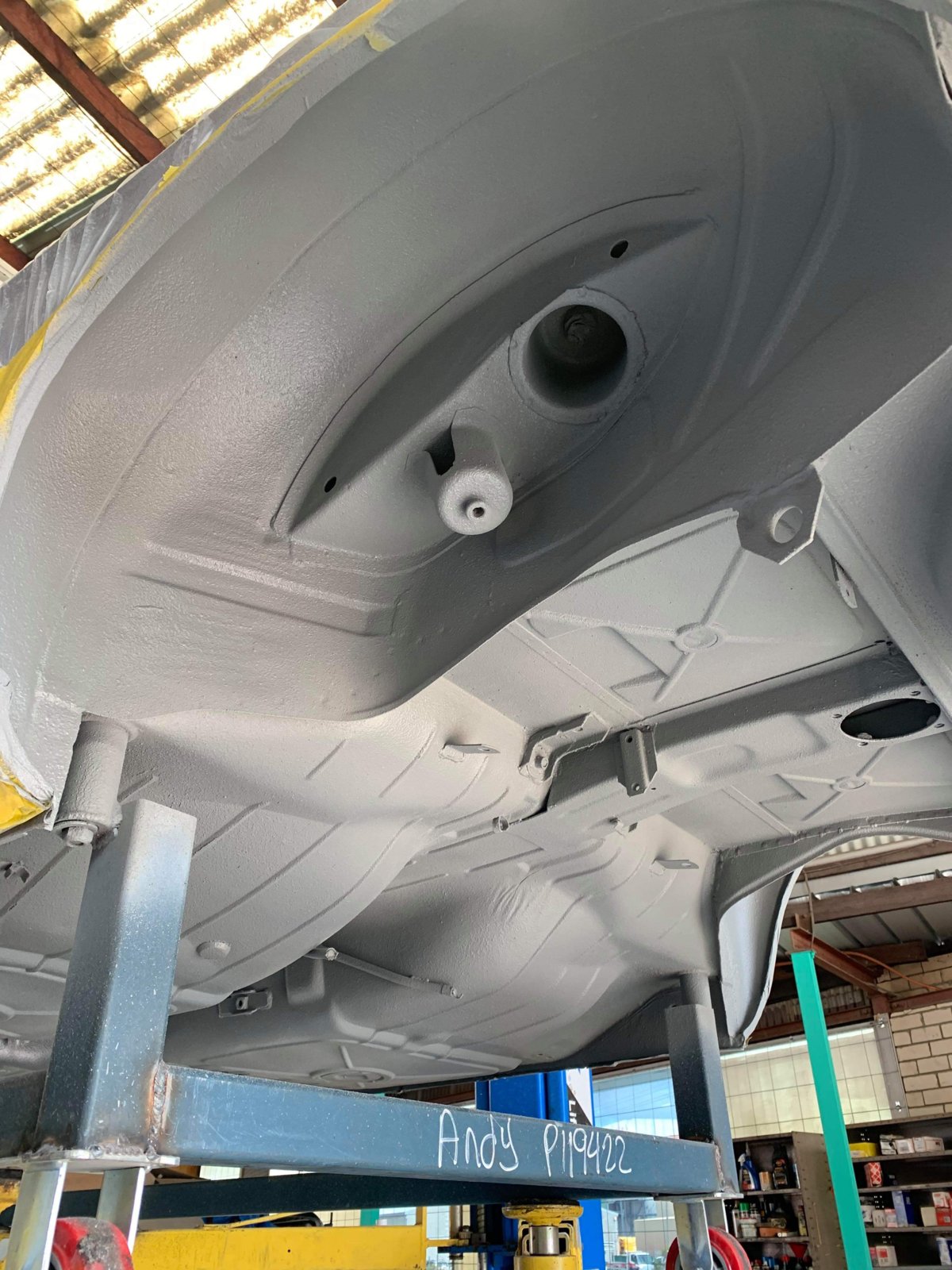

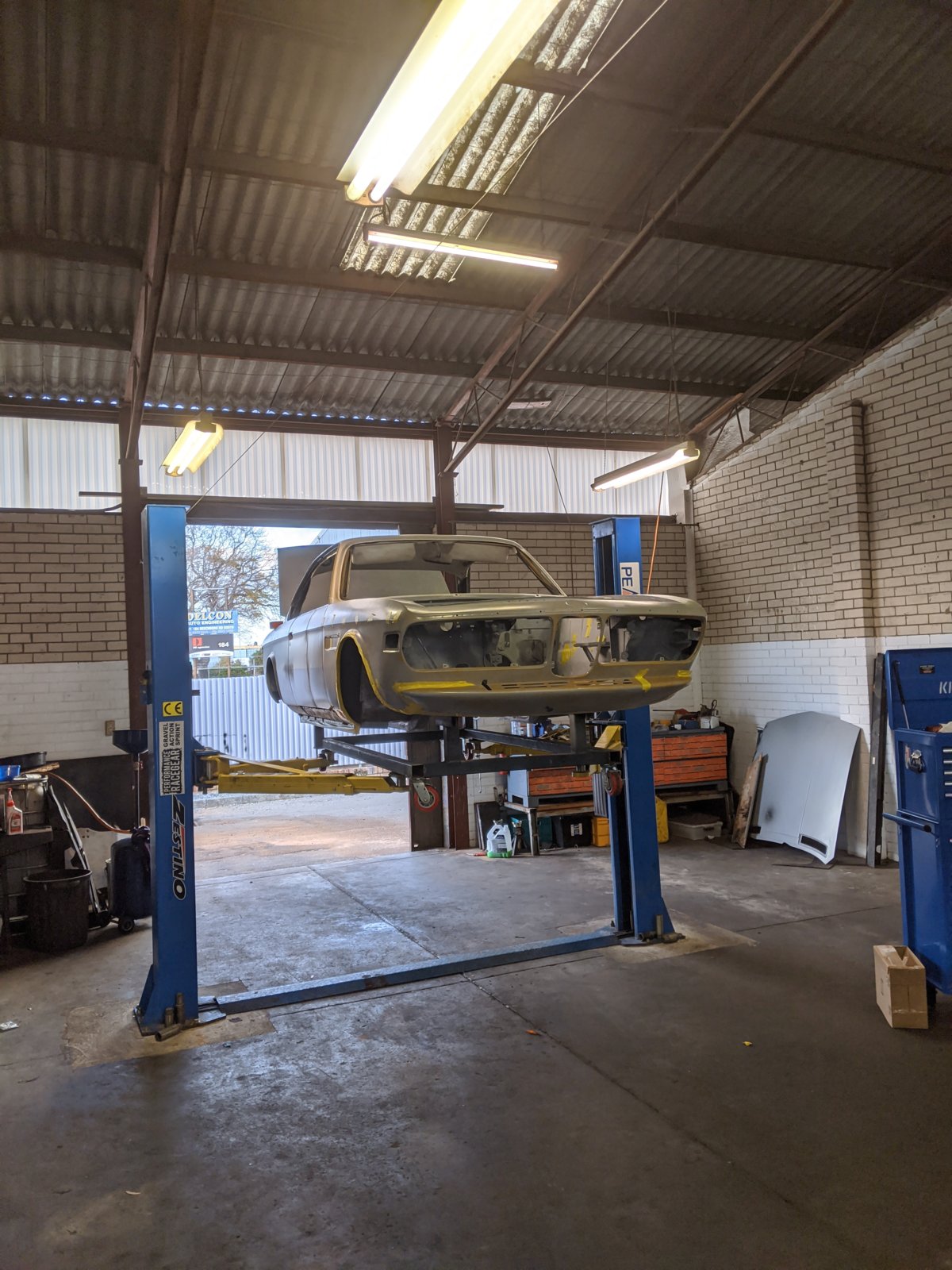

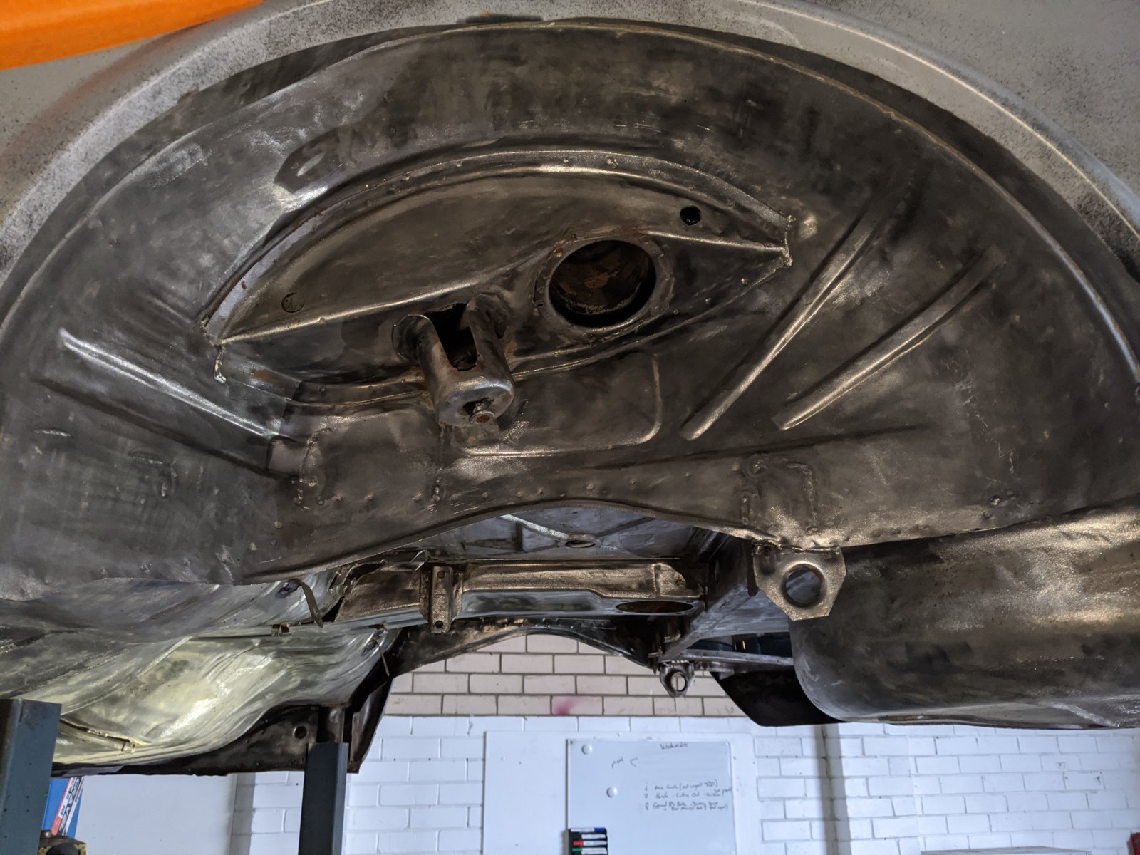

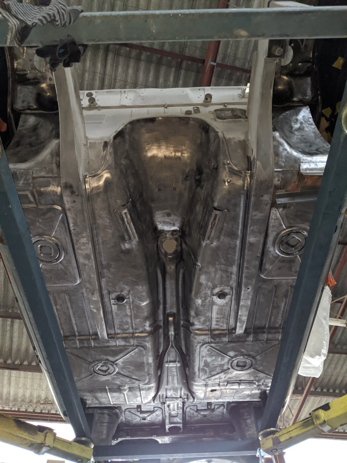

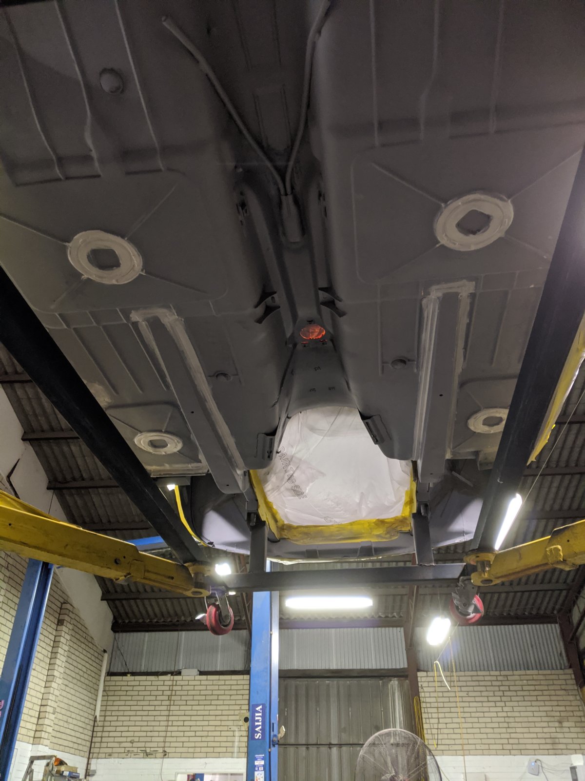

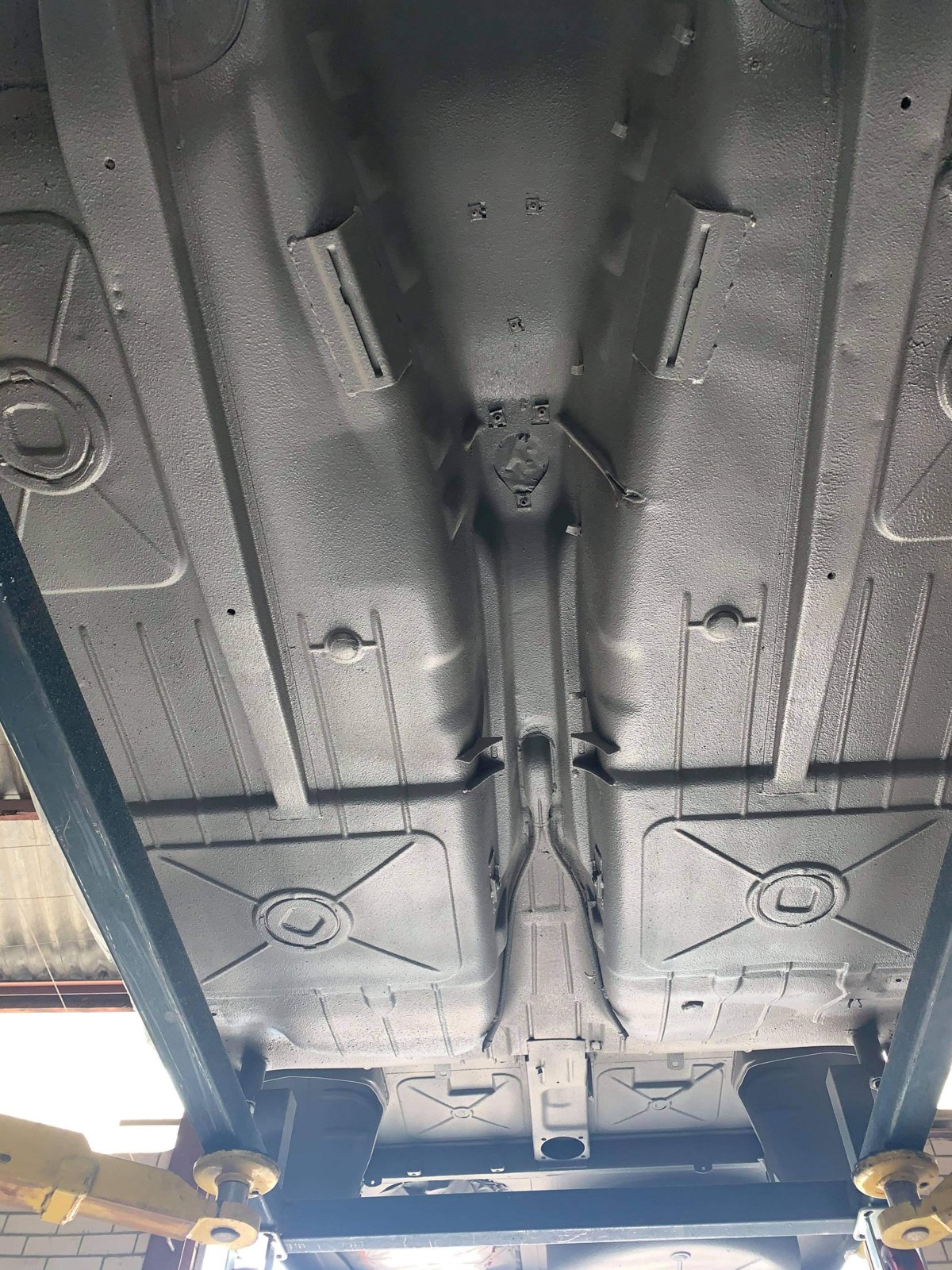

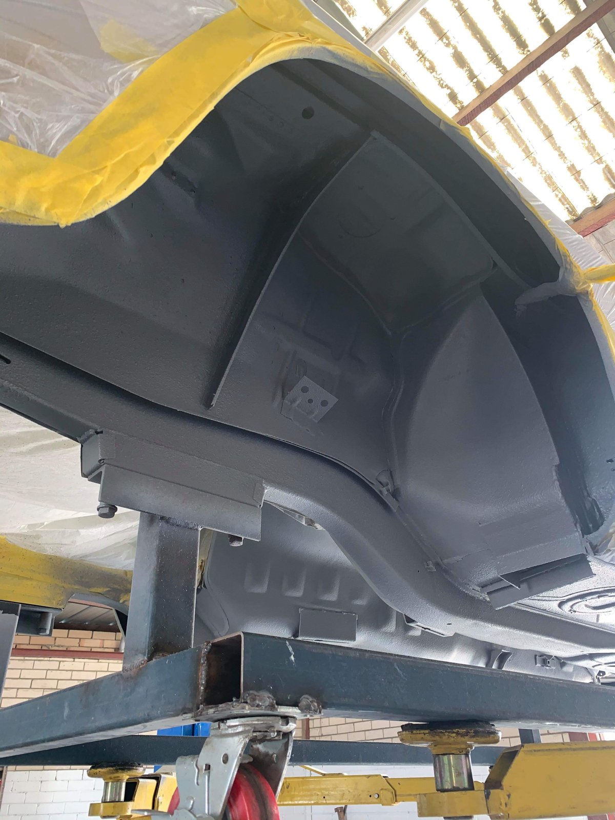

The underfloor stripping of all the wax, sound deadener, surface rust was something I had been putting off but knew had to be done, most of this was done on my back on a creeper and after a few long nights I had removed 90% of it, I finally got the car onto a hoist to take a deep breath and get all the last really hard to get to spots done...
