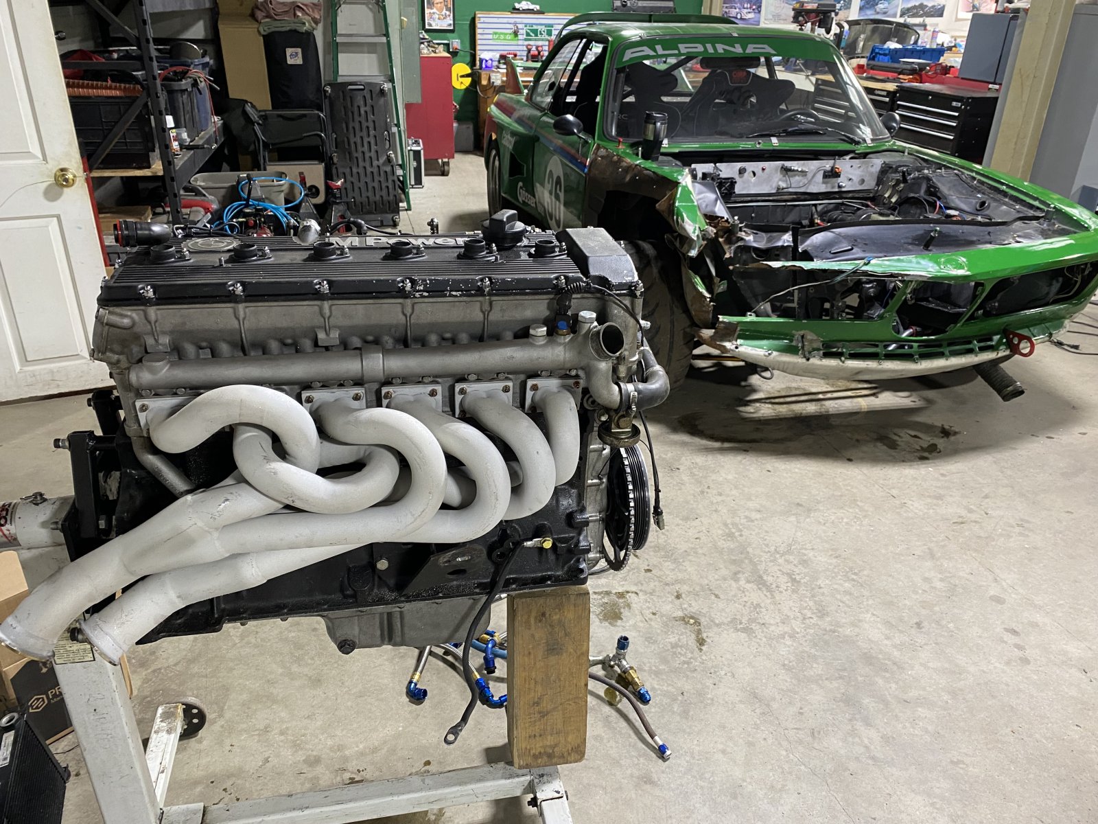

During the first time attack practice session at the Lime Rock Gridlife event, our BMW CSL experienced damaged connecting rod bearings which ended our track time.
The issue was the result of a malfunctioning Accusump system. The engine will need to be torn apart and repaired. We have decided to install a VAC dry sump oil system
which should be more appropriate for running the car at 7200 RPM in the future. We have delayed our attendance at the BMW Octoberfast event until 2024 but we are committed to running Road America next year.

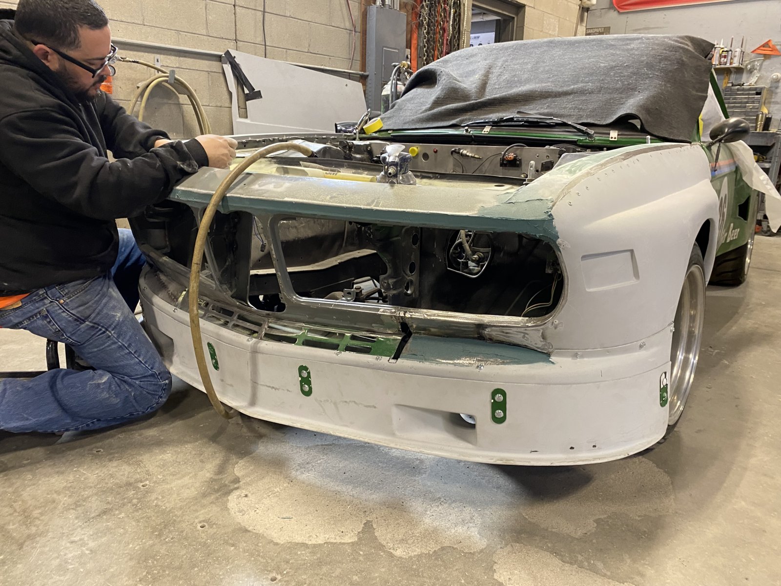

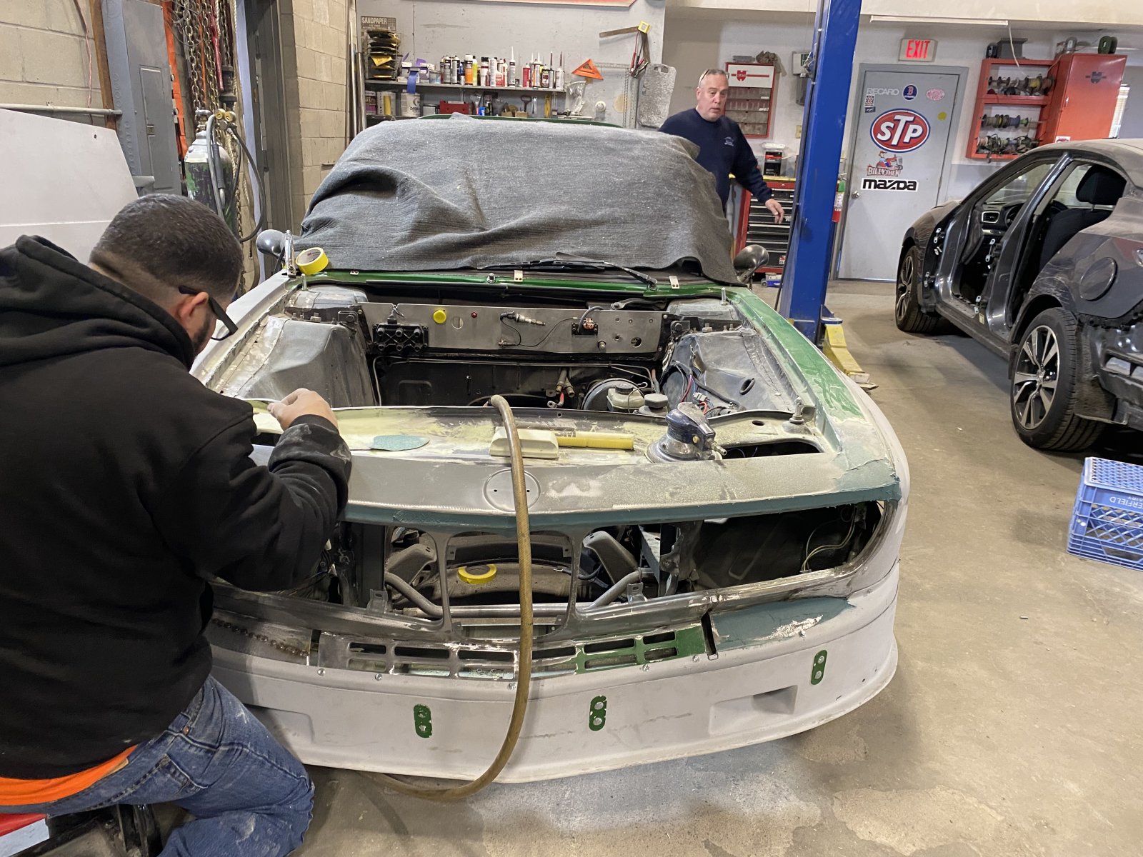

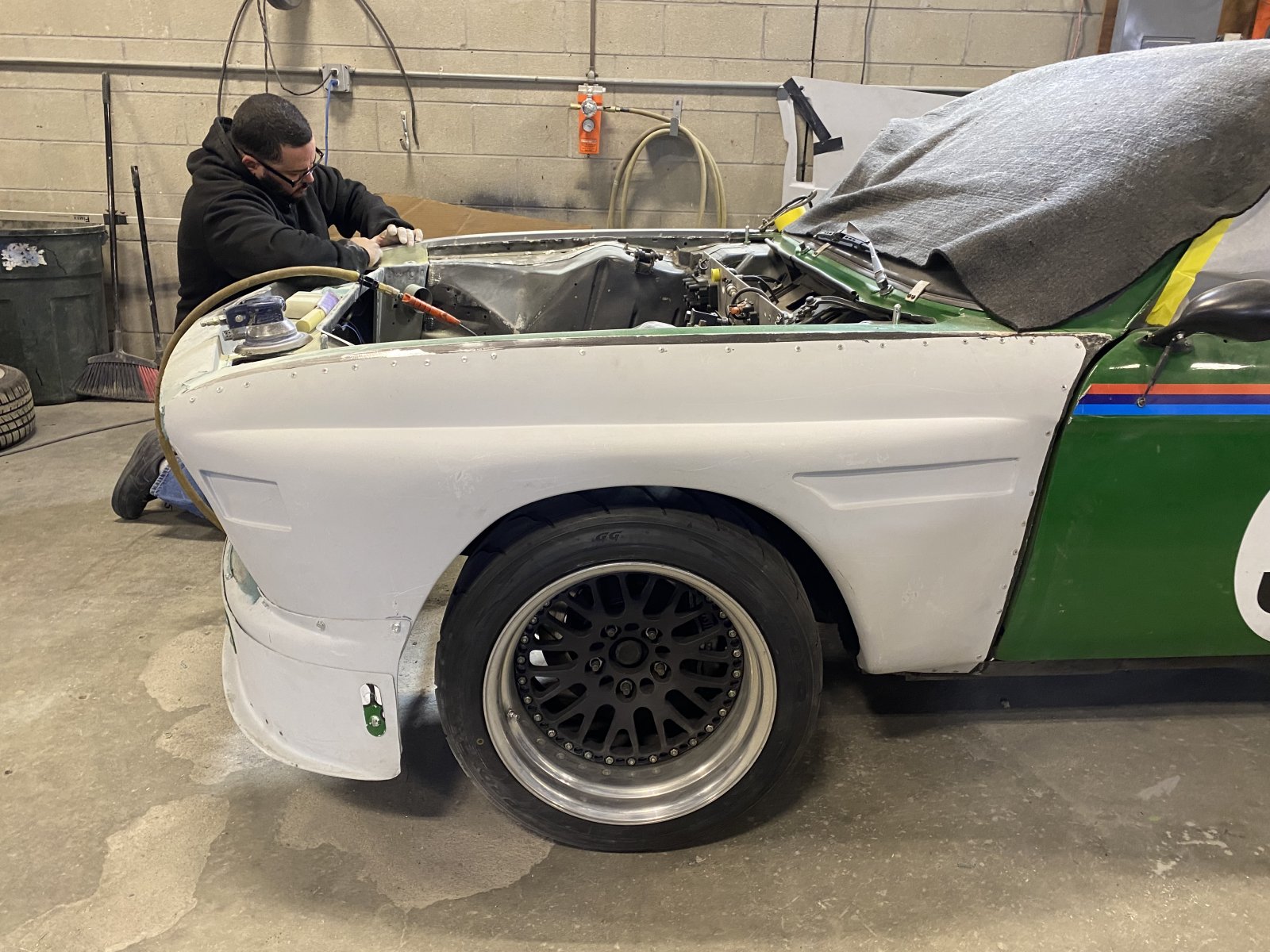

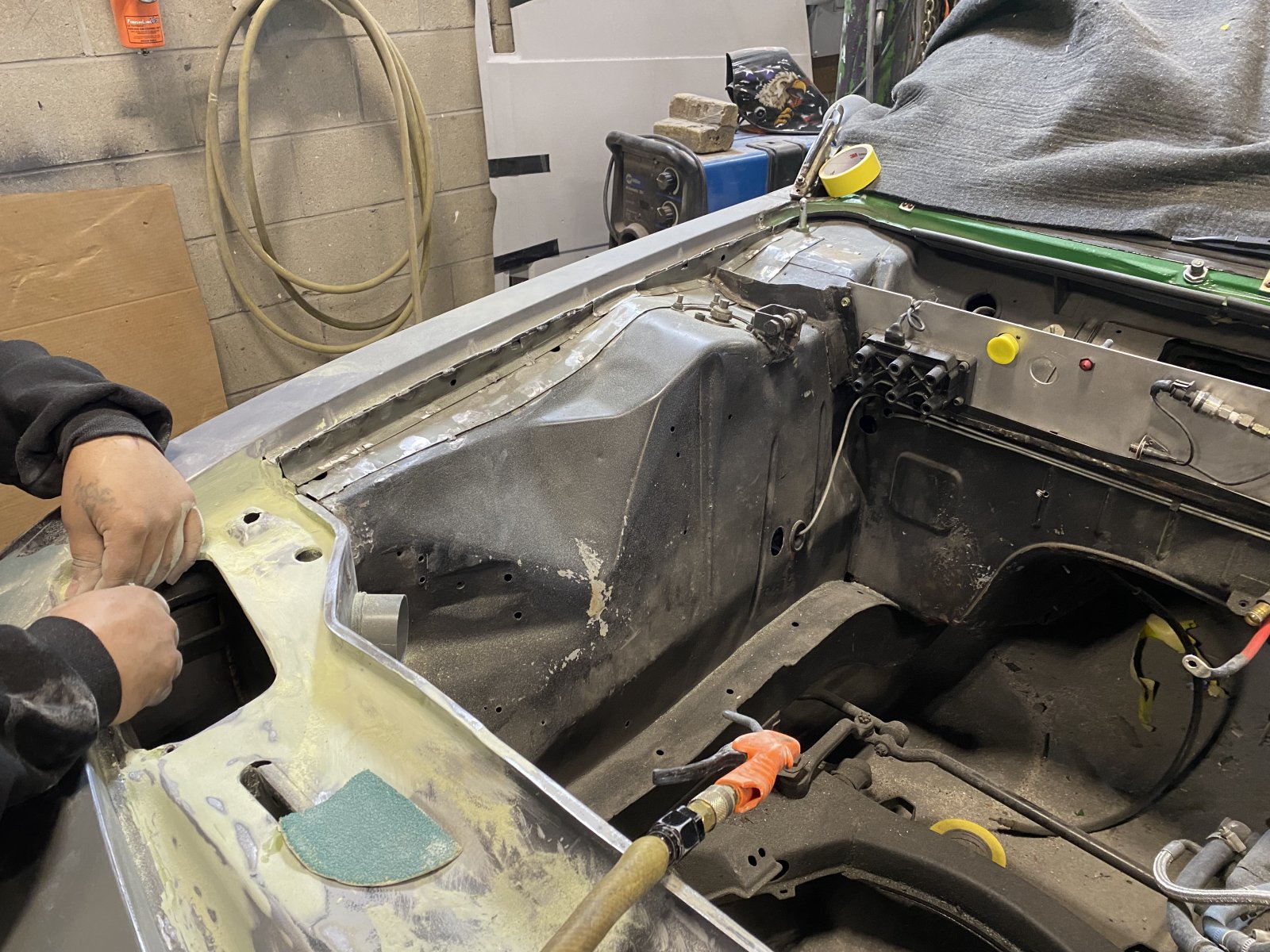

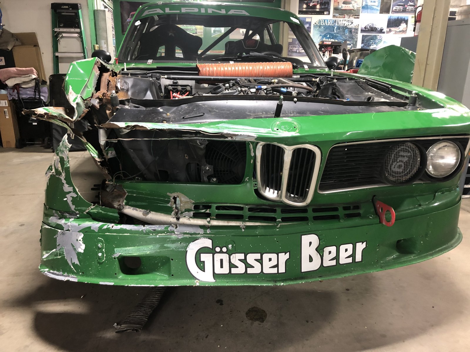

During my talk to the White Mountain BMW chapter about my CSL tribute car and my 60 years of BMW sedan ownership, I neglected to speak about my experience repairing my CSL after a head on accident at Watkins Glen in 2021. At the time, I was unaware of the problem sourcing body parts for BMW E9 sedans and finding a repair shop experienced in repairing these unique bodies. The E9s were one of the early BMW sedans post WWII and they were made with thinner metal and lacked any rust prevention applications. This is the reason there are so few E9 sedans remaining today and those that remain unrestored suffer from severe body rot deep in the frame.
My accident destroyed the right fender and the complete front grill pieces and severely bent the inner right fender lining. Fortunately the E9 has a strong shock support structure that was unharmed. It took me six months to source the body parts and I was fortunate to find the perfect body shop willing to take on the repairs. Tom Kelly and his son Zack at Precision Motorsports in Milford Mass did a magnificent job which was quite complicated. They have specialized in repairing race cars for 30 years and both of them race BMW M3s in SCCA competition.
My car has flared fiberglass fenders that are attached to the steel OEM fenders. I needed to find a replacement steel fender and complete steel front grill members and then have a replacement fiberglass fender made. I visited Mario at VSR1 in New Hampshire and he was extremely helpful with advice and an offer to purchase the front grill parts in Germany for me and provide illustrations of how the repair would be done. He informed me that BMW had ceased making most body parts for E9s years ago. The body molds were sold to a Polish company which went bankrupt. During my six month search, I discovered on Ebay someone in Long Island that was parting out three E9 sedans and I purchased two sets of front and rear fenders and a front grill structure and had them sand blasted and zinc treated for rust prevention. I then contacted the Coupe Guy in Colorado who is one of the few sources for fiberglass CSL Group 2 body parts and had him build two sets pf front and rear flared fenders and front spoilers. The repair took several months and the results are amazing as you can see in the pictures I have posted earlier. Owning an E9 BMW is a goal for many BMW club members, but

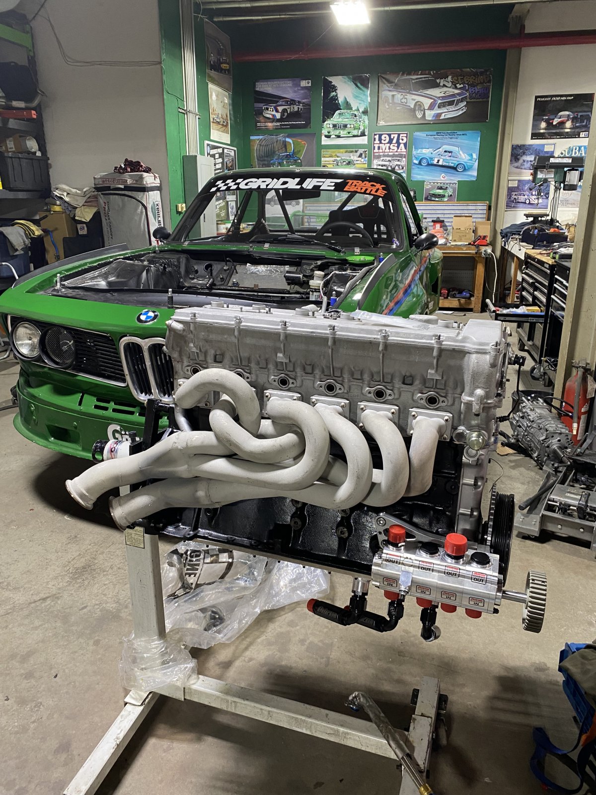

The M88/3 engine in my BMW CSL 3.0 tribute car has been rebuilt after the rod bearing damage at last summers GridLife event. We had the block totally cleaned and surfaces polished at Reid Automotive in Whitman MA who also polished the surface of the head. The crank was sent to a specialist in California to repair the rod surface and rebalance. All new coated crank and rod bearings special head gasket have been installed. The Peterson dry sump pump and oil pan sourced at VAC Motorsports have been installed and the engine will be reinstalled in the car next week. My son has installed a remote oil tank in the passenger footwall and all new flexible oil piping will be installed. We plan to keep the oil cooler and remote oil filter. We estimate that the dry sump system may add about 20hp and avoid any future oil system problems.

It has taken far longer than we expected to install a dry sump system for the BMW CSL M88 engine. My son needed to custom design parts
for the dry sump pump pipe fittings and the main oil tank installation and dyno the car again. We are ready to do a one day Lime Rock session
with SCDA on July 16, followed by GridLife at Lime Rock August 16-17, Watkins Glen August 19-20, and Road America September 21-22.
I will post pictures of the dry sump installation.
