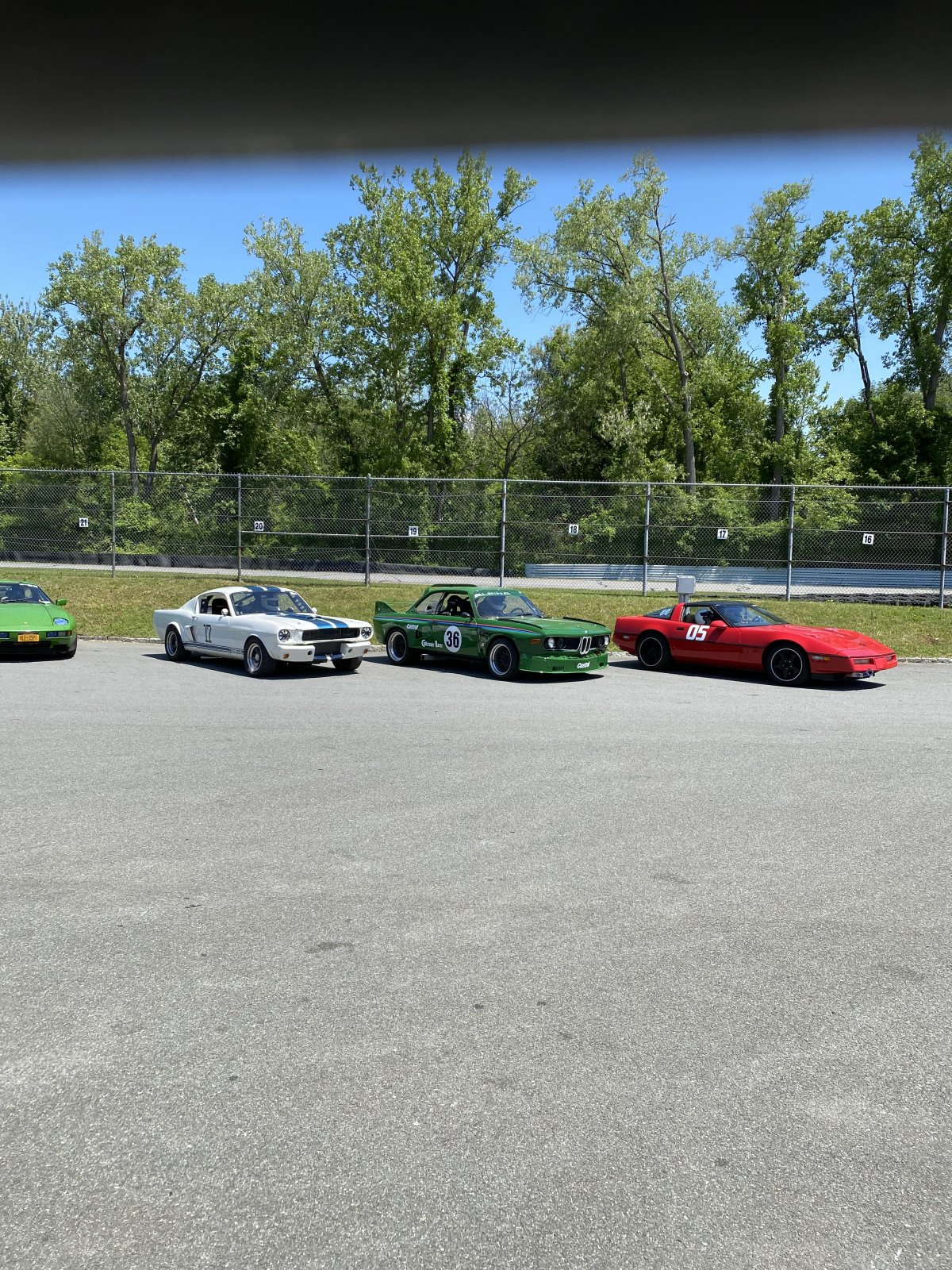

My son and I took the BMW to a vintage car event at Lime Rock track in Connecticut and both drove the car during the two days. We plan to trailer the car to Road America in Wisconsin in October for a two day BMW Club event. I will also drive the car at Watkins Glen twice this summer. Picture shows the BMW next to my Shelby GT 350 tribute car which I sold to a young Mustang racer so I am able to run with him in the same race group in each event which is ideal.

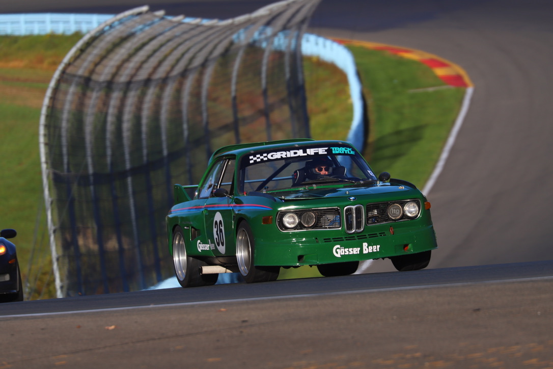

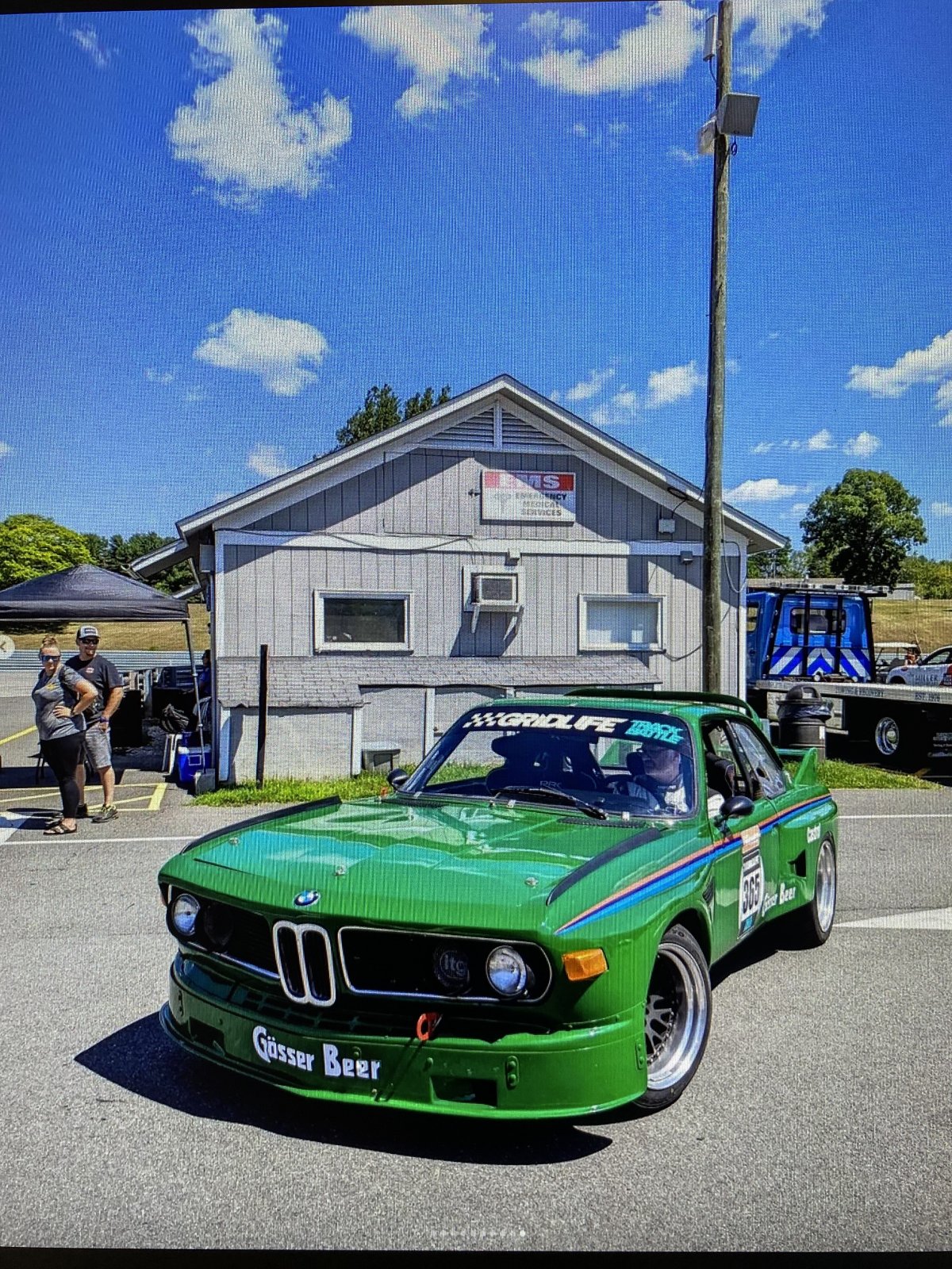

My son Bill entered the BMW in the GRIDLIFE time attack event at Lime Rock which had some of the best time attack and drift cars from all over the country
including several from California and Texas. The CSL was one of the few vintage cars competing and was the oldest car there. The first day Bill recorded a lap time of 1:02.89 which was without pushing the car. During the first session on the second day the car experienced a broken valve spring and bent valve which ended his competition. Although the main attraction was Asian turbo charged time attack cars and some of the top drift cars running the full Lime Rock track for the first time, the Gosser Beer CSL attracted a great deal of attention from most of the crowd, most of whom had never seen a competition prepared CSL before. We plan to return next year for the GRIDLIFE event. October 1-2 we will trailer the car to Road America in Wisconsin for the BMW Octoberfest event.
