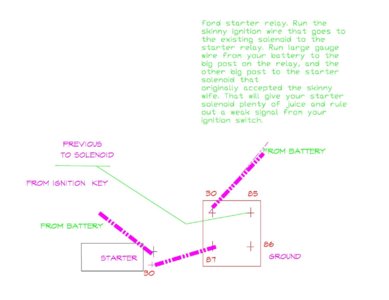

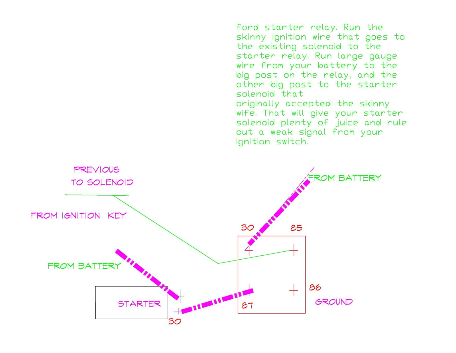

Alternatively, you can buy a $20 ford starter relay. Run the skinny ignition wire that goes to the existing solenoid to the starter relay. Run large gauge wire from your battery to the big post on the relay, and the other big post to the starter solenoid that
originally accepted the skinny wife. That will give your starter solenoid plenty of juice and rule out a weak signal from your ignition switch.
FWIW this isn’t a hair brained idea. I used this well documented method on my MkII jetta to combat hot start issues. After the car was at operating temp it wouldn’t restart. Starter would just click. This was an approach addressed my issues. Personally, I wouldn’t do it in my e9, but it’s another inexpensive diagnostic approach.
Lastly, welding wire makes good inexpensive battery cable. I’m sure I’ve mentioned this before but why not…

IS THIS THE LAYOUT YOUR SPEAKING OF.
Use an actual ford starter relay. They are $20 or less at autozone. Not your average relay.
AFTER A BIT OF THOUGHT A SOLINOID WONT HELP AS I SHORTED THE
STARTER WITH A SCREWDRIVER DIRECTAND IT STILL JUSTCLICKED.
