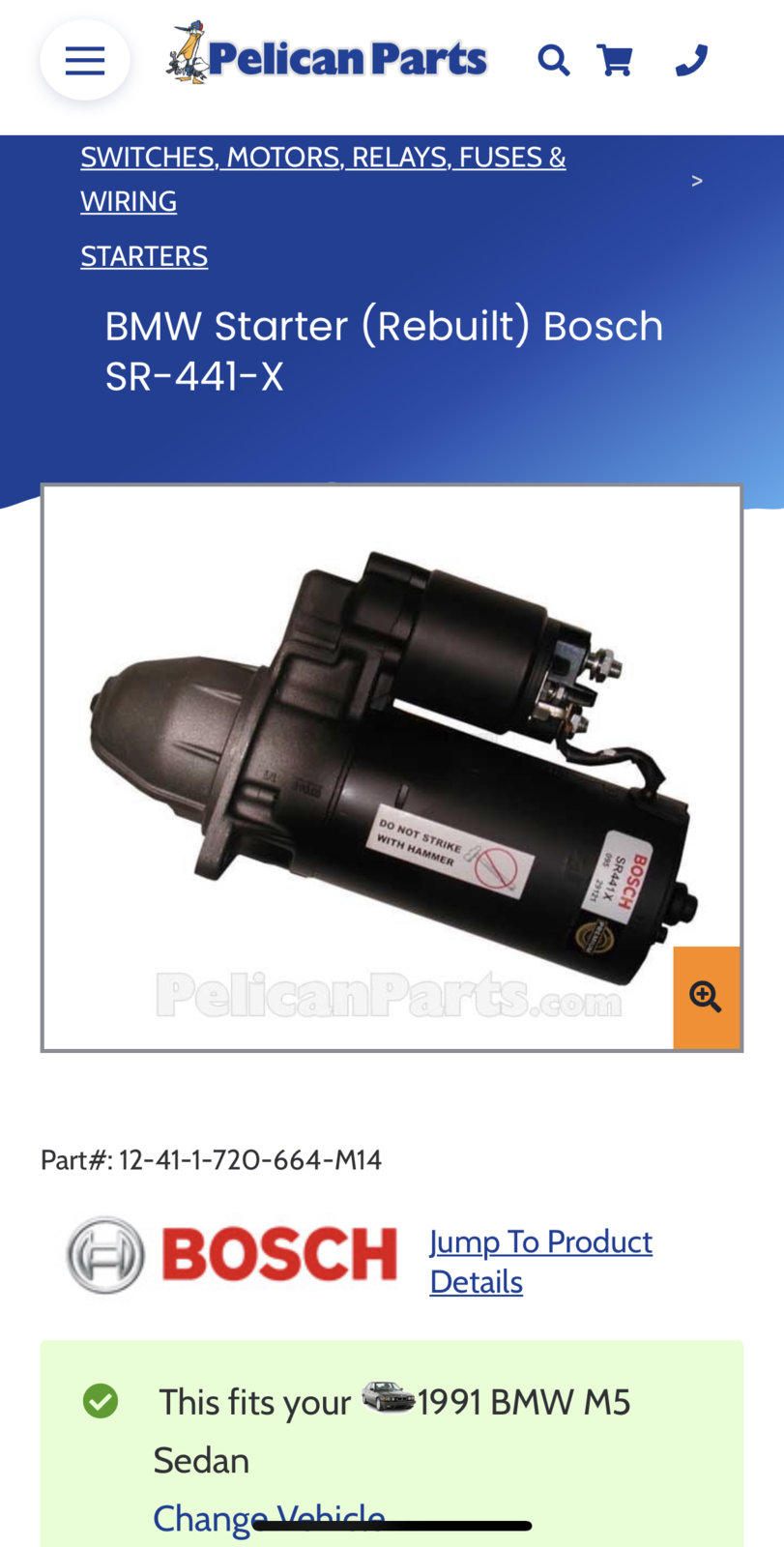

FWIW - @aearch dis state that he ordered N SR-41x starter. I would have gotten a newer dimensionally smaller starter like the 441x. I’m pretty sure the 41x is the same big old starters as found on the early m30, but from the e28 era.
right there with you Markos ... the sr 41 from autohauzaz is 103 bucks plus 25 core. it is the remanufactured version of the original starter
he could have bought a sr 441x from fcp euro for 137 bucks - send his old one back his old one to avoid core charge
or the sr 444x (850ci) from autohausaz for 115 bucks - 50 bucks core charge

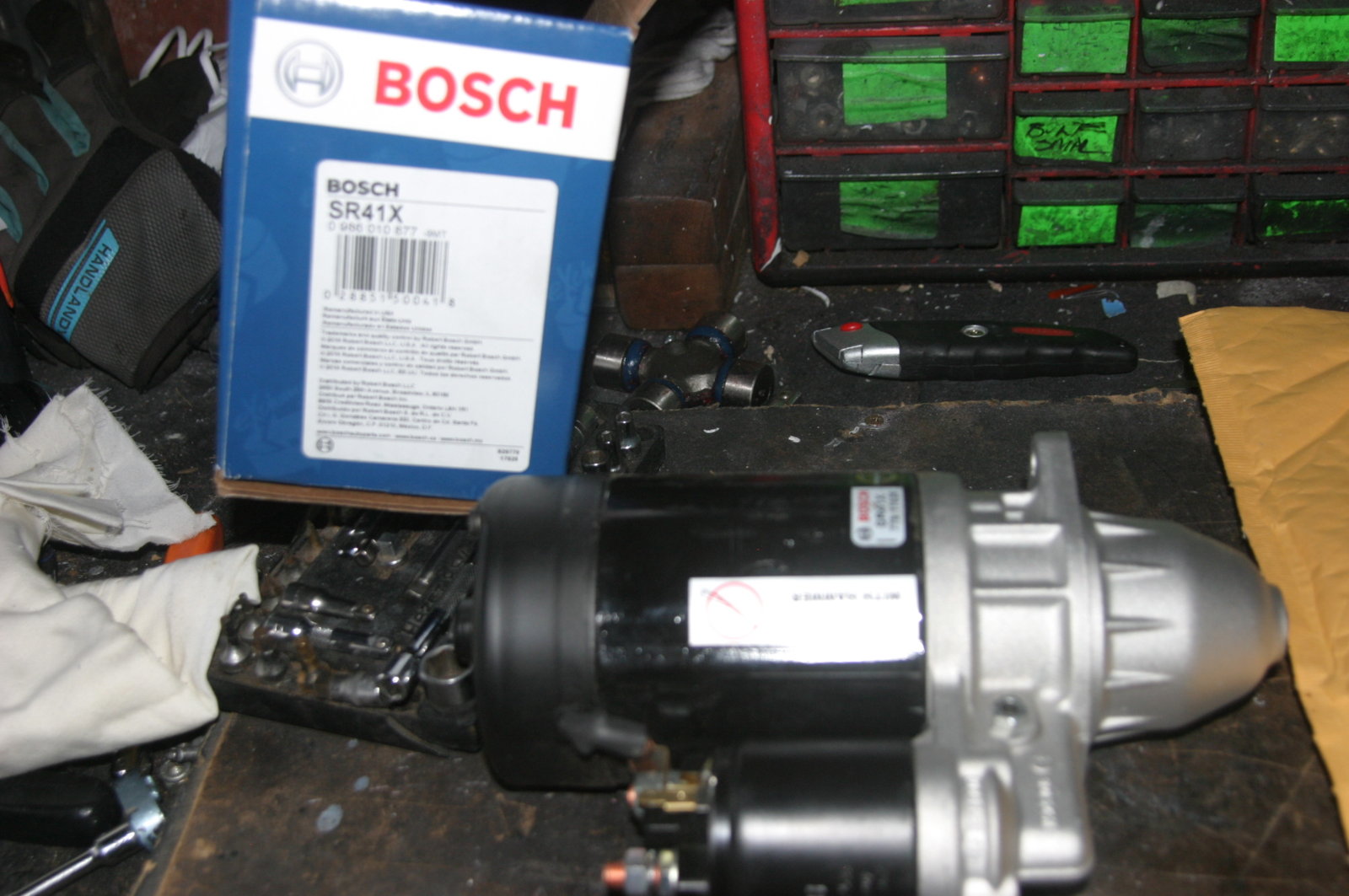

I JUST RECEIVED THE SR41X AS THATS LISTED IN REFERENCE TO THE SR444
SO ILL LET YOU KNOW HOW IT GOES.
IS THIS AS GOOD AS THE 444X
THE 44X DOEST FIT THE M5 CHECK IT ONLINE YOULL SEE
THE 441X WONT FIT THE M5
I HAVE THE RIGHT ONE
still NEED TO WIRE THE LINK UNIT
LOGAN HAS NOT BEEN ANSWERING AND HE IS MY ONLY OPTION TO
GET THIS HOOKED UP
I MEAN THE 444 WONT FIT AS I HAVE THE441
