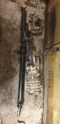

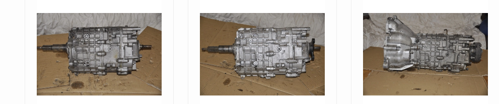

I am getting additional photos but the problem is the corrosion has progressed below the case hardening of the gears in some places and if I repaired it will not last long. So yes again looking for a replacement solution. I tried Mr. Taylor as suggested no reply as yet. As I recall the trans can come out of 1985 535i or a 1980-82 528. Any leads appreciated shipping not an issue.

You can also check the ratio on the gears. It is possible that you have crossover with a 260 for example. I have no idea but it is worth checking.

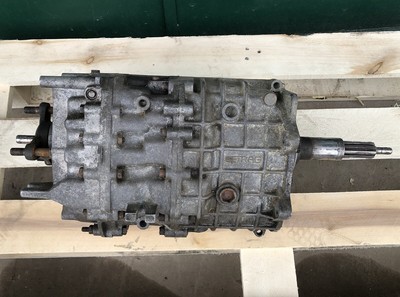

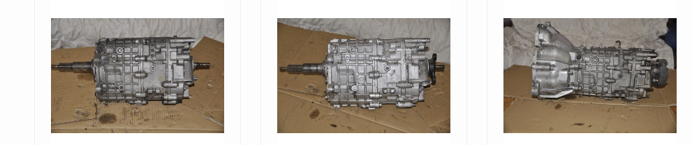

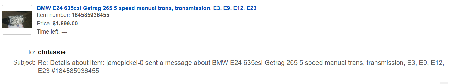

I found three for sale on the east coast two at $1500 one is $1900
In process of teardown to rebuild. Another great adventure.
Not sure I would attempt that. Special tools and as mentioned parts availability.
A company called Metric Mechanic in Memphis is currently the only one I know that can rebuild. $4000???
There was a guy named Jim Blanton that used to to this but haven't heard anything about him in years.
I would source another before I went down the rebuild path.
Jim Blanton has retired from rebuilding transmissions due to the scarcity and high cost of parts. I appreciate your candor and advice.
Several years ago I rented a Spece30 from the guys at Drivegear just to give it a try. Andrew Zimmerman, who is part owner of the place, told me that their main business is rebuilding 4 speeds for BMWs. When I asked about the five speeds, his reply was "can't get parts."
FYI My mechanic had a look at the 265 gearboxes for sale on eBay and he said to pass on them. So if anyone does hear or know of a decent 5 speed available, please DM me.
Thanks all. M

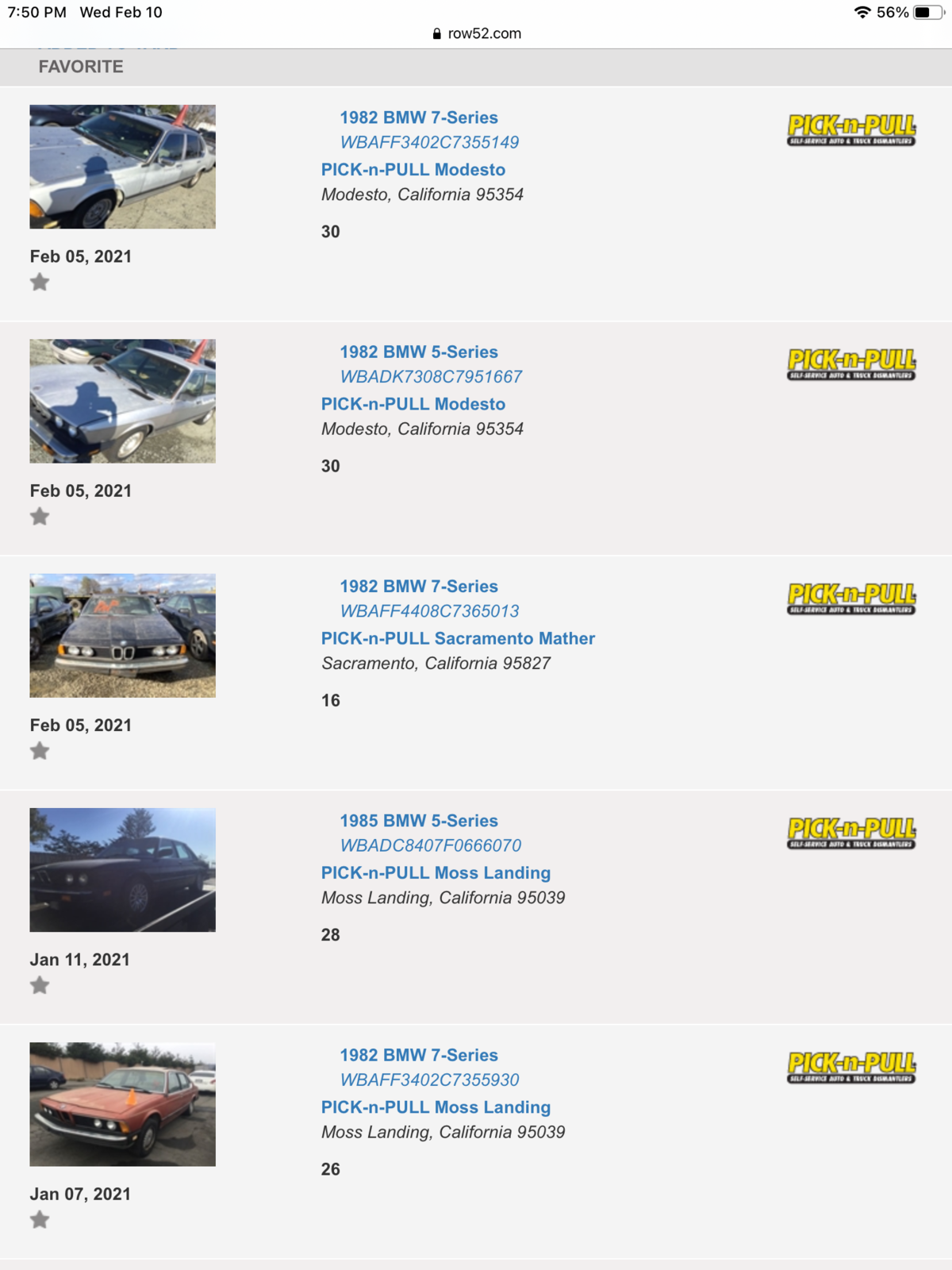

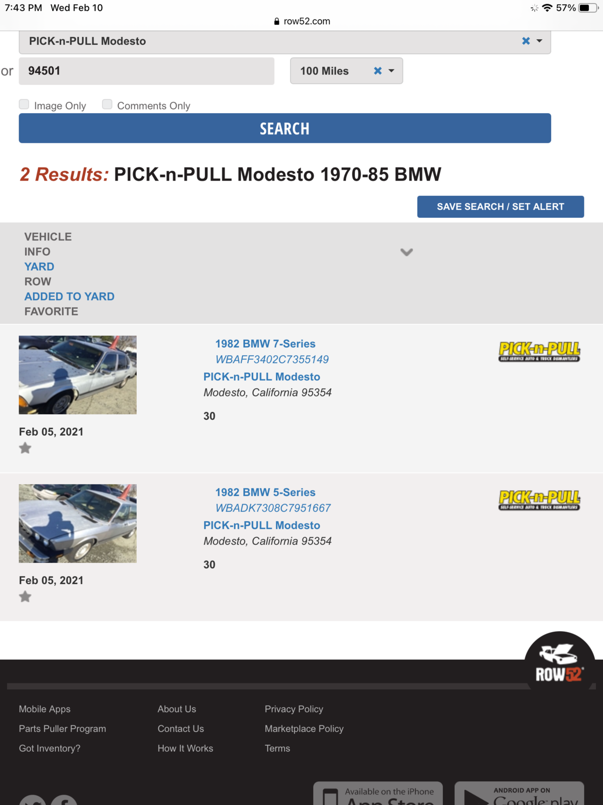

I got two from the boneyard this week.
528e and a 733i
most yards have pickers!
