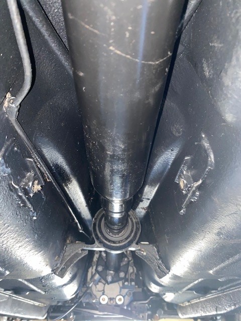

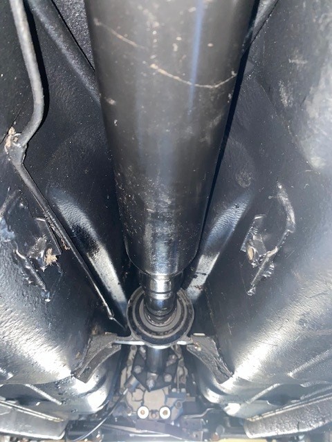

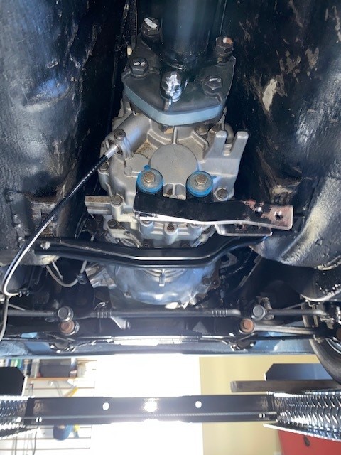

The 5 speed rebuild is complete built some special tools to separate the front and rear sections had a lot of fun figuring where the shift rods are positioned relative tot he second gear which is essential for reassembly. Reattached all the bits and pieces and gave it a test drive - shifts smooth as silk and quiet. Spedo is functional.
One anomaly is when the engine fired up the tach does not work and its running really rough will not rev up at all - have not touched the engine in 4 months if anyone has a best guess to this it is appreciated - last time I ran it all was perfect!!

Create a sep. thread for your running bad issue.
Check your points if you still have them. Also a bad plug wire.
Fuel separation/bad fuel would be my first guess. I zip tied my speedo cable to the tranny bracket to tuck it up closer to the body.

What was actually replaced in your trans?
