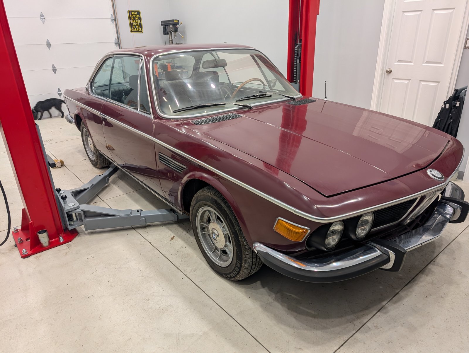

Well here we go.
The plan… it’s coming completely apart. Being blasted. Metal repair. I will do the structural and metal replacement then off to the painter for a nice finish. I painted most of my cars but think I would rather leave this one to the pro.
Engine going out for a long block rebuild. I’ll do the rest. Trans and rear end will need done as well. Have not decided on who or how on that yet.
Yes, some will blast me for this but it’s getting a color change. Sorry Ive seen some really beautiful Malaga cars. Just not my color. It will retain its heritage but I would like to have it like my old 71. Chamonix with a blue interior.

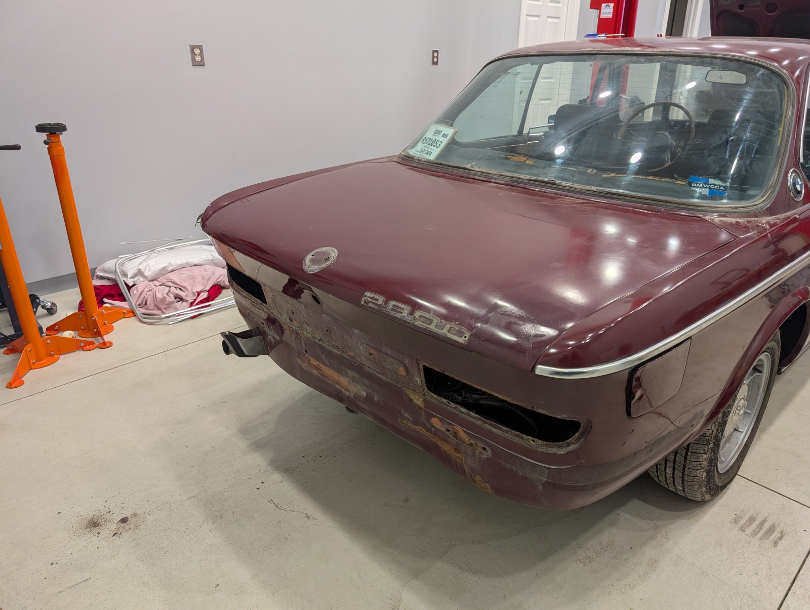

Known issues… needs floors. Fronts for sure. Most likely rears. drivers door is toast. Could be a reskin or better door. Deck lid sucks but could be repaired.

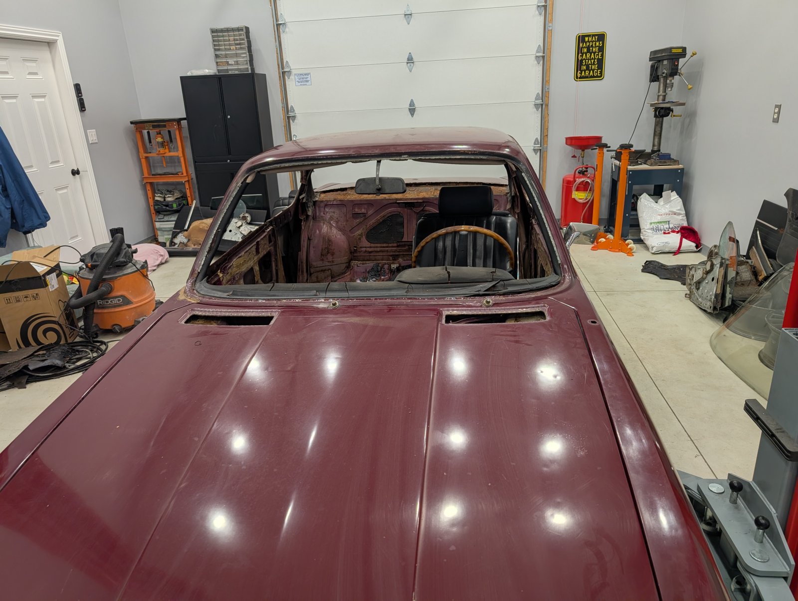

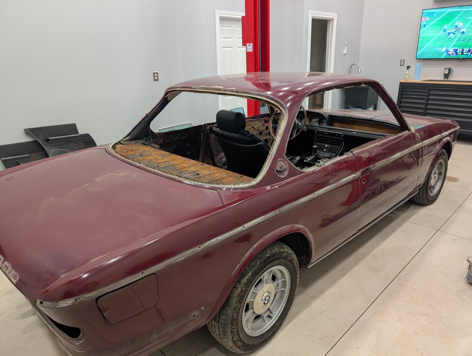

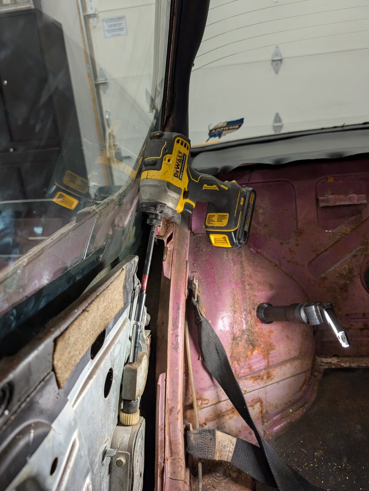

Been a little under the weather but managed to get all the glass out. A good bit of the interior and almost all the trim off the outside and some inside.
Windshield was scrap. Delaminated and big bullseye in it. It cracked on removal. The rear window came out perfect.

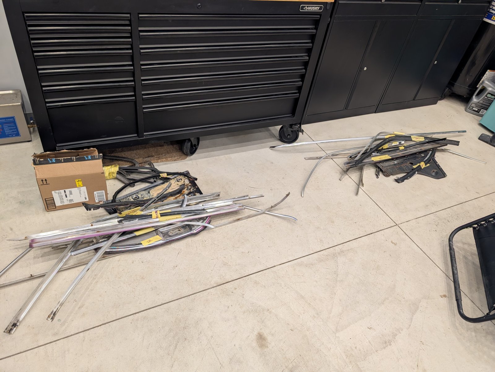

Don't have to tell you all... Damn that is a lot of trim. Takes quite a while to get it all off. Only had to drill out one screw... Pretty good.

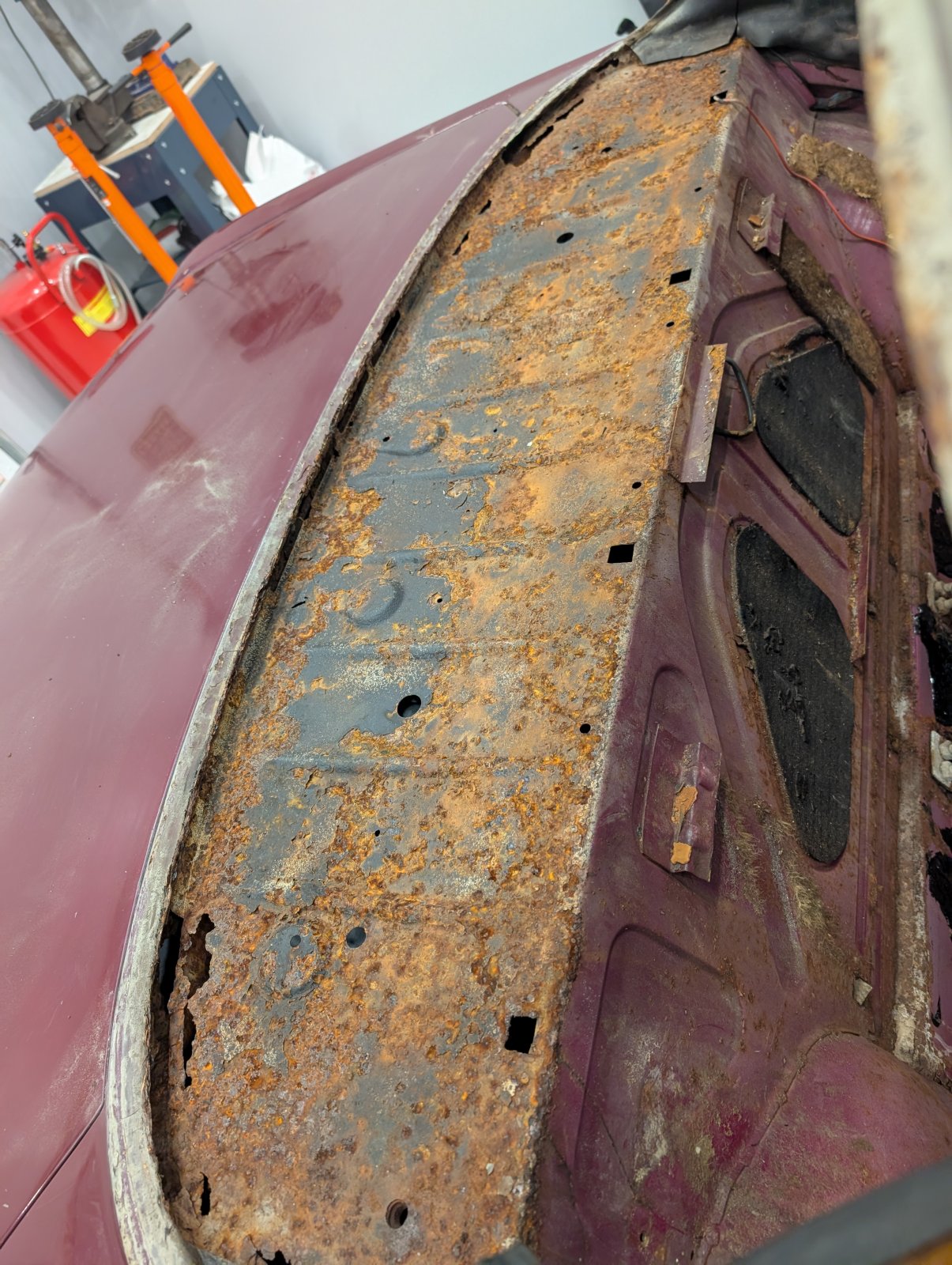

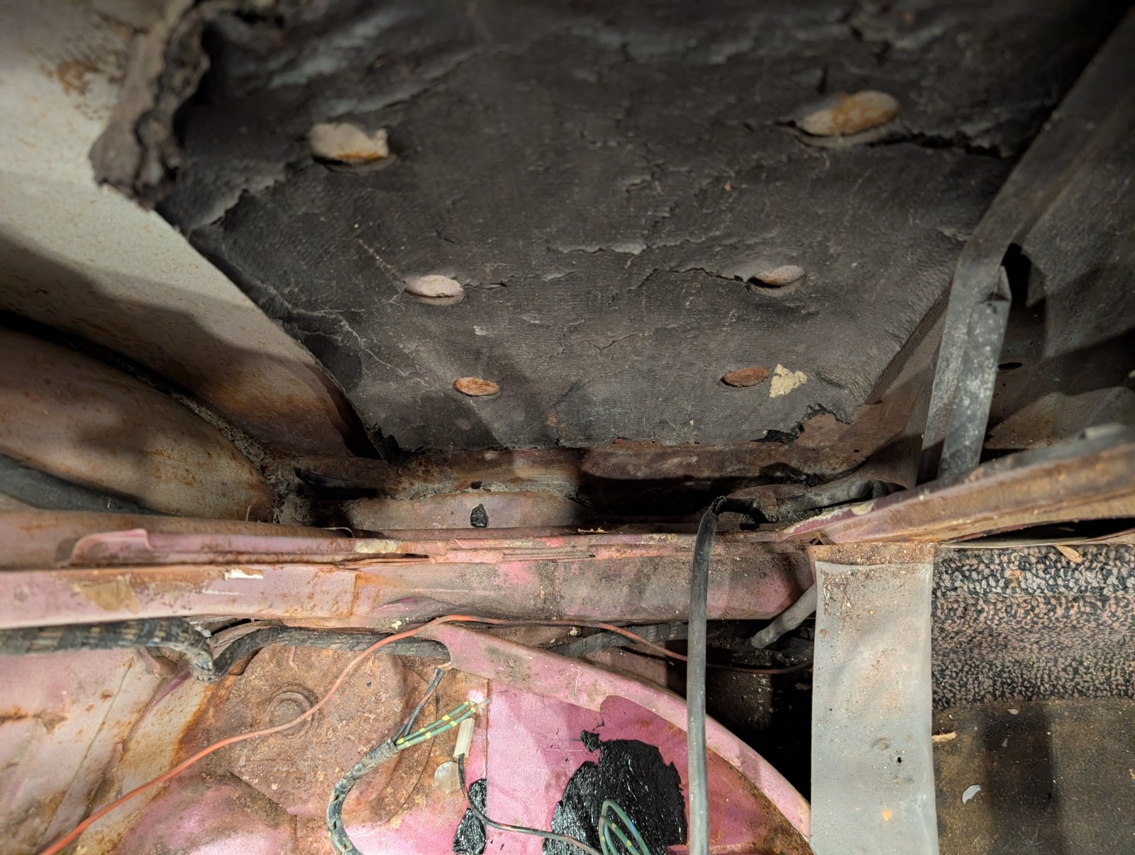

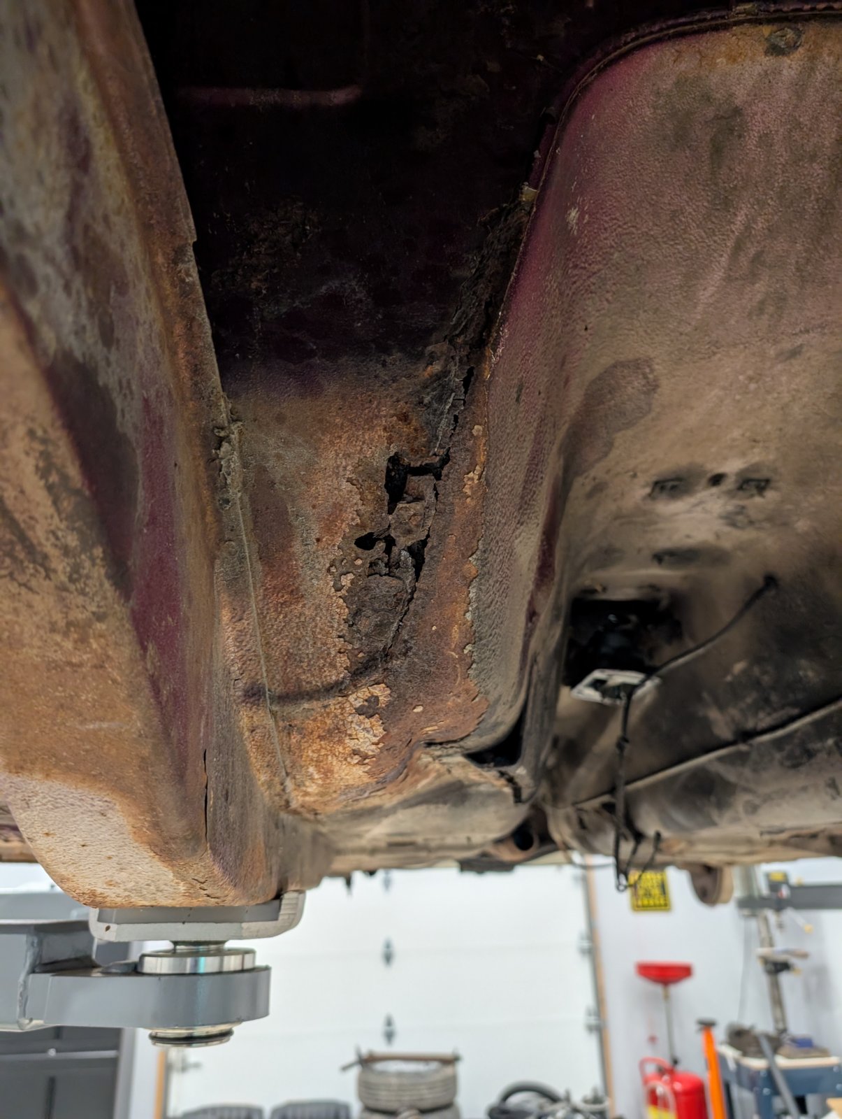

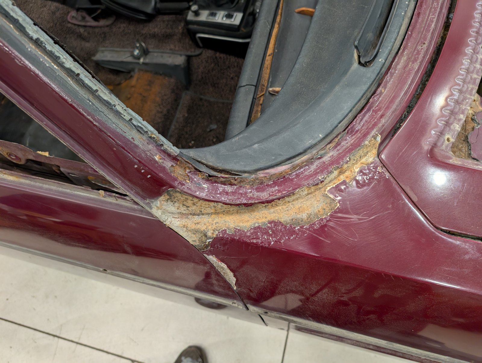

Some of the bad... Door we knew about. Rear package shelf... Bit of a surprise how bad it is. Front corner of windshield is so so.

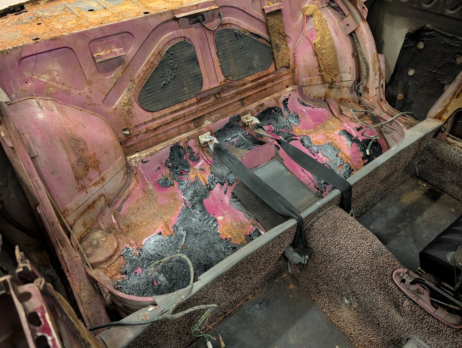

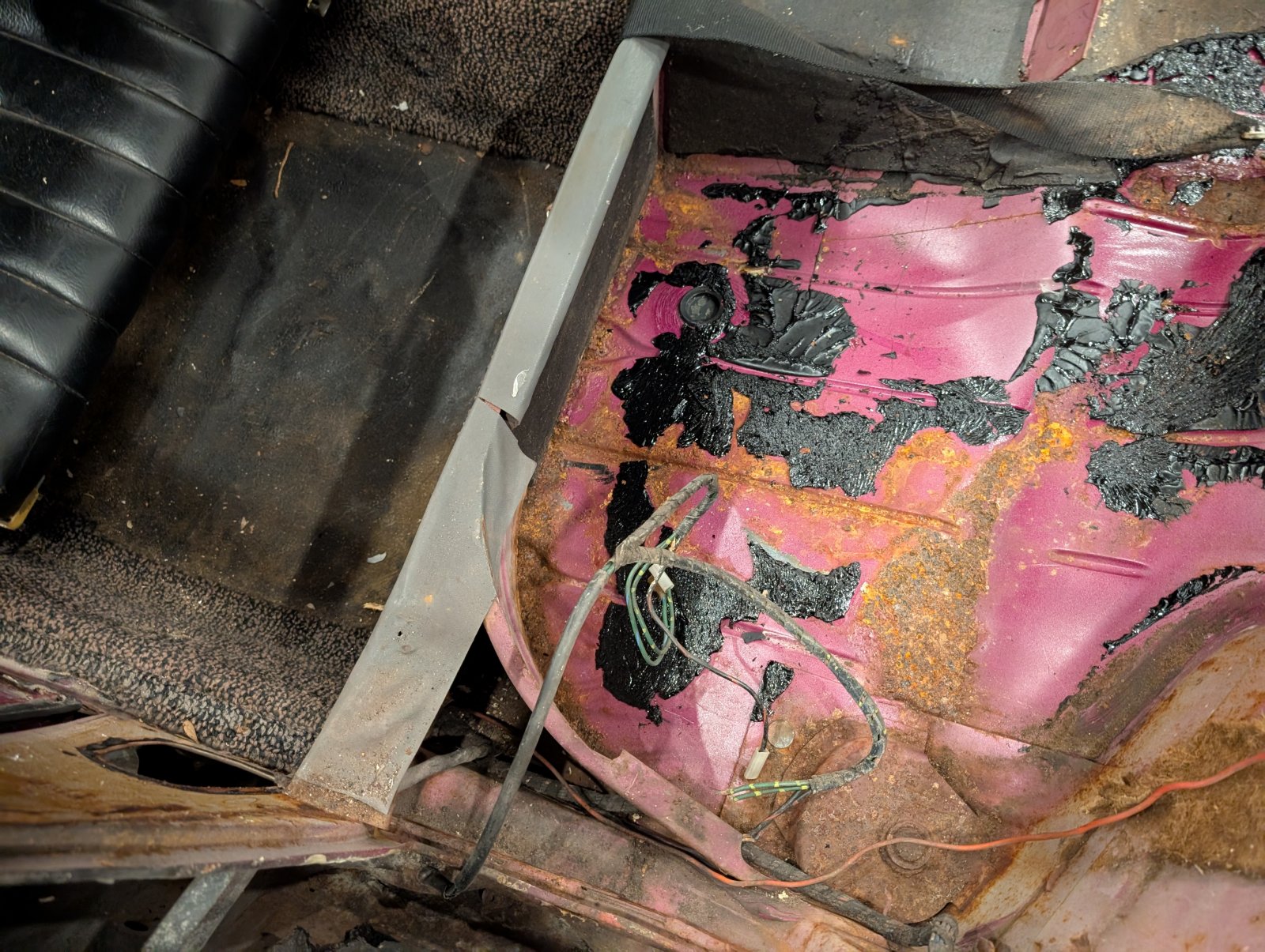

Really happy with the rear of the interior... Solid. No rust in the areas below the armrests and back seats. That's a plus.

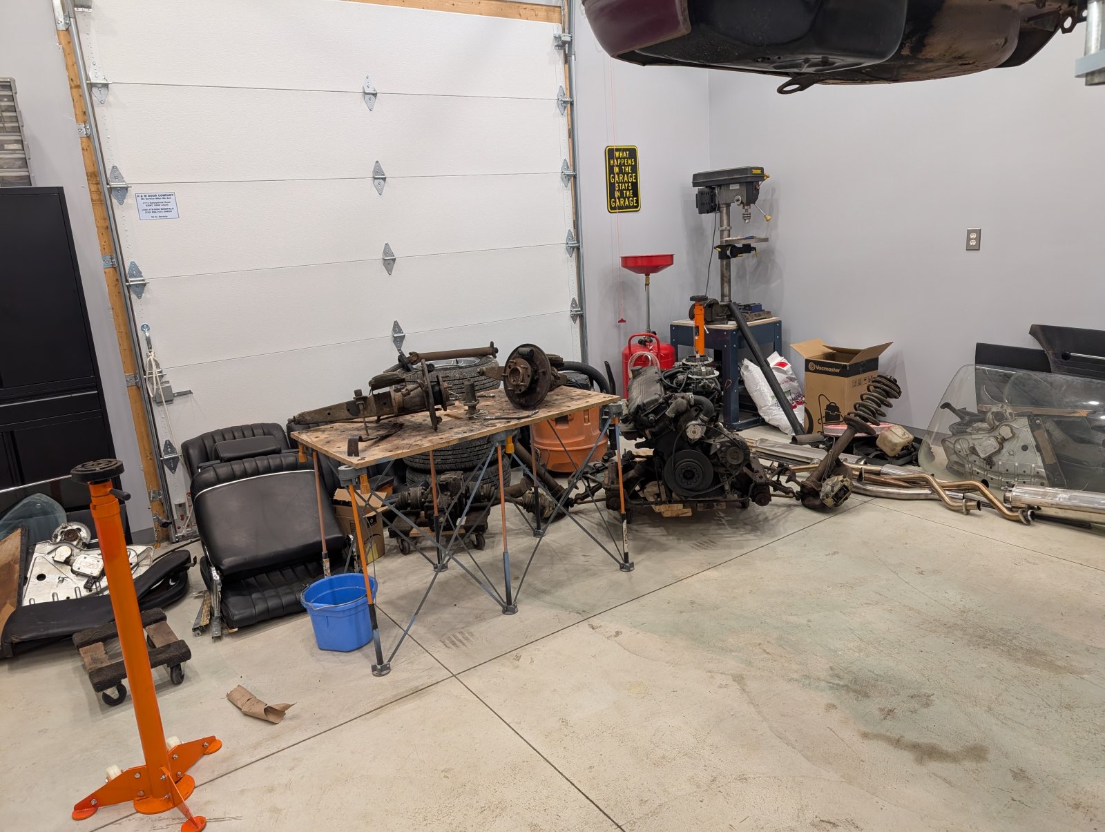

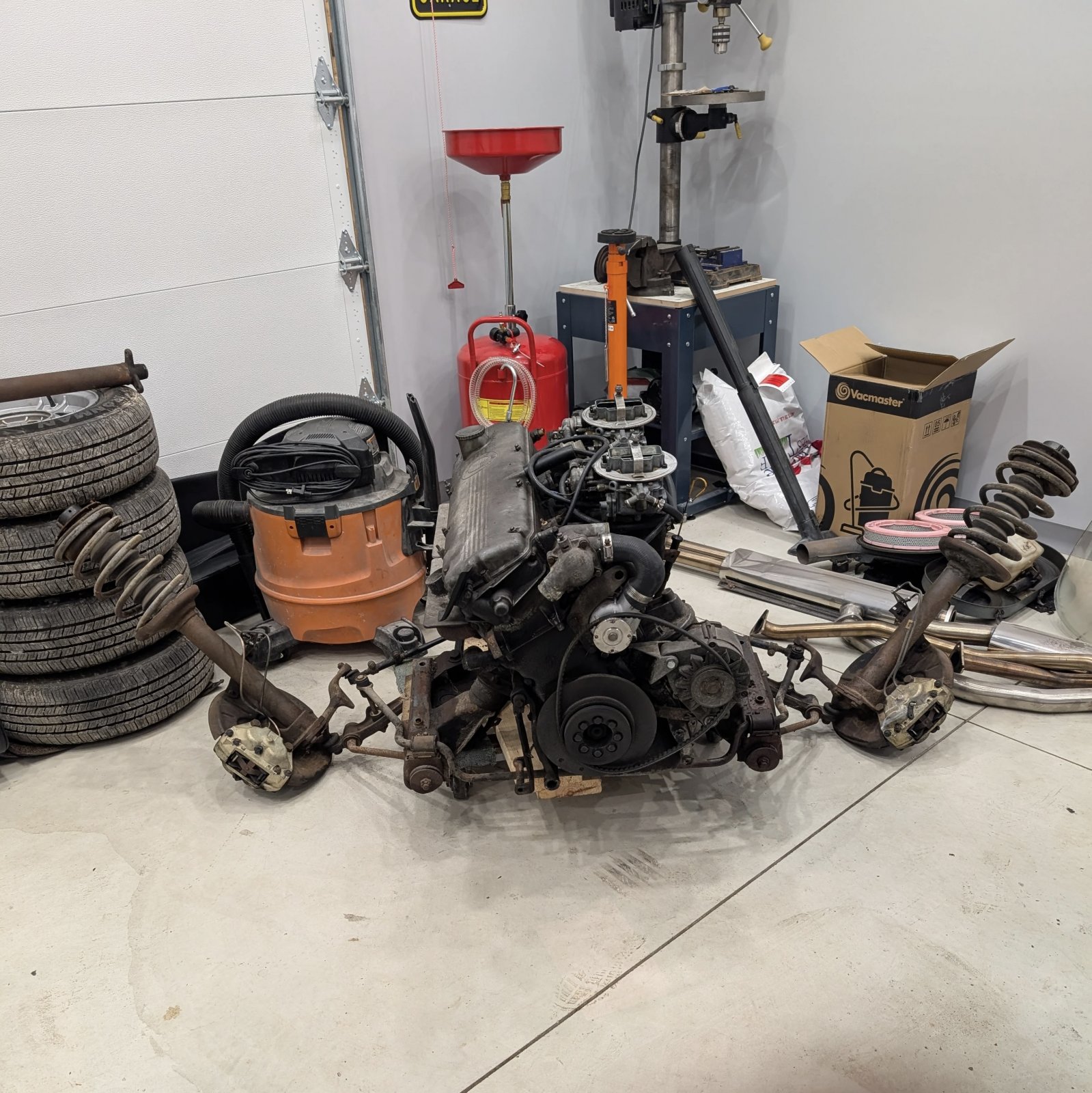

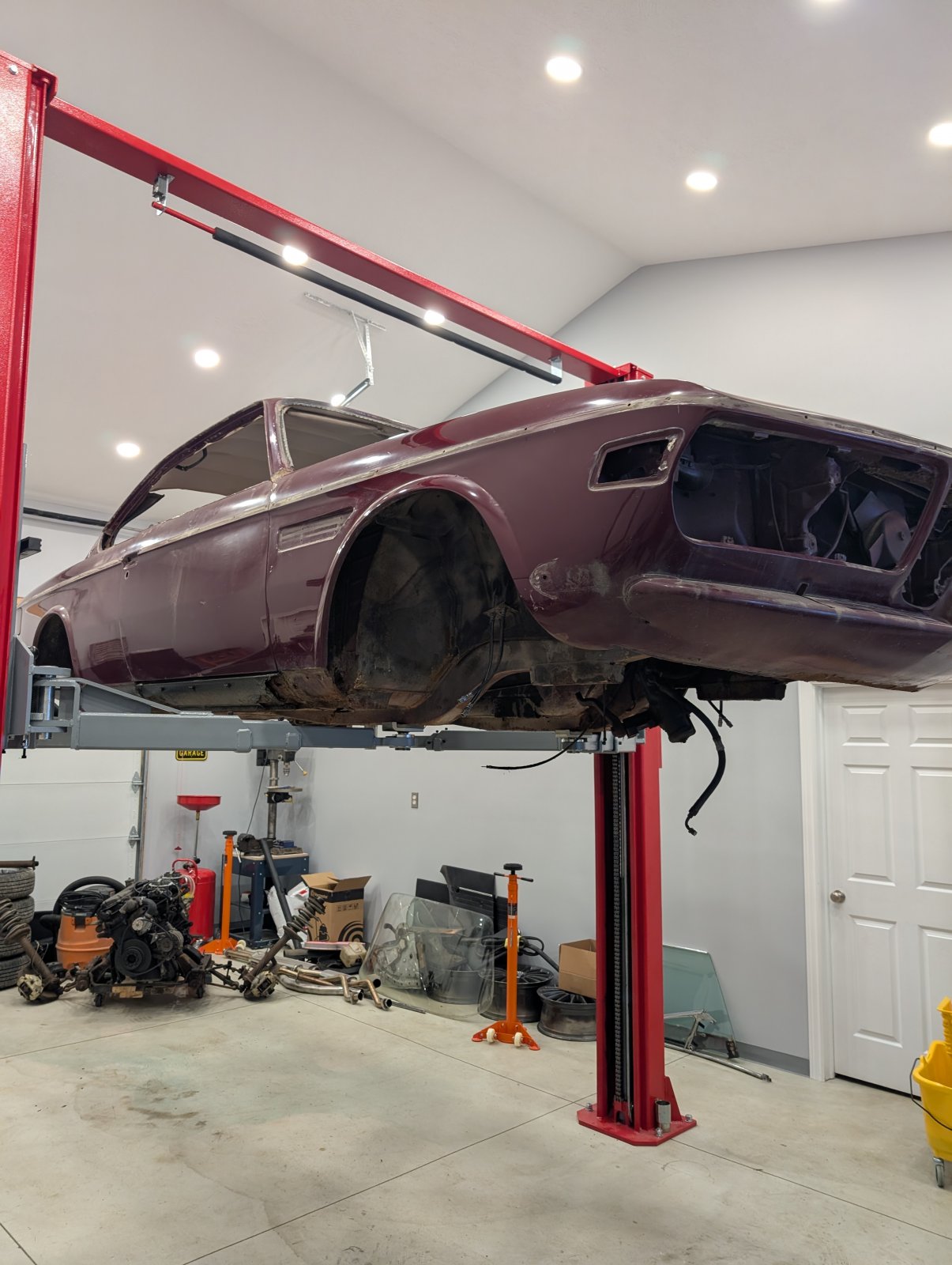

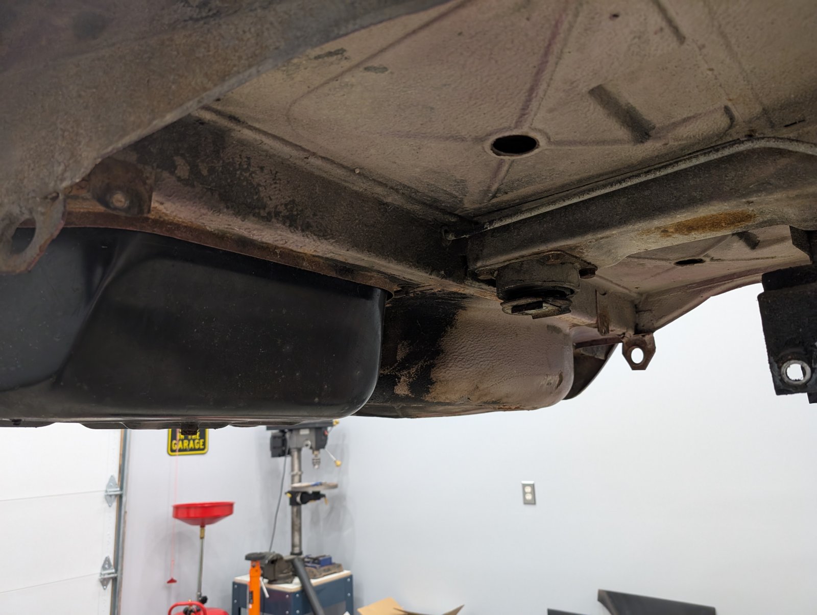

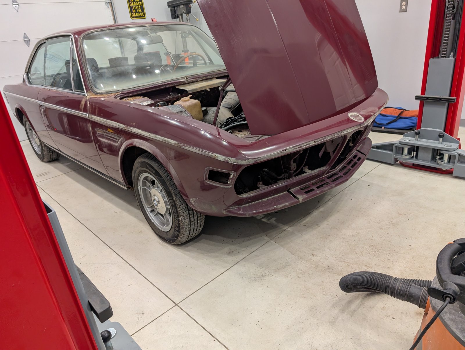

Did the drop the engine out the bottom trick today. That was fun... Until my plan went somewhat south. My plan was to ease the steering knuckle off as I picked it up.
Don't do that... Just take the unit off the rack. So much easier. pardon me if someone had pointed this out and I missed it.

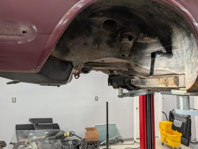

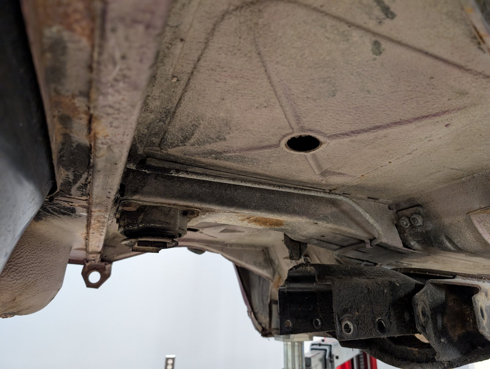

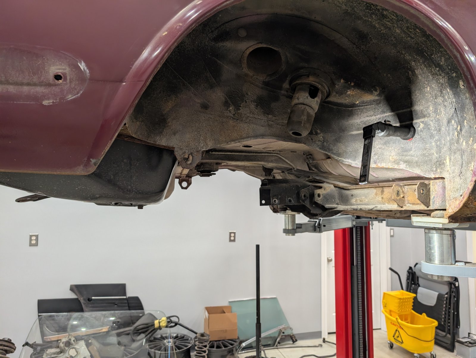

More work done today. Cleared the rear end... Well sans the carrier because my lift is using it right now.
Great shape back there so far... Shock towers great...trunk pan nice. Pretty darn pleased.
I still can't believe that I have not had to cut one bolt or nut off yet. Even the axle shaft bolts although very stuck came out with some wrench beating.

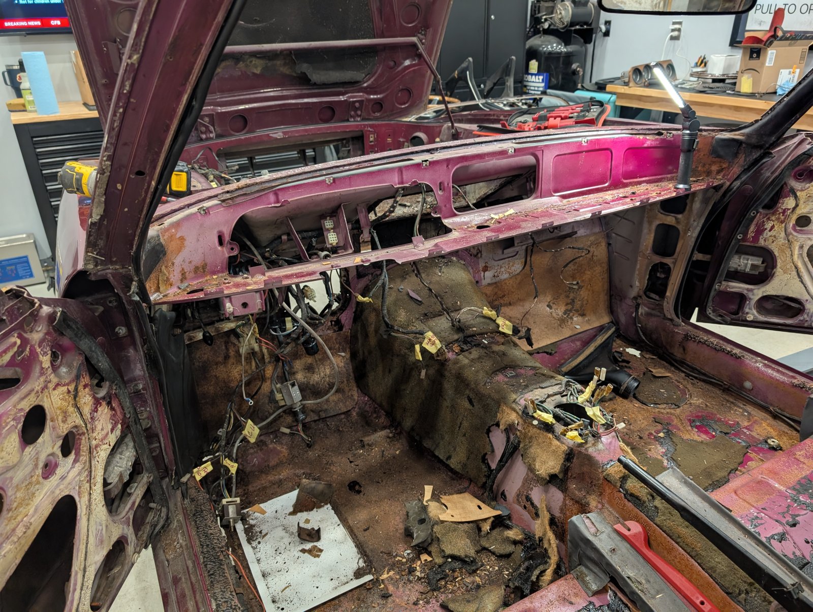

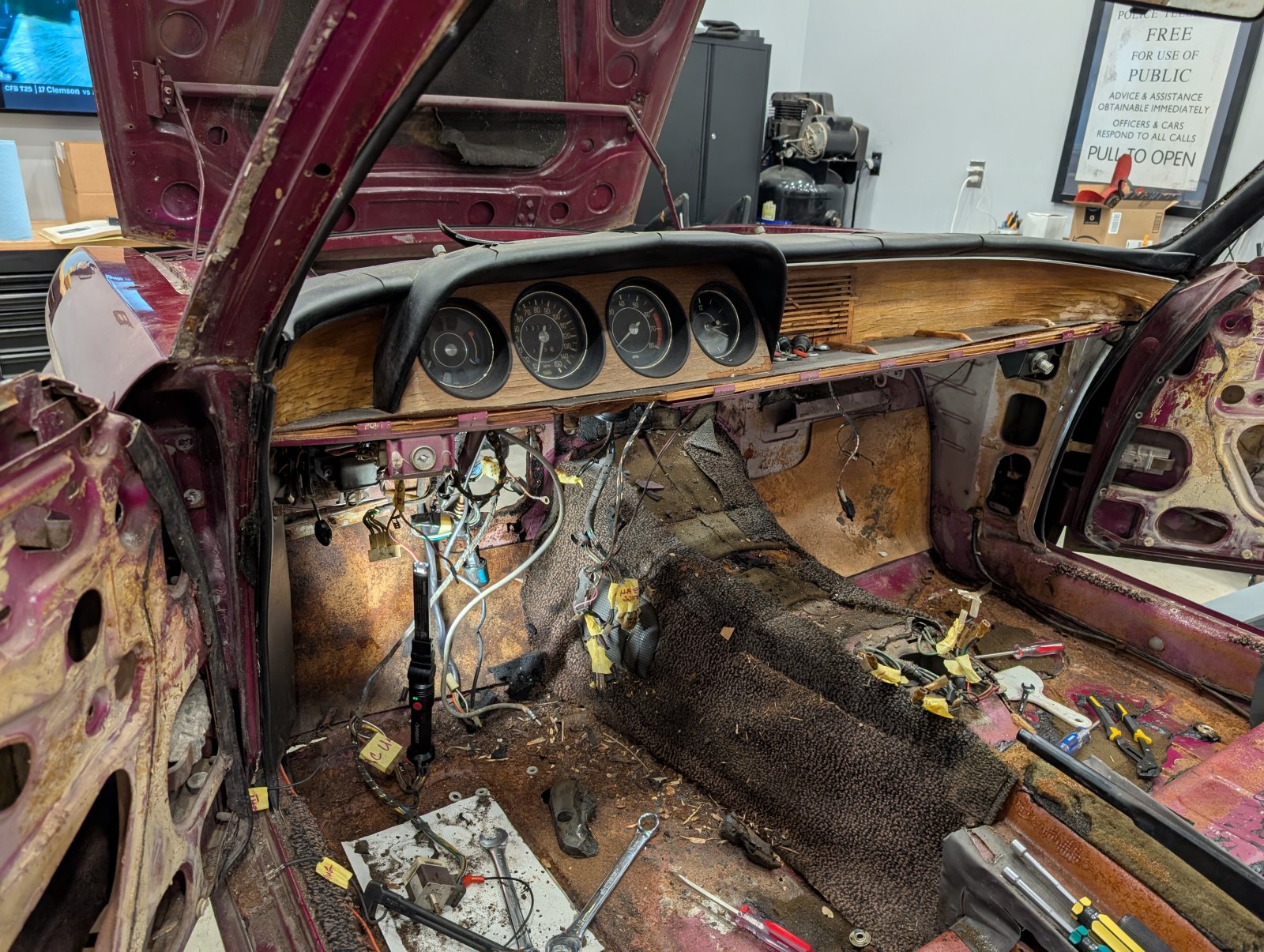

I will say I applaud with gusto anyone that has taken that dash out without the windshield being removed... I don't know how you would have done that.
Once again... All screws came out easily (still amazed at this).
The heater is a total freaking pain in the butt... You all know this.
Wood is crunchy and will require tons of work. But everything came out in one piece... Even the toasted padded dash parts came out intact.
