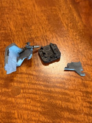

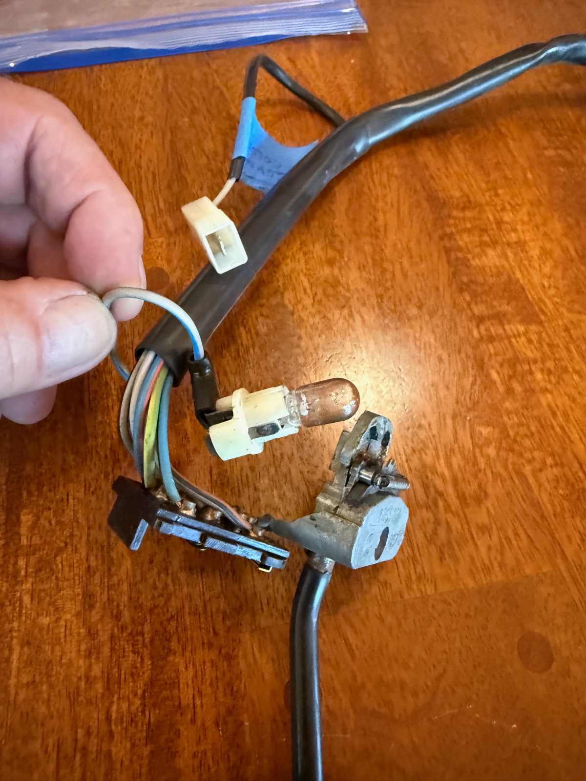

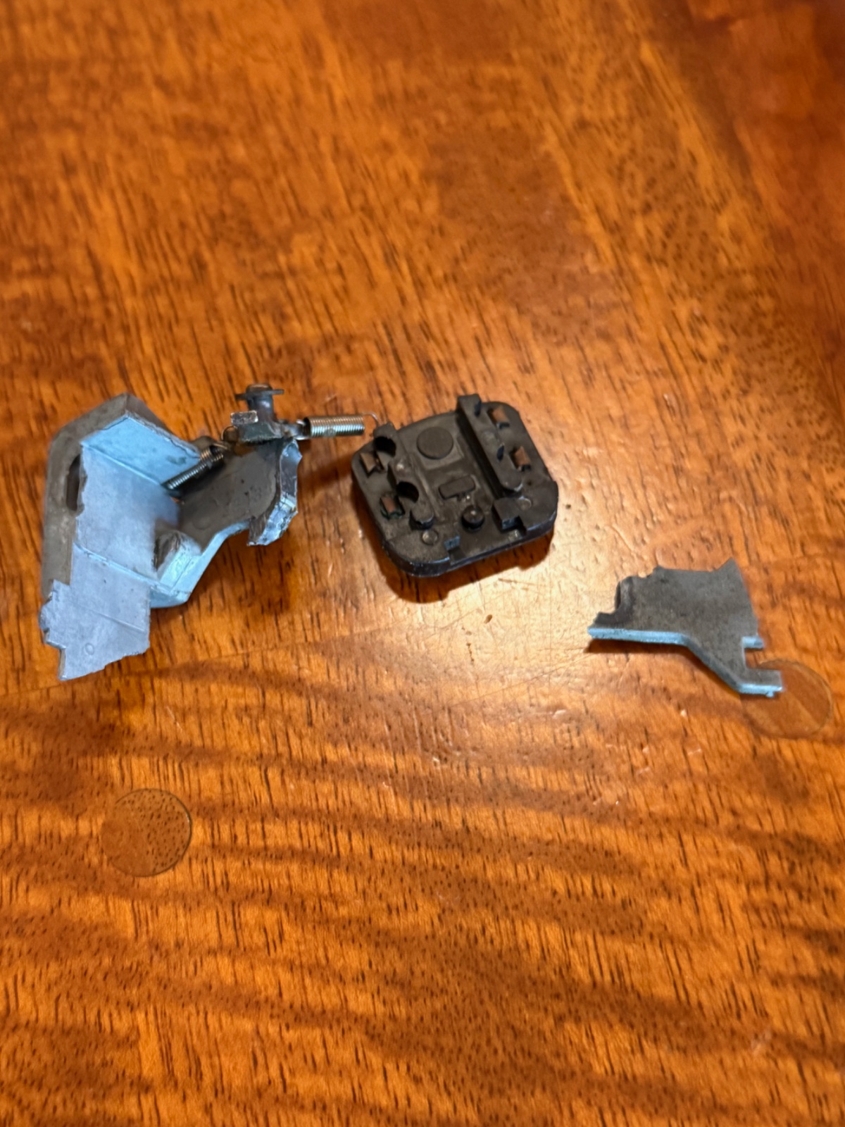

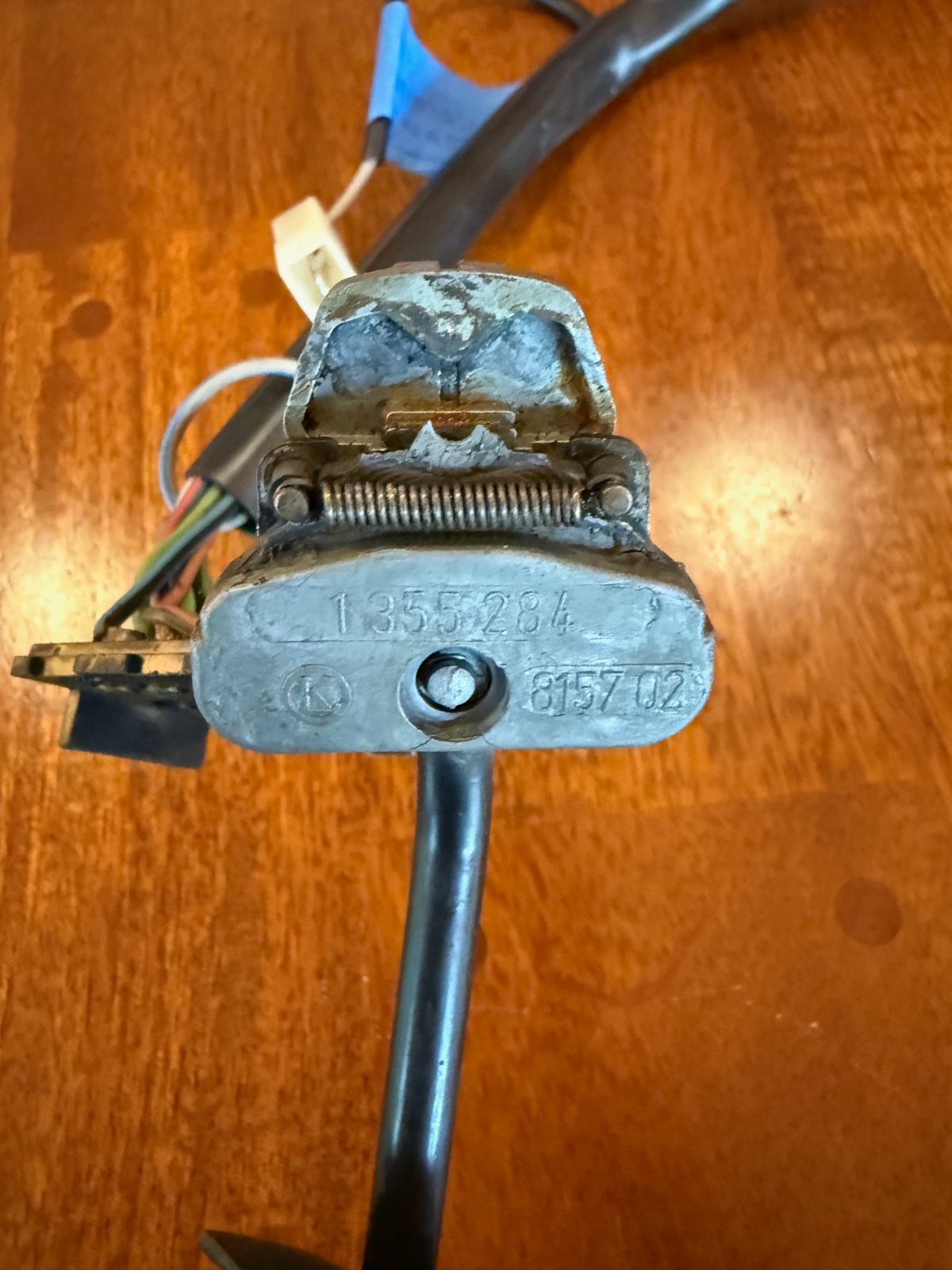

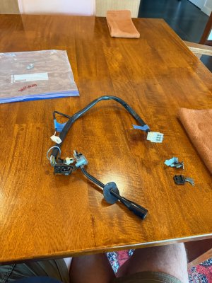

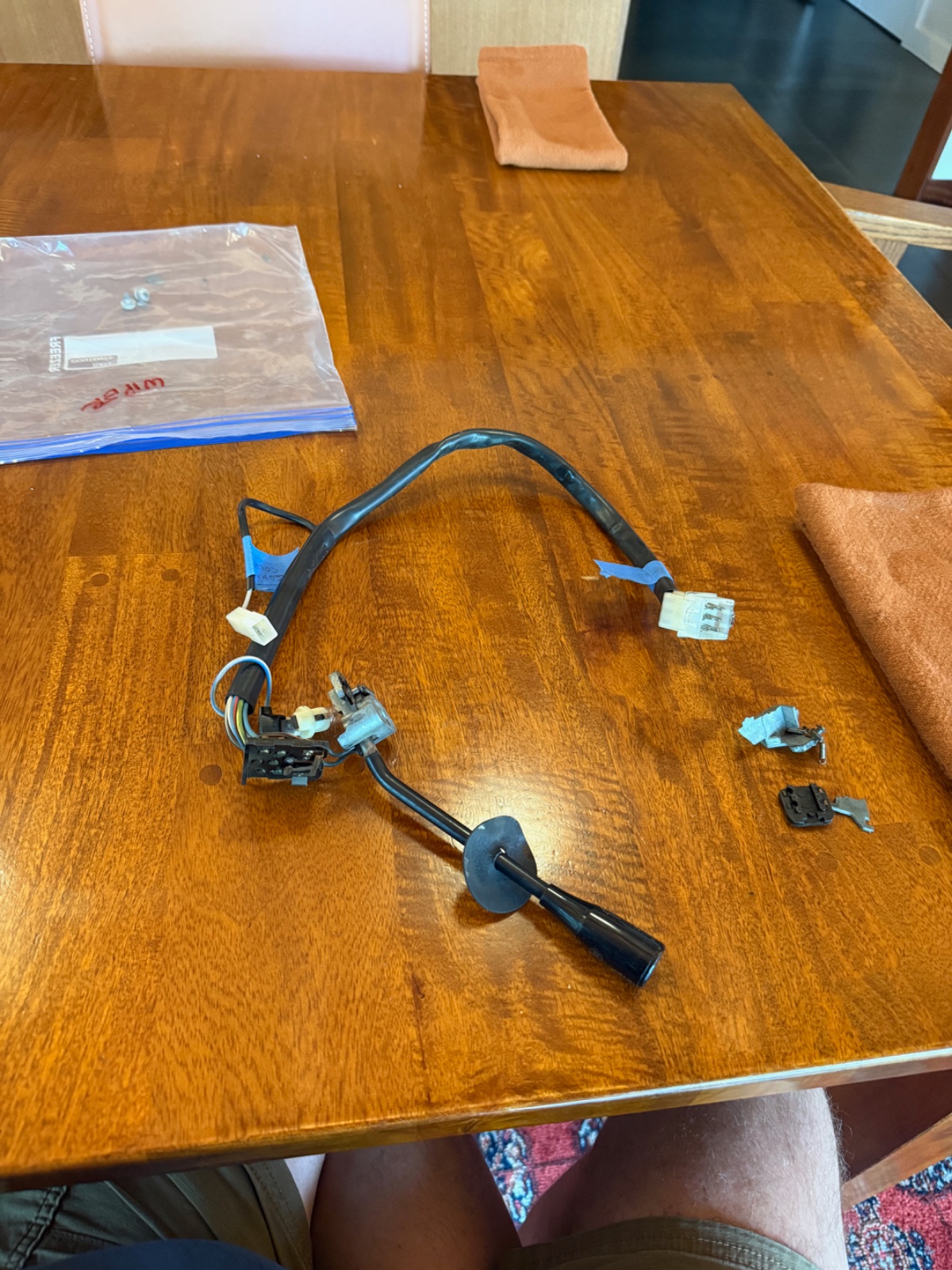

Woot!! Scored a replacement wiper/indicator switch on eBay this AM. My original switch fell apart in my hands when I removed. it. I think the mounting screws were the only thing holding it together!
I have been going round and round trying to find a replacement. There are so many variants out there. Some are only wash/wipe, some are wash/wipe/dip, wrong connectors, etc..
Miraculously today the exact same part number showed up, so I snagged. it.
Here is the switch as it fell out of the column..

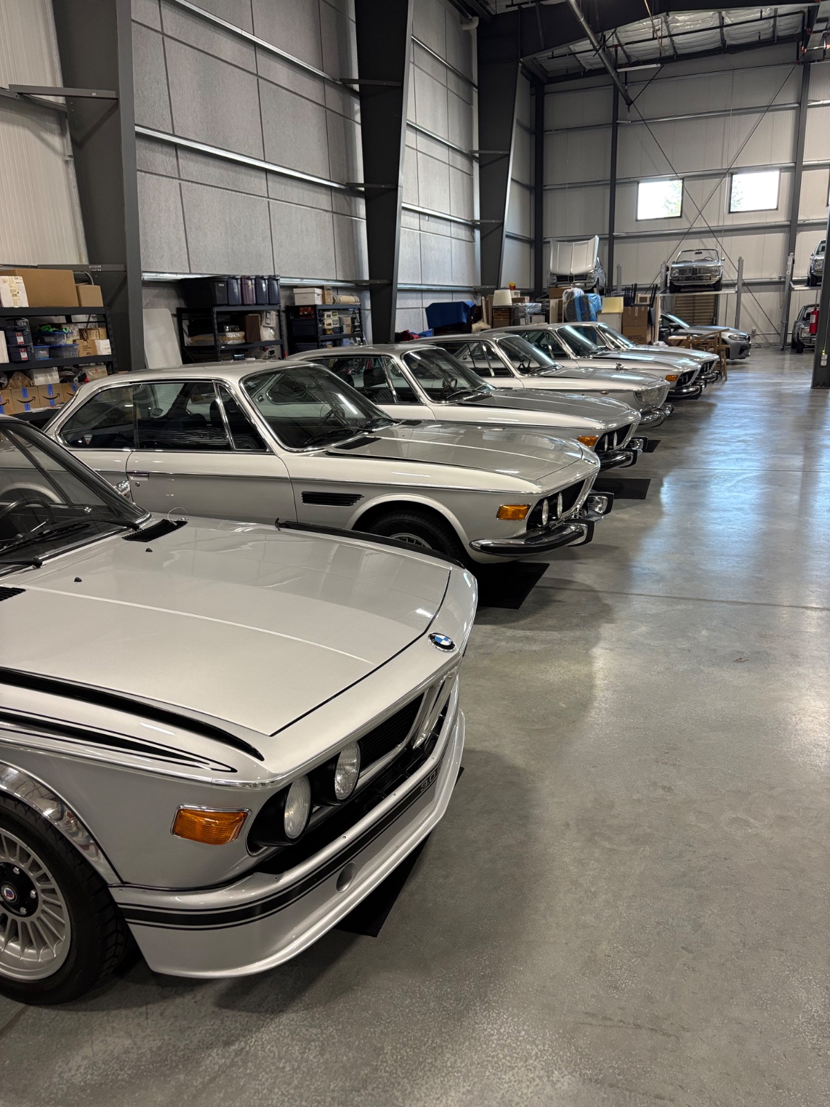

Great to meet a few of the west coast forumites today at the Kusten Fahrt event. Nice to finally put faces to names!
Thanks to @HB Chris and @paul cain for organizing that (even though I only attended the Sonoma museum part).
What a collection! Great meeting you too Scott.

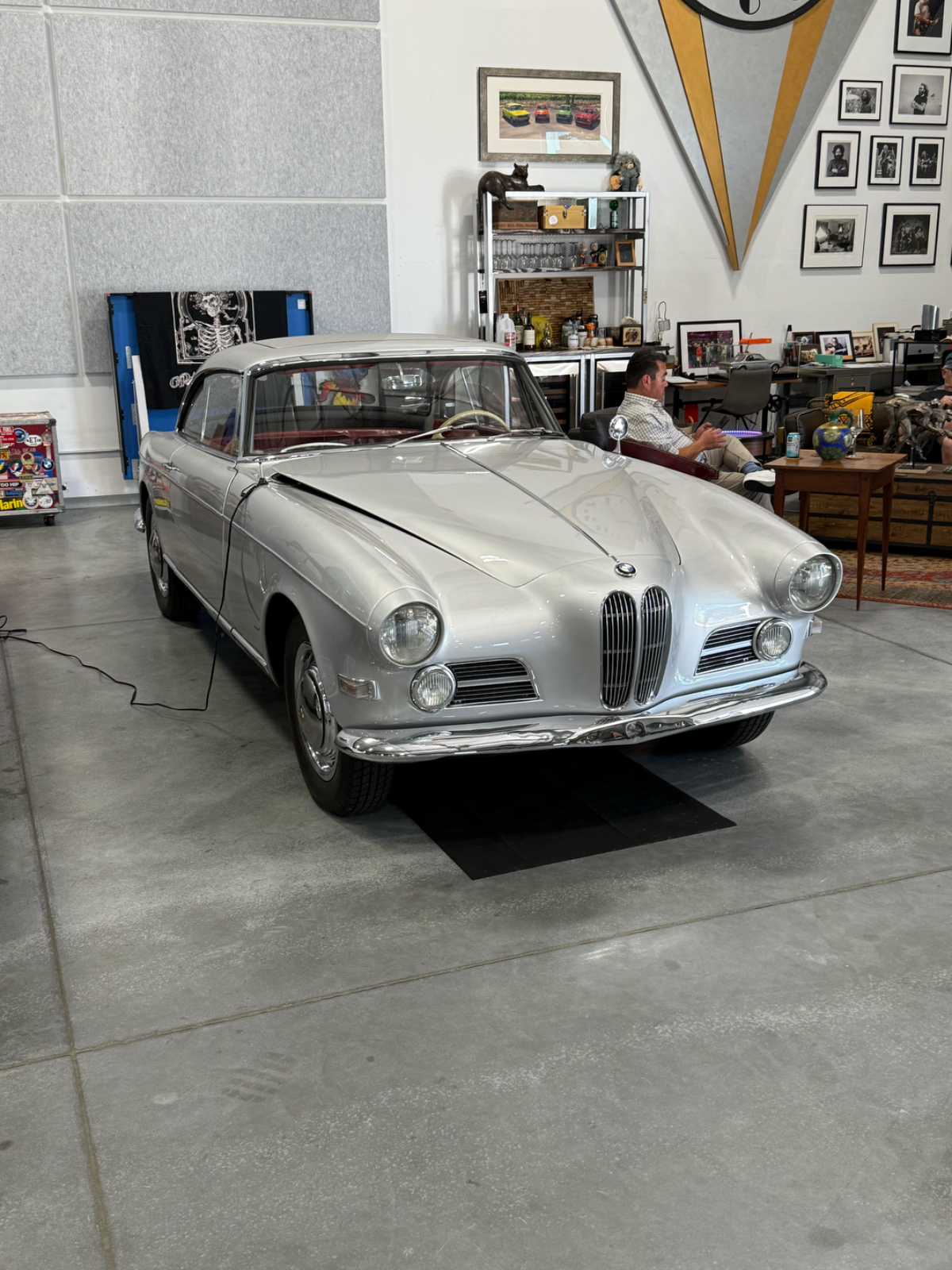

503. Same little V8 as the 507. Shifter on the column. Very lovely lines. Not much fun to drive. They made a cabriolet as well.
WOW! That IS rare... Only 412 made..
"The BMW 503 is a rare luxury grand tourer produced between 1956 and 1959, with only 412 units made, often overshadowed by its sibling, the 507. Known as a "forgotten" post-war classic, it was styled by Albrecht von Goertz, powered by a 3.2-liter aluminum V8, and featured advanced electro-hydraulic windows."

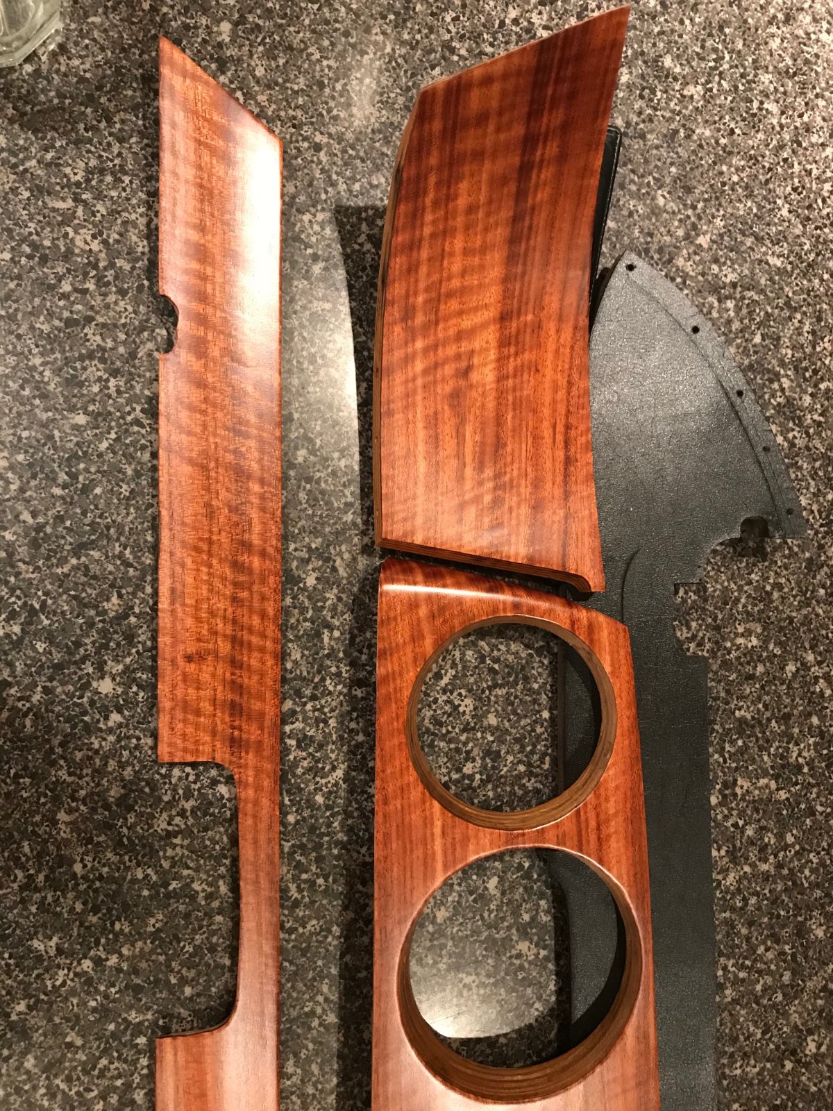

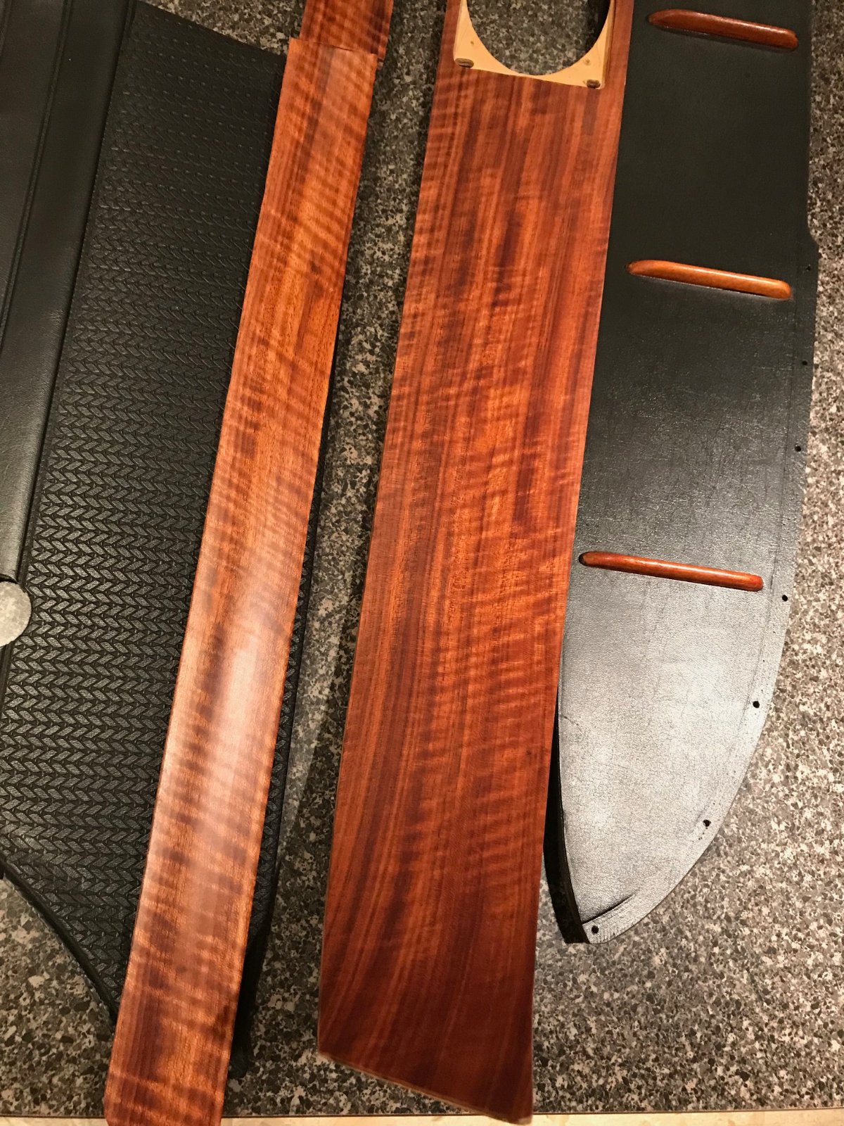

Went to the shop to work on my 635 smog box project, and got side-tracked by my E9 instrument cowl. TomHow is sending me a new curved wood section for the dash, and I'll be veneering that and the rest of the salvageable parts using Etimoe (I believe this is pronounced Et-Ih-Moy). So I picked up the cowl and noticed that the veneer was cracked and crazed. I lifted a section with a fingernail and it peeled off. Inspired I took a bare utility blade and slid it under the veneer. It all came off in large sheets! Sohaving avoided hours of stripping that I was dreading, the cowl is now ready to veneer. I'll attack that when I return from Austin in a week or so...

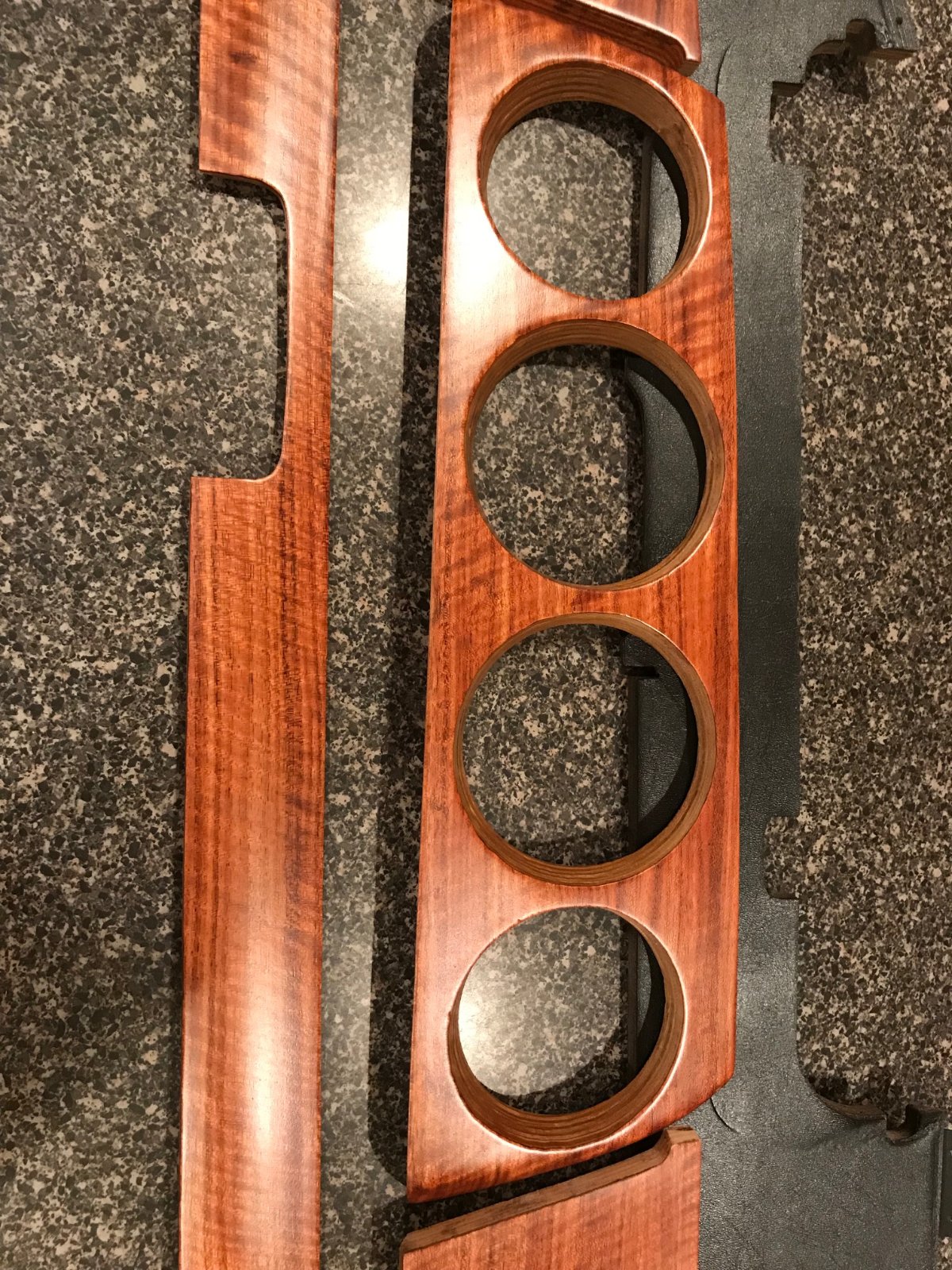

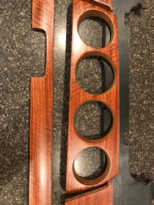

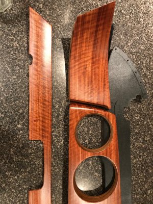

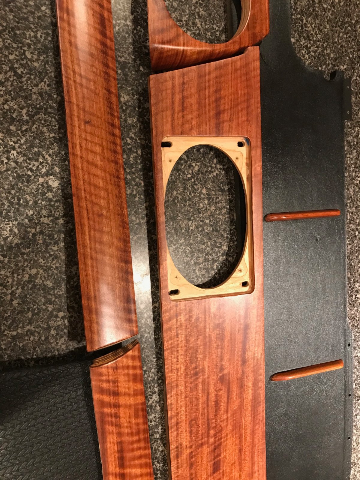

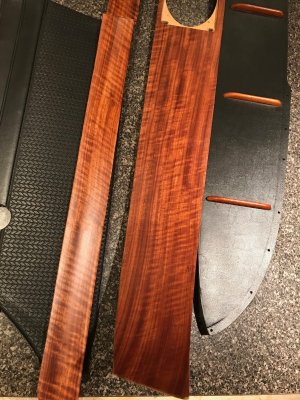

i have always heard it pronounced eh-ti-mo-way. great veneer. i bought a few figured sheets on ebay that were quite large - about 10" to 12" wide and 100" long. i pattern matched the door wood to look sequential
