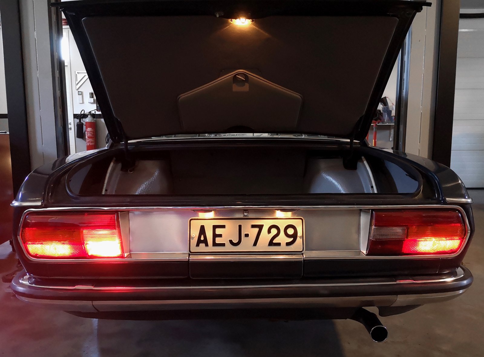

Thanks Andy, here is a picture with tail lights ON and stock fog light ON:

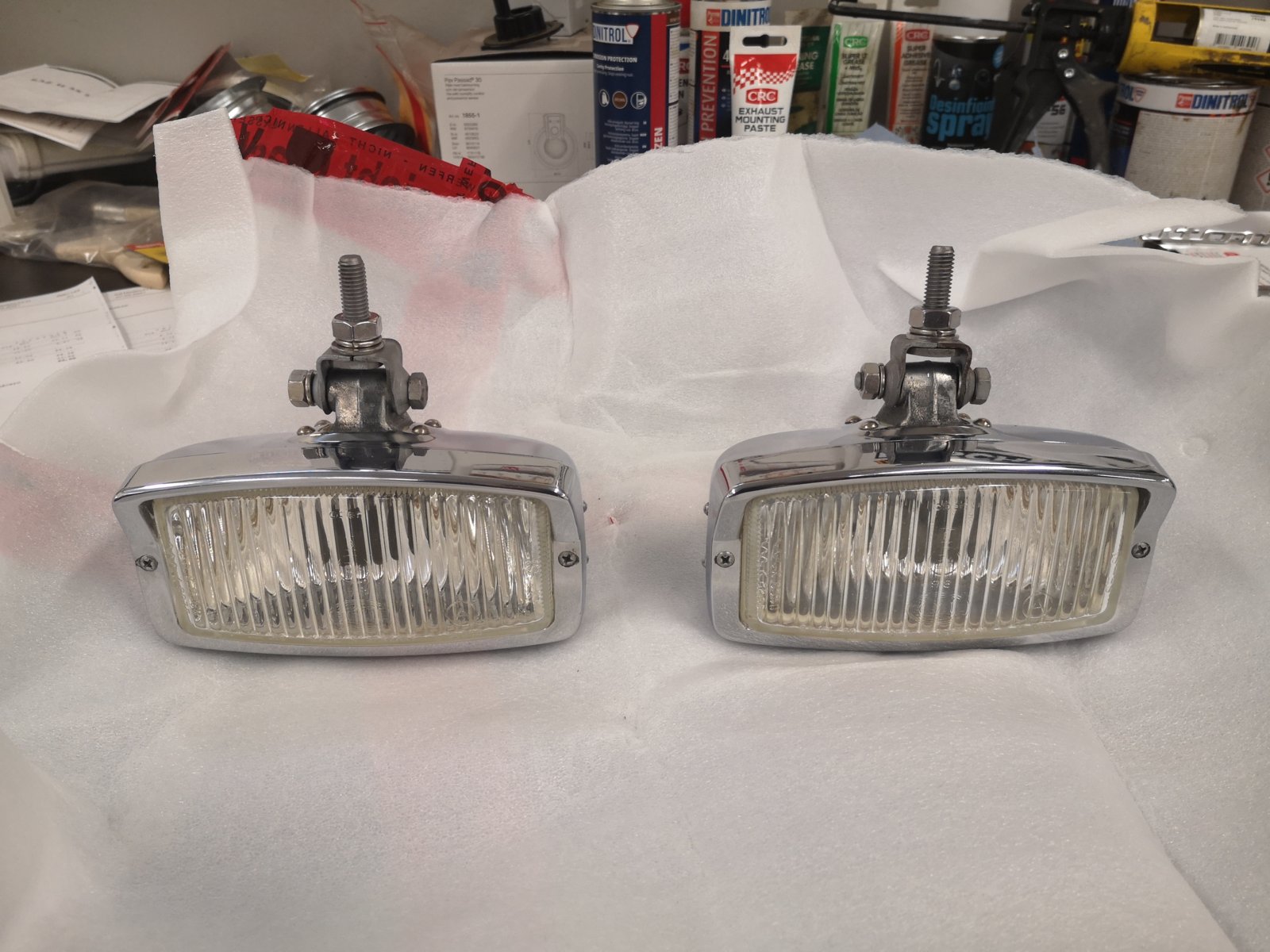

Talking about fog lights, I just got home a set of really nice Hella 139's to go on the car as soon as I have some time to make some brackets for them.

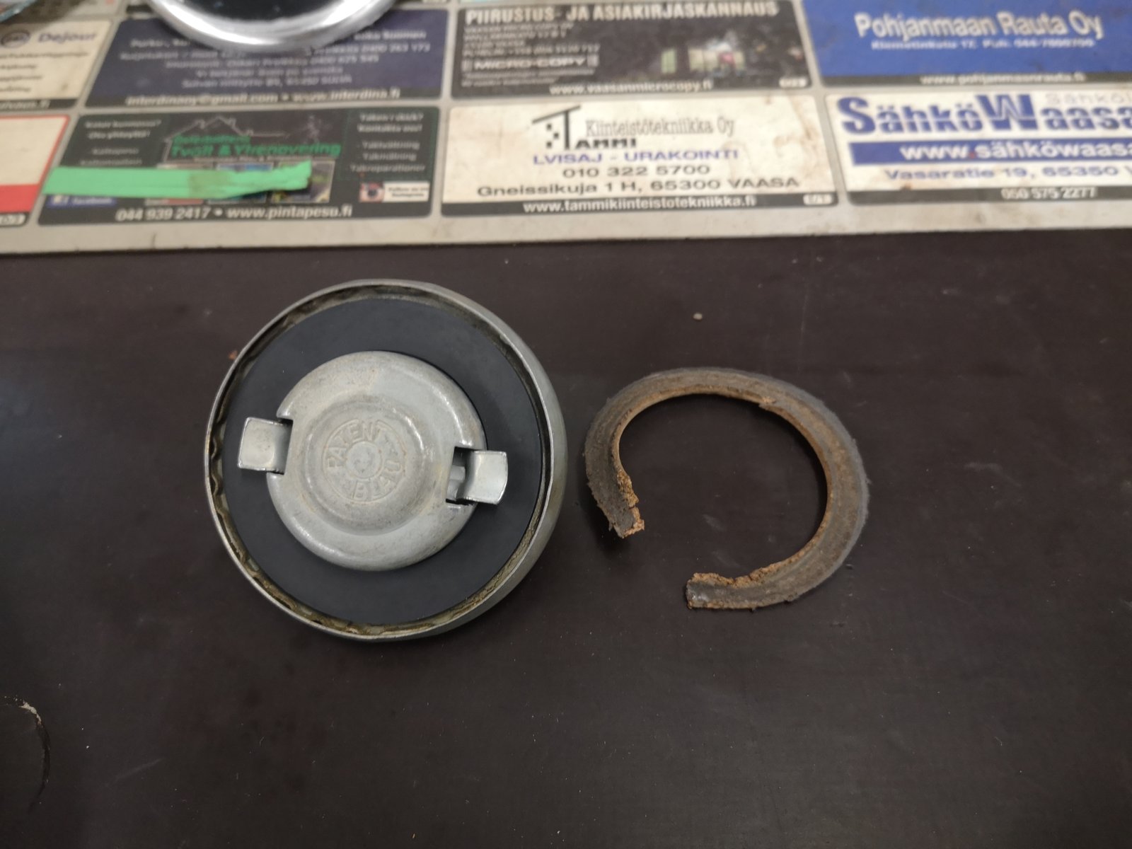

Got rid of the gas smell in the garage, easy fix!

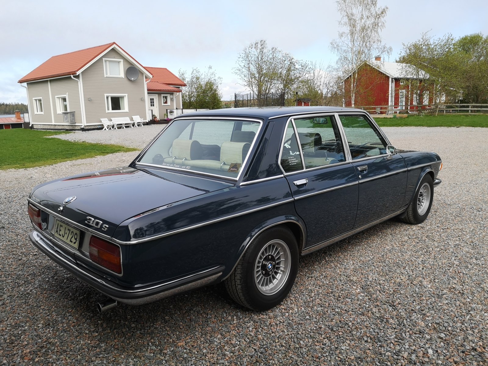

Someone has installed a 55mm rear end exhaust pipe, even if 60mm would be the correct size.. But to make the best out of the situation I bought a new chrome end.
Out waiting for the last snow to melt and roads to dry up a little more, also booked for a much needed professional polish + wax session, the paint is oxidized and dry at the moment.

I agree, Atlantik looks good on any vintage BMW model. I LOVE that interior, I don't think I've seen that before. Interesting bubbling at bottom of gas tank..... looks like? Kind of unusual bubbles, maybe gas leaked and reacted to paint and primer over the years? First time seeing that. Amazing detail job, looks like a new car. Love the ownership history too! That's always cool.....keep up the great work! I realize it's automatic, but what are your initial thoughts driving this vs. the coupe? Biggest thing I notice is the ride height is higher.. Sitting lower in a coupe makes it seem like you are driving faster than the e3 where you sit higher.

The bubbles on the underside of the car + tank is the Tectyl rust preventive coating that the car has gotten several treatments of, so it's quite thick at places and looks like bubbles. It's a nightmare when you need to do any kind of maintenance on the car, as it's very soft, sticky and oily = quickly becomes a mess but at the same time that's what kept the car from rusting all these years.
