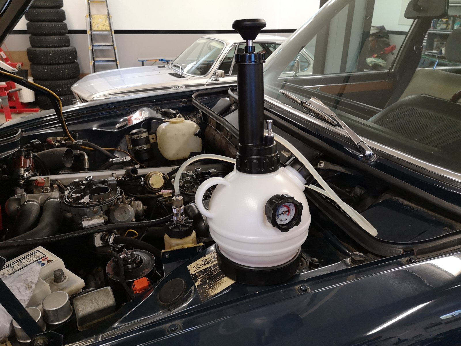

We had of course planned on flushing the ATF fluid anyway, but reading about your success we started the process straight away. What came out of our BW was nasty!
It wasn't burnt, but it had been there for ages I suppose, no particles in the filter. We flushed the gearbox a total of 4 times (oilpan down each time to change as much as possible). Got a new gasket from BMW which was not great, I guess the original one was cork, and the available one was not, so it did leak as the new gasket wasn't soft enough. Had to put some sealant on both sides of the gasket and then it worked as it should..
Anyway, the gearbox shifts much, much smoother now! Thanks for the advice :)

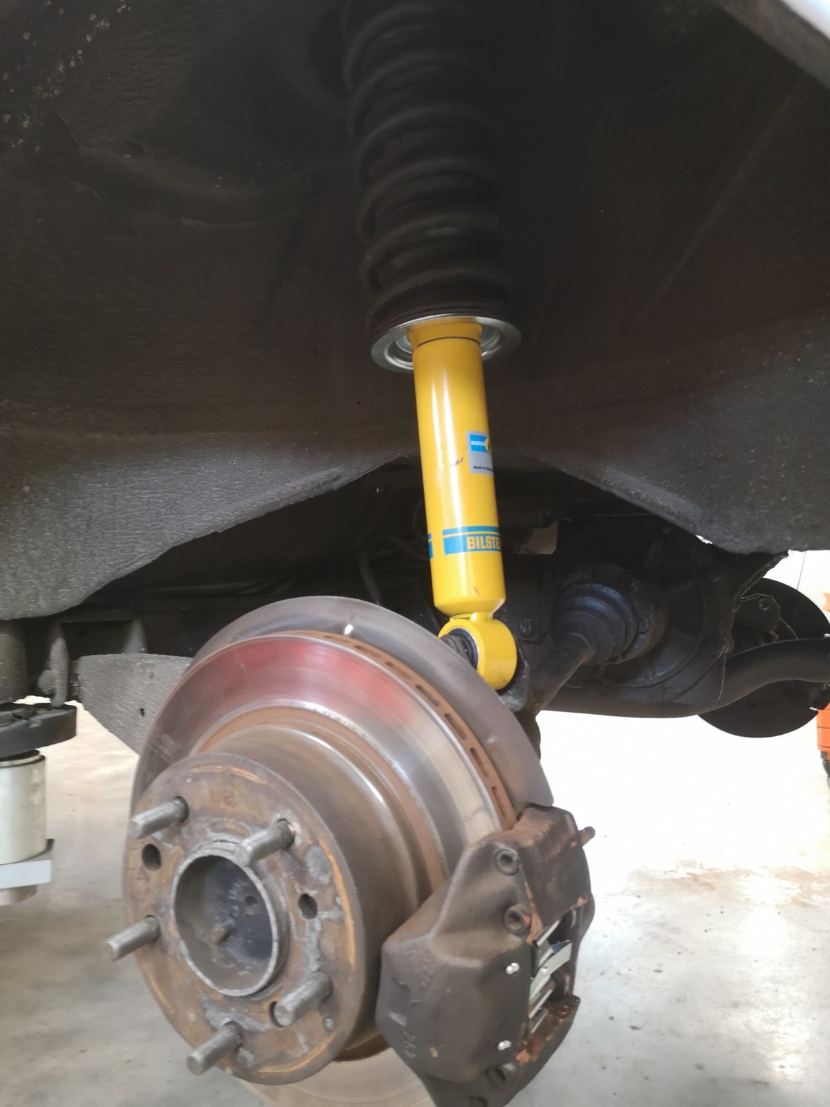

Otherwise we've just been enjoying the car as much as possible when time allows, between maintenance and upgrades.

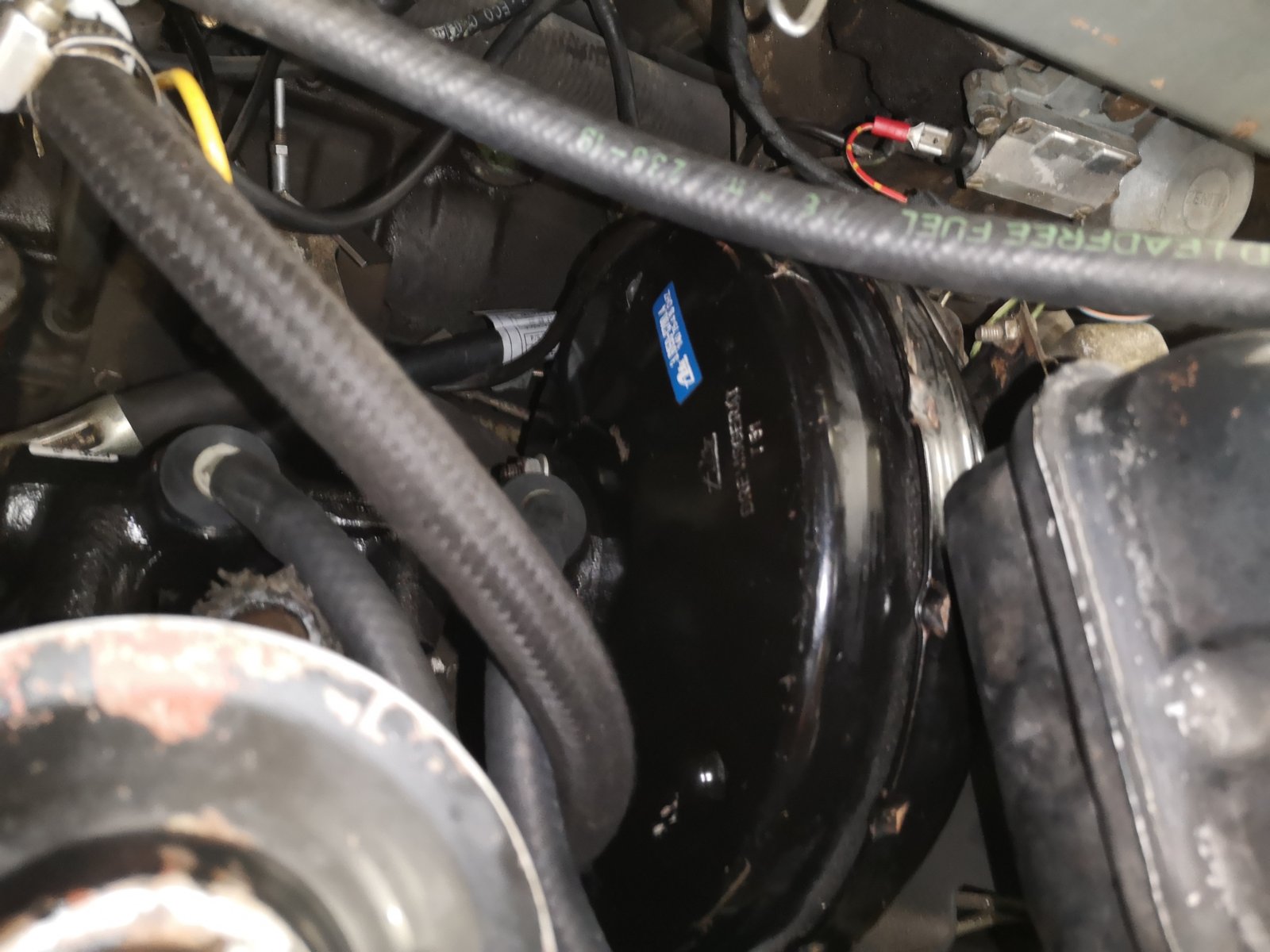

We've installed new Bilsteins, refreshed most of the brake system, replaced some steering linkage, installed a pertonix, played around with the Zeniths, replaced some gaskets here and there, then the MC had leaked into the brake booster, resulting in a leaking brake booster from the brake fluid built up inside of it.
Fortunately @Keshav helped us (as always :love:) find a really nice booster so we bought a new MC and installed the 'new' brake booster with it.
