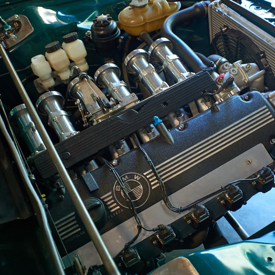

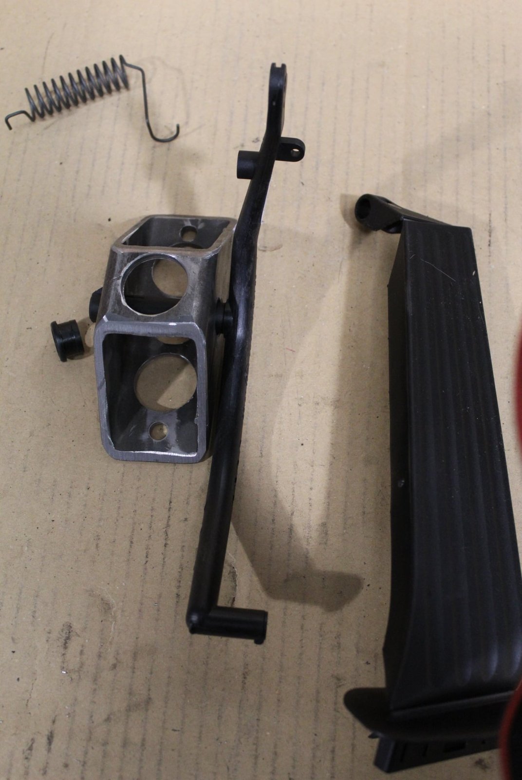

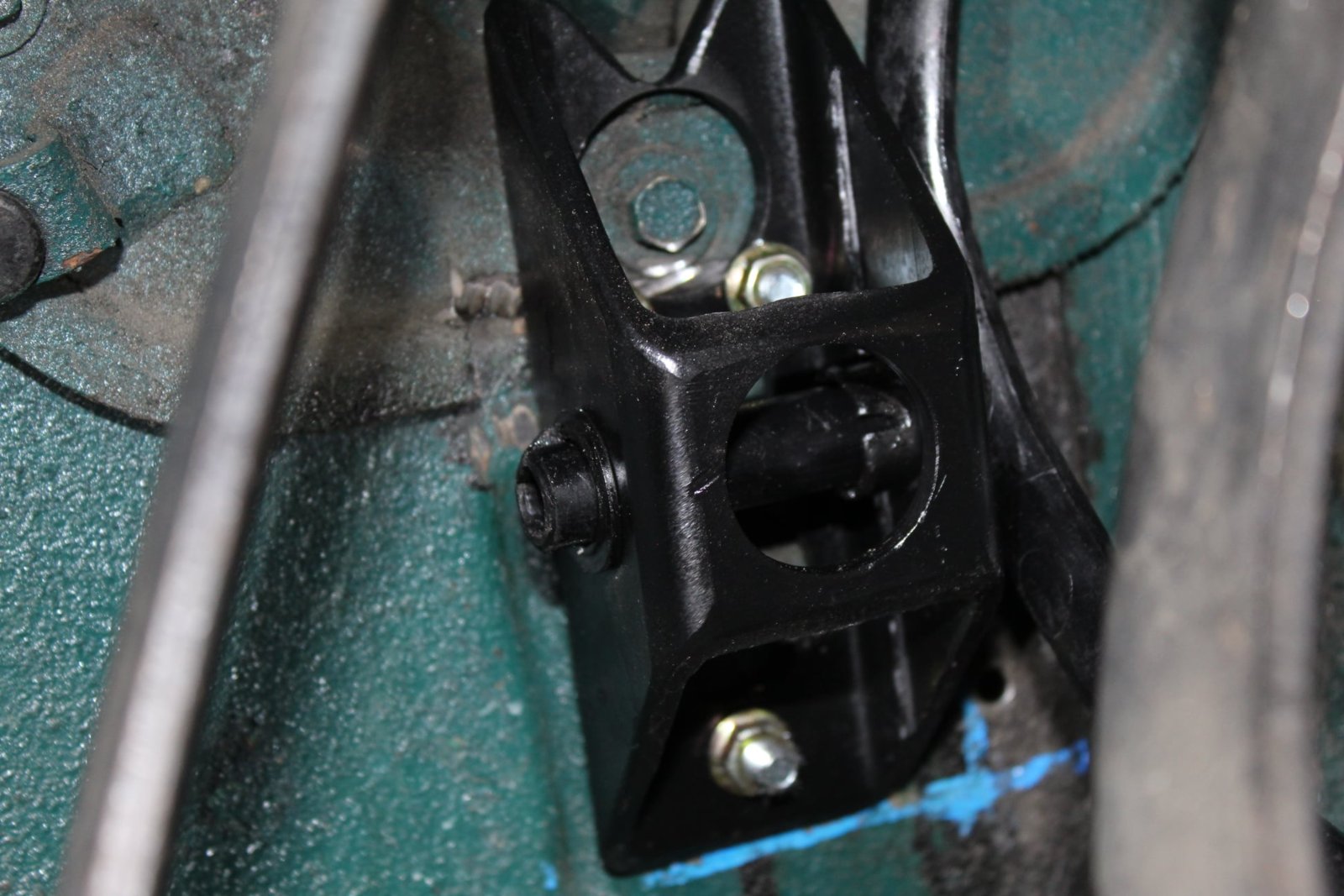

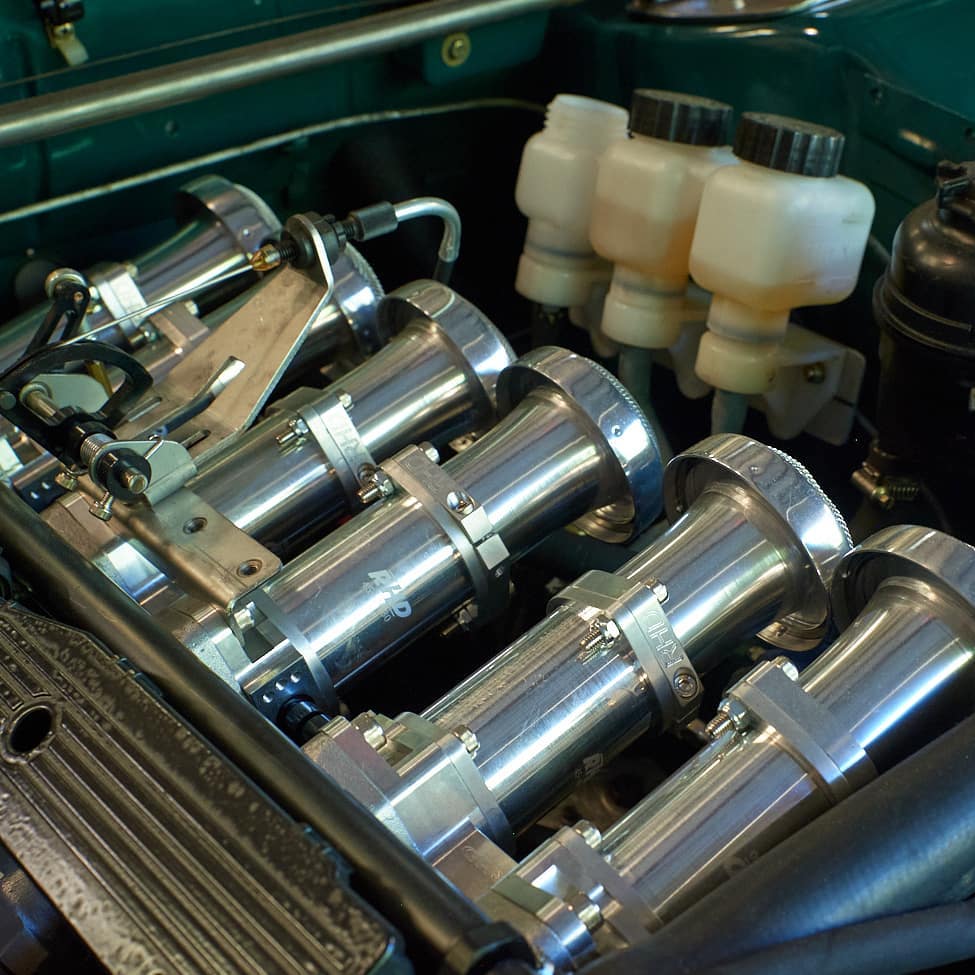

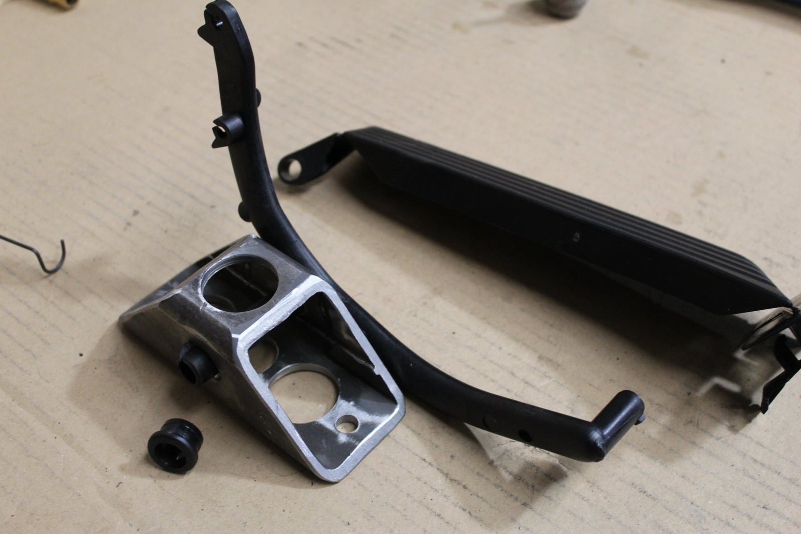

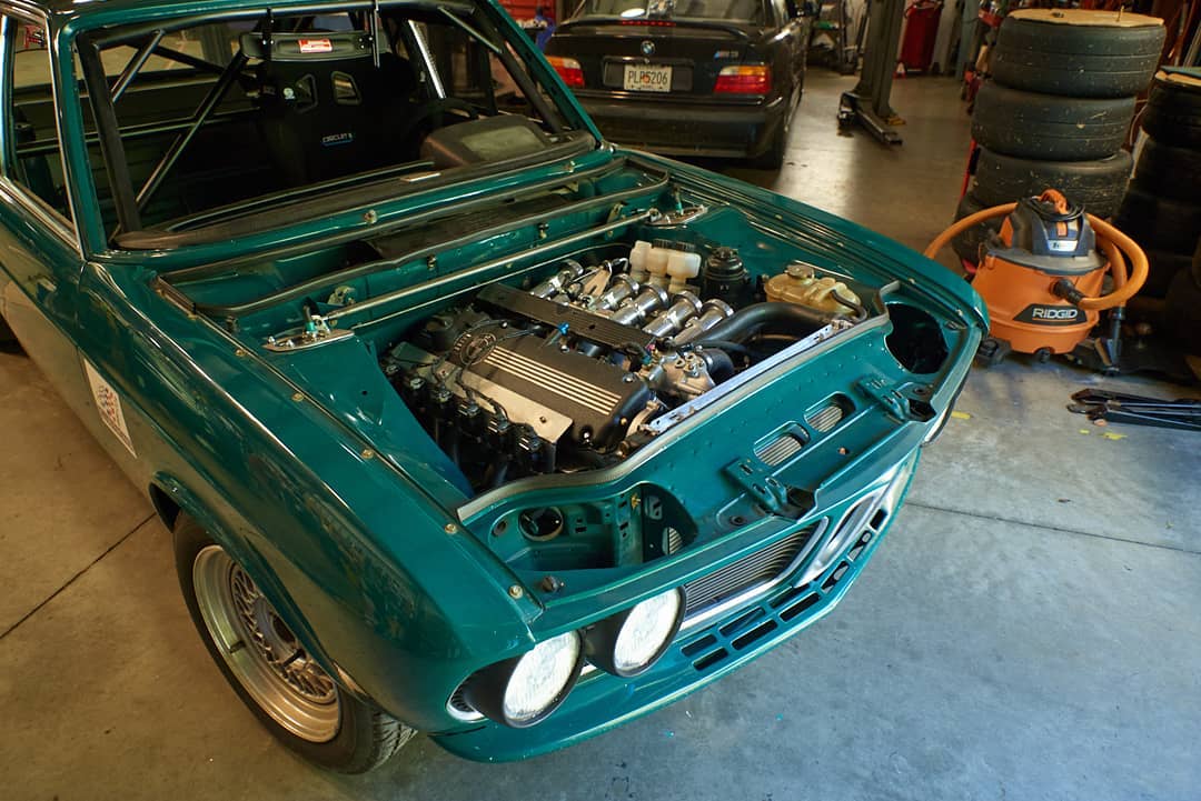

One of the last things I needed to do before loading the Bavaria up to the Cage builder was to mount the new throttle assembly . The ITBs are cable operated which wouldn't work with the rod operated older BMW throttles . I got an E36 cable and pedal assembly and made this bracket to hold the assembly 171275396_2934666783523771_5879036229758057756_n.jpg166269681_2924189984571451_8049799081271789923_n.jpg154633797_2902313453425771_534487191742232794_n.jpg154371672_2902313313425785_4938520624946898816_n.jpg

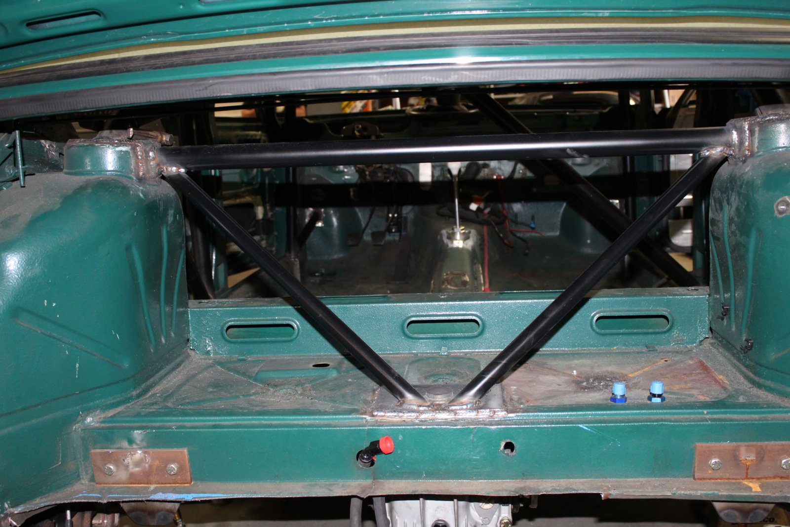

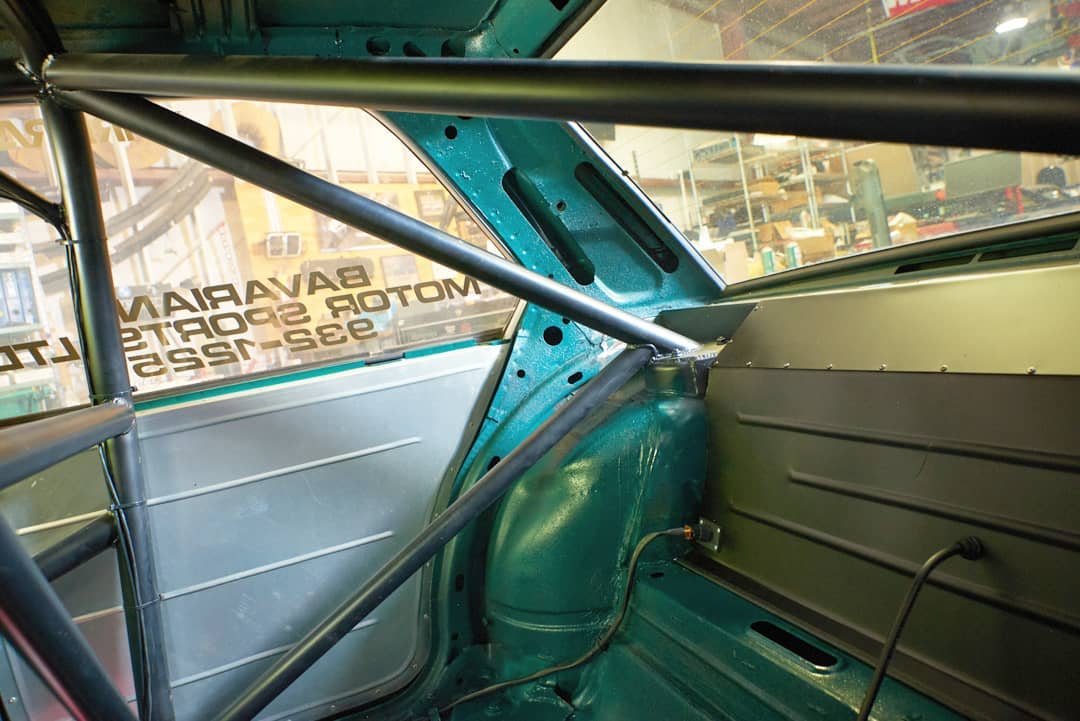

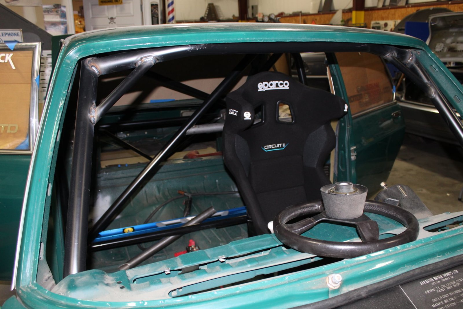

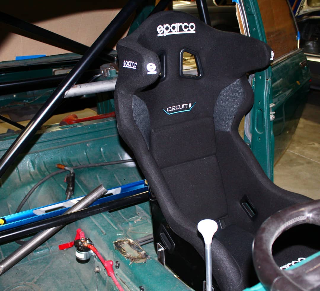

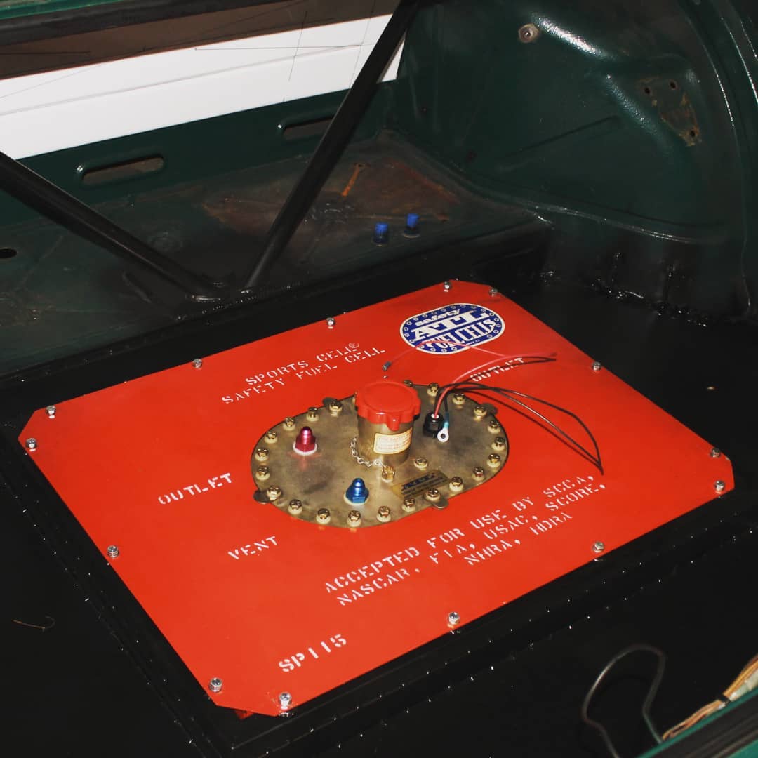

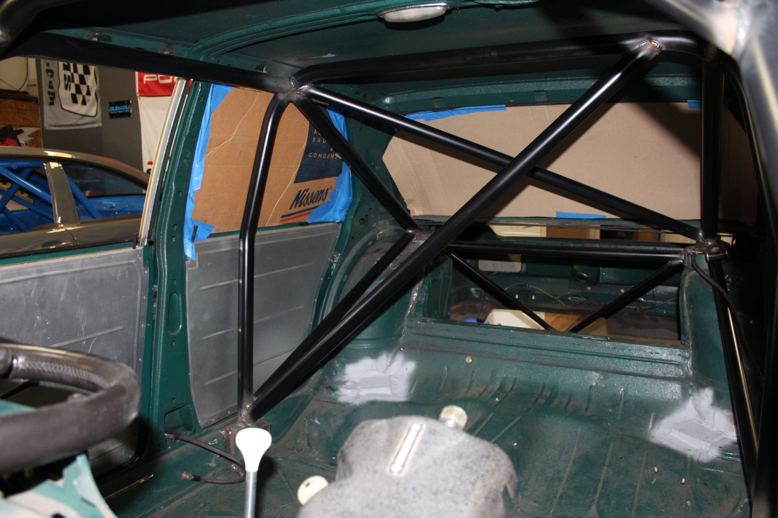

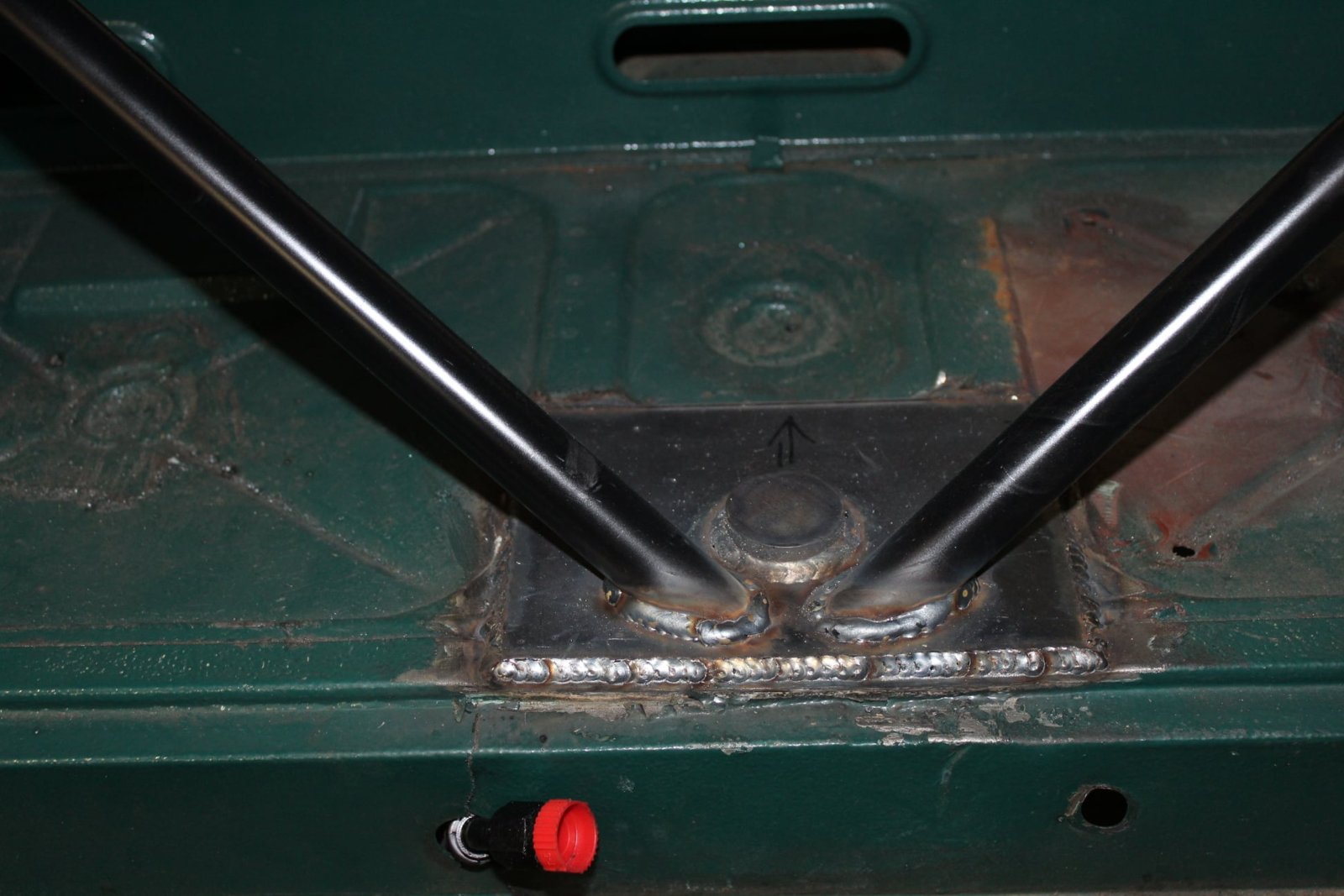

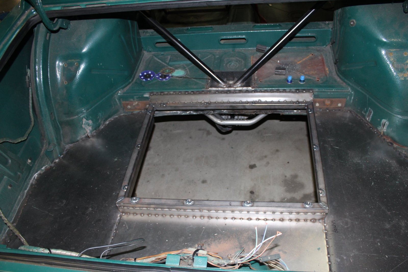

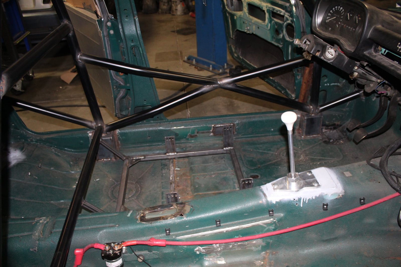

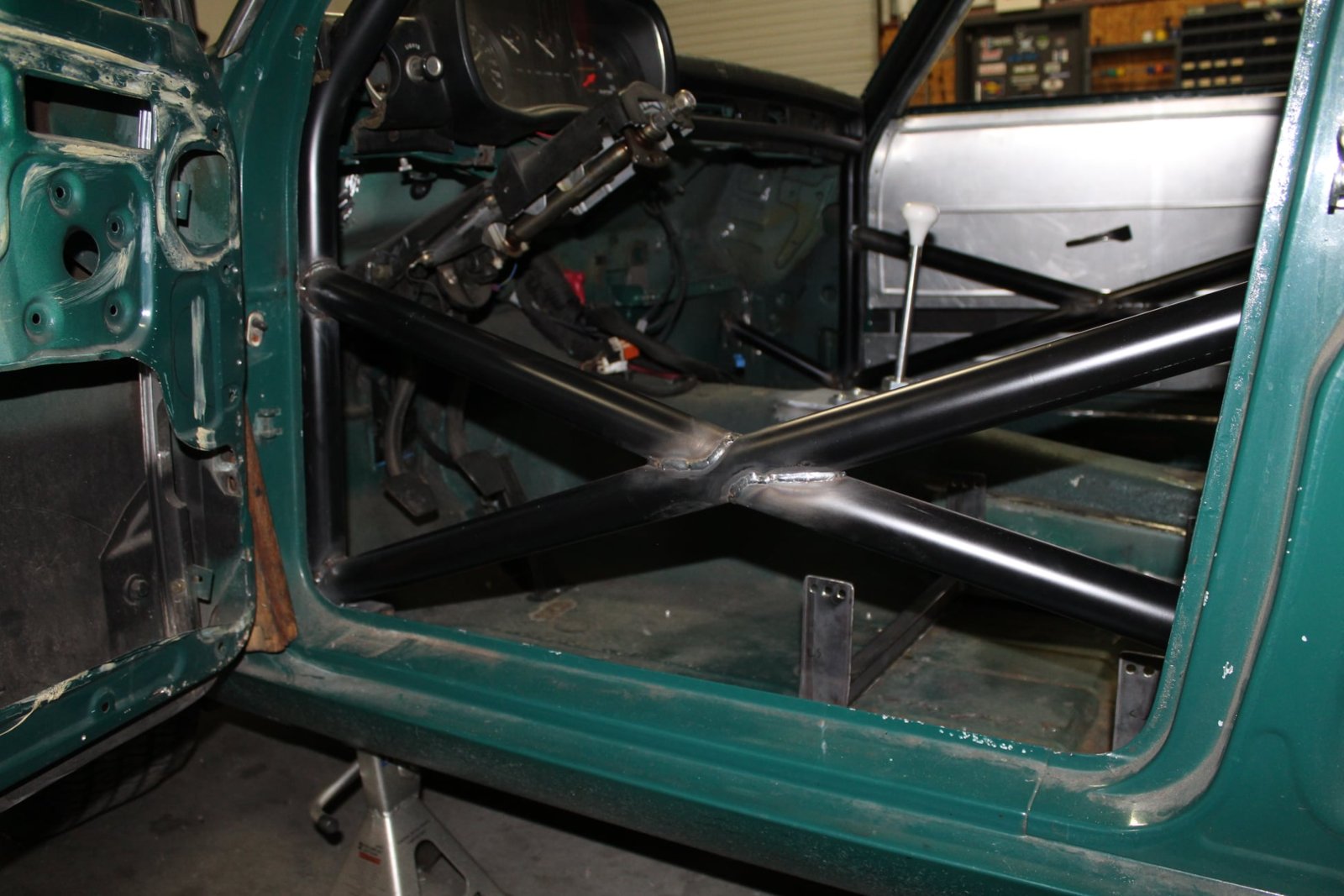

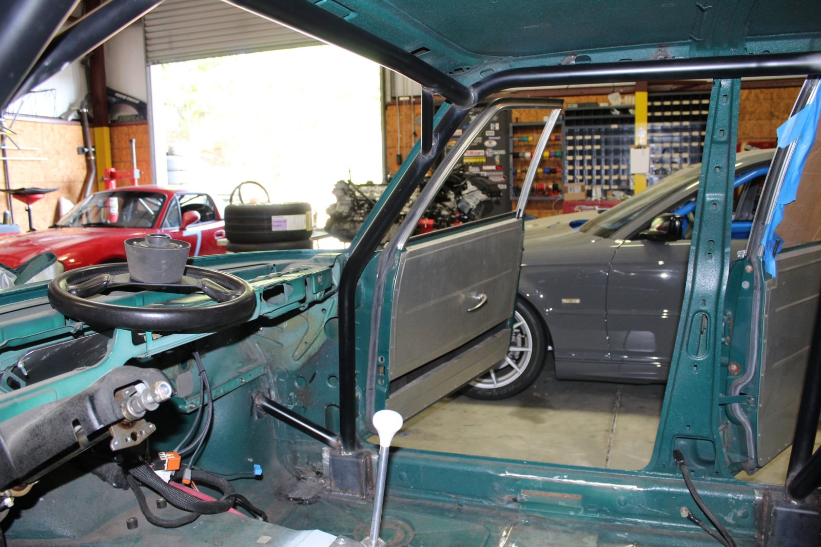

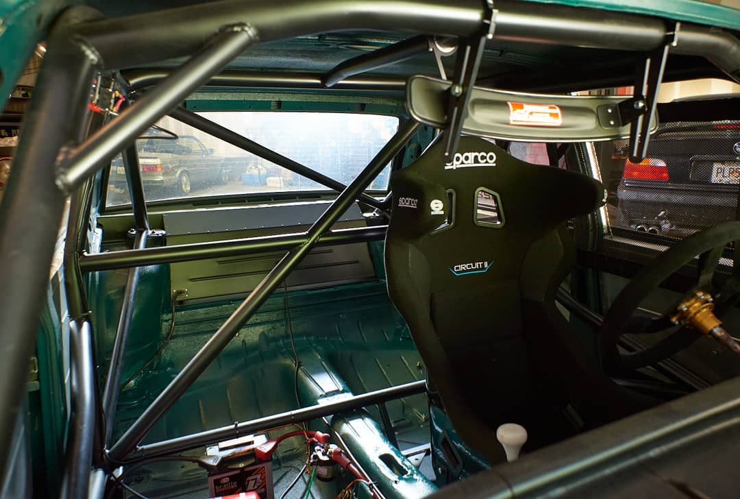

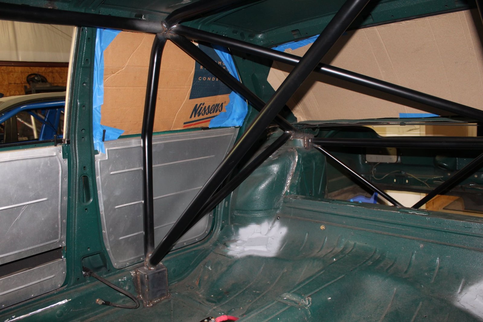

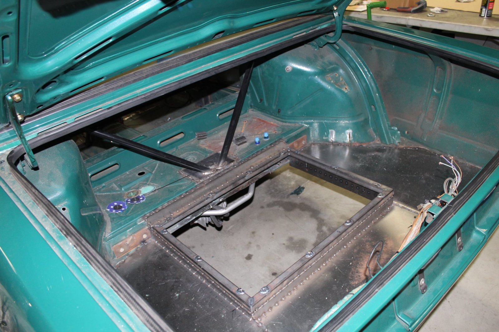

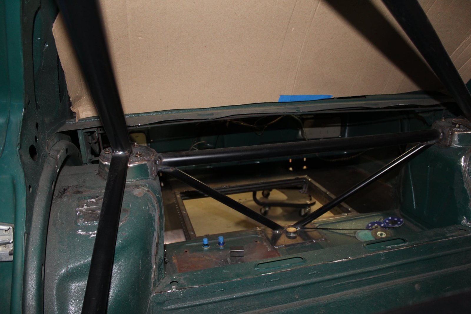

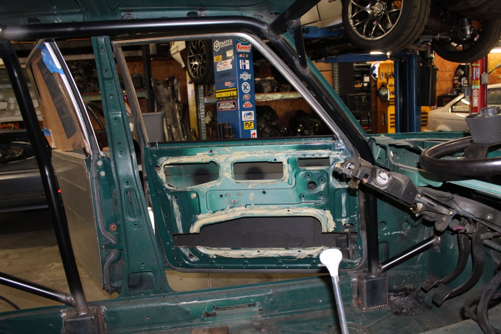

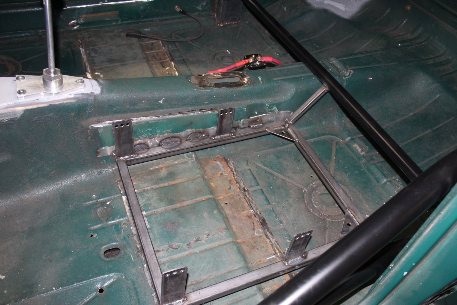

Continuing with the Cage update / rebuild . One of my main objectives with the new cage is to tie in to the diff mount . Any one who has driven an old BMW (pre 82 especially ) hard (or in my case abusively ) knows how easy it is to rip the dif mount right out of the trunk . We made a solid diff mount and tied the cage in to that mount . Had new seat mounts made . The fuel cell had been mounted high up in the trunk , so I removed the old cell mounting and cur out the entire trunk , The Guys at Blue Maxx Made a new trunk floor with the fuel cell mounting to lower the cell

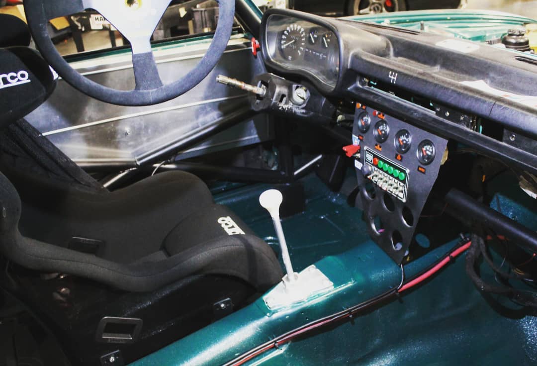

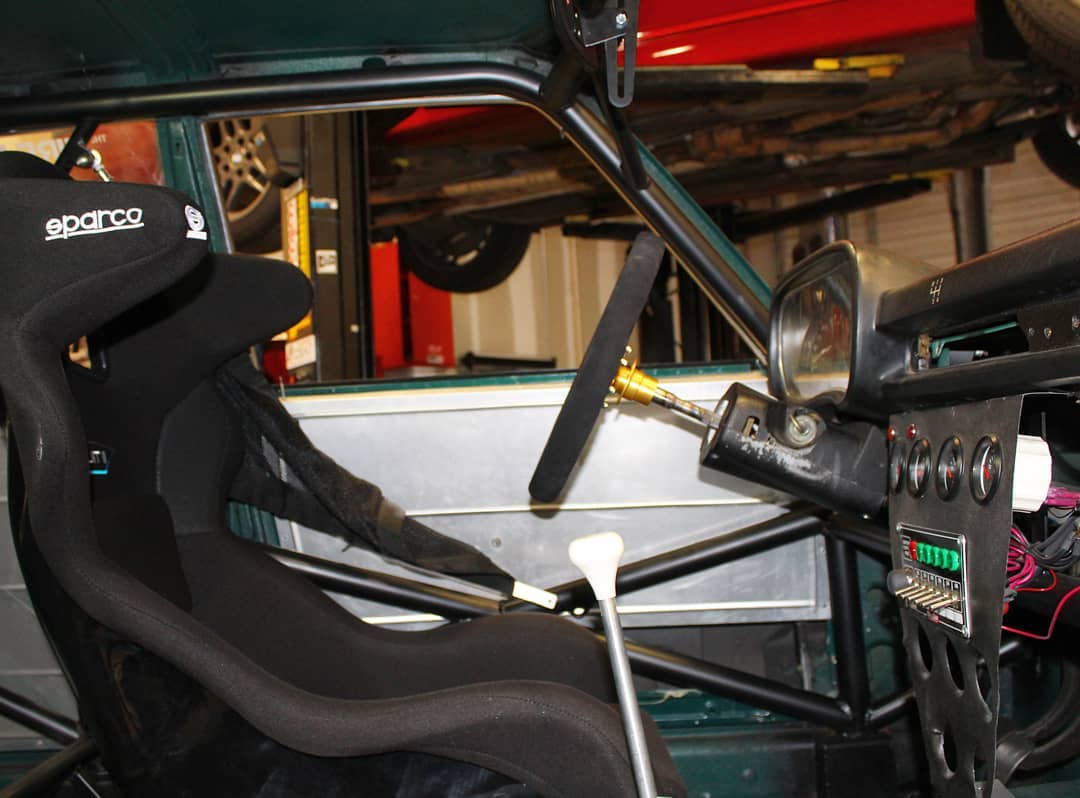

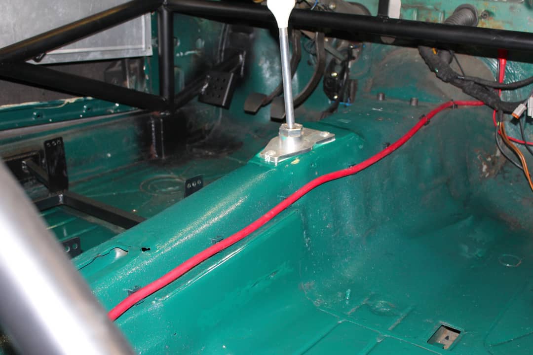

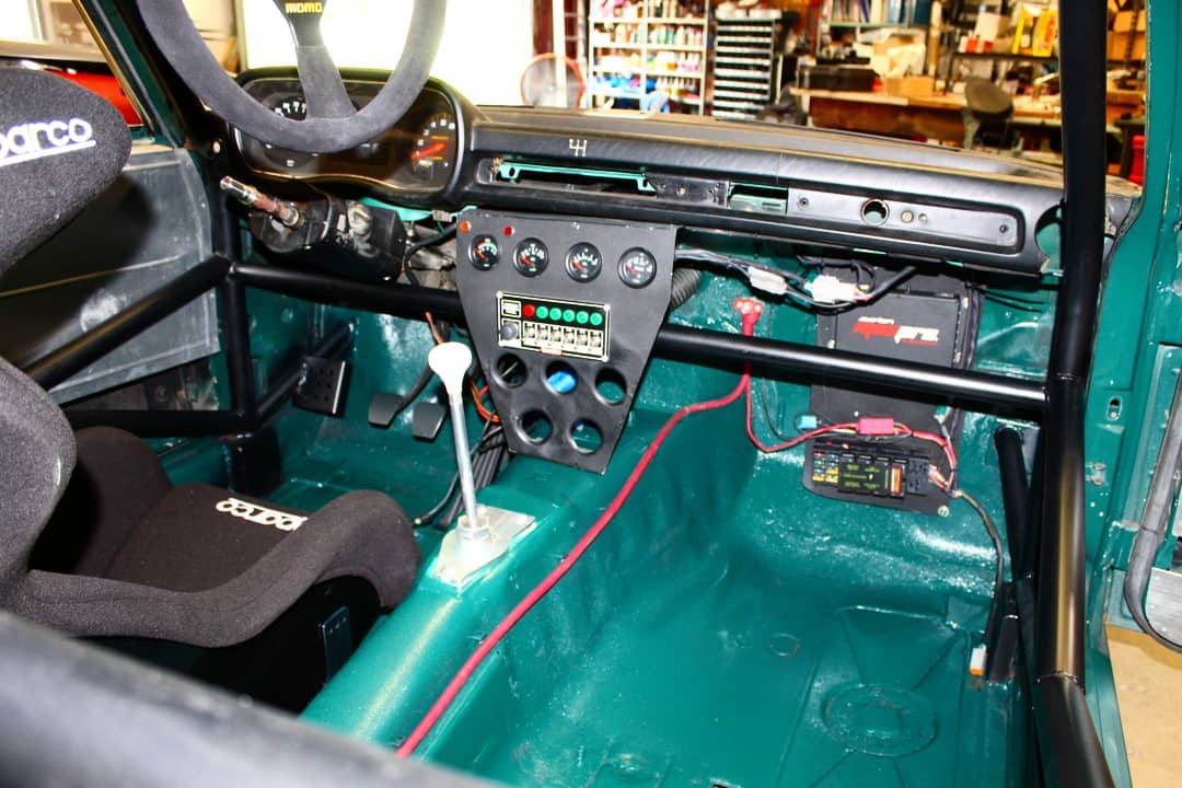

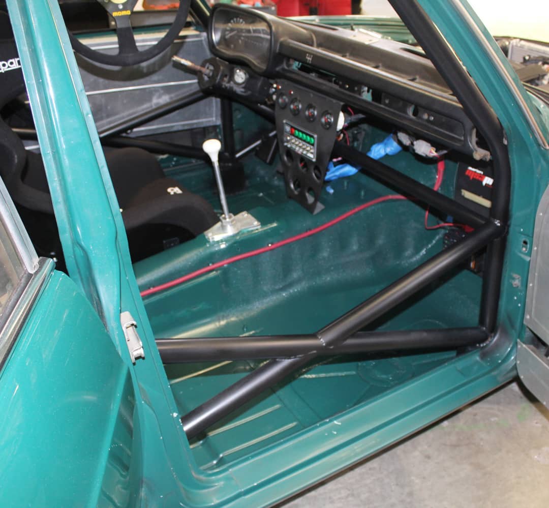

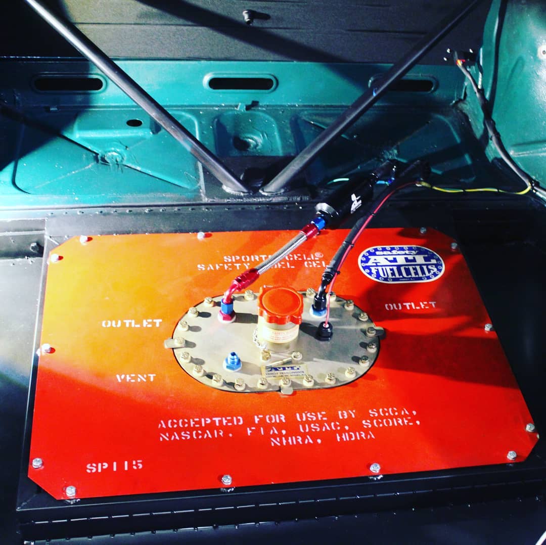

After getting the car back from the guys at Blue Maxx Garage , I reinstalled the fuel cell in its new mounts , Got some color matched paint and painted the floors to clean it up . and started permanently installing the wiring harness , got the power cables laid out and secured , , Take note of the new exhaust and the work Blue maxx did on the steering column

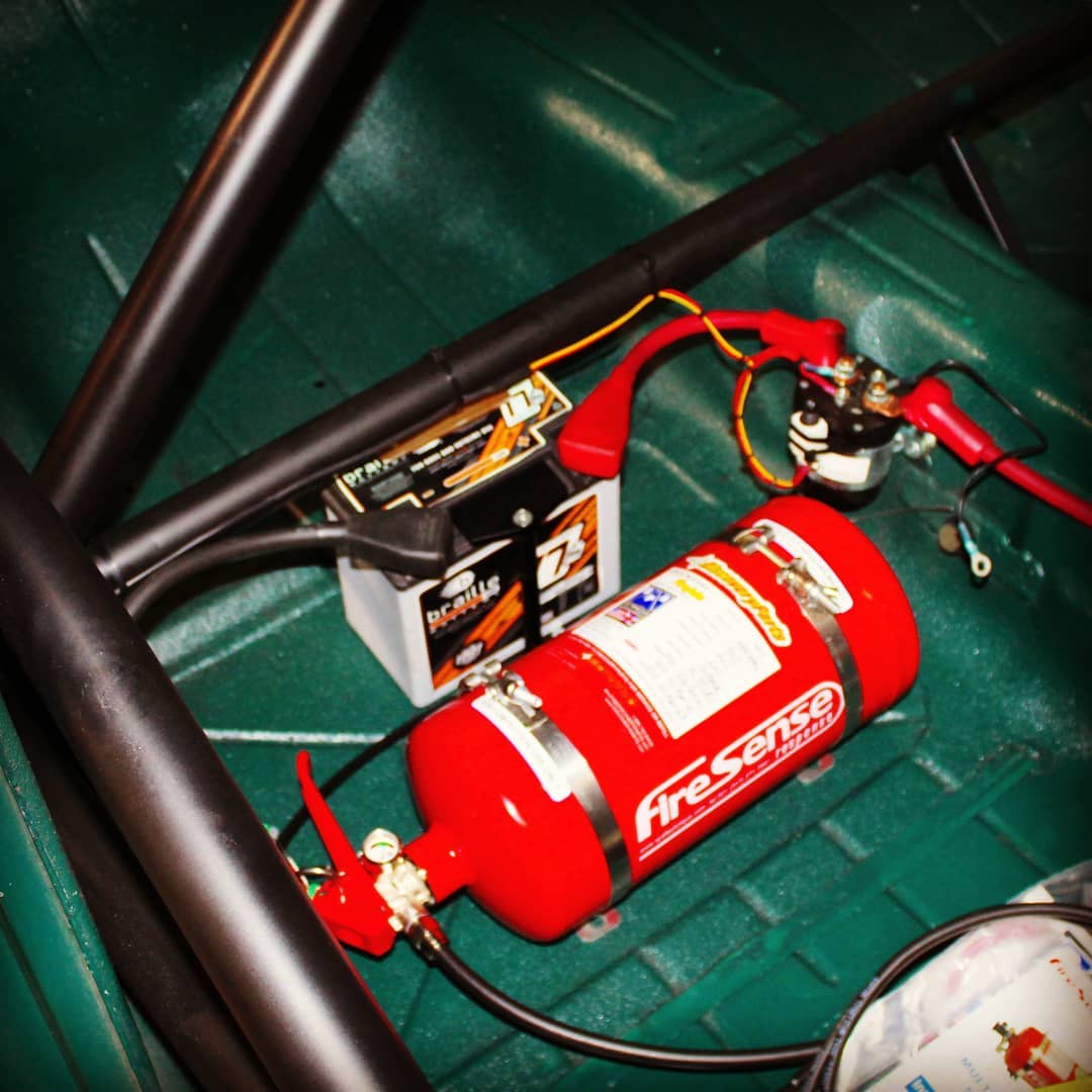

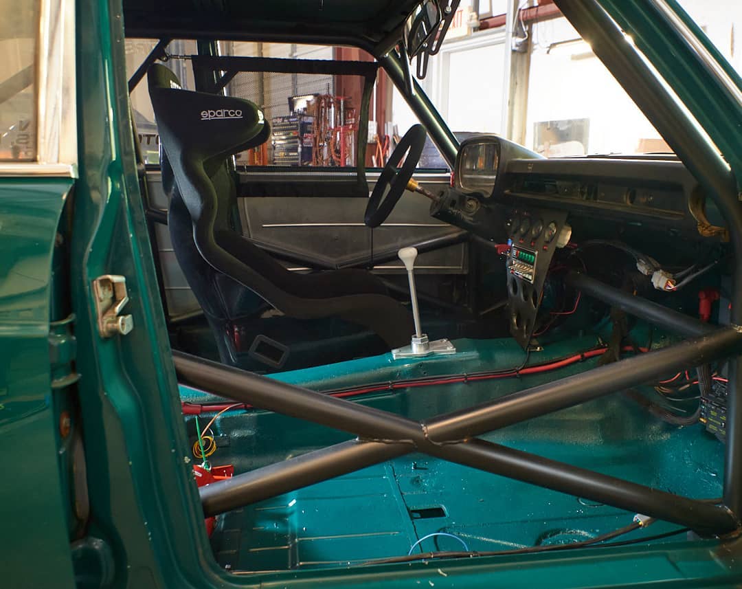

Got the fire bottle mounted and started laying out the lines , Also got the Fuel cell plumped and wired up , And started laying in the electrical harness permanently
More pics of the new cage. installed the new firewall between the trunk and cabin and notice the bulkhead connectors for the electrical harness , also the quick disconnect steering coupler

It seams like its the small tedious things that add up and take time to complete long term projects , Trail and error involved to find a throttle cable to operate the ITBs

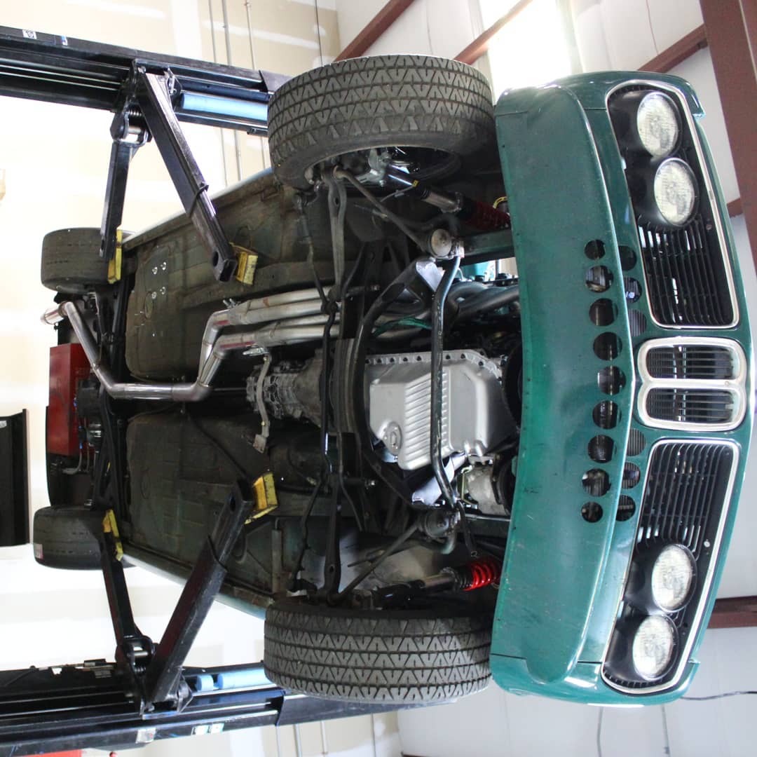

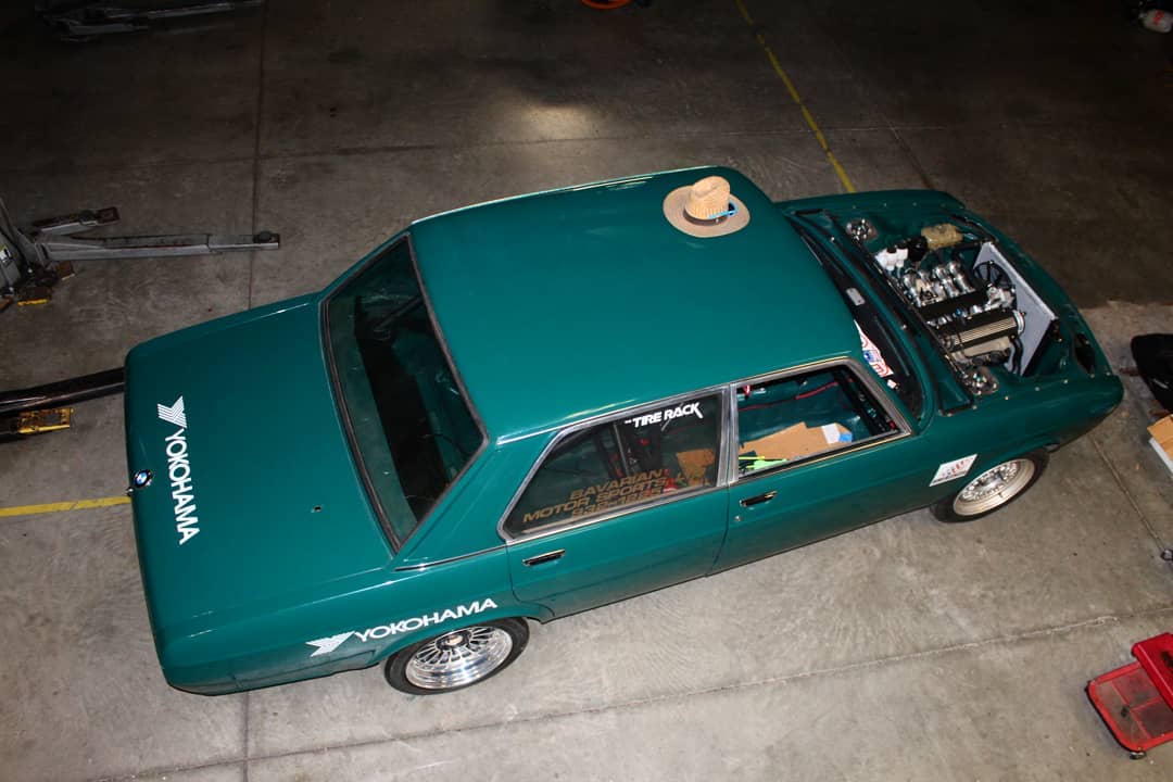

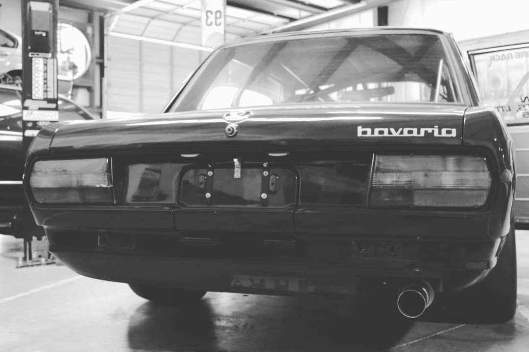

also got a pic of the exhaust that Blue maxx made for me, headers to ay pipe single 3 inch pipe to a magnaflow muffler
246931595_3081242232199558_5886384322932788342_n.jpg247424801_3081241585532956_862496610370004981_n.jpg245375870_3076113872712394_5724970651549644570_n.jpg
