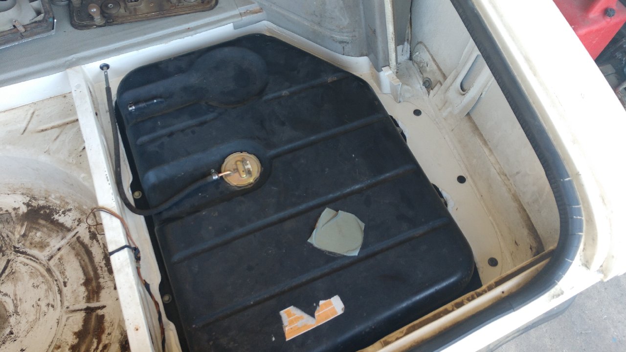

Nice stance. I have a Facet electric fuel pump that I just put in but don't like. I'll probably go with the E28 like you did (and Mike) but I'm curious about which fuel tank you have. Does yours have the extra space on the right side of the tank? I can't remember when they changed the style.
My later tank conversion:

1974, same as e9
Here's my current set up followed by a picture of from left, E30 pump, stock E3 pickup, and e28 pump. That e28 pump frame is the bolt on type, not twist on like the one I'm using.
Mine being a '73 has the earlier tank, I didn't know that was a thing.

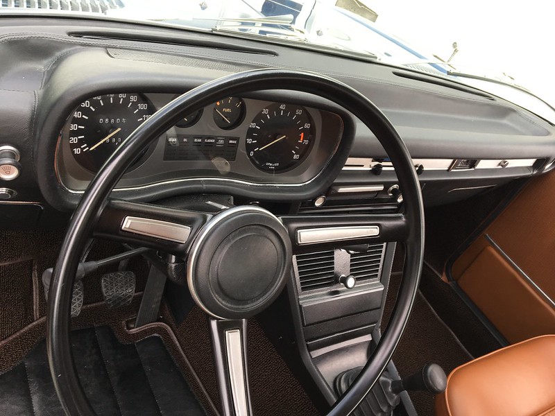

I replaced the dash while the windshield was out. I figured it was now or never with how difficult it is to find the seal, the windshield and someone to install it. I really had to harass that guy.
Ted,
I notice your dash does not have the little dividers in the right hand well. Did your dash come that way originally?
My badly cracked dash had the dividers...
...but the guy that recovered it, eliminated them. I think because it added a layer of complexity....
Coupe King, right? That’s where I got it. Yours was my inspiration. My original dash had the dividers.

I can't get used to the dash without the dividers. Too many years, decades actually, looking at them. Looks too contemporary to me. But that's just me.

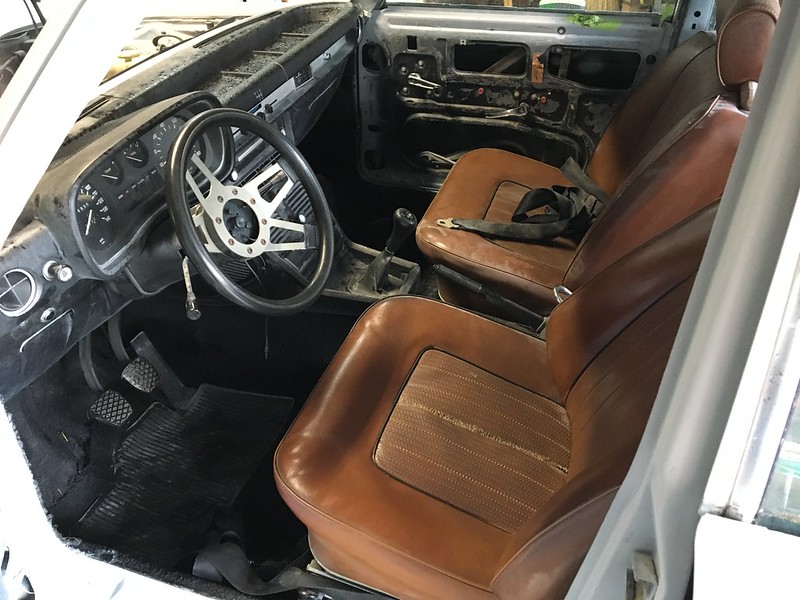

While the seats were out I finished the front suspension: new LCA's, center link, tie rods, idle arm bushing, and the other bushings I can't remember the names of. The ball joints were toast causing some wandering on the freeway.
I also found a stock rear sway bar so installed that with new front and rear end link hardware with poly bushings ($18/pair @ rock auto!)
