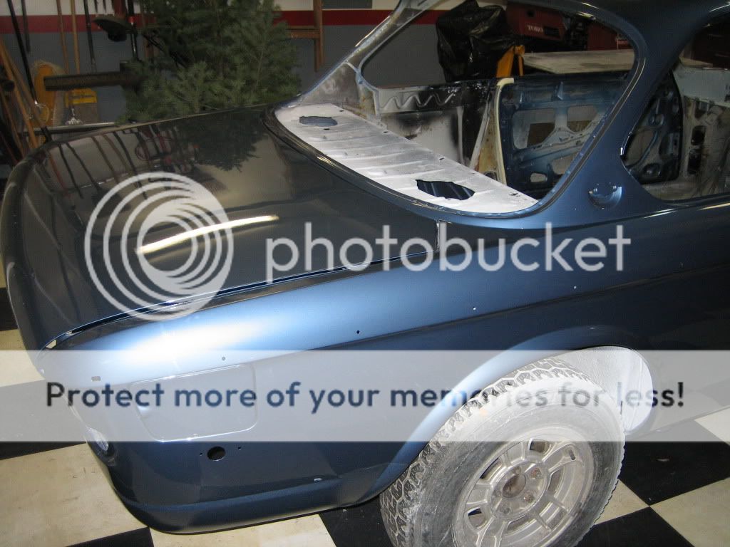

Here is what the car looked like in 2006 when the project started:
In the barn...
Ready for the makeover to start...
More details and pictures to come....

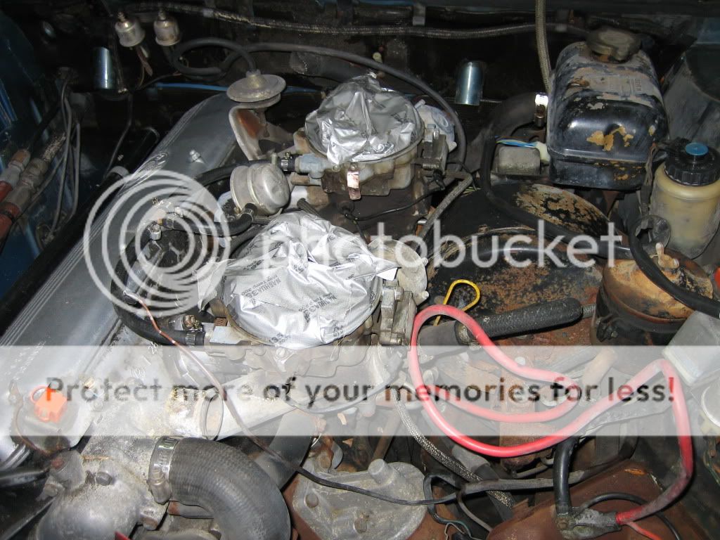

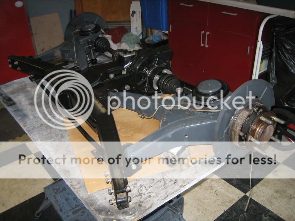

Here are pictures of the car as the onion was unpeeled....

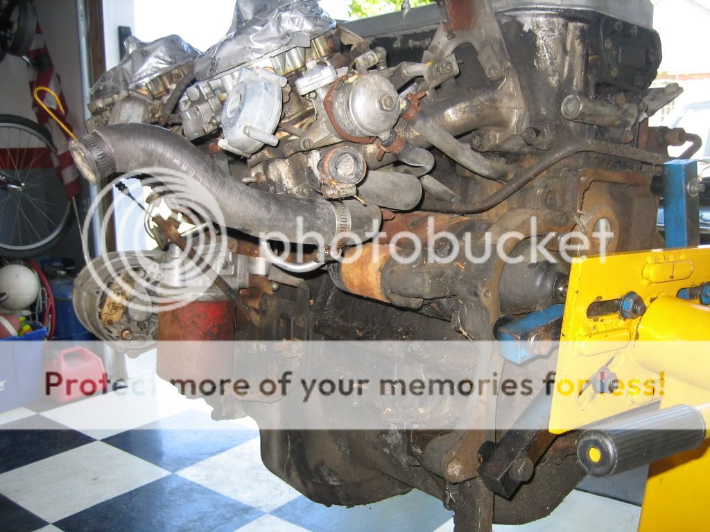

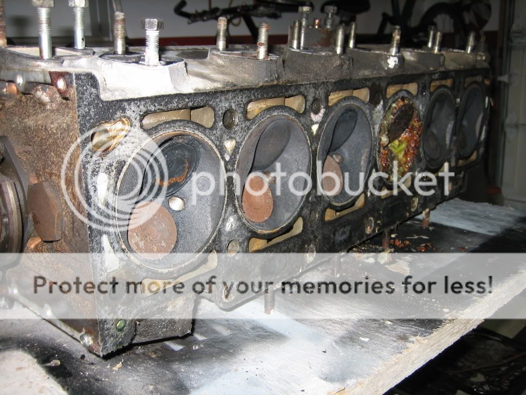

The owner knew that the engine didn't run and once he got it open he found out why...
Engine out on the stand
Head is off and we see why it was parked in in 1981...
Corrosion in the head as well...

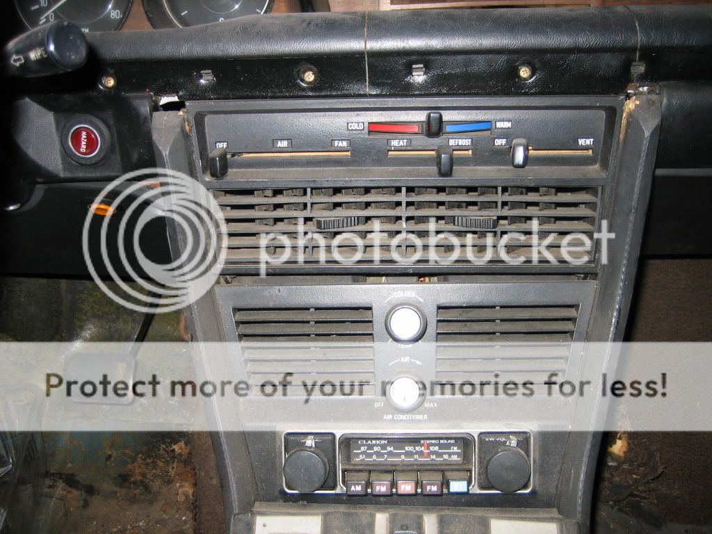

for posting these photo's. it's great to see what's under things like the
dashboard and such.
and i save them for later (if you don't mind) for when i do some more work on my 2800cs.

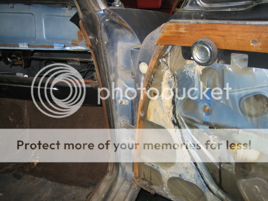

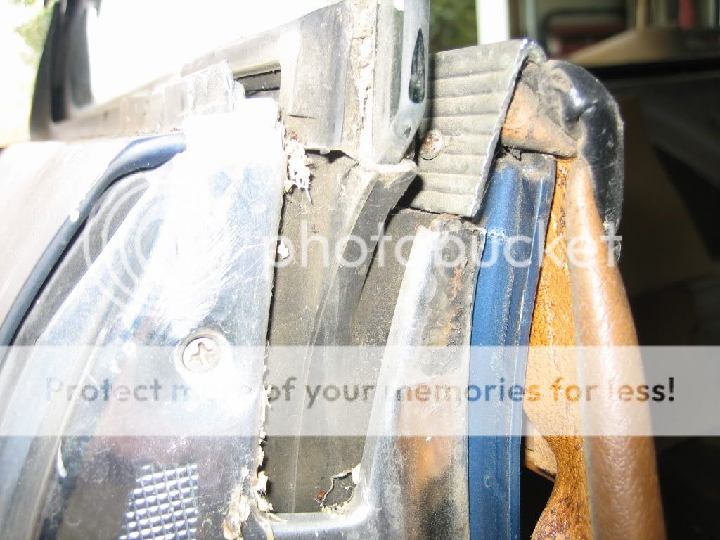

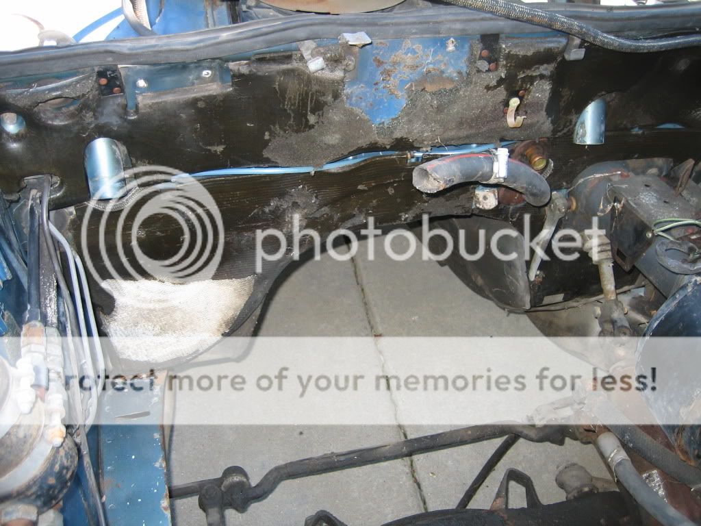

Your car actually looks better than mine did (except for the engine) when I started.

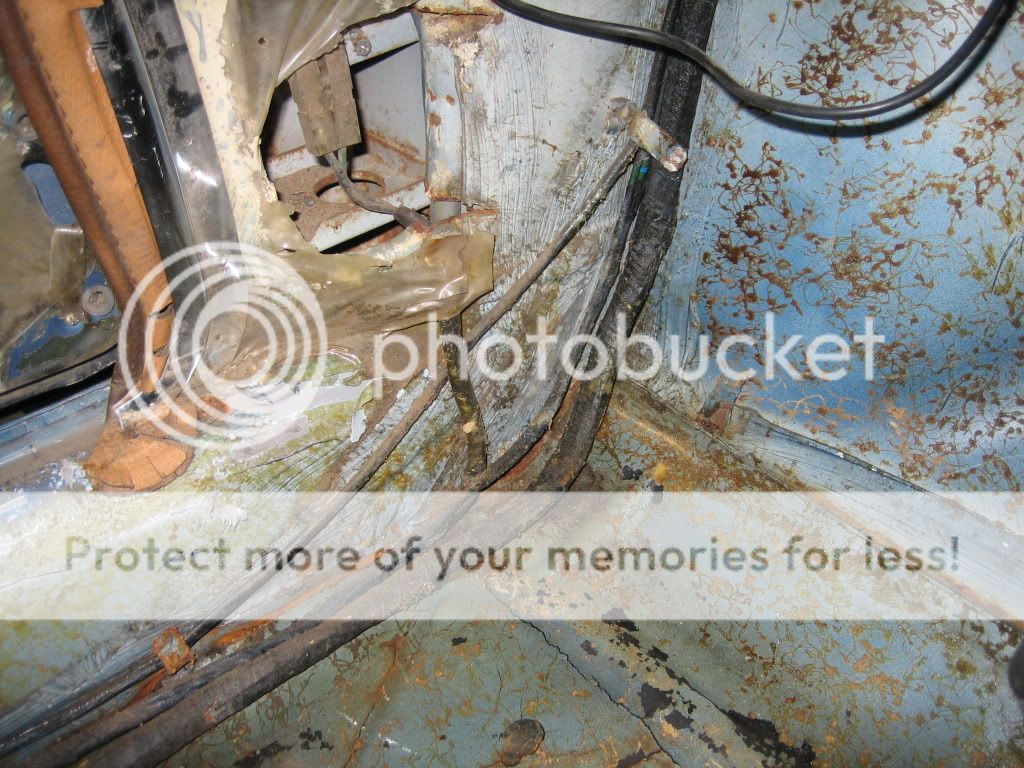

Most of your under-fender parts that have rust perforations are still available. There is a thread here: http://www.e9coupe.com/forum/showthread.php?t=6971 that discusses what is available and how to replace the parts.
awesome info
i believe it would be great on this forum to have a designated sticky thread with these tips as far as rust places is concerned
Fixing the hole in the floor is easy. Walloth & Nesch has a solid replacement part for the floor. http://www.wallothnesch.com/e/frameoffer.htm Jaymic has the replacement floor, http://www.jaymic.com/shop/parts_CS_products.asp?grp=CSBDR&page=3 and just a solid part that is a replacement for the plug and the surrounding floor. http://www.jaymic.com/shop/parts_CS_products.asp?grp=CSBDR&page=2

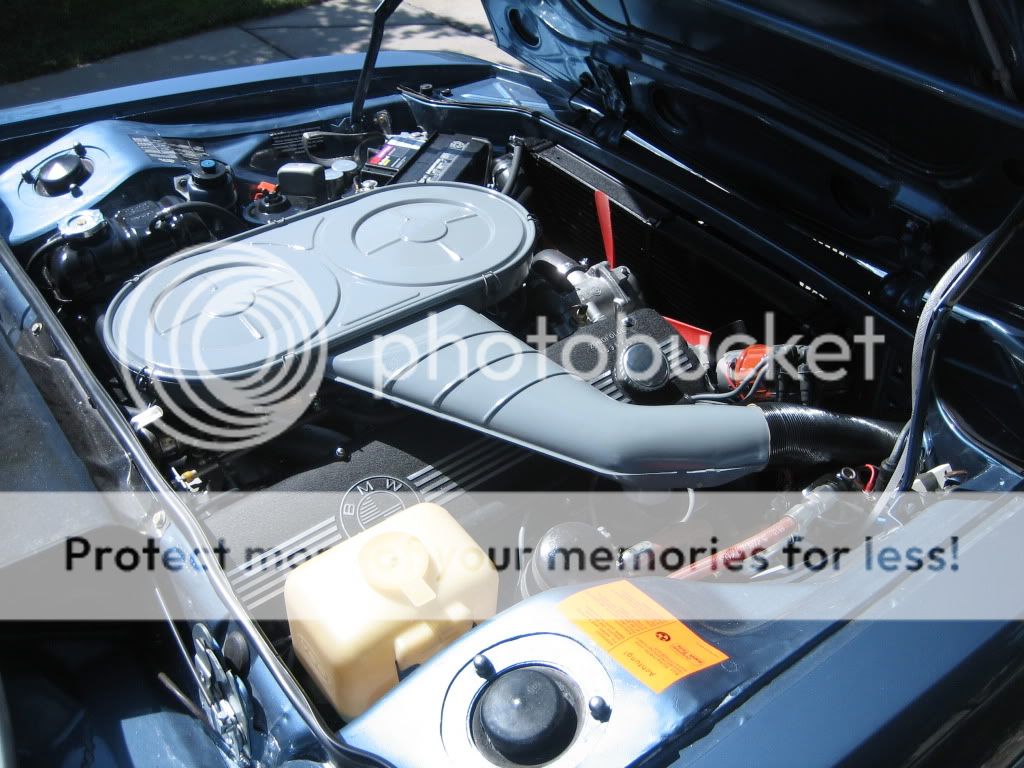

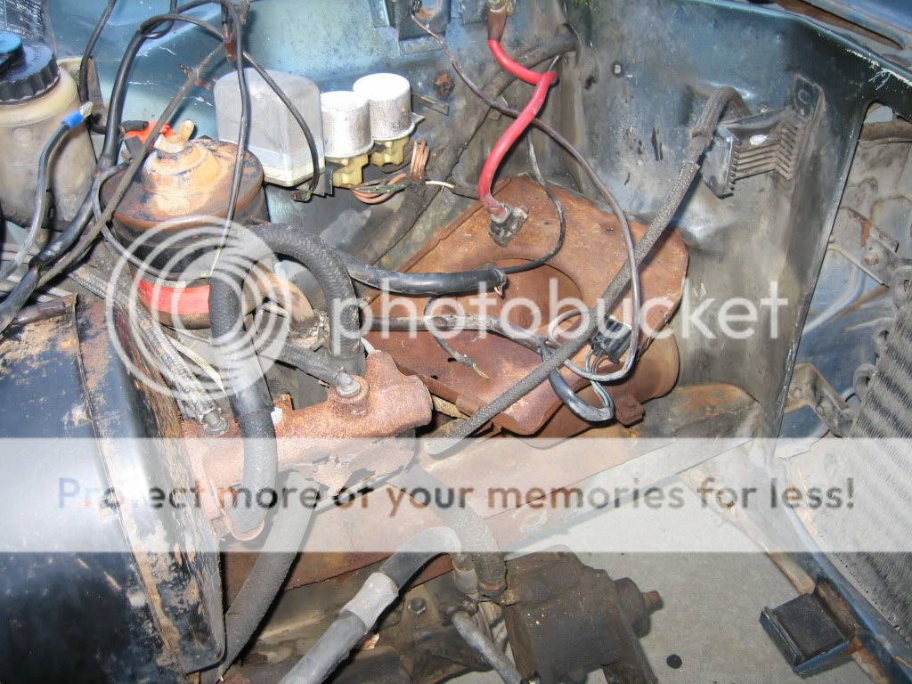

Is that the stock aux A/C fan and brackets?

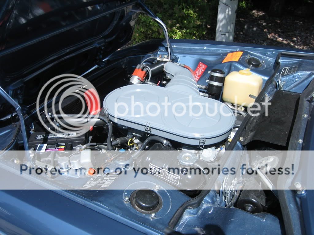

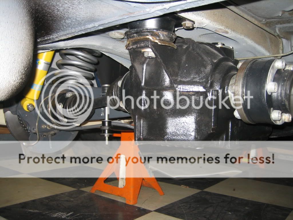

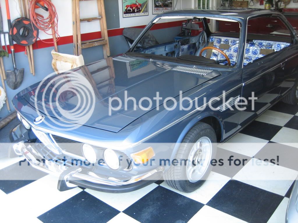

For the engine, the original block was in rough shape, as you saw in the prior pictures. The restoration goal was to keep the car close to stock in appearance, so while the replacement engine is a rebuilt 1982 M30 Euro spec 3.5L, it is still carbed. This engine is mated to a 1982 Getrag 265 5-speed and a 3:73 LSD rear end.
