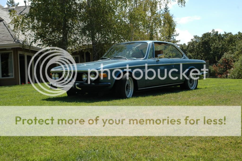

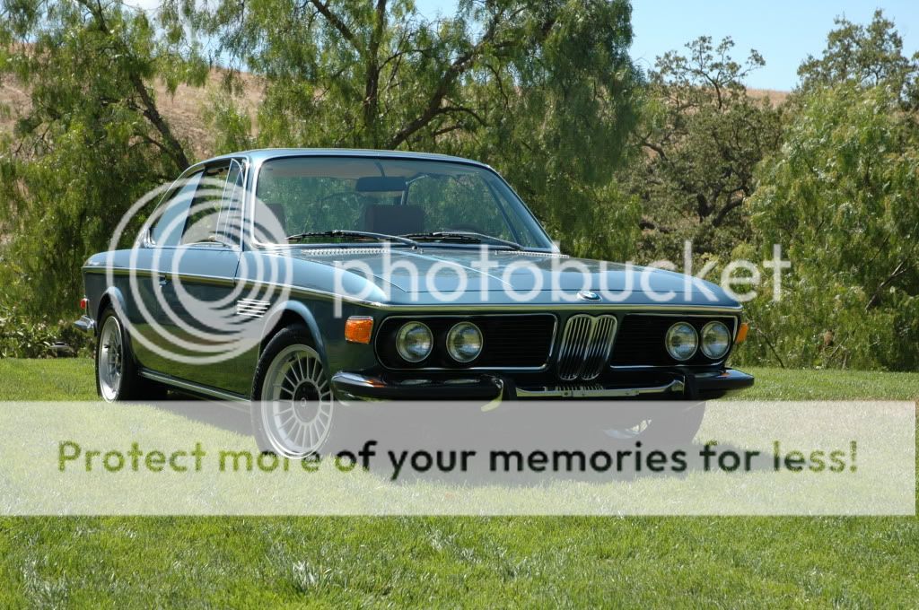

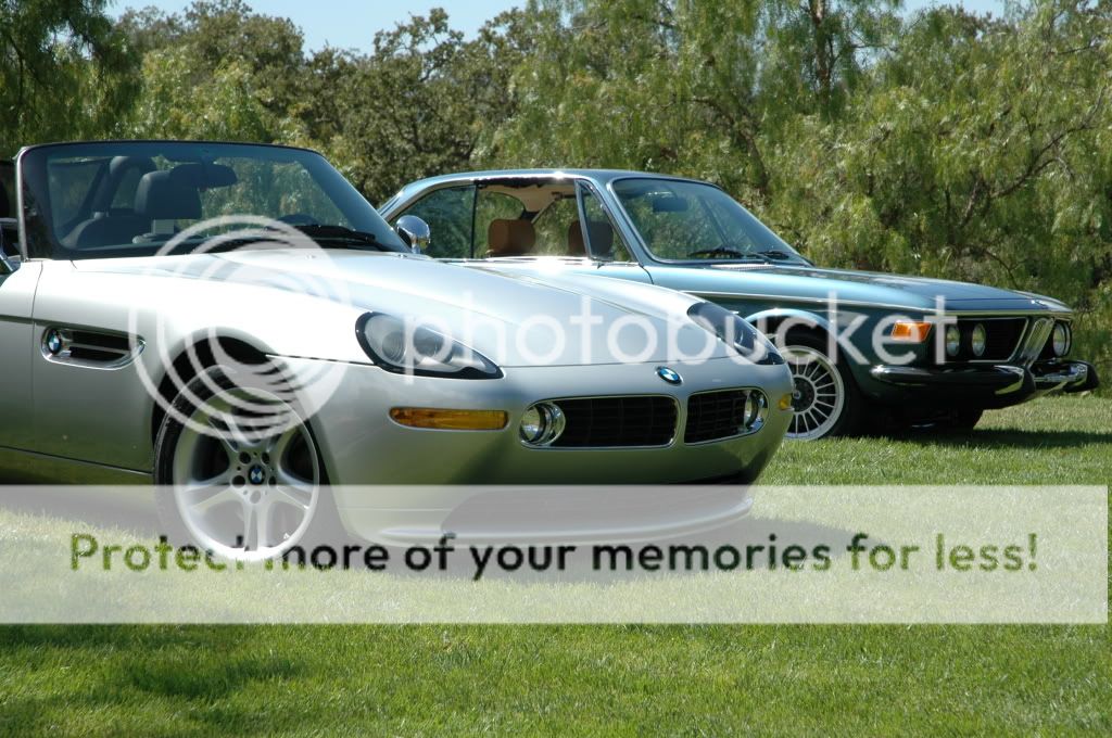

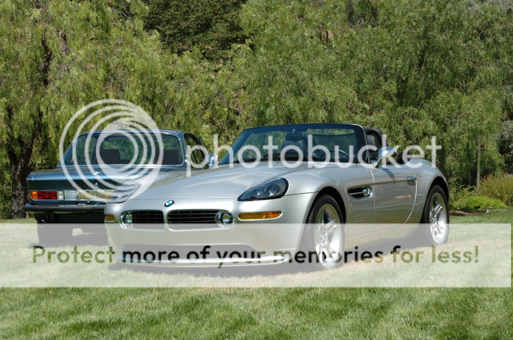

Here are recent finished photos, including a couple with the car's younger cousin. There are a few open items that need tending and I'll be looking forward to using the collective wisdom of the board to sort them out.
Very, very nice!! Love that color!
The rear license plate is going to have plenty of light on it.
More interior shots please.
Great color...Beautiful landscape as well !
congrats
Thats a great result, the car looks superb.
I agree the stance of the car is exceptional also.

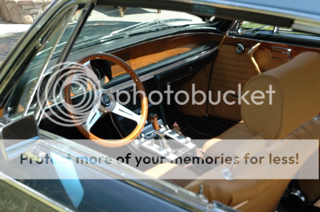

what steering wheel is that?

2. The steering wheel is a Nardi

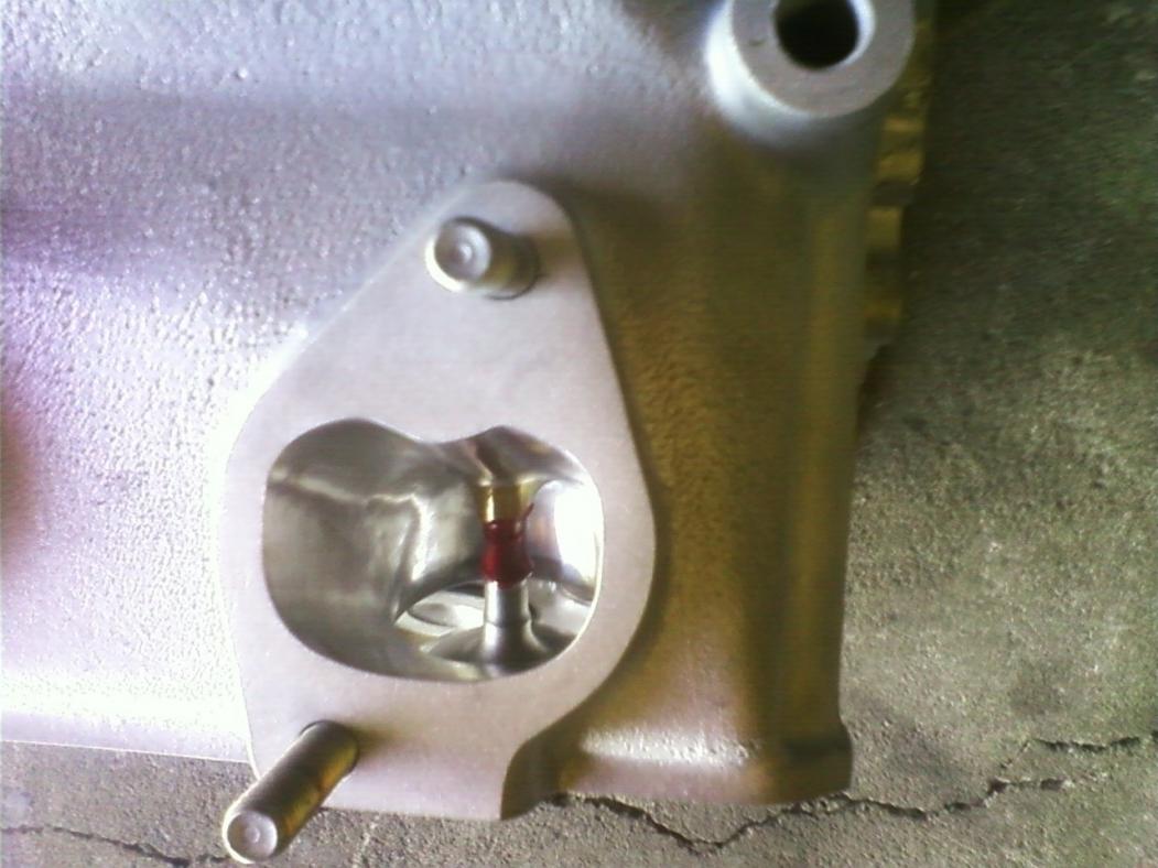

Port and polish done - love how they look when they get cleaned up...
red goop...
Machinists always think they have to prepare something that won't be used for months..
Head was placed this afternoon and engine will be running by Wednesday.
