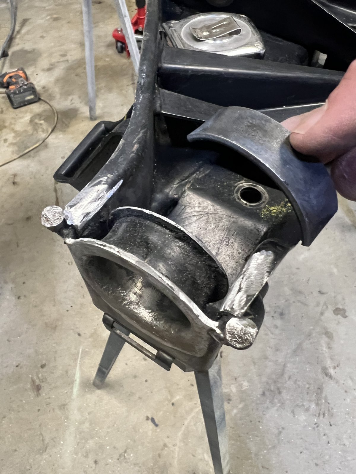

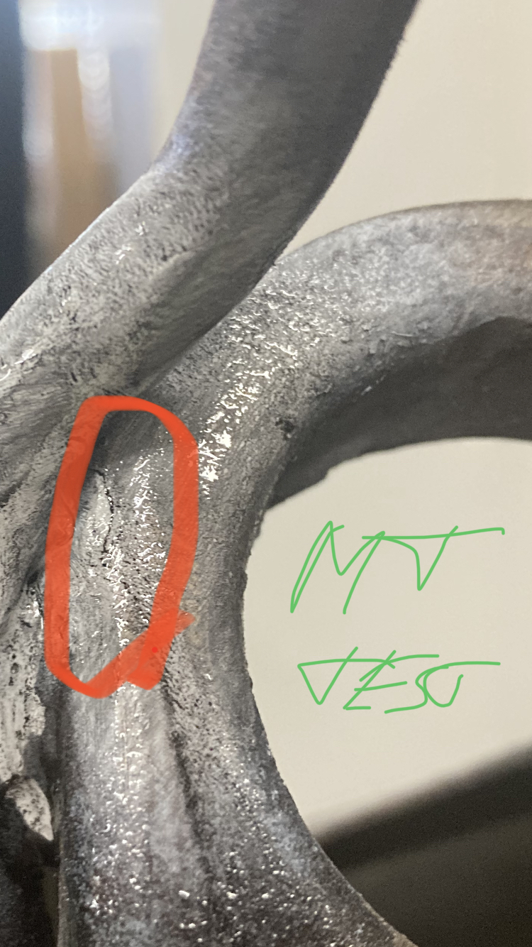

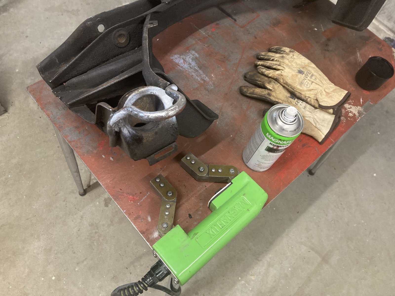

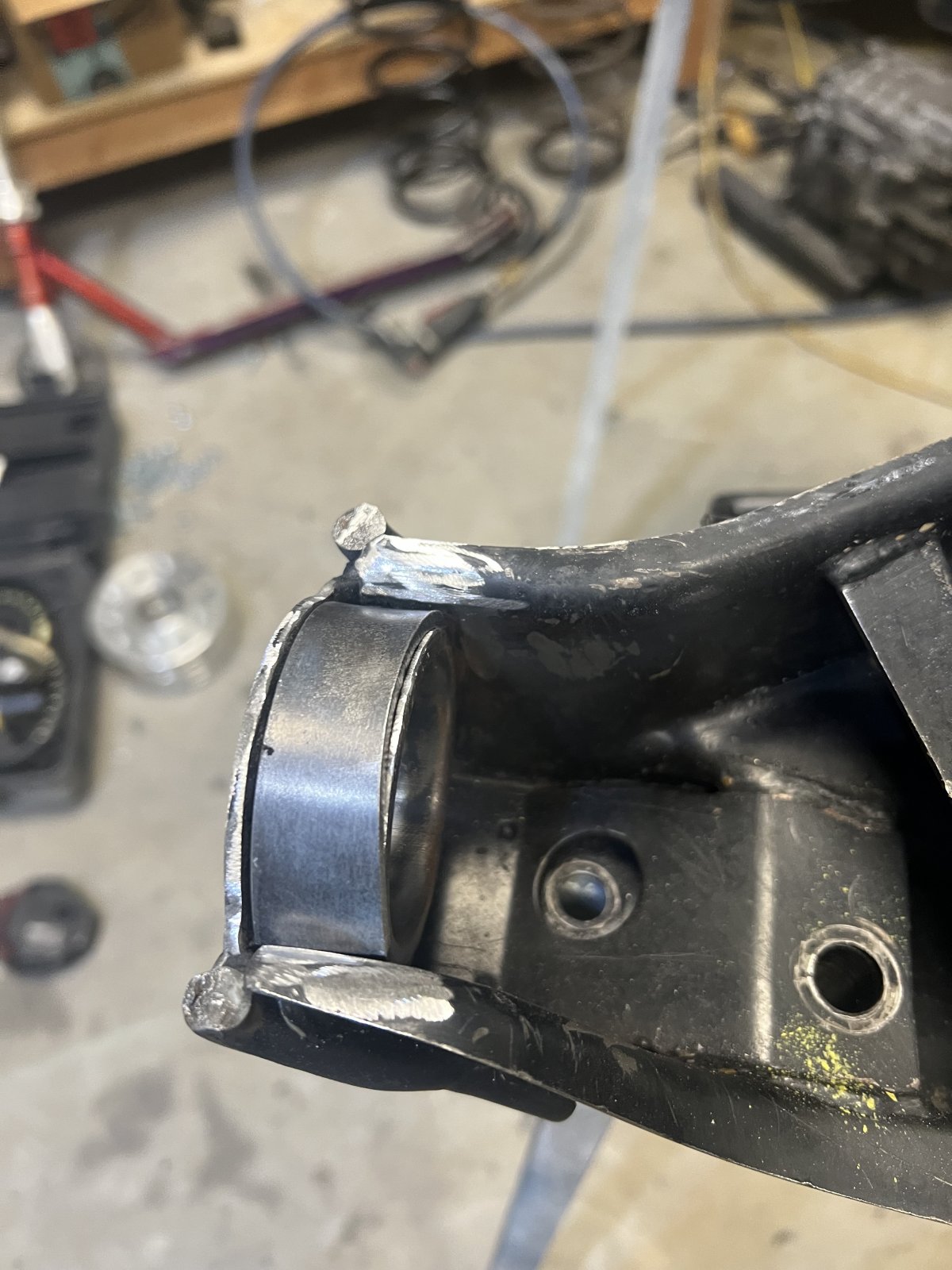

So, if any of the group has experience with the strengthening needs of the front subframe, here's what I'm thinking. I pulled my front bushings out to get ready for clean up and paint, when I noticed it was bent from what I assume was a curb or something..I got it back in shape with some hardened punches, but I saw the loop was cracked. I drilled, ground out, and welded it but thought that the area looks pretty weak, considering where it is located..I'm thinking of welding in a strap type support out of 1/8" steel to strengthen that spot. Anyone else ever see issues in this area on their rebuilds? Seems like such thin metal that could use a bit of shoring up..
The sub is upside down in the pics:View attachment 179026View attachment 179027
Hello, have noticed the same cracks in that area. I decided to reweld it. But your solution is very simple and useful especially when you drive a lot (rally’s) or if there are bigger wheels on the car (more reaction forces)

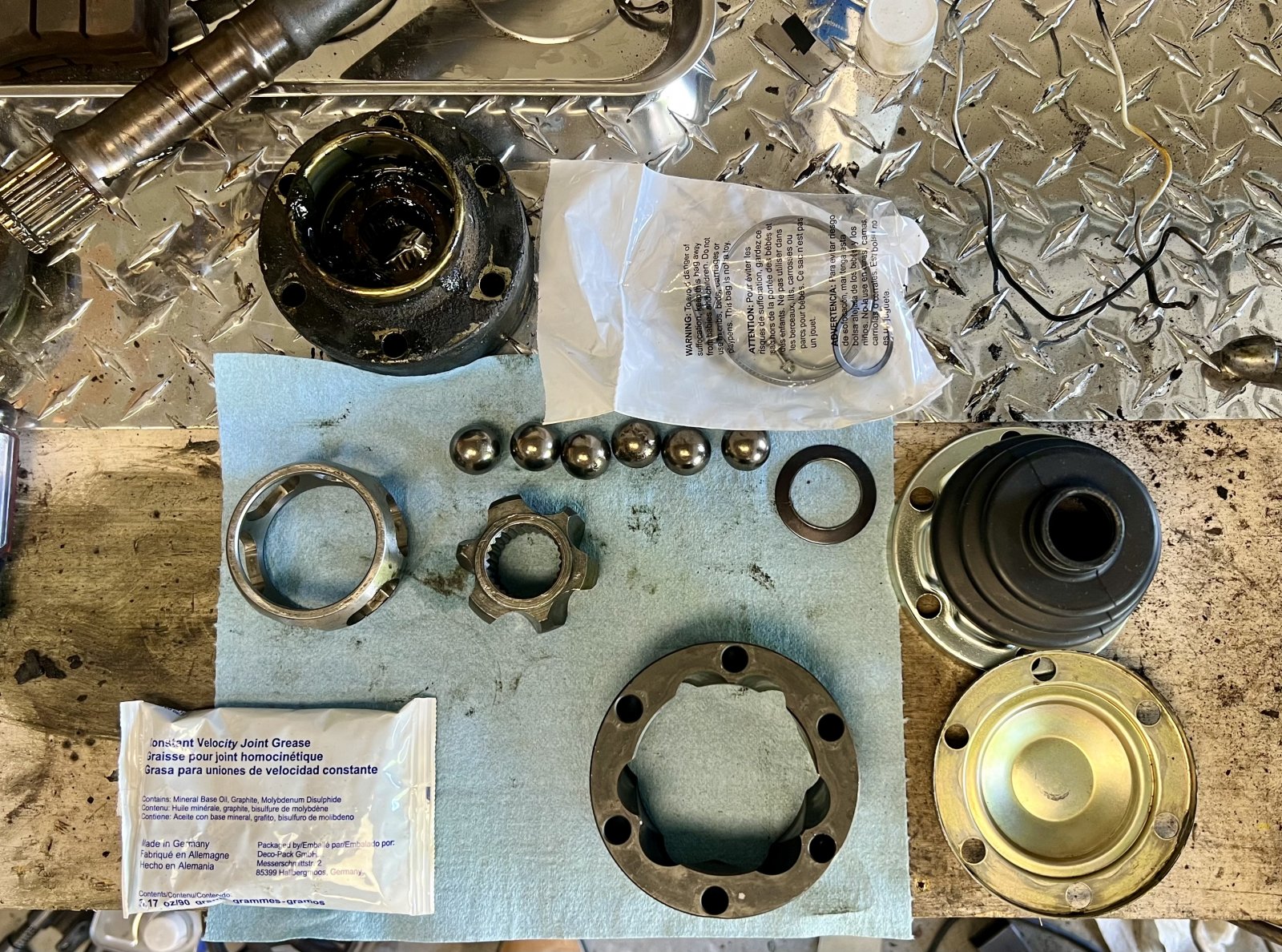

Rebuilding the rear shafts..one down! Man, the grease in there was awful..they’re so nice and squidgy now..lol

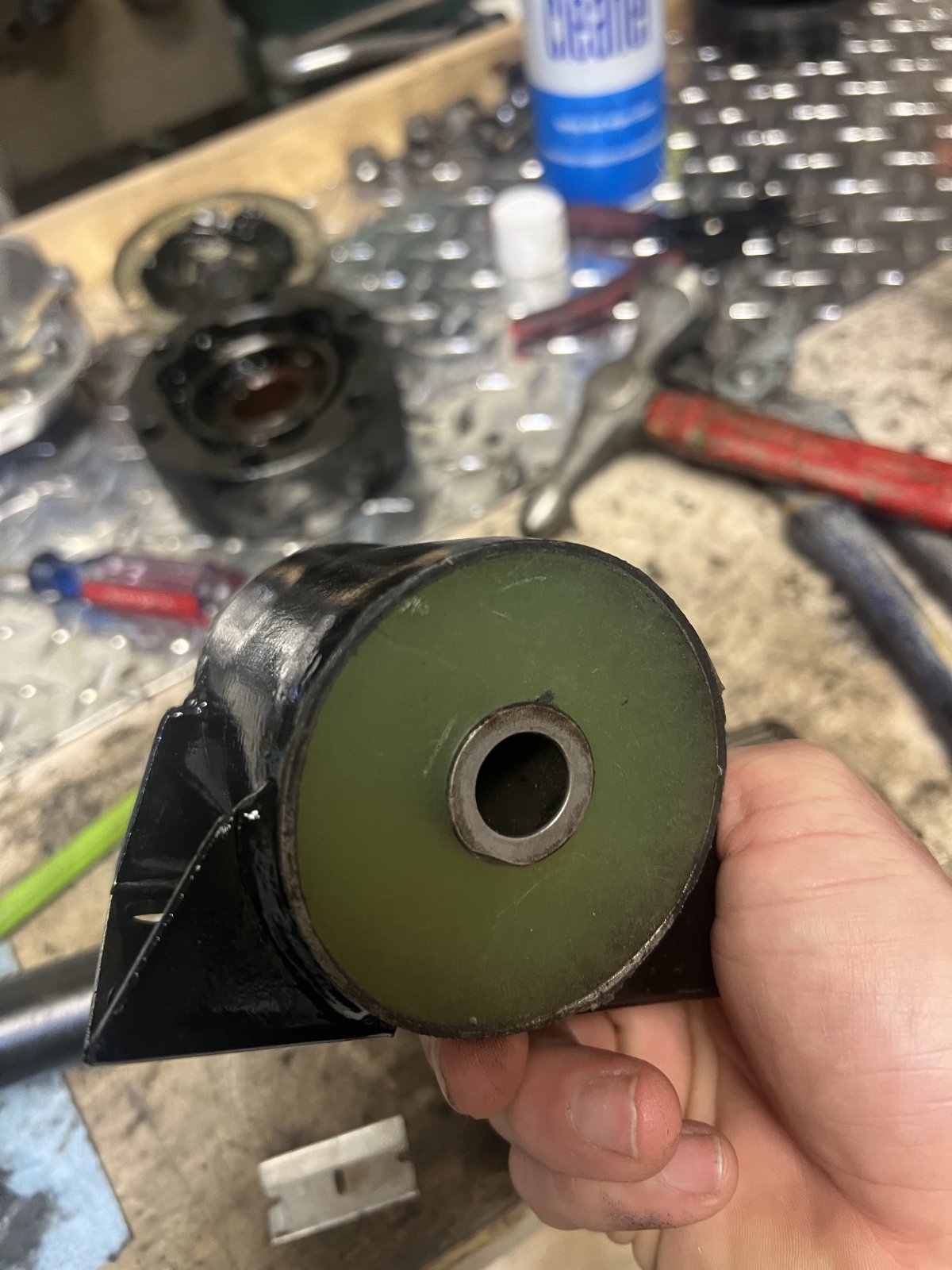

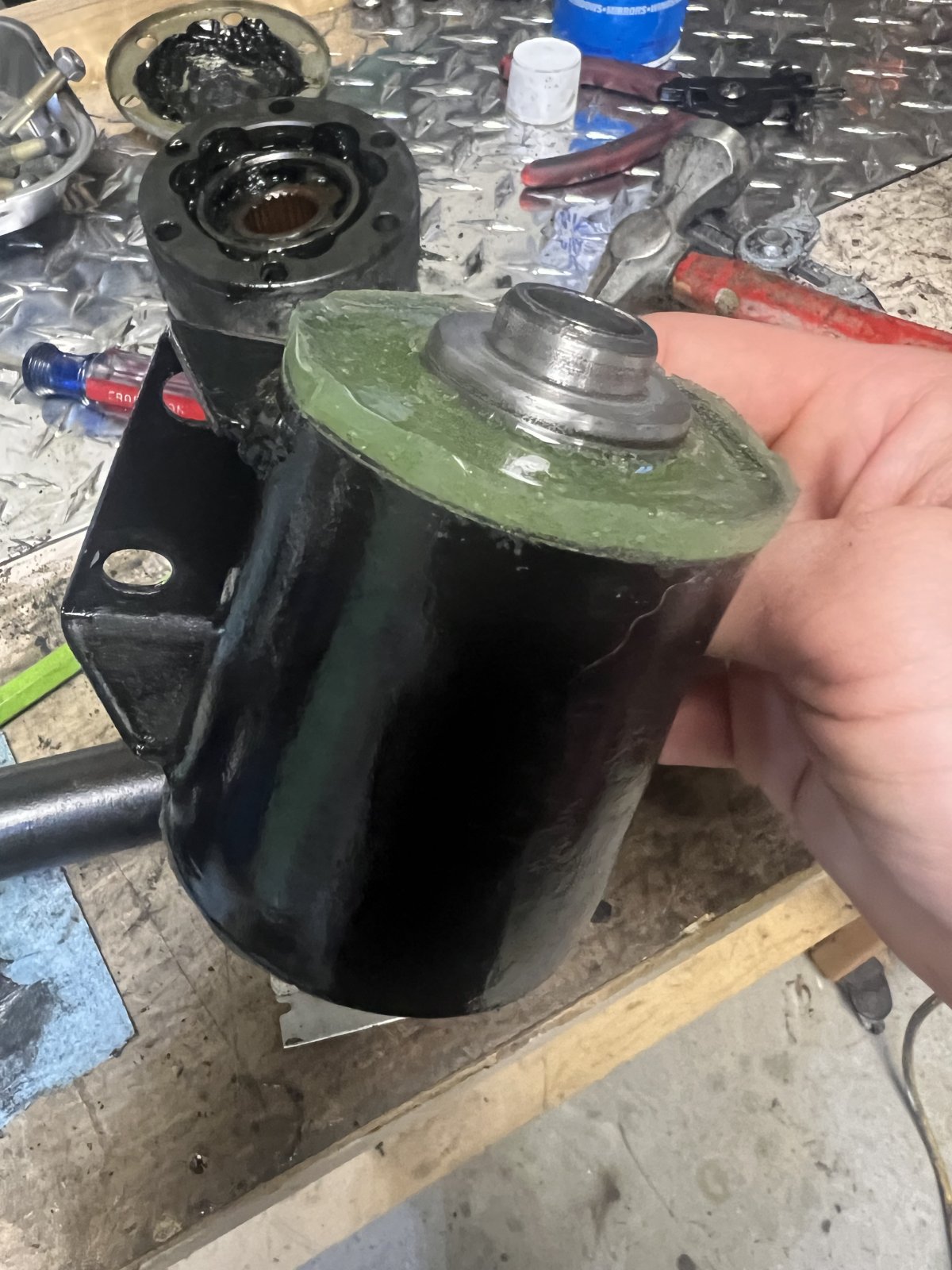

I also just poured my first rear subframe mount with 80a polyurethane. I’ll let you know how that goes, after the 16hr cure time..:).
Got one rear sub bushing made..:-). Really happy with how it turned out. 80a poly and 16hr dry time..able to use the original unit once I pressed the old junk rubber out and cleaned it up. Pretty easy process.

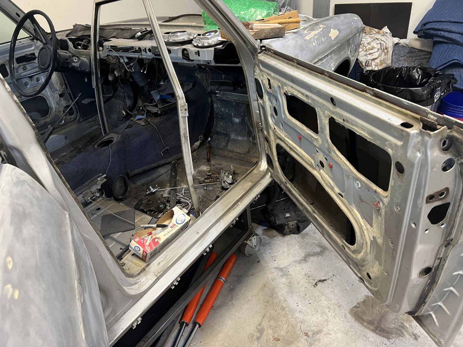

Well, I've been sidetracked again, but I finally made the other rear sub mount with the 80a poly. Also started pulling out the windows and frames to finally get the sanding finished before primer

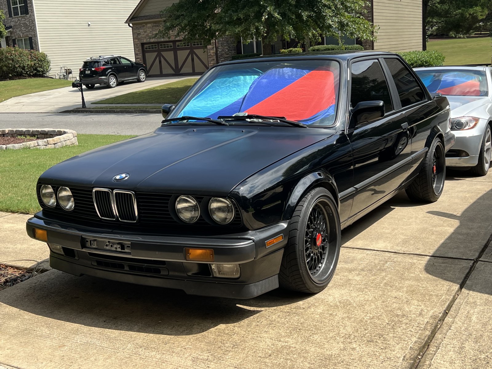

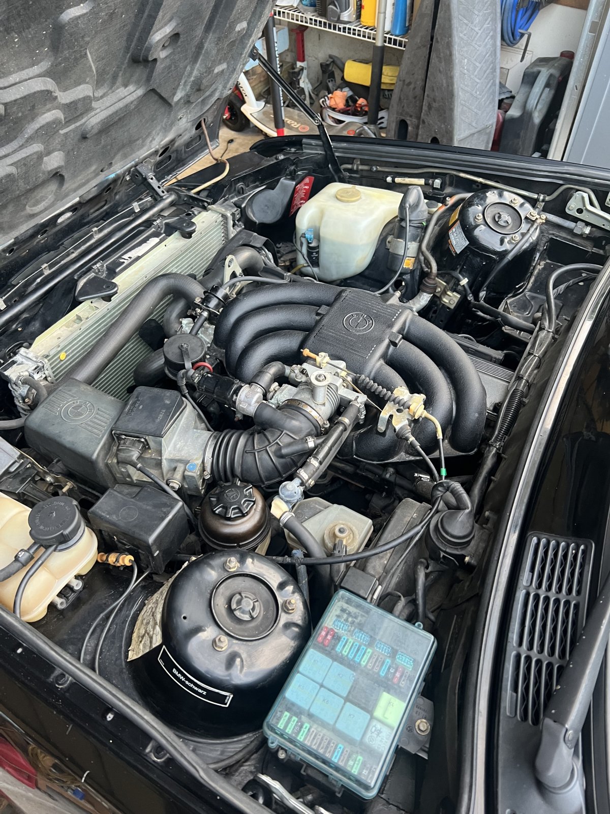

I was sidetracked with my son's 'new' car...:-) He turns 16 at the end of the month and he's into BMWs also..yay! So this is what we found him. 88 325is with 106k mi on it. really fun car. We pulled it all apart and replaced the whole front suspension with new controls arms, bearings, steering rods, koni sports, new soft lines, etc. Same with the rear end. Pulled the old AC system out and made all new barrier hoses for the new sanden compressor, condenser, drier, etc. New radiator, timing belt, water pump, tensioner, thermostat, etc...cleaned up everything we could. Doesn't even reach halfway on 95 degree days! She blows nice and cold now, too! Tasteful Apple carplay head unit so he can navigate easier. He's so in love with his new baby. Oh, of course it's 5spd! Previous owner had bbs rc090 wheels filled and drilled for 4x100. They're a little big for my taste, but he loves them, and they do look sharp as hell. Lower springs, too. rides amazing. It has a wrap on the hood and trunk which we'll remove in a few years, when we paint her together. It looks fine in person and he's young, so it's cool, i guess...lol. Also a completely crack free dash! My sister had an 86 325es new when she turned 16, so it's fun to have one back in the family again. I forgot how much fun these were to drive! She had almost 400k mi on hers before she traded it in...never had the engine opened up..crazy, right? Anyway, I'm back to giving time to the Bav...unless I feel the pull to replace my wifes shocks and front end on her 330i...never ends, huh?
