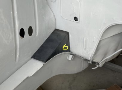

advice: make a hole in it for inspection and to paint the inside after the welding activities.
And don’t forget the holes for the fuel lines.

100%. I'm going to use a steel tube to weld in place for passing fuel line through..or anything else that may be needed. I'll also spray with weld through zinc primer before and use a chassis rail coating on the inside..
I figure I'll never have this opportunity again to add stiffening like this. I did the diff support upgrade, too..

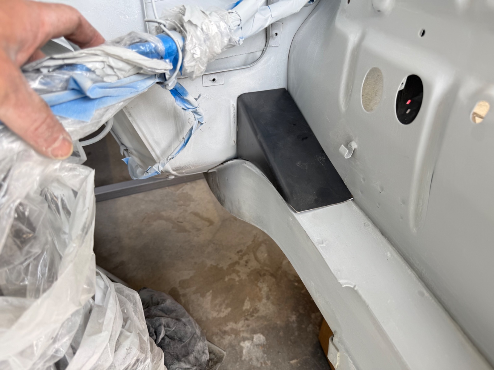

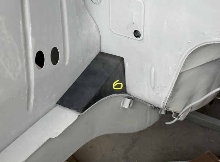

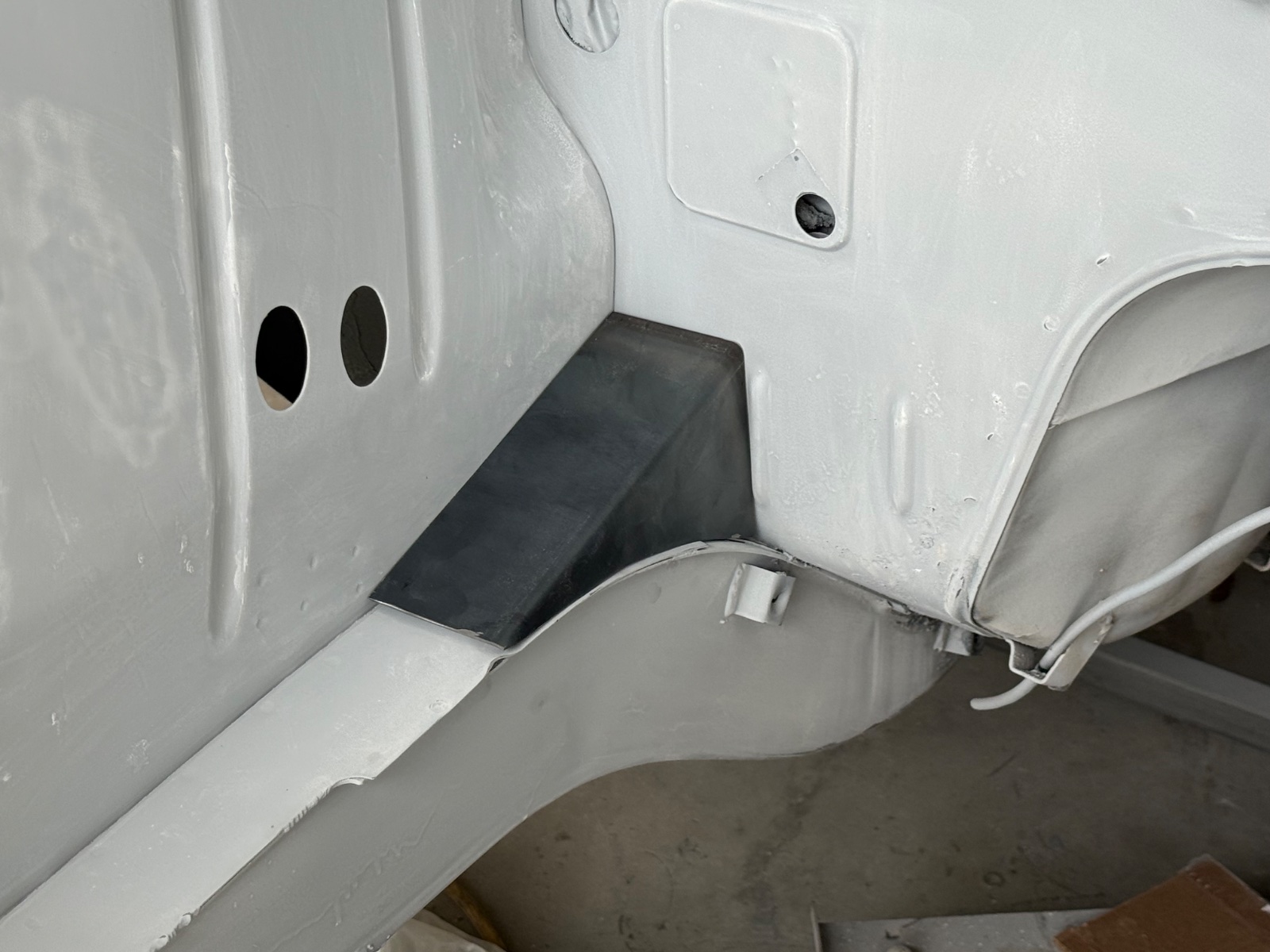

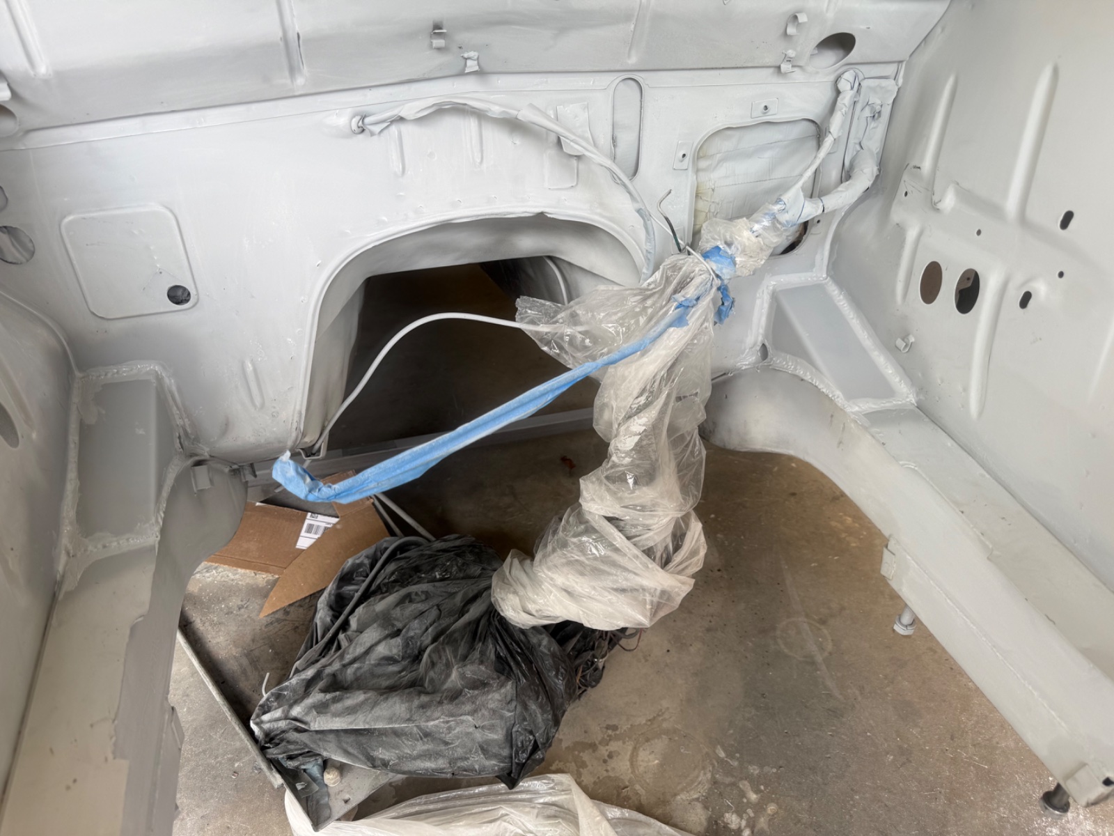

I would say, if the plan isn’t to add much more hp and push it hard, then no, probably not important to do. I’ve just been dragging my feet for so long on my project, and now that I’m finally pushing again, I want to make sure I don’t regret not doing something when I had the opportunity..easy to do while it’s at this stage..:-)
-slots in the frame rails welded closed
-zinc primed underneath
-welded in the angles
-welded in stainless tubes for lines to go through
-zinc primed again
-seam sealed everything for good measure
Frame rails and sills will get internal coatings, too.
I think that should be pretty solid. I have nothing to compare the rigidity to from before, but I hope it helps a bit..that and the diff support welded in place seem like good ‘while I’m in there’ mods..

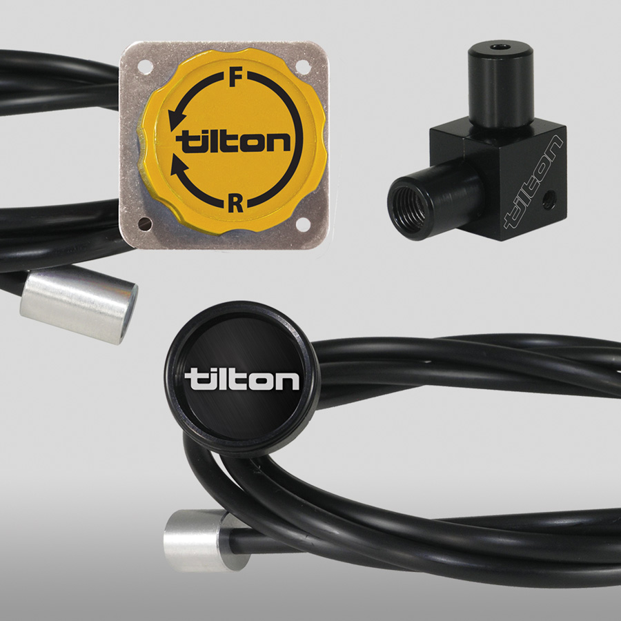

Tilton offers remote bias adjustment - you can literally change the front / rear brake bias on-the-fly. I've ridden shotgun in my friends V8 powered 914 and witnessed this at Willow Springs...
I haven't picked a specific unit yet, but here are some links to think about:

Nice, I did see the remote bias...love that. I'm ok with just testing and adjusting under the hood, but I like the idea of being able to mess with it, on the fly, for a race car!
Probably a solid call if you're switching from auto to use a set up geared for the manual brakes. I looked over my pedal and if I move the clevis up 1", it should give me 6:1 on the pedal for better force..as long as I can keep the rod pretty level. I'm pumped for losing the booster, though..I'd like to have a nice chunk of space for the side drafts. My battery will also be in the trunk, which will open up more room. I think GK has a universal kit that looks to be solid for my set up...good price, too.

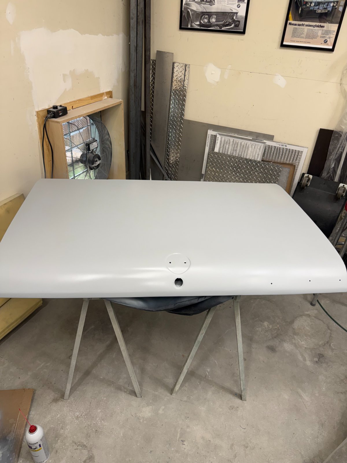

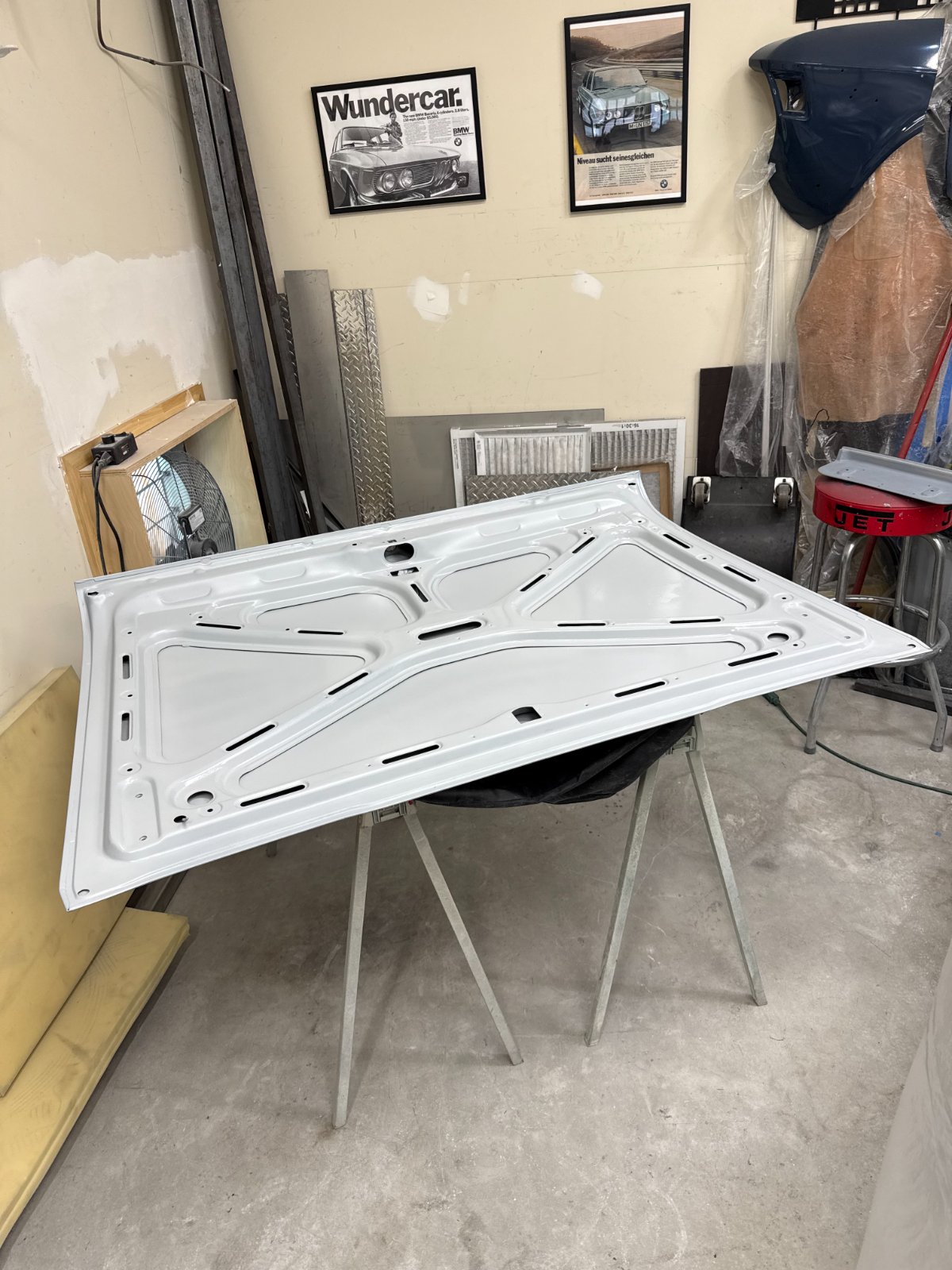

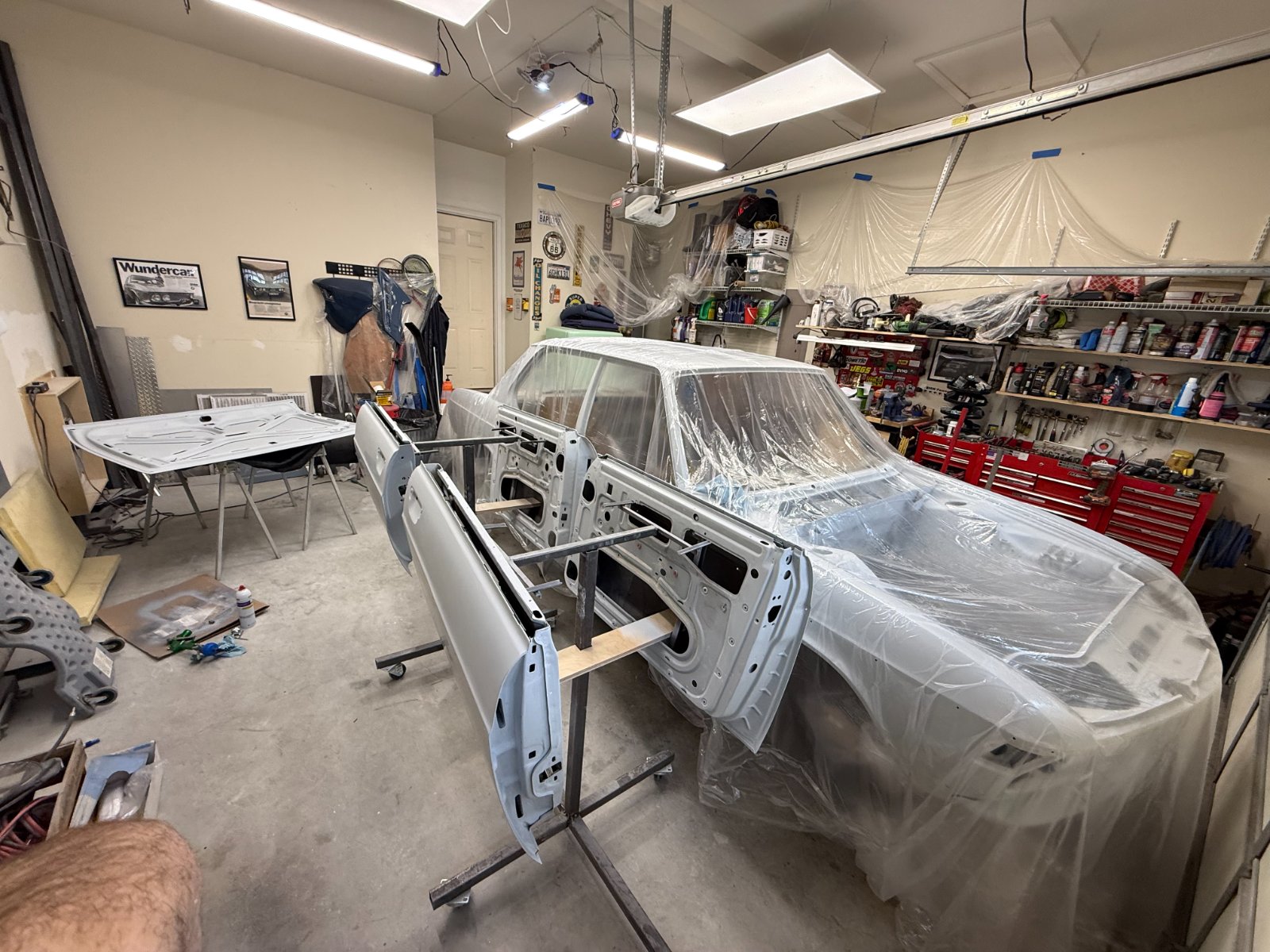

Finally primed the trunk and everything is ready to paint! I need to finish a client's job first, so hoping by the end of the month I'll be able to lay down color! What was supposed to be a quick, driver quality, fix up, turned into a 10 year full rebuild...with raising a couple kids and moving cross country in between...Sheeesh! Very excited to be getting the paint done and be able to move on to the parts I actually enjoy doing..the mechanical!! lol
For those of us that do the paint ourselves, I installed a big fan in the wall of my garage, and got to use it today while I did the primer on the trunk, and it worked great! There was no mist in the air, and I took my respirator off after spraying and there was almost no smell either...so happy about that! I believe I'll build another jig to hold the trunk and hood for paint, and paint those, along with the doors together...then I'll tackle the body after I can move the doors/trunk/hood into the house to make room. Lucky to have a supportive wife...LOL.

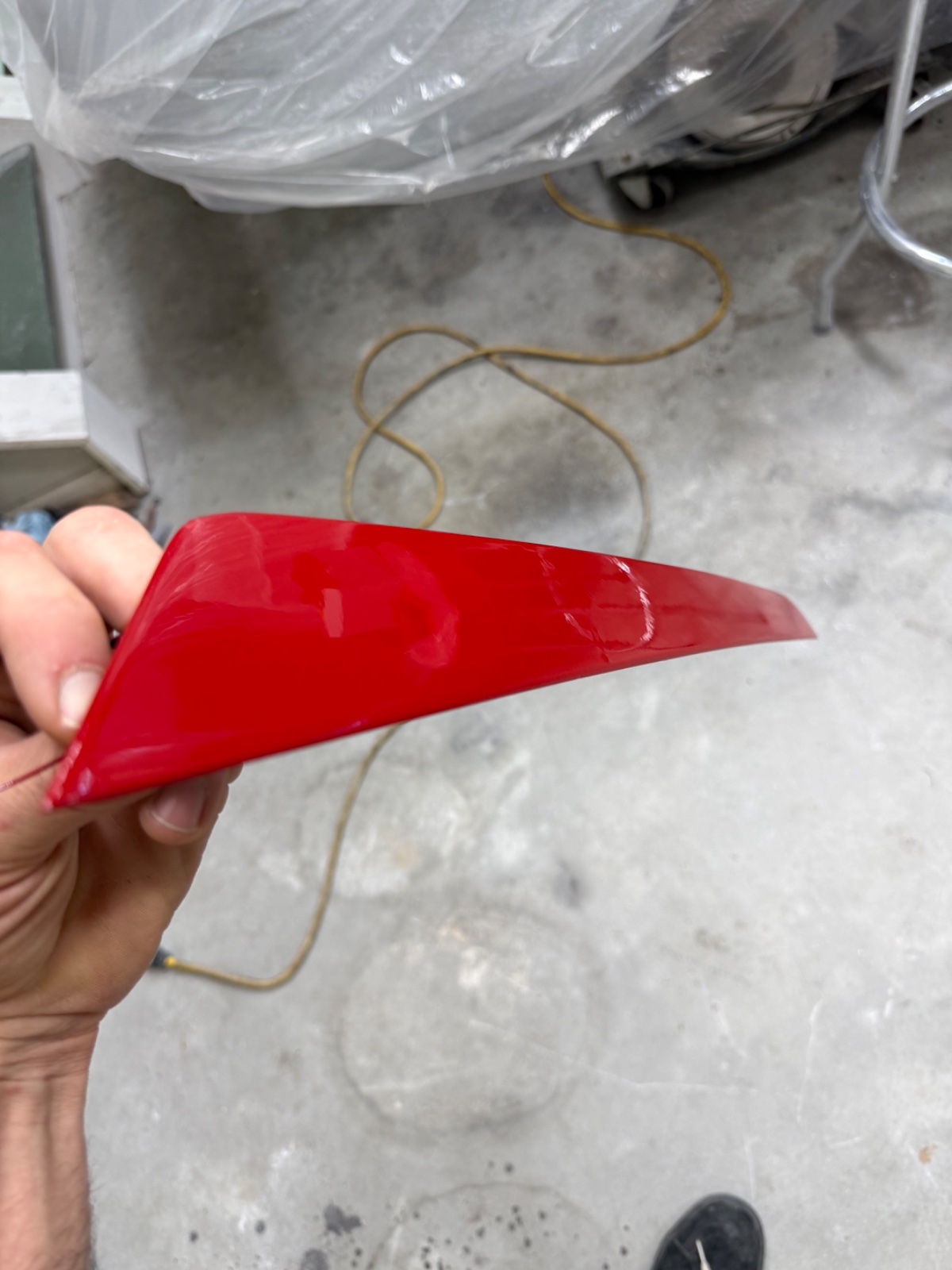

Milestone day…I have to run out of town, but wanted to get a test bit of color on the car. Granada 023! I’ll redo this piece, but it’s so wild seeing color on this for the first time in 10 years! I should be able to fully paint in the next couple weeks..
I thought I had mentioned it earlier..or maybe another thread. lol. The blues all started to look like every other modern car on the road..none of them really grabbed me..then the Granada just jumped into my life..and it was love…
