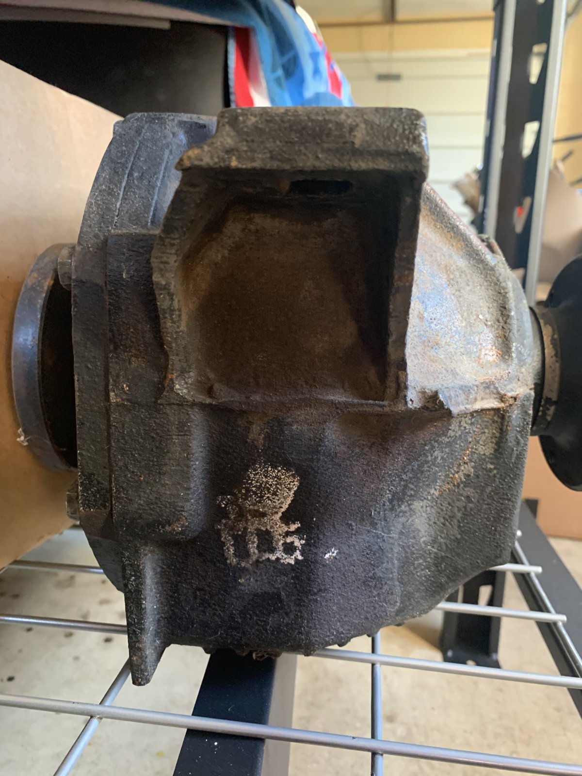

In looking at my diff, I came across some writing in chalk that I can’t decipher. Can anyone decode this? Did I get lucky...is this diff limited slip?
It can be painted but stamped is very common.
Ok, I checked again and found no stamp. However, upon closer inspection of the white, chalky script that I photographed, there is a faint “S” on its side, just underneath it! Can anyone else make it out, or is this just wishful thinking?
