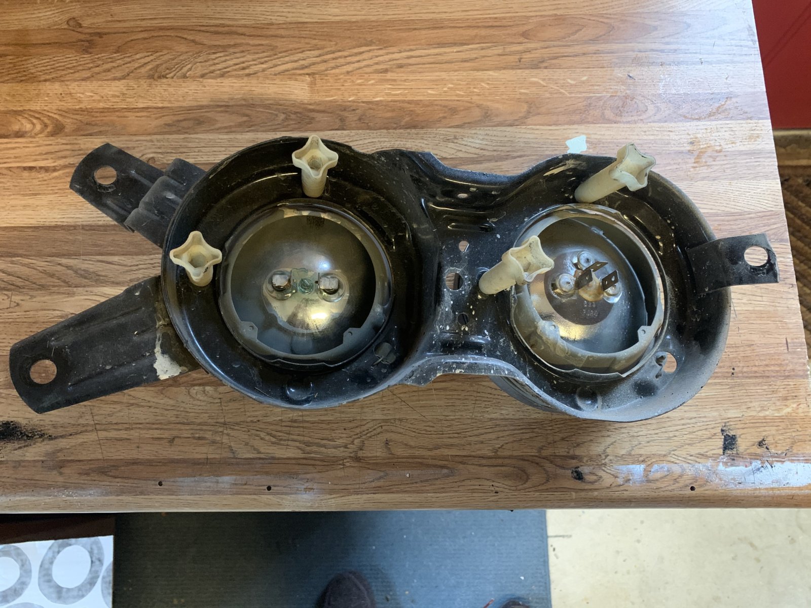

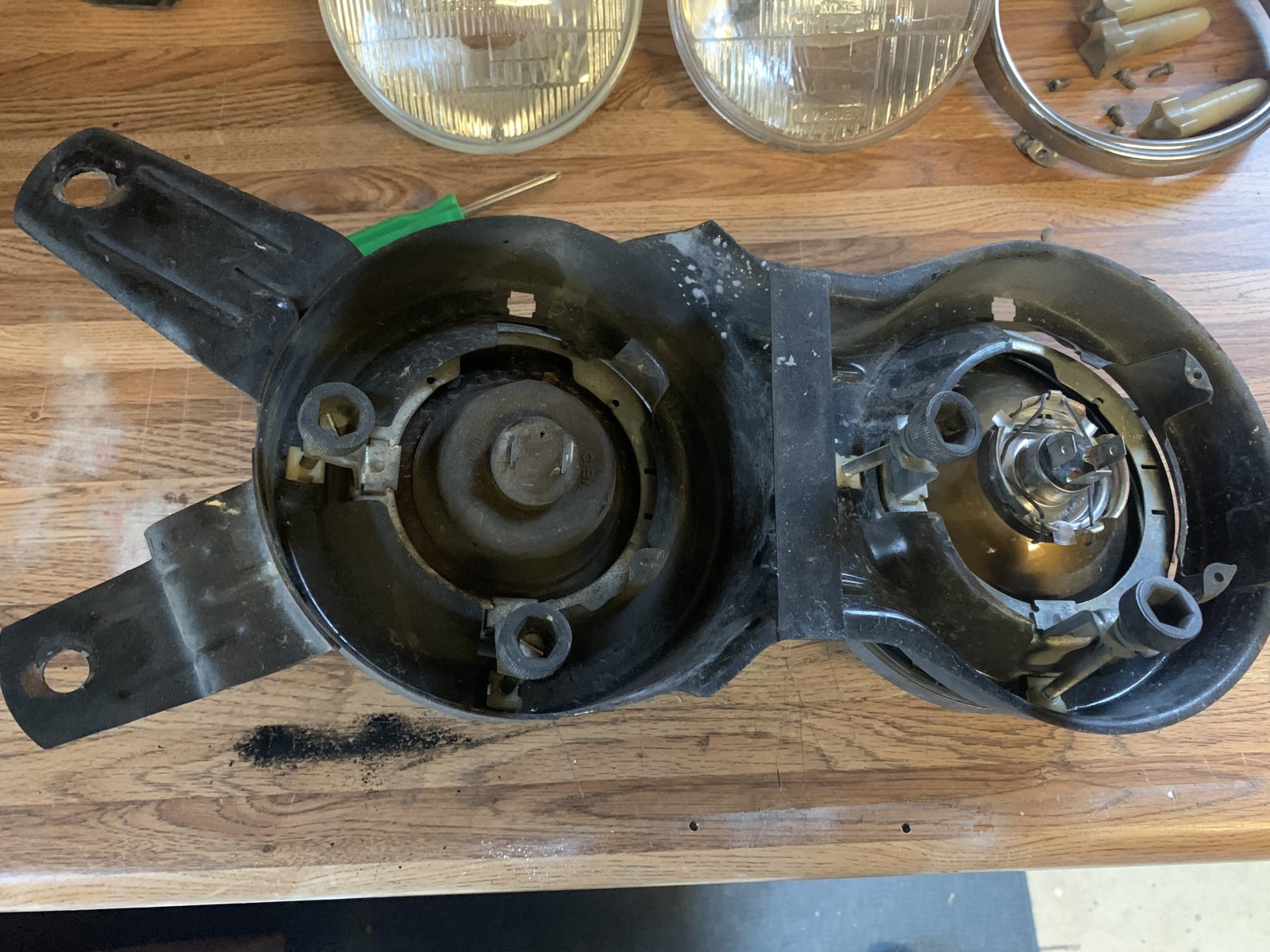

I am tackling the restoration of the headlights, tail lights, and side markers. Didn’t take long before I found a discrepancy; looks like the headlight buckets are different from right side to left side. Adjustment knobs are different which kind of affects how the headlights fit. Is the difference between the buckets stock; are the buckets from different years/models (e3); does the difference matter? Can’t say I noticed any difference before taking it apart, but knew that my headlights were terrible (not bright, did not cast a good pattern, and all four headlights are different models).
Walter, buckets are the same but adjusting screws were small on 2800CS and changed to the long plastic ones on 3.0CS.
