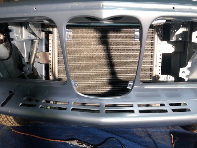

I completed this conversion about a year ago. Attached is a list of the hose fittings, hoses, condenser coil and compressor part numbers and cost at that time. I used the same conversion bracket as shown in the threads. I had some old R12 and used this changed the compressor oil and it works very good. To fabricate the hoses I purchased the end fittings and some cheap clear plastic hose to arrive at the hose cut lengths (think twice cut once) and it came out great. The only part that I caution is once the new compressor is installed with belt the compressor pully is fairly close to radiator lower hose. To remedy this took some repositioning of the compressor mounting bracket and move the radiator as far toward the passenger side as possible. Got lots of photos of this conversion if you need.
