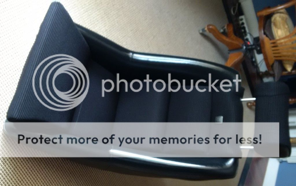

a scheel tale

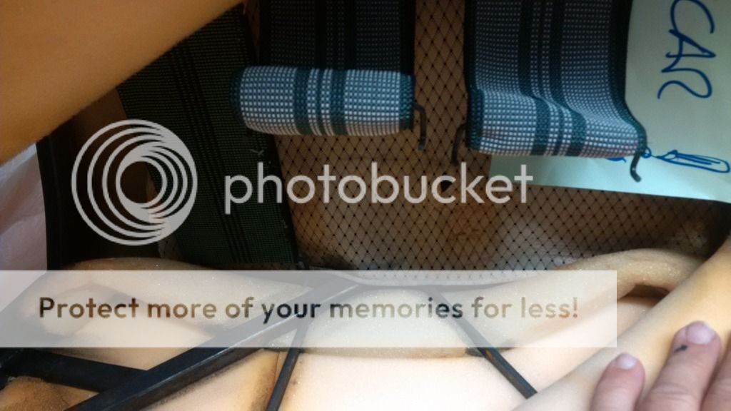

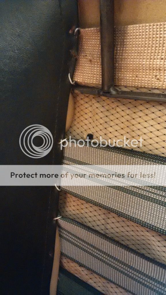

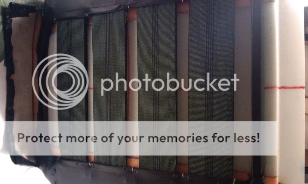

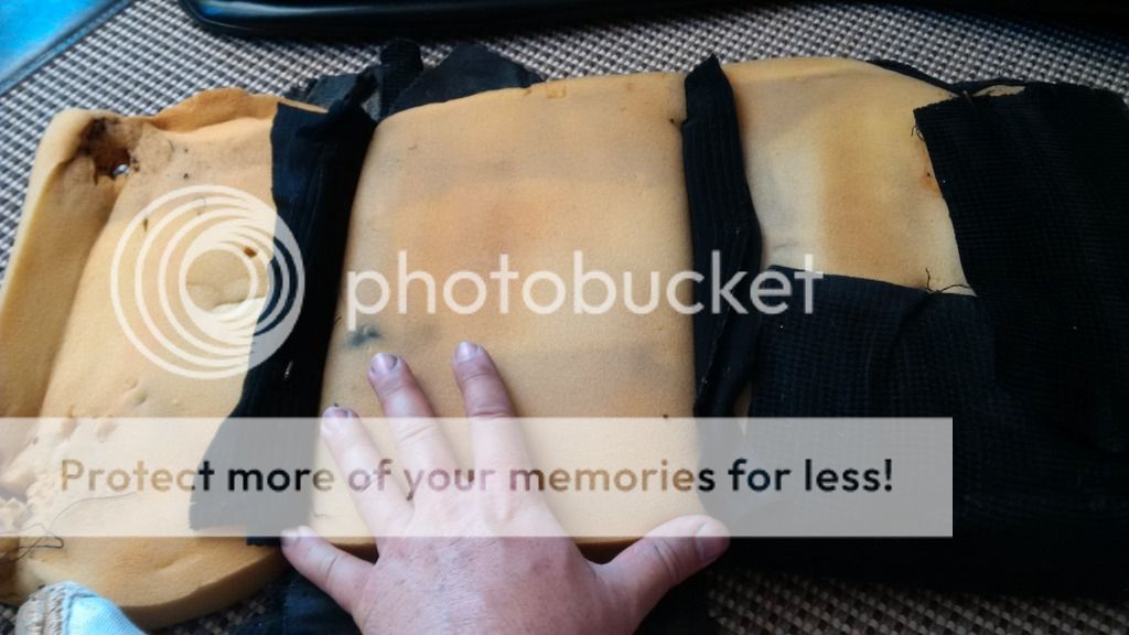

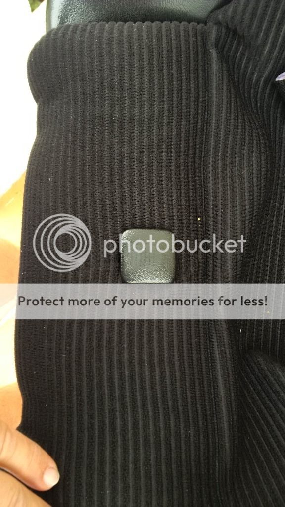

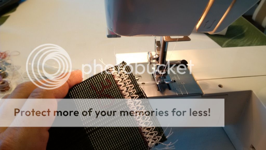

lets go to the reinforcements, final position is 33,5 cm

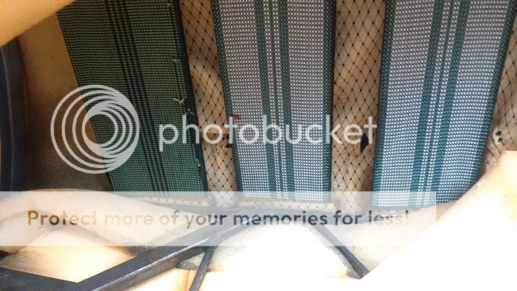

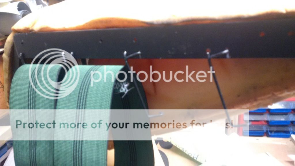

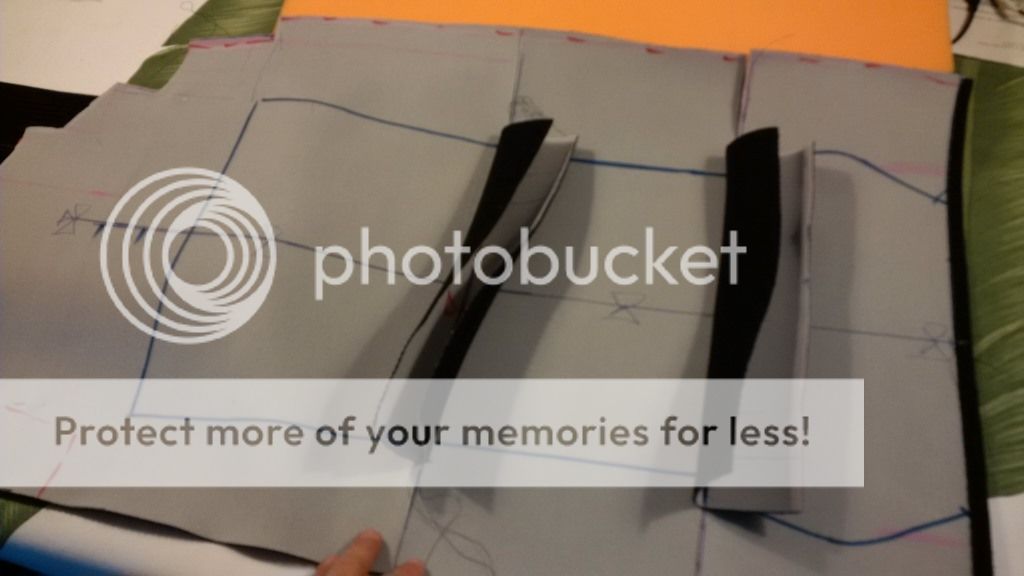

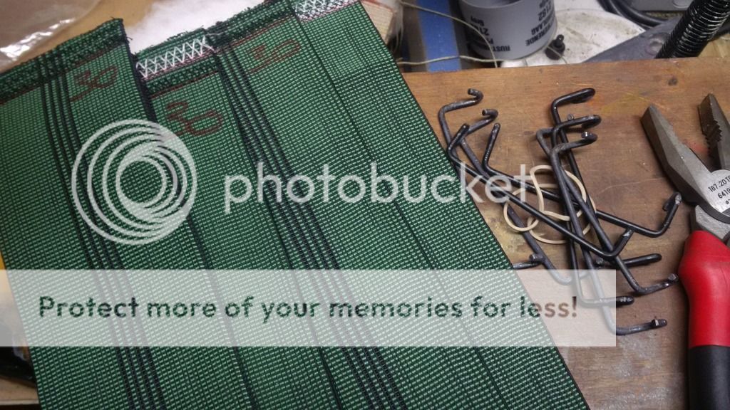

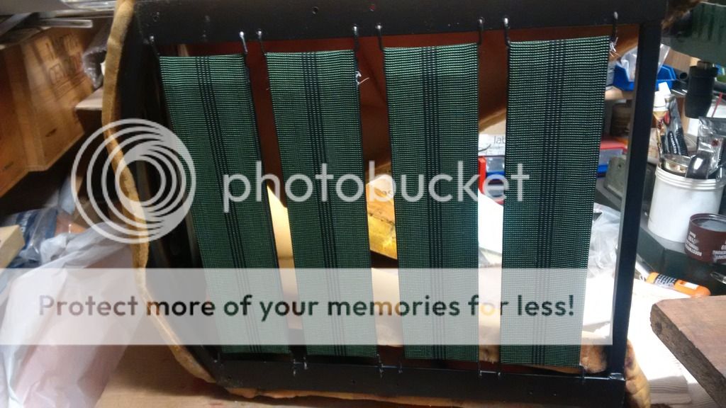

i will use two type of straps, the Green one is stronger (this will go on the bottom seat)

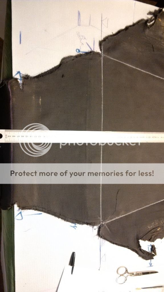

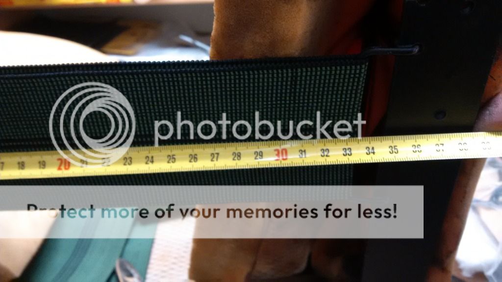

i will have to make them slightly smaller to pretensión them, so after some trials i decided to sew them at 30cm

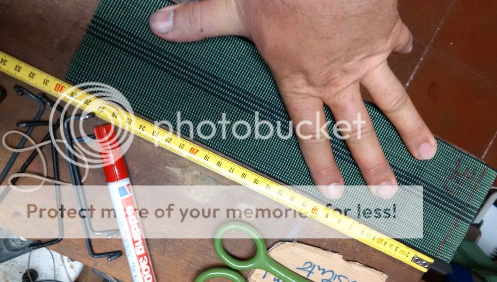

how to put them in place, these are the back ones, made at 35cm for a total width of 38cm
done

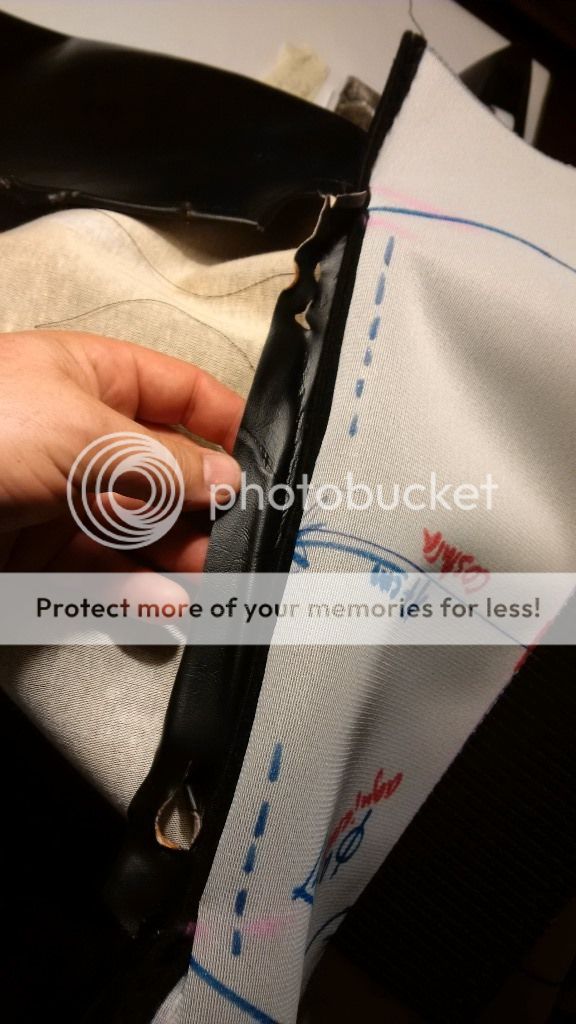

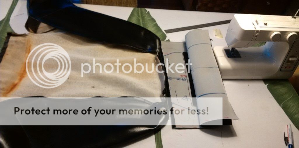

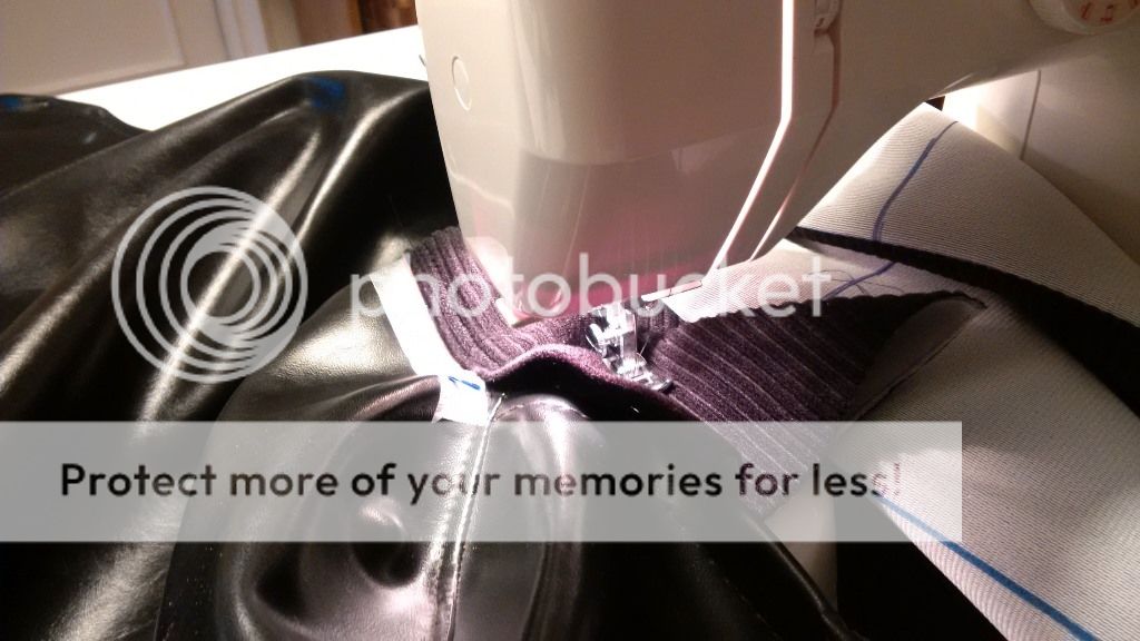

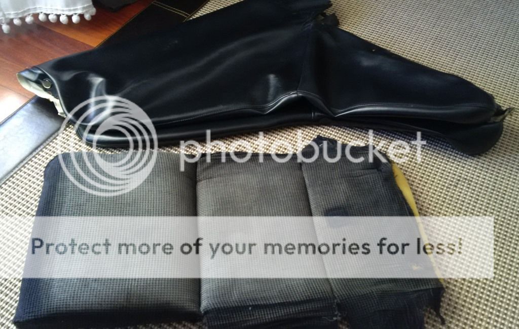

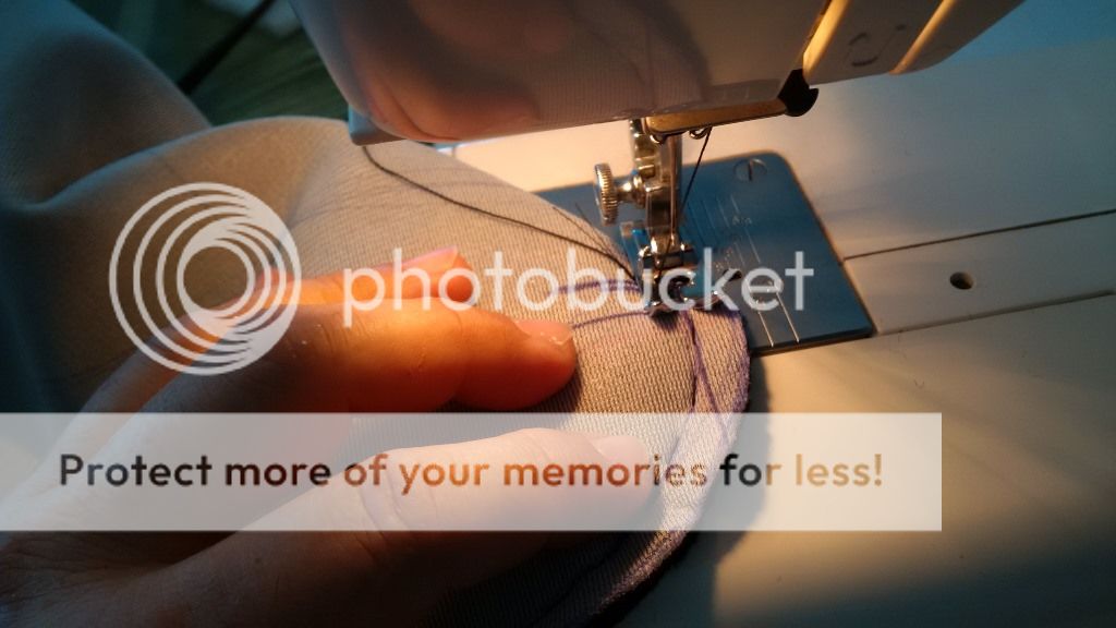

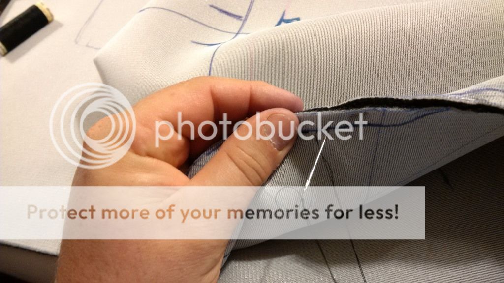

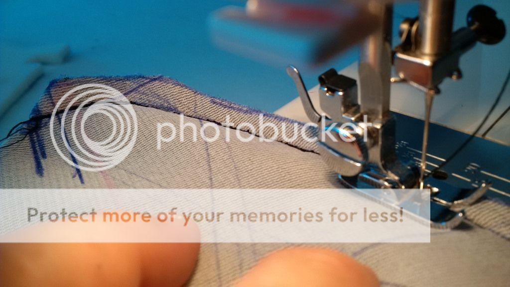

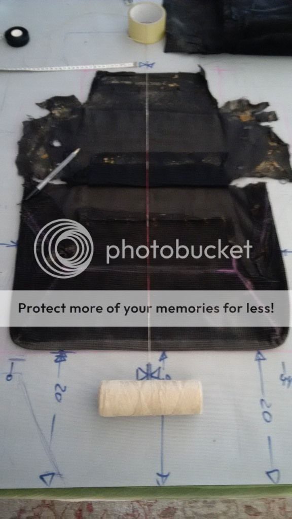

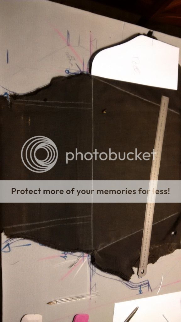

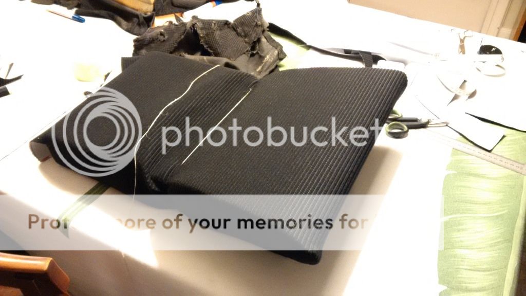

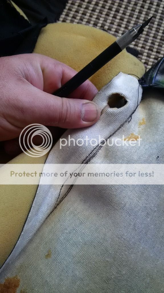

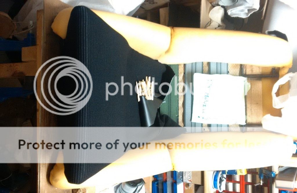

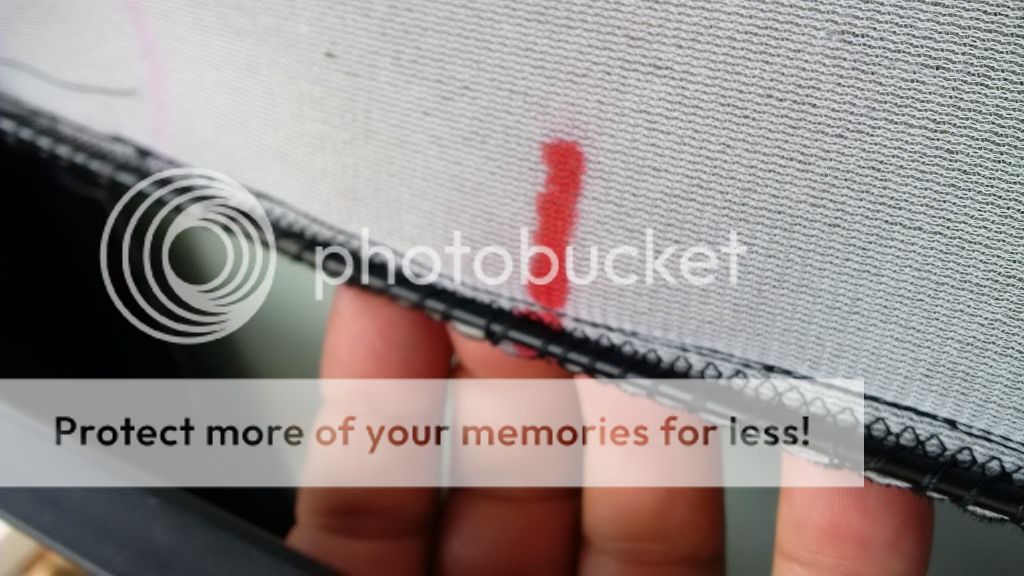

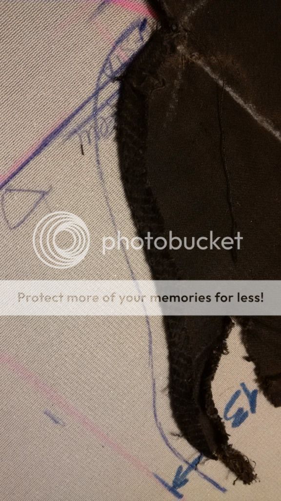

first i have to sew the central cloth to the vinyl, it is a very delicate task, and i have no room for puting the pieces into the machine
adhesive tape and marks for reference
done
seems good

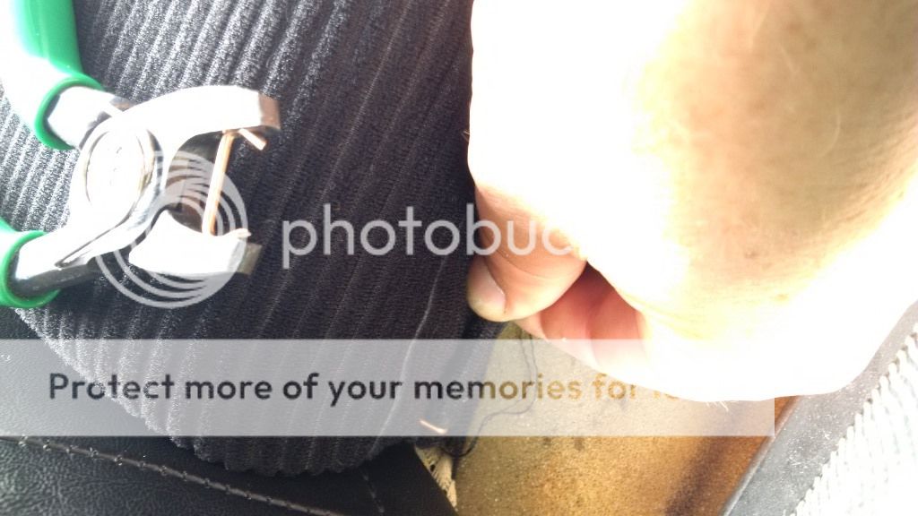

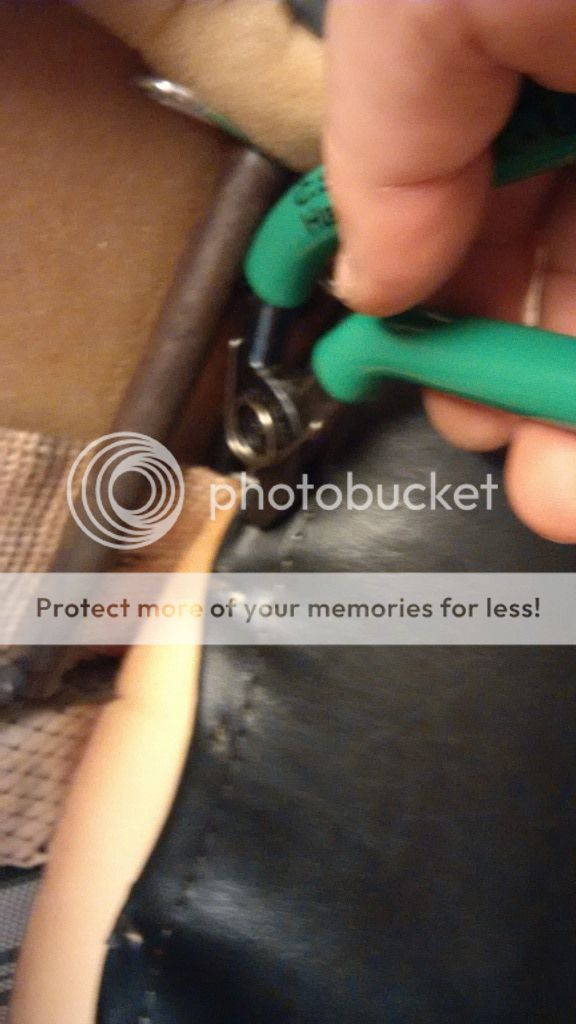

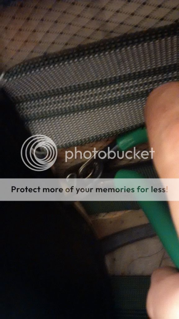

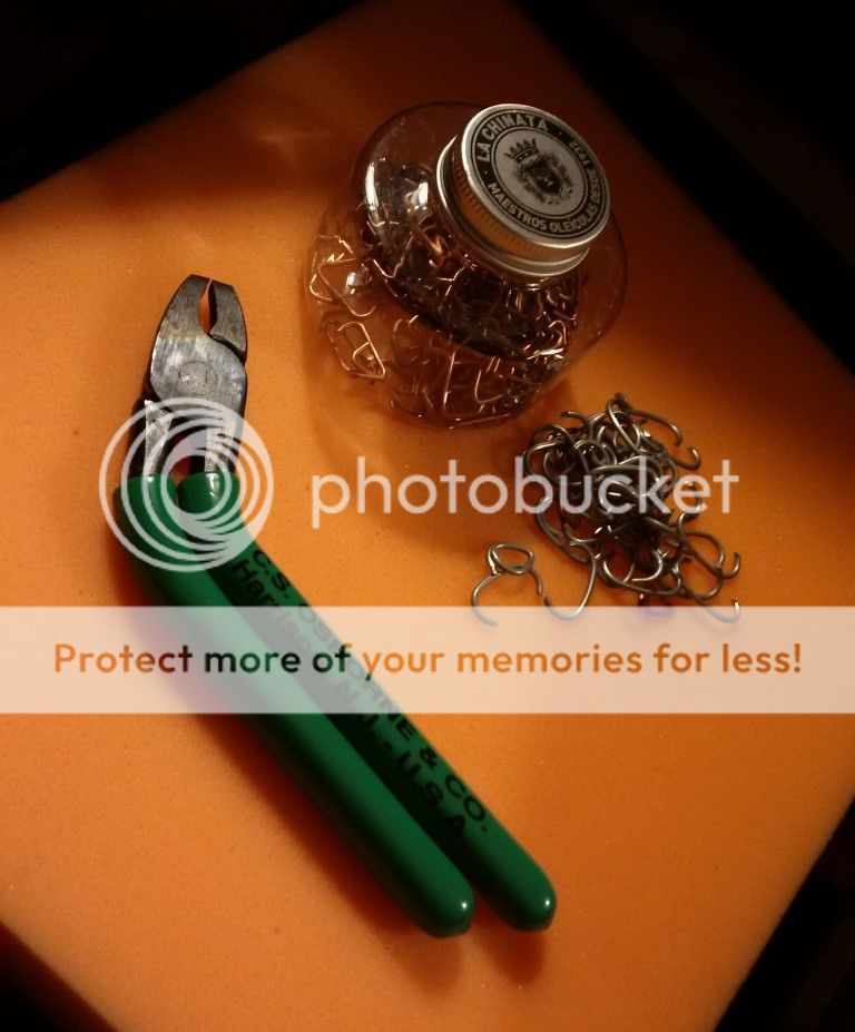

now time for the hog ring plyers that John found for me in London (thank you so much), this is a well recognised US brand in the uphostery world, curved plyers make the trick, very simple but efective
they are expensive but no way to Work in a seat without them,

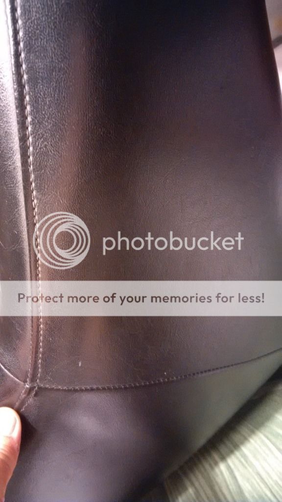

finished vinyl surface tight as a drum

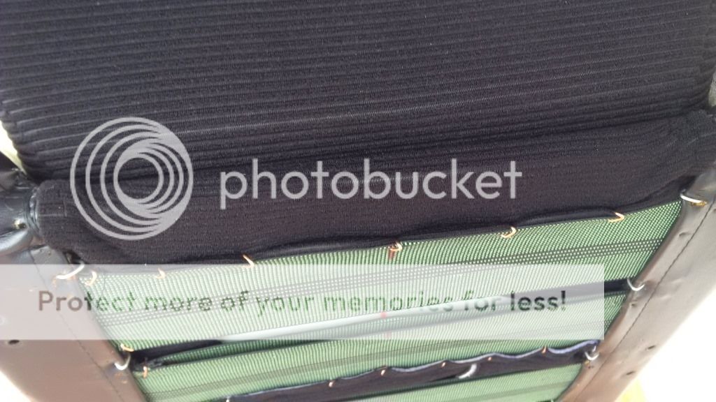

done the bottom part, the vinyl has two Steel wires that i use to retain the rings

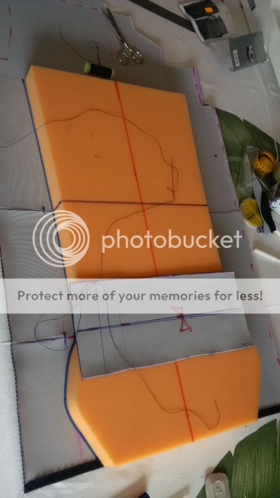

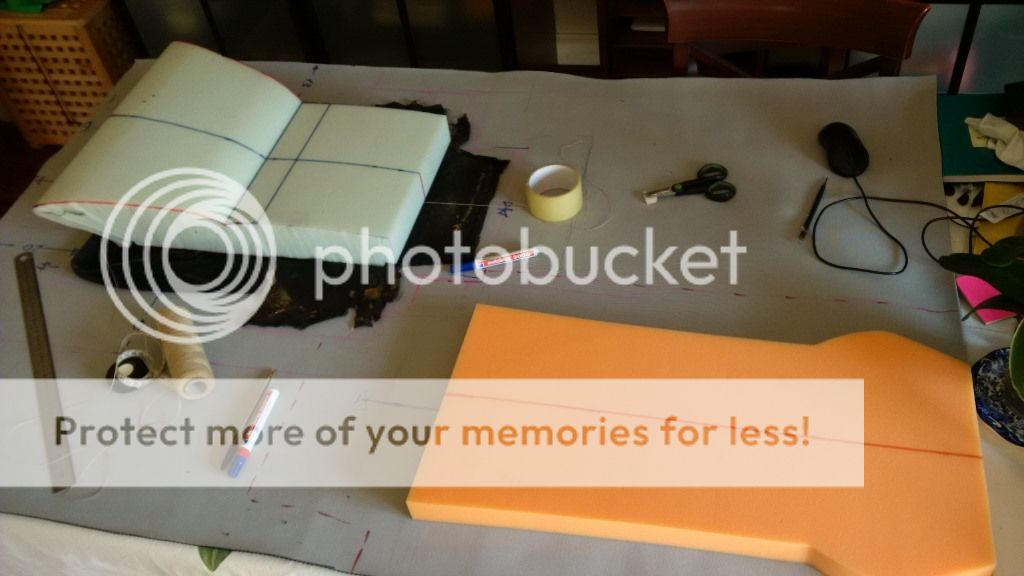

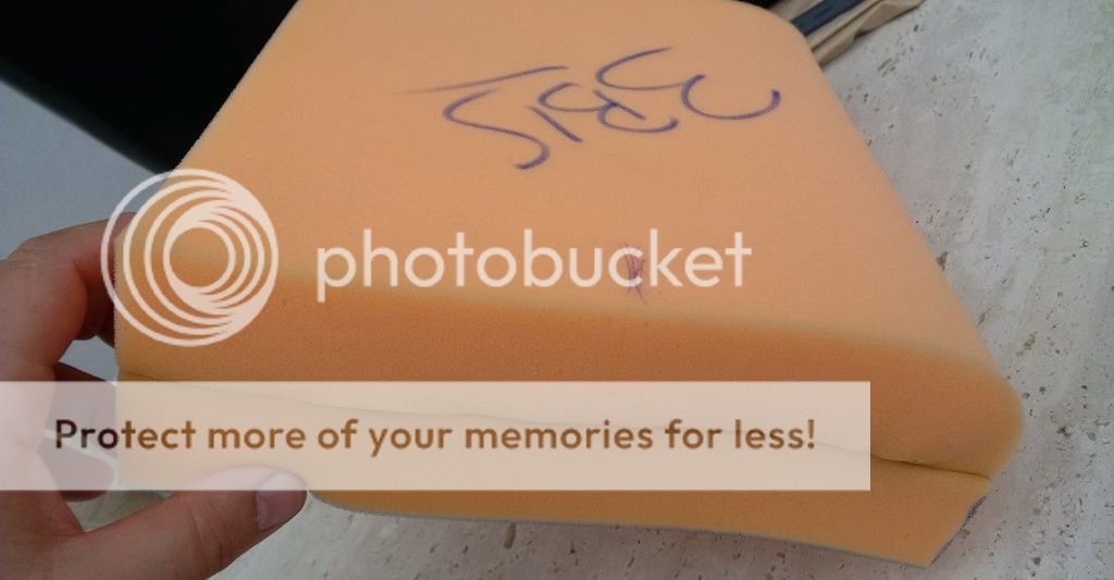

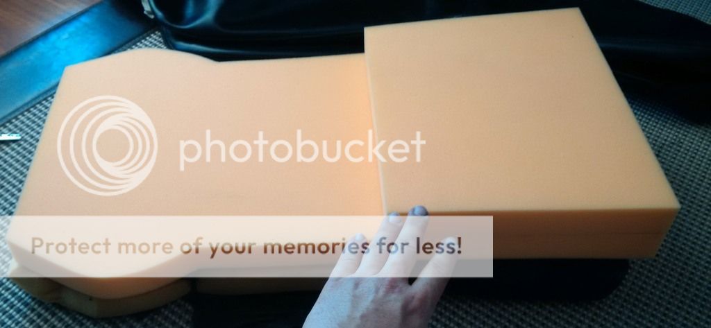

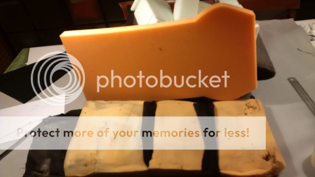

check foams in
a general view ready for a next step

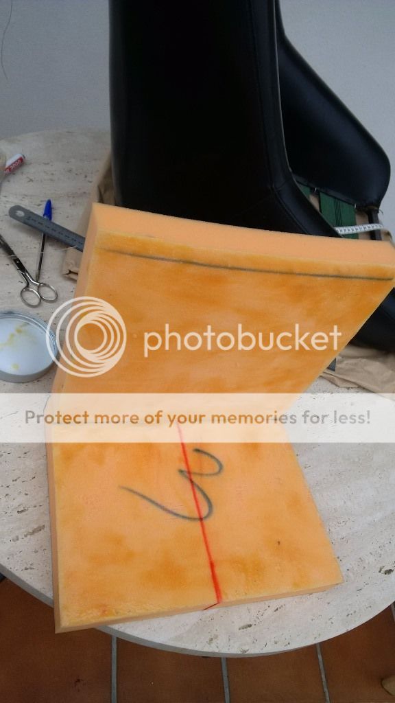

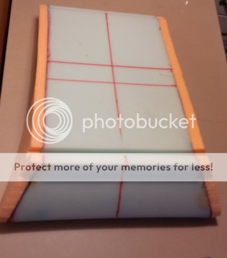

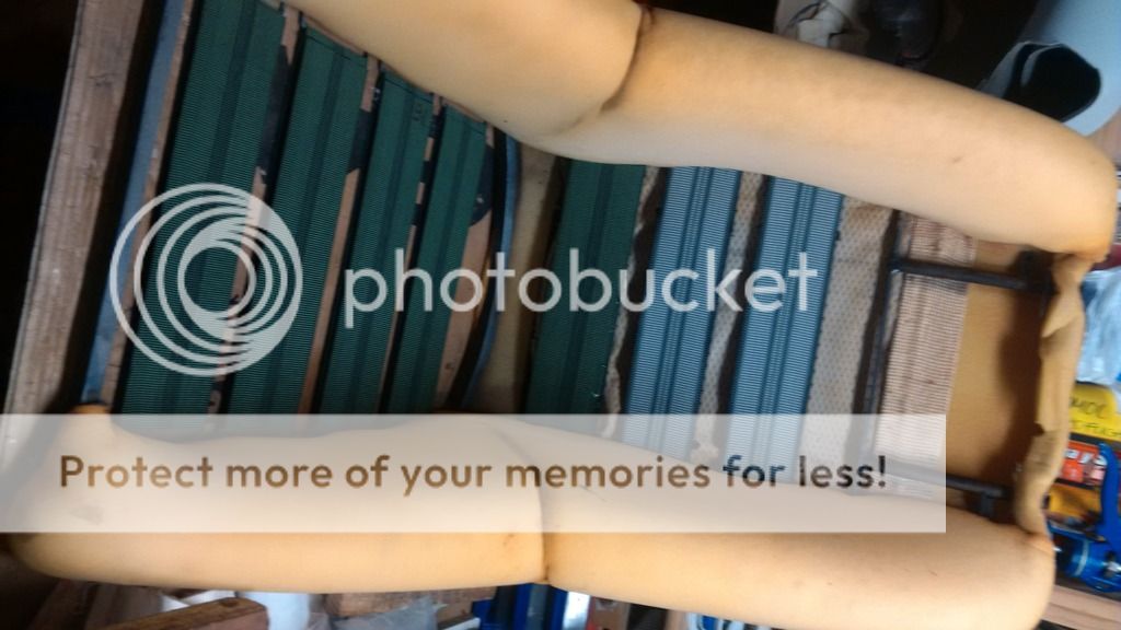

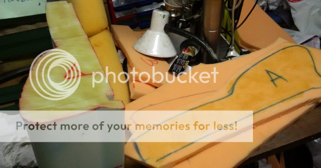

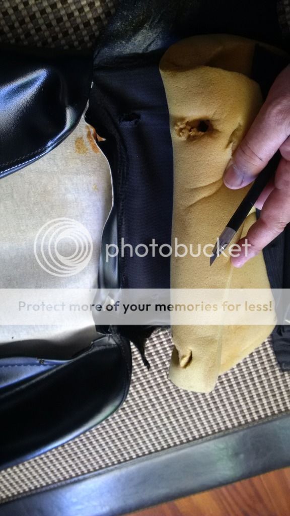

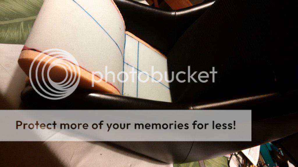

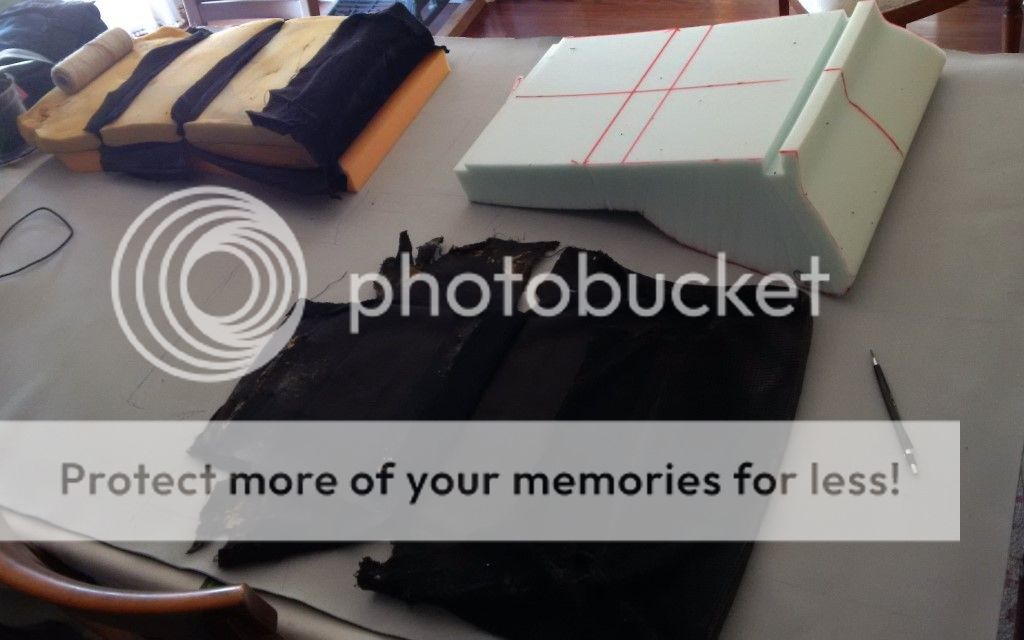

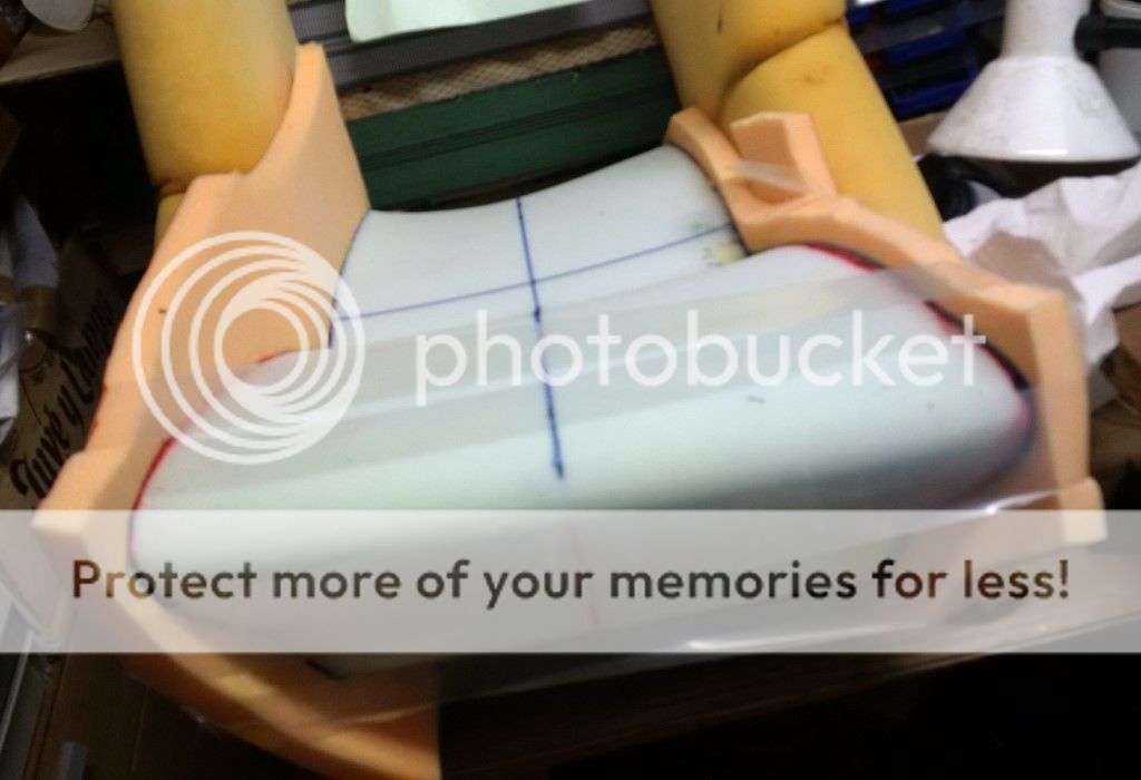

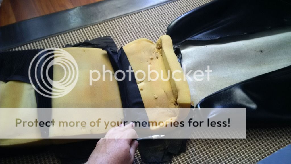

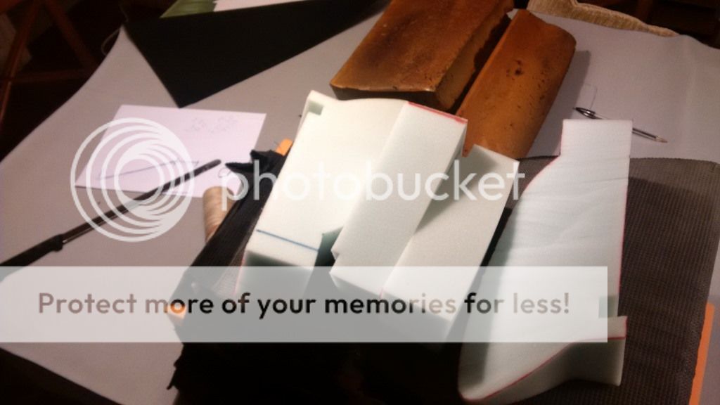

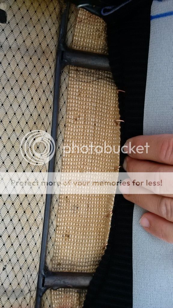

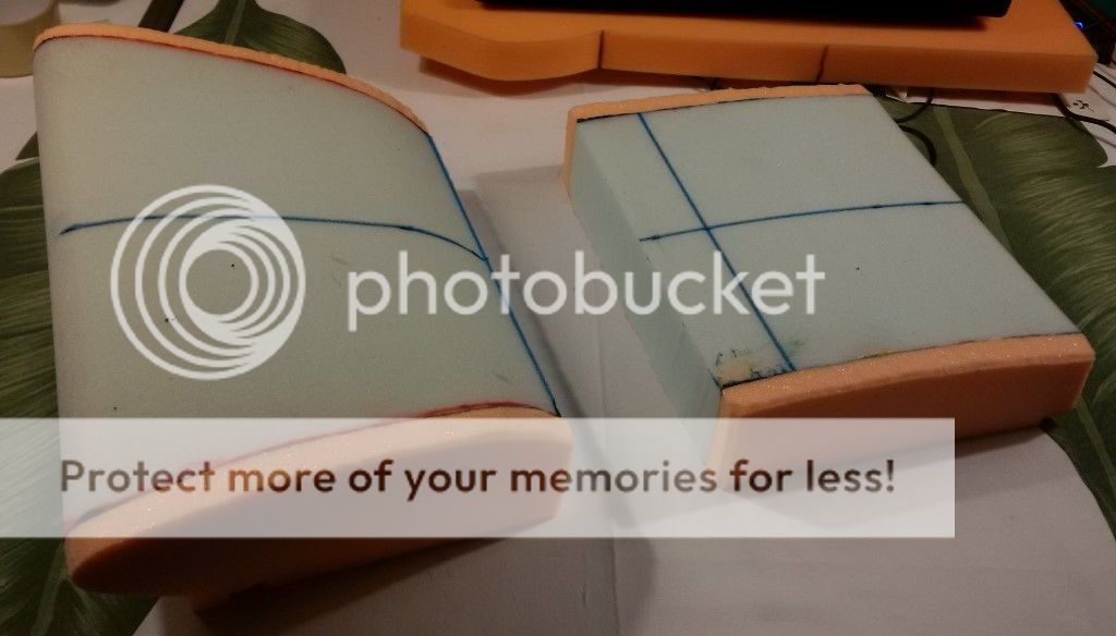

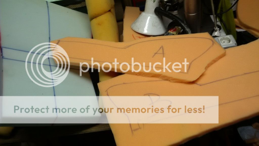

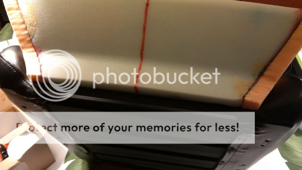

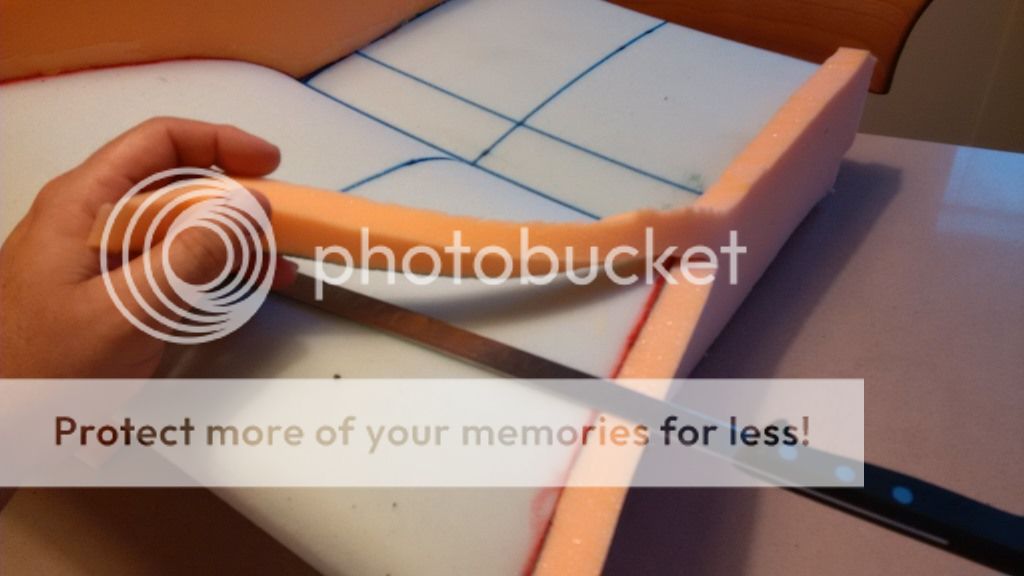

i have to cut the back foam, it is not what i was supposed to do, but i found no other way,

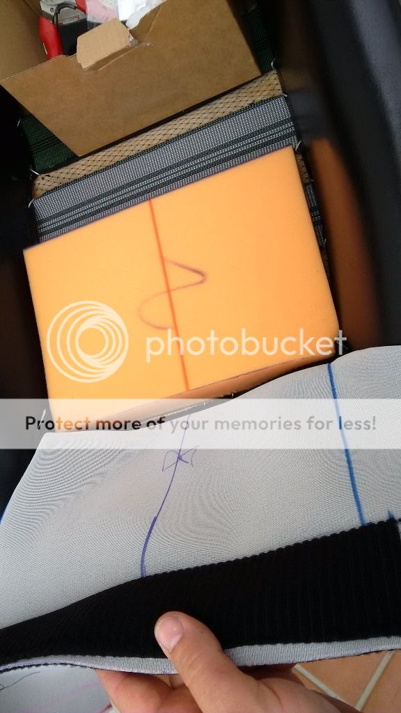

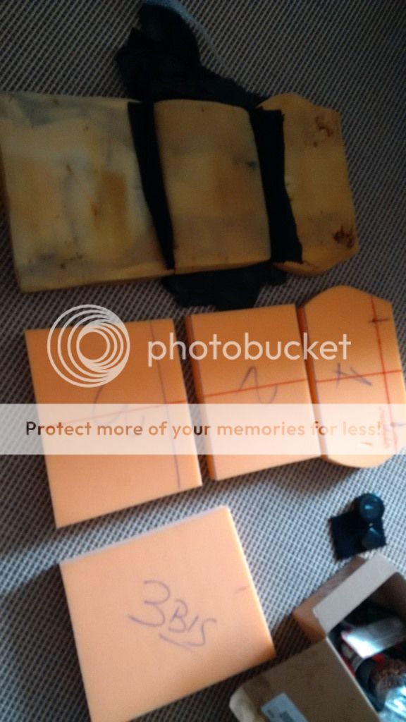

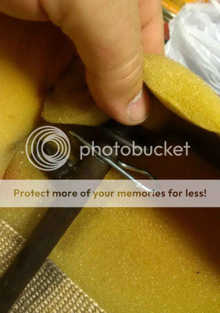

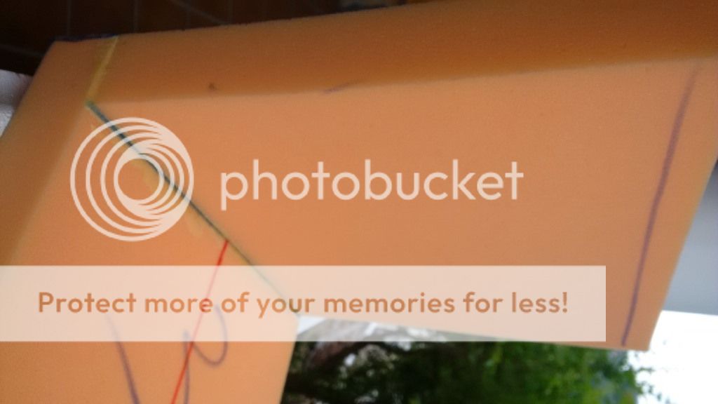

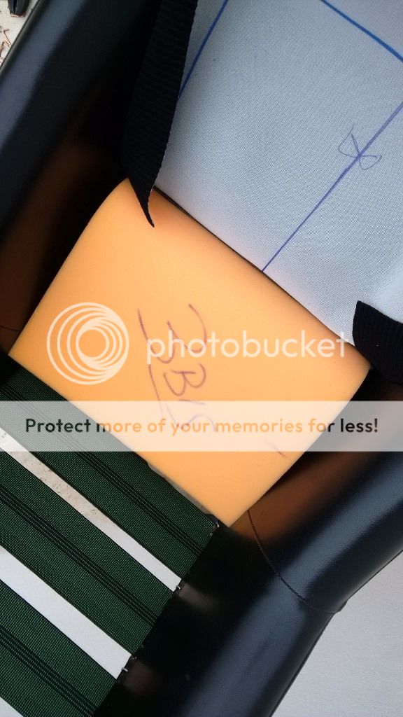

see the 3 and 3 BIS, a curious glueing to make the shape:
start on top, introduce foam "1" and start with hog rings

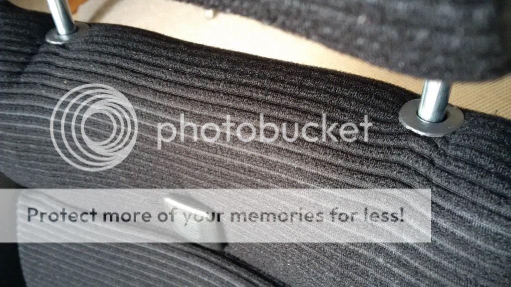

put the top caps and headrest

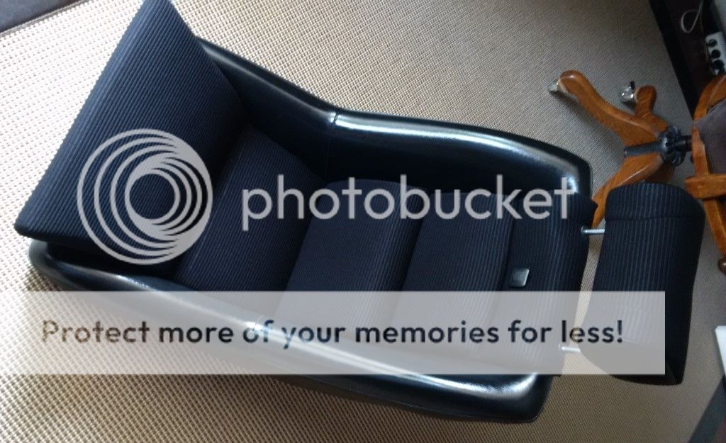

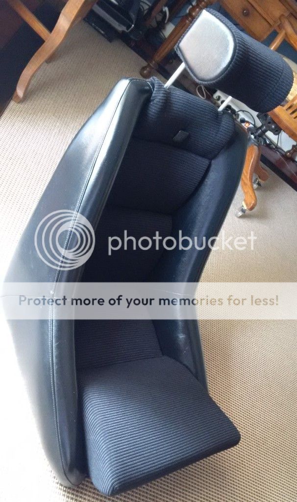

and it is done:
a scheel:
So you just did the driver side?
Awesome work. Is it comfortable or were you following your precept of "form follows form"?
yes, only drivers seat, in fact i have only one seat, looking for donations to get a second one, ;-)
as to your question, this is not a form follows form, i am looking for a better driving position, firm and stable
i have only tried the seat as it is, and i can tell that you fit like a glove on this scheel seats, looks and feels promising
