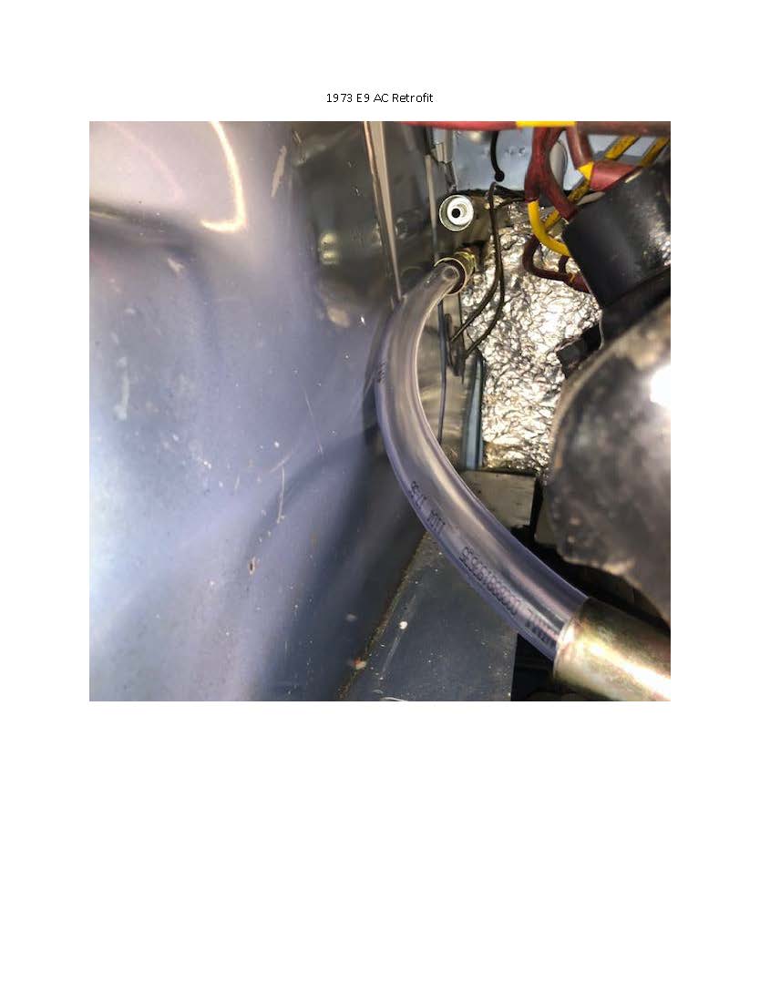

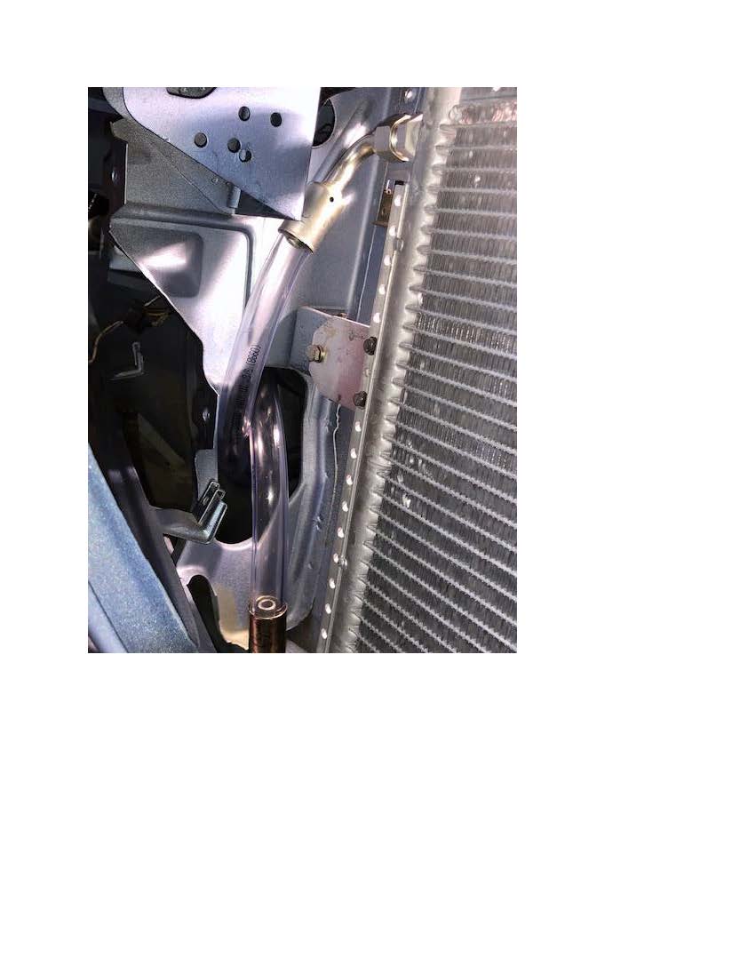

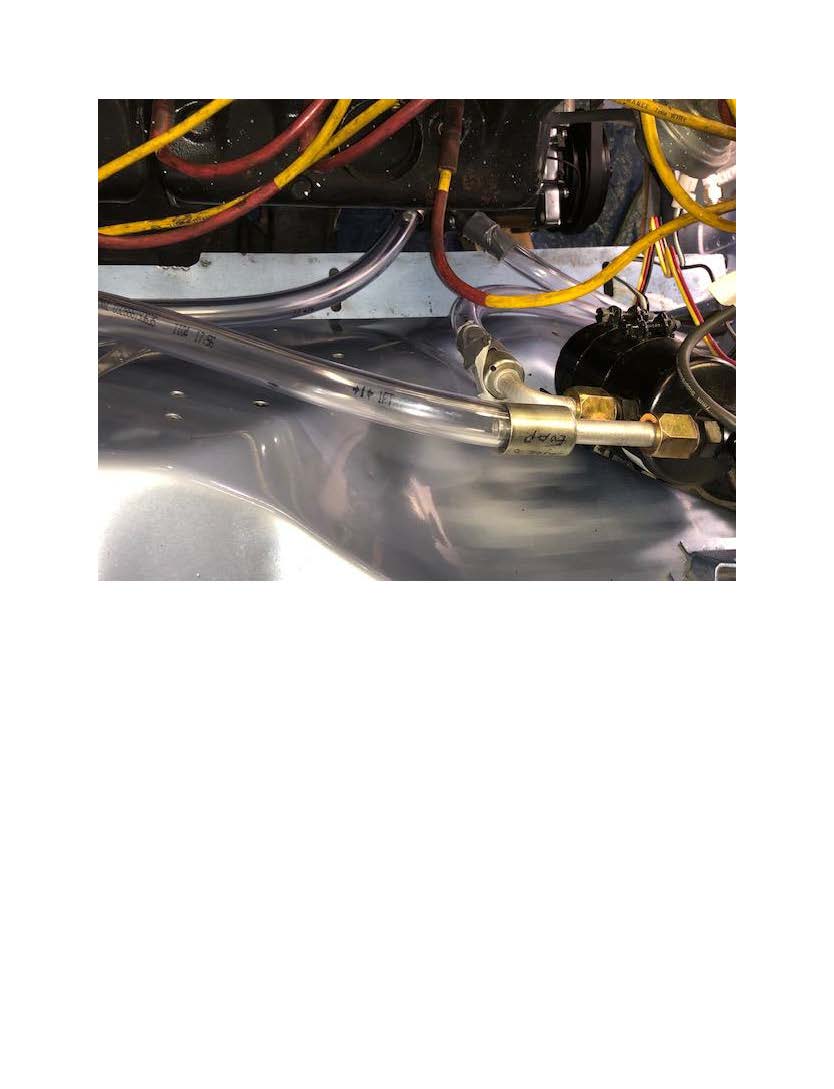

This is a fairly straight forward conversion. My evaporator coil was n good shape so I stayed with the original as the TXV is designed for R12 I stayed with that. Parallel flow condenser a must - rebuild the condenser fan or a new one. Attached are some useful details on performing the conversion. Before cutting the hose length mounted all the fittings and used inexpensive vinyl hose to simulate the routings/length. Condenser cost about $100. The other PDF details all the required fittings and costs at that time. Johnsjoy has all these parts including compressors. One important item (for me) was the close proximity of the compressor pulley to the lower radiator hose- with engine rock make sure to position the radiator as far right(passenger side) as possible and adjust the compressor mounting bracket to get optimal clearance otherwise you will cut the hose. My system works great. Good luck.

Fabrication included making some bracket extensions for the condenser to fit the existing one seen in this pic:

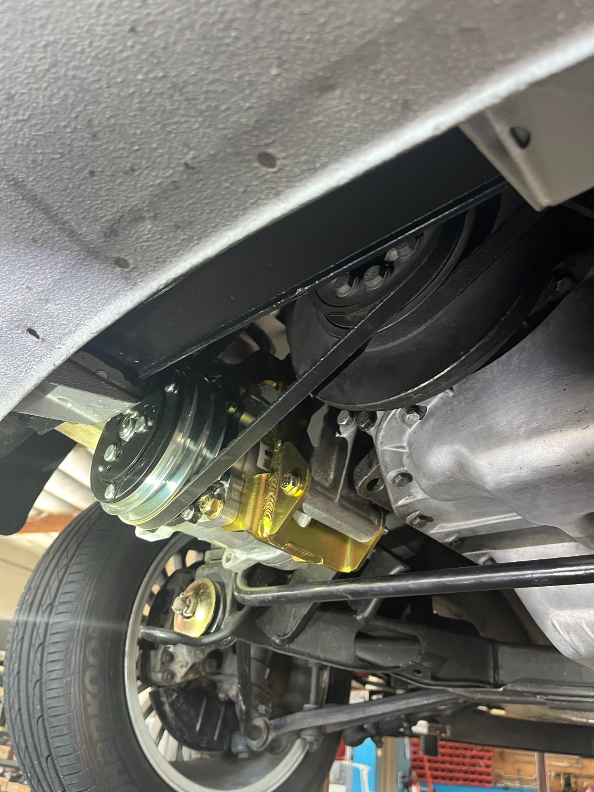

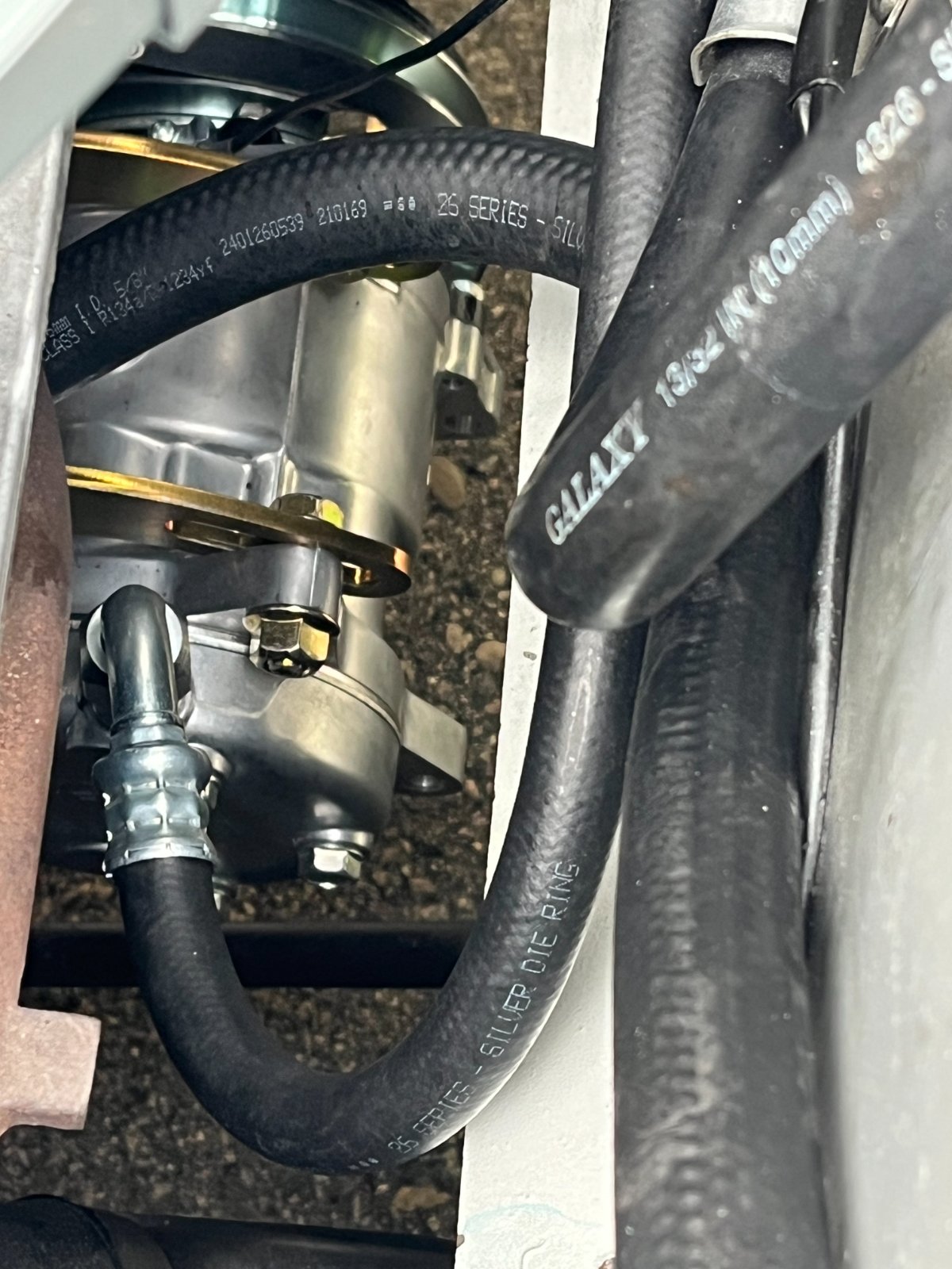

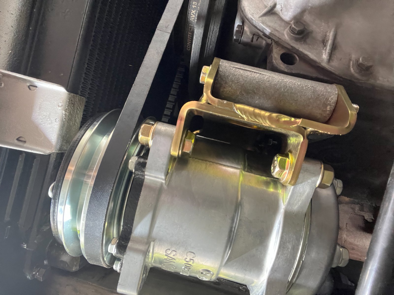

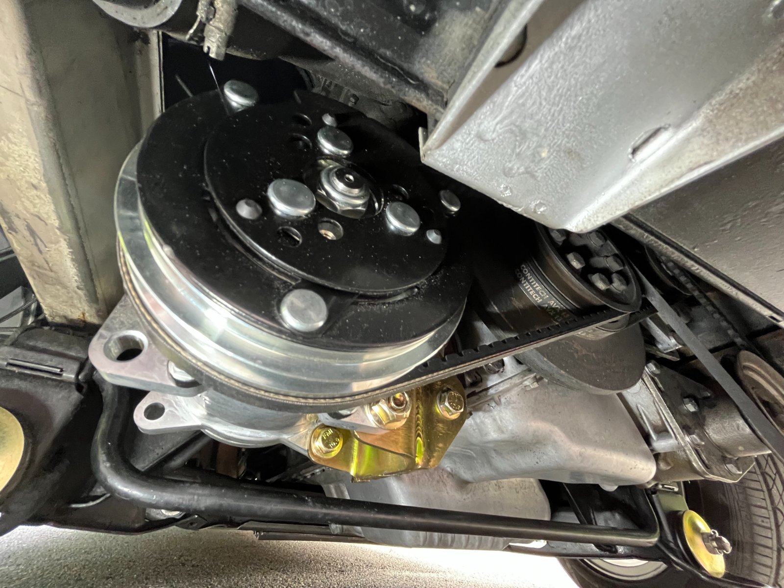

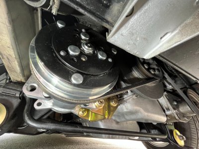

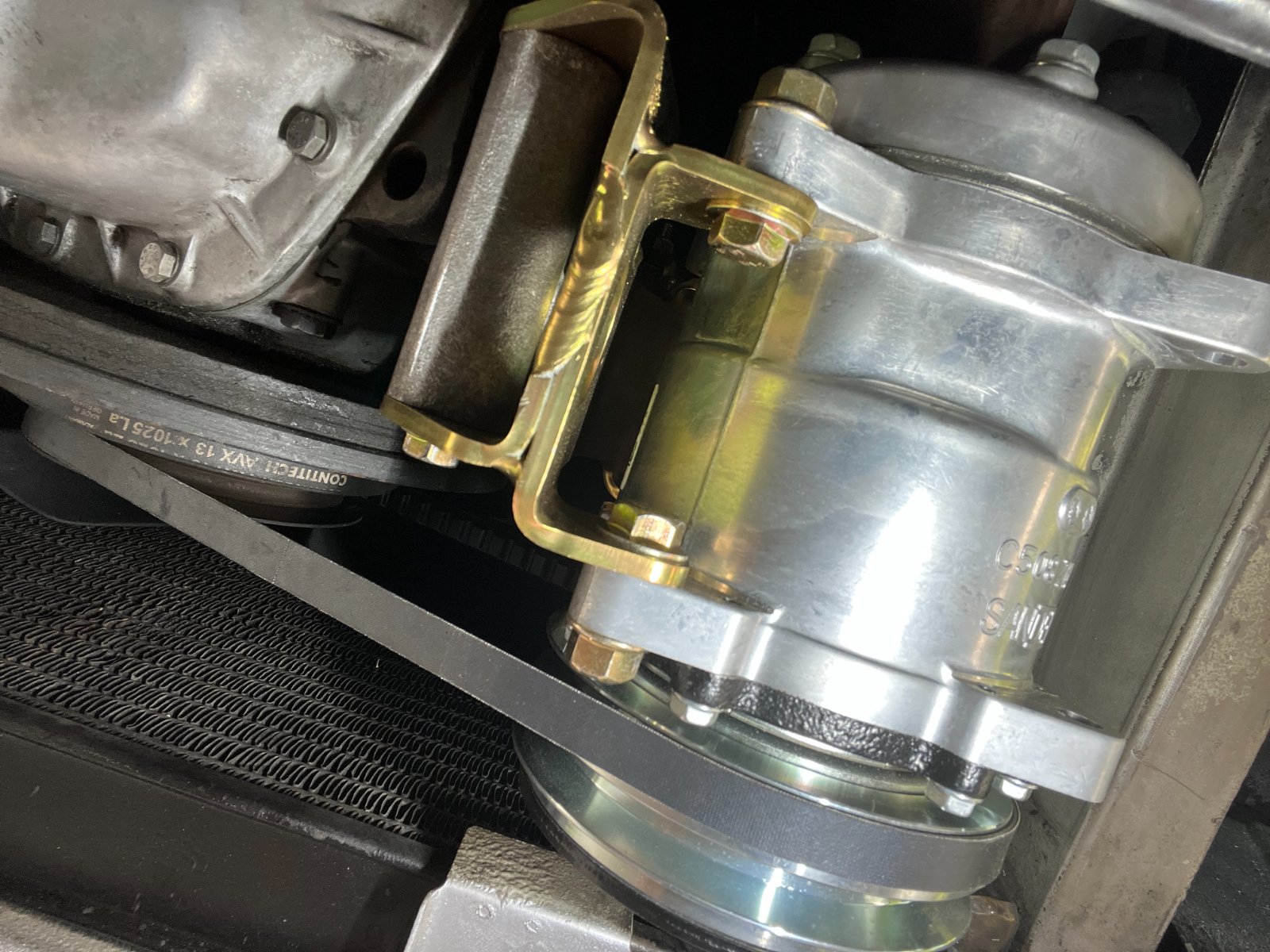

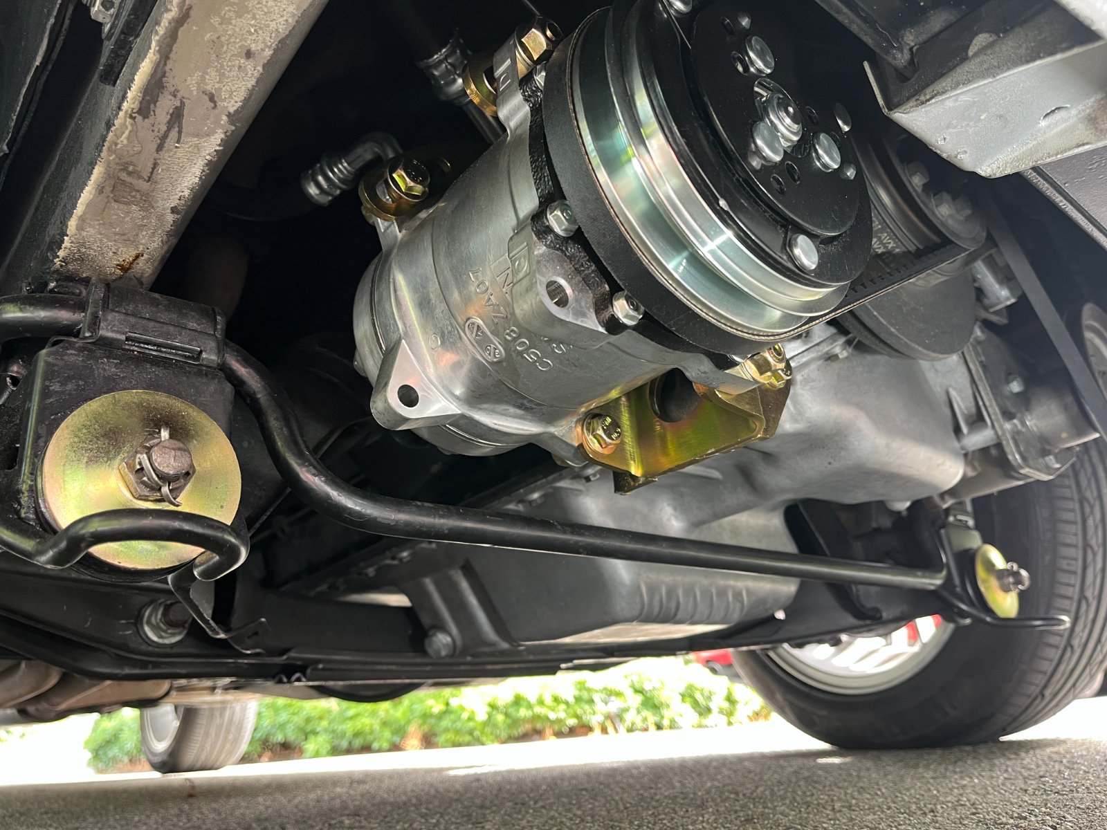

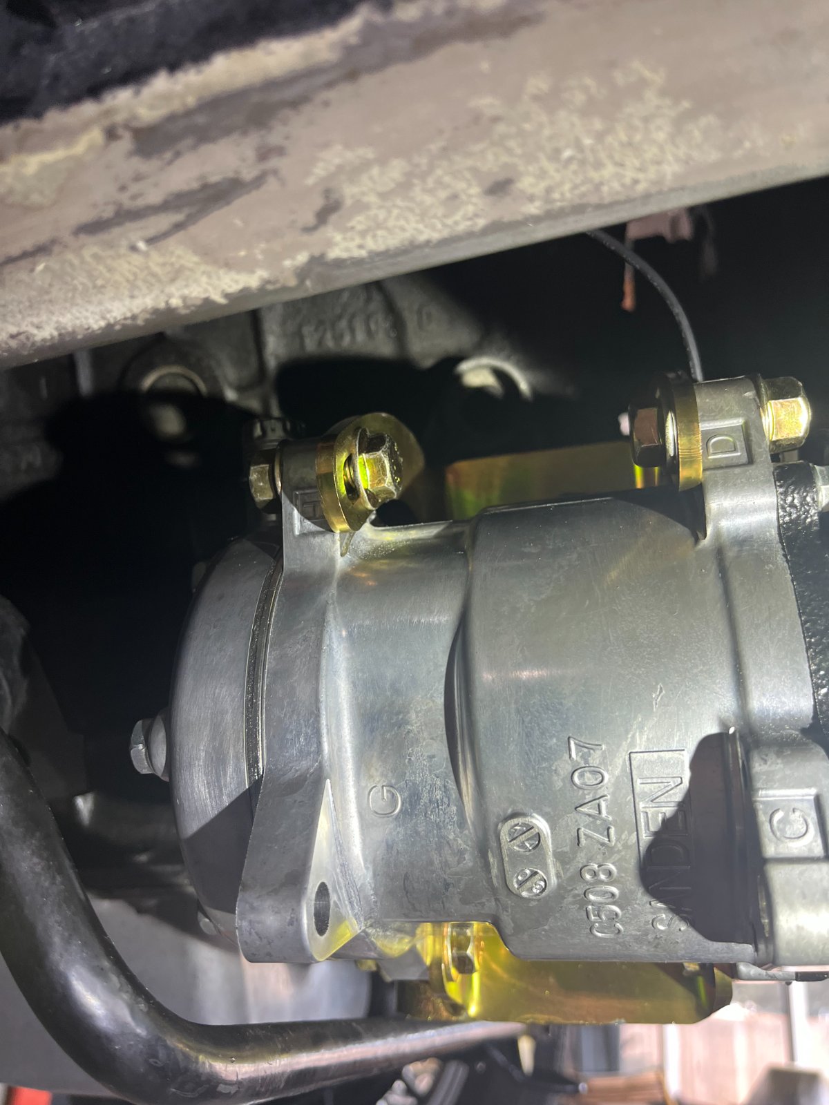

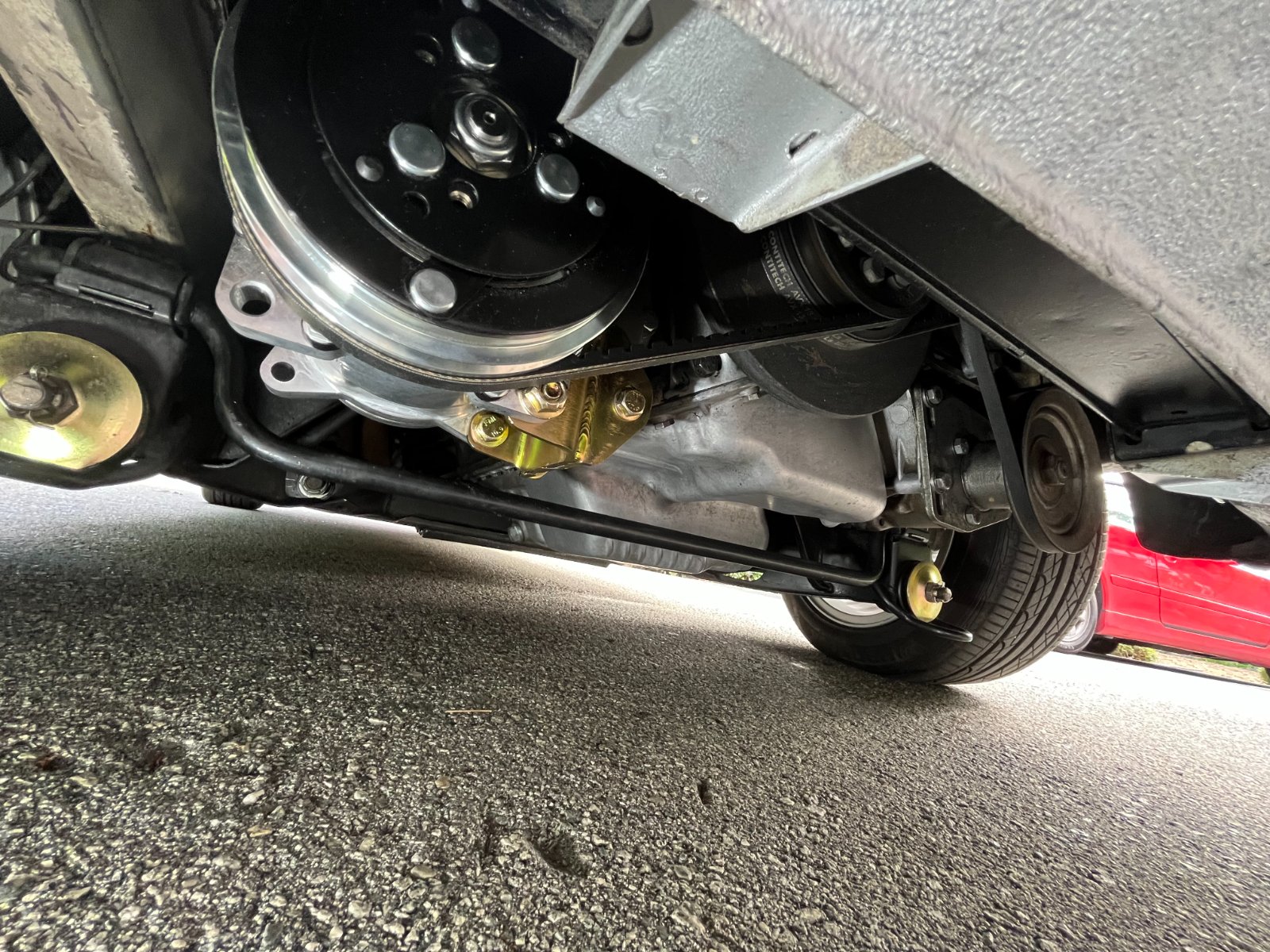

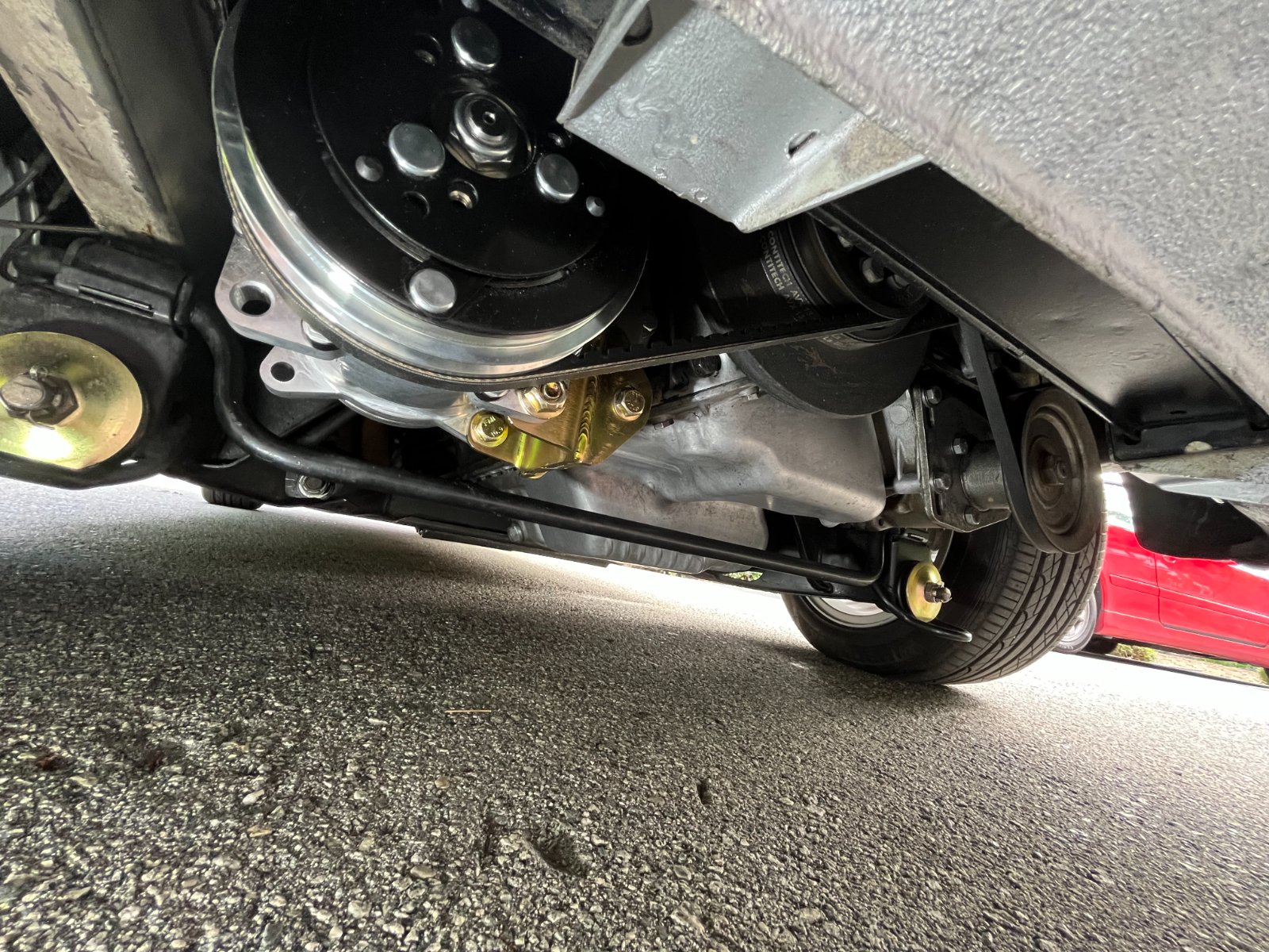

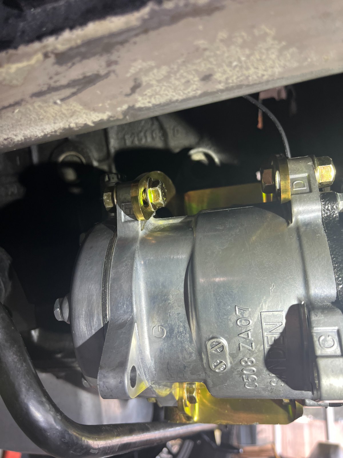

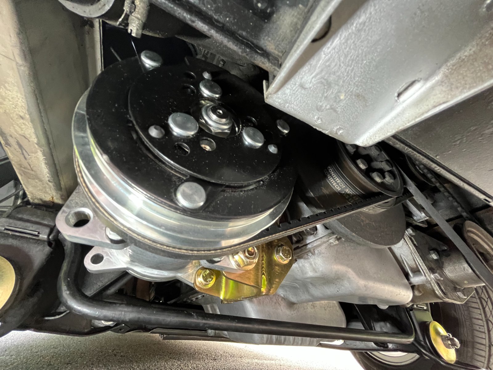

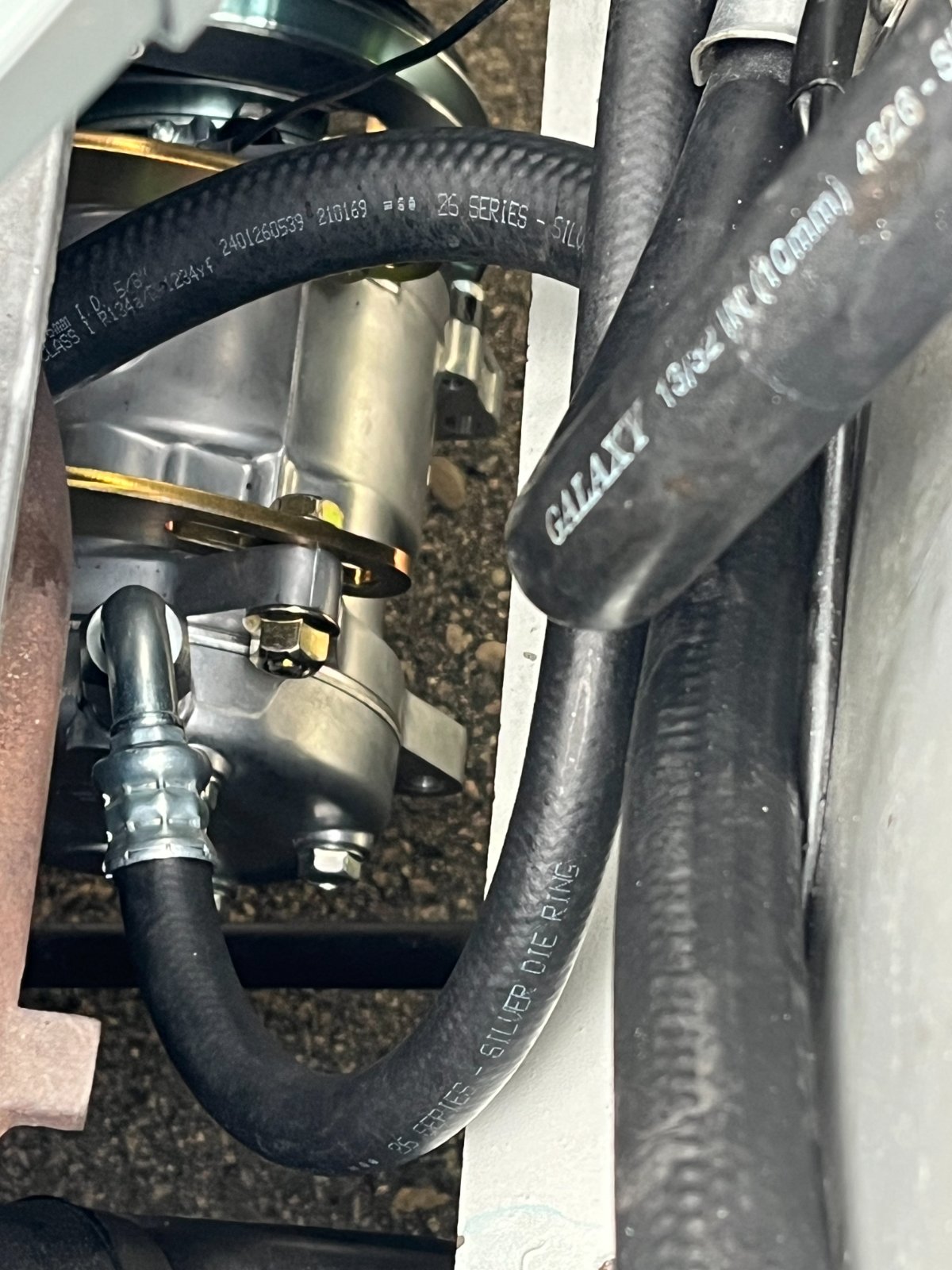

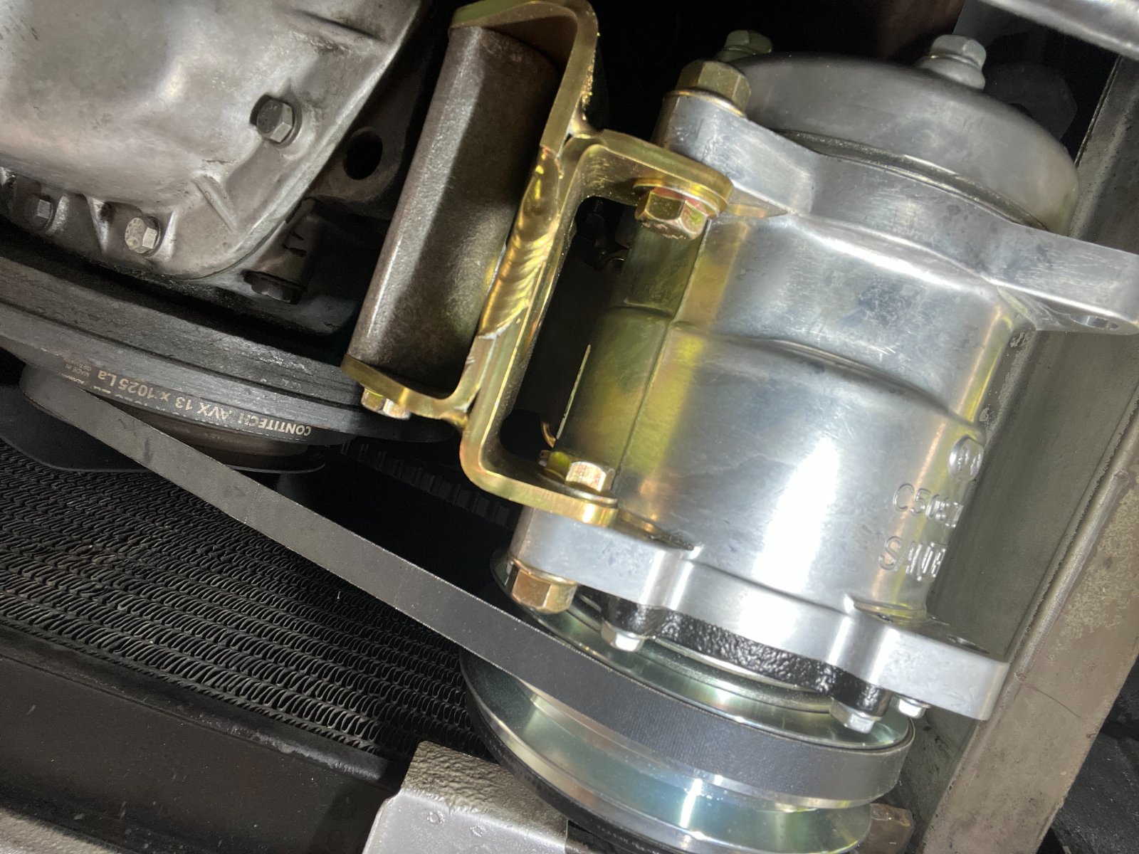

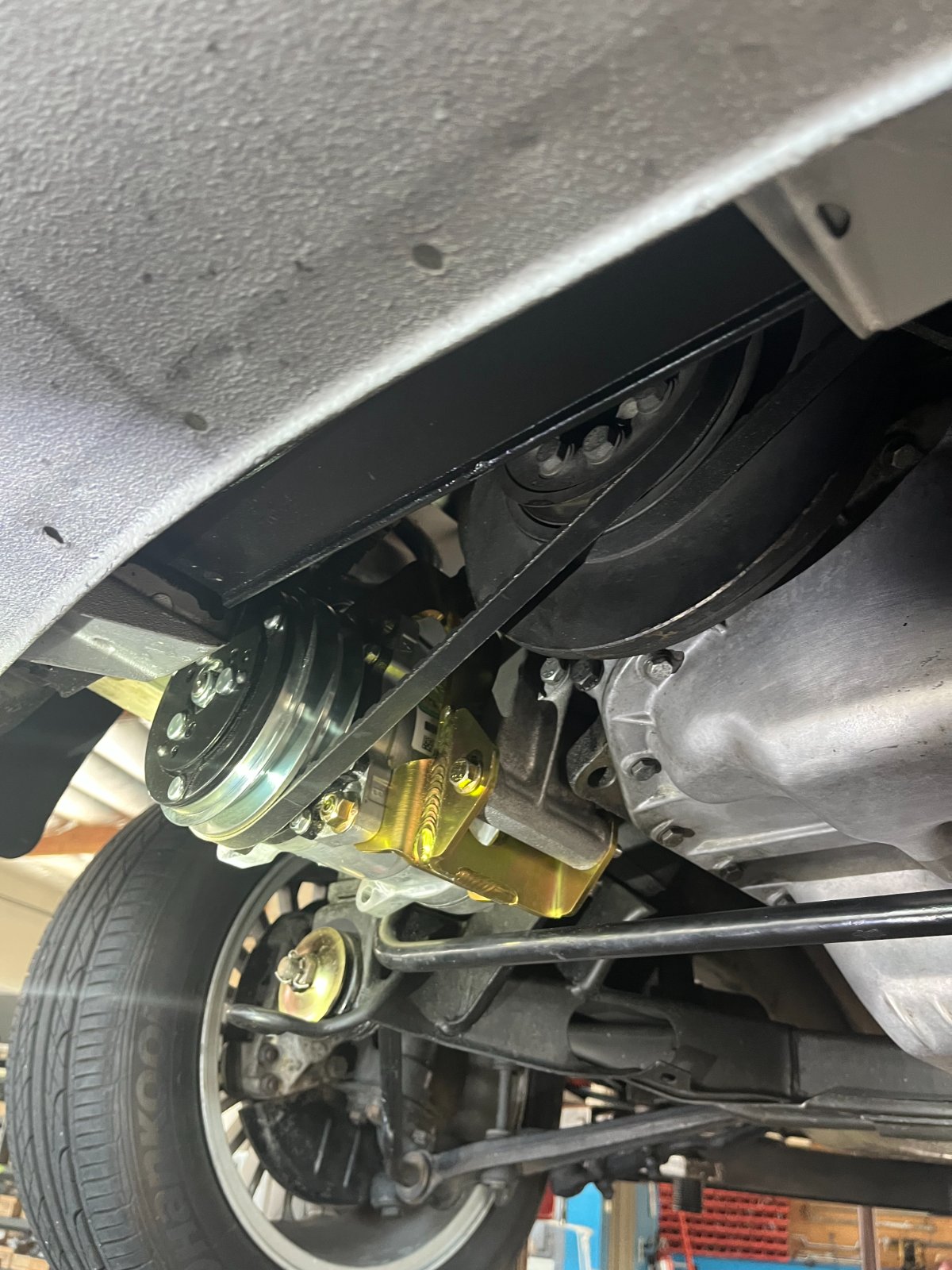

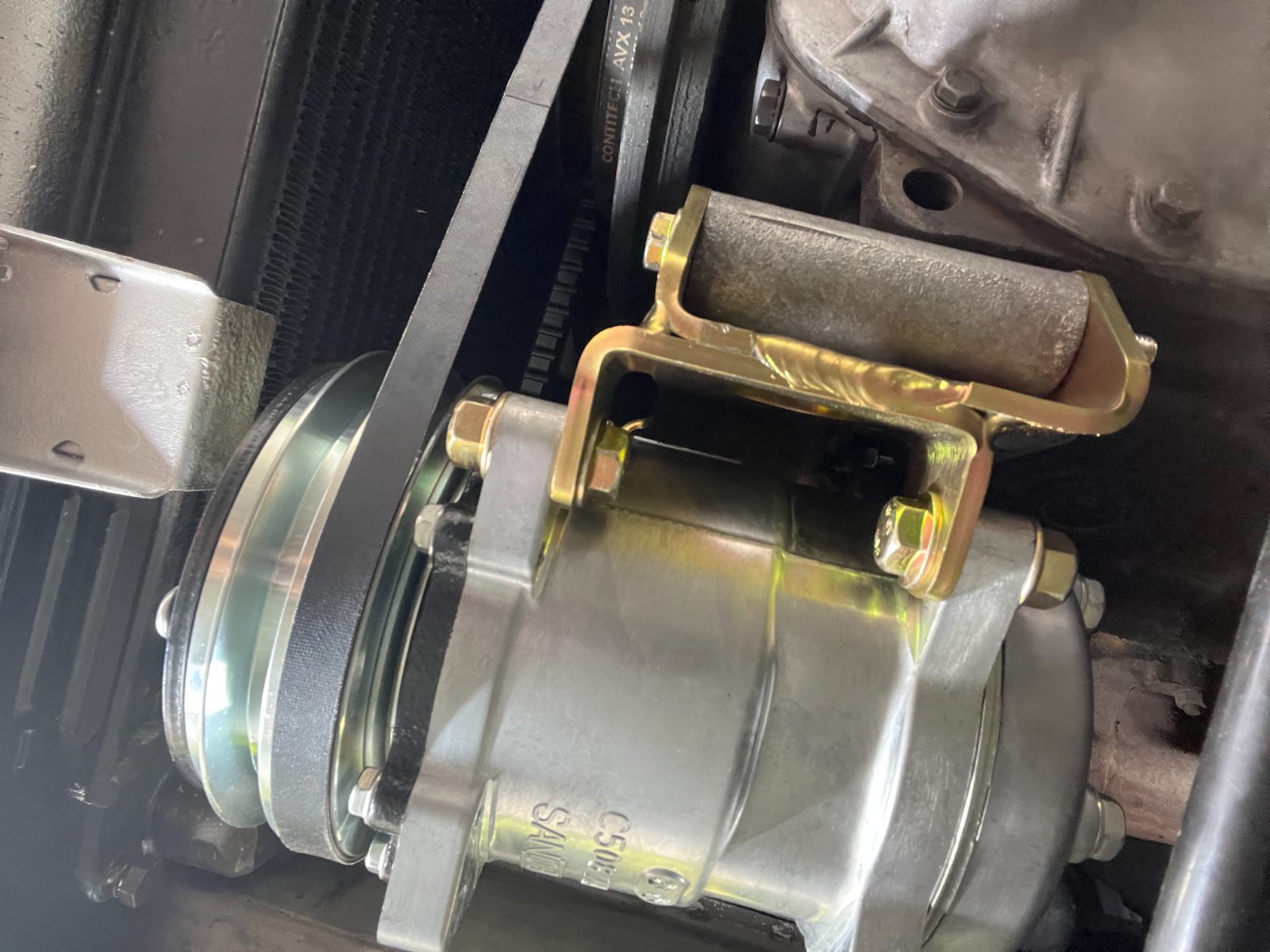

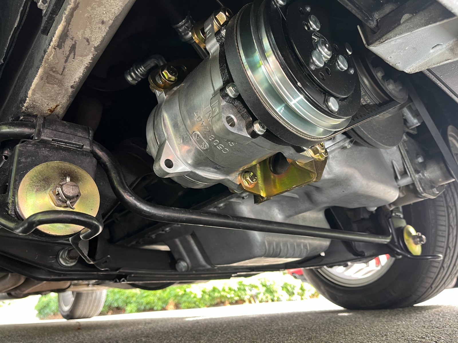

If you’d like to purchase the compressor together with the M20/M30 Sanden compressor bracket, this package is a great option. I really like how the yellow zinc hardware stands out:
AC Solutions BMW Sanden Compressor Kit
Keep in mind you’ll still need the support bracket (part #64521284953), which you can source either new or used. I also had to have custom hoses made—Royal Brass did mine and they turned out great.
