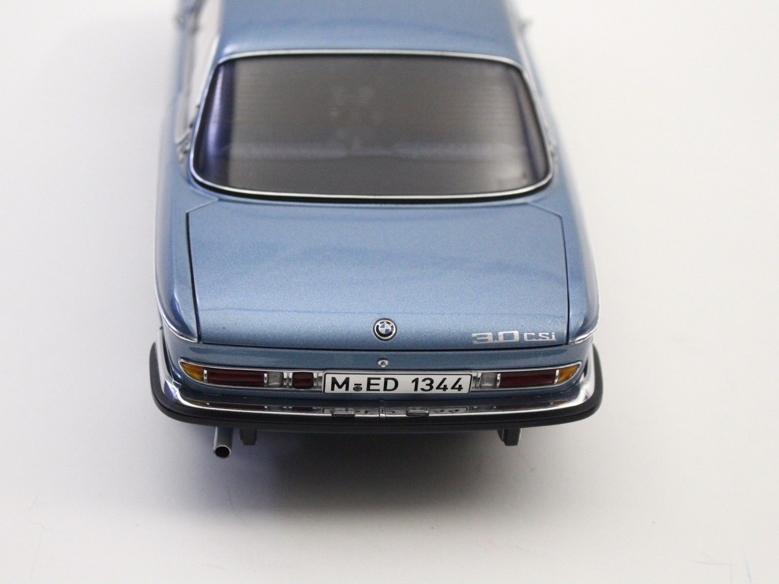

Last Cars and Coffee of the season today in Newington, NH then a short drive over to Stoneface Brewing.
Funny how different Fjord can look on different cars. My 02 definitely had a more lavender hue to it than my coupe.
Your coupe looks more blue than the 02 your parked next to, which looks like it has a little green in it.
Your BMW 'vanity' plate scene is strong in Maine :)
I like it ;)
