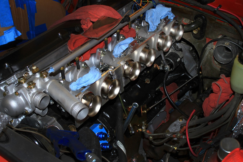

I suspected from the beginning that I would need to make a change to the stock vacuum booster as it (likely) takes up too much room for proper air cleaners on DCOEs or an air box for F.I.. I sourced a tii booster early on, thinking that it would provide the needed space, but I didn't fully enthuse about using it as it was designed for a braking system on a car which weighs +/- 700lbs less than a Bavaria. A reduction in brake boost was not the way to go when increasing torque & horsepower. Shortly after the engine was installed I attended the NSRA National event in Louisville (I also have a traditional hot rod affliction) and white perusing the indoor vendor area (in excess of 900,000 sq. ft.!) I encountered the booth of ABS Power Brake (coincidental name), which manufactures a two-part system: a very compact electrical pressure accumulator (8"x6"x6') which can be mounted remotely, and an equally compact master cylinder (3.25" tall, 3.5" wide, 8.75" long) which mounts in the position of the stock MC. It provides 1600 to 1800 psi of pressure which actually exceeds that of the vacuum system. We were able to mount the accumulator below (required) and essentially out of the engine compartment on the subframe and then shortened the booster tube and actuating rod approximately 4" for additional air box space and a round mounting plate was fabricated for the MC base. It's a very tidy and compact unit and I've been very pleased with it's performance; pedal feel and modulation is excellent and I believe it to be superior to the stock system (given that the swept area is not increased) in hauling the car down. A minor drawback is that one can hear the accumulator run from time to time, but I just consider that it signifies the system is working. Some images of the installation:
This shows the shortened booster mounting tube in the upper right:
And here is the mounting plate:
The only component which enters the engine compartment is the MC, shown here with finned aluminum cover and fill cap (a bit of a fuzzy photo):
I'm very pleased with the decision to go this route. It was a bit pricier than I had estimated (so what's new there?), but it provided the needed space for the air box, allowed no change in the overflow tank mounting and its performance meets or exceeds my expectations.

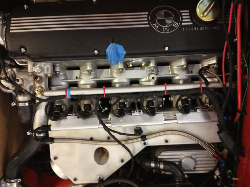

One of the details which I now notice has been omitted is the fuel return system required of a fuel injection system. Running a line from the end of the injector fuel log back to the tank is a fairly straightforward task but the stock fuel pick up insert in the tank does not allow for the return of fuel. One call to Carl Nelson solved that issue quite easily; an e30 fuel pick up fits exactly in the e3 tank. The only difference is that the e30 unit is approximately one inch shorter that that of the original unit. Though it can be used as-is, we lengthened the bottom portion so as not to receive a "too early" indication of low fuel. When the fuel gauge didn't work upon installation I called Carl again and he immediately knew where I had erred: "You've got the lead wires crossed, reverse 'em and it'll work.", and sure enough, instant fix. The guy is an amazing resource. The system uses an 30 fuel pump mounted above the left half shaft along with a high capacity fuel filter.

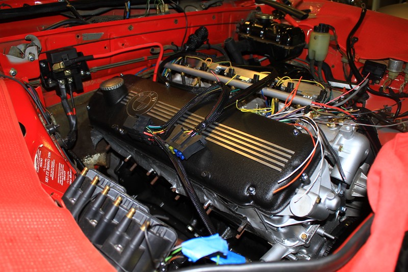

From the image featuring the brake MC (third photo up) taken in early August 2013, to our major goal of startup, we're seeing light through the tunnel; a small amount of wiring, circuit testing, header installation and a fairly extensive check list later we arrive at Aug. 8 (5:36PM Central Standard time to be exact) and this occurs:
HotDamn! ..... only three and a half years (as life's other activities permitted) into the one year project and we have ignition. Next up is time on the dyno, correcting a few small issues and then its break-in trip to Upstate New York with the Vintage BMW Club.

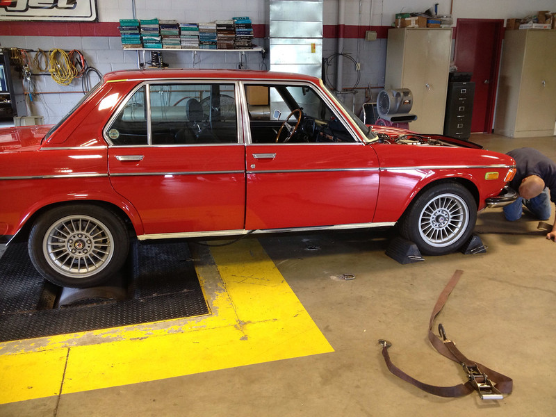

Now that the engine is running, though only at idle, we roll it from the bay where it's been siting for nine months to the dyno. Scott's very able tech, Tim, who has co-designed and fabricated much of the install, now lends his (considerable) tuning expertise. Our goal is to baseline the parameters and then I'll tow the car to Henry the engine builder's shop for the final dyno tune followed by some real world/on the road micro adjustments.
Tim straps it down for the initial dyno tune.
Tim spent a couple of days getting it to run fairly well before we re-install the hood and I load it up to head south where Henry performed the fine tune. While there we also install an idle air valve and program its operation into the ECU. Since I'm not using a fan on the engine, we program the start-up temp on the auxiliary electric pusher fan which is also triggered through the ECU; this is a smart little box! After three days in N.C. Henry waves his goodbye and off I go with my new old car. Given that there is some great two-lane blacktop between Henry's and the Interstate, I'd love to be behind the wheel of the Bavaria but as dictated by its need to be towed south, I have to make do with Dodge diesel and trailer. Tomorrow I can play.

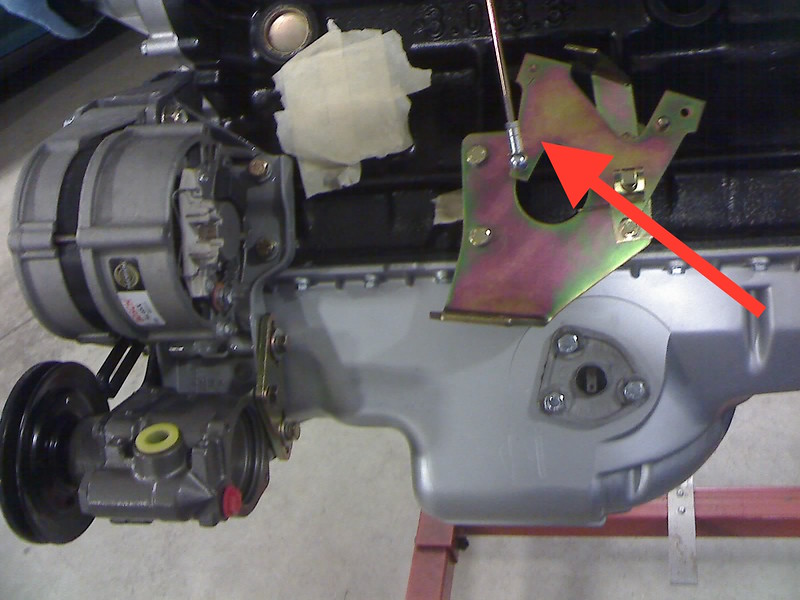

I had a phone conversation about the throttle issue with Ben T., as I pass by his Chicago shop often, and then took the car there a few days later. What we learned on close inspection was that two issues were present: 1. The movement of the throttle was too rapid for the throttle bodies and 2. The butterflies were wide open at only 80% of the accelerator travel. In order to shorten and slow the travel, Ben moved the upper throttle rod ball both upward, which reduced the maximum travel, and inward toward the fulcrum to slow the opening rate. the first try was a SWAG, but it worked beautifully for both issues. I can now accelerate out of a 90 degree corner after a downshift without jarring the driveline so I can actually relax while breaking it in.
This is an approximation of the change. The horizontal rod from the pedal remain the same.

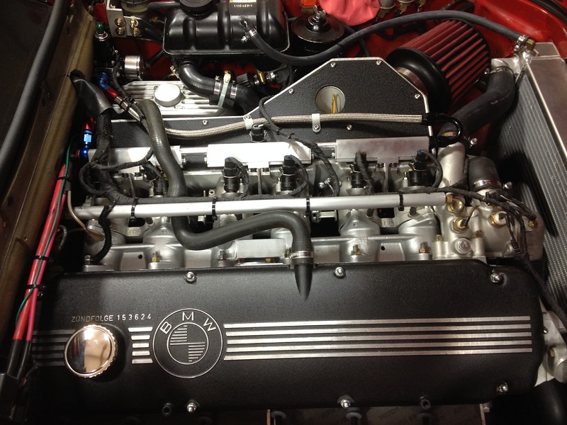

So this will be the wrap-up (I hear sighs of relief) of my project recap. It began as a straight forward M30 engine rebuild and as often happens, morphed into far more than I had envisioned. As stated very early on and after dropping the engine out the bottom with its subframe, it made no sense to make a pretty engine and then bolt it back into that grungy subframe. And if doing the front one,...well, you get the idea. It was probably at that moment I realized this might take a bit longer than I had planned for but hey,...I'm retired and this is fun! In 46 years of BMW ownership I have seen and admired quite a number of what I considered to be well done performance enhanced street cars and here was my opportunity to (attempt to) do that for myself. I learned a fair amount by doing (or) observing, met some neat and very knowledgable people along the way and am enjoying the end product. My wife asked when it will be finished and my reply was "I hope never" which I guess describes my (likely yours as well) car affliction: I can't resist the CSI (constant state of improvement) mindset and I enjoy the process of finding a solution. Since the engine project was completed I've changed front seats, added gauges to the console, modified the stock exhaust, re-routed wires, etc, all in the spirit of CSI and which can be covered in future postings to this forum. I'll attempt to do so in one sit down as opposed to this admittedly way too drawn out epistle.
The (mostly) finished engine compartment.
I've since changed the circuitous breather tube to a positive catch system, re-routed the ignition wires through an E28 M5 loom, wrapped the red battery wires and shortened the overflow hose. Never done.
