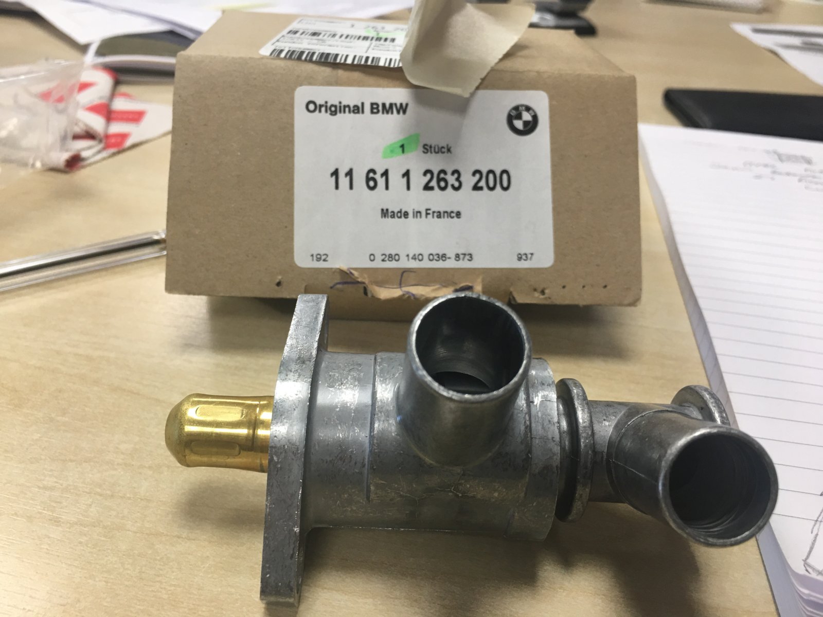

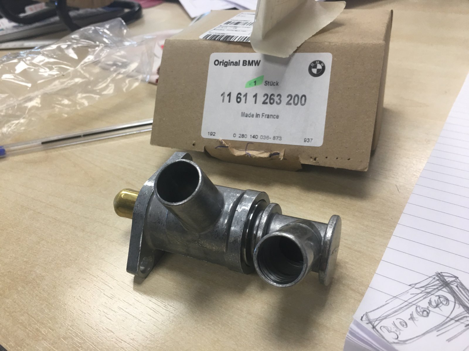

Dear All
I have been on the BMW classic web site and found the part, and purchased it - i have tried the BMW dealerships but they say its NLA..
i think bmw parts are all a mess and no one knows what they have....
Anyhow - got the part today and is the same as mu old unit
The part number is 11 61 1 263 200
And here are the pictures.....

Dear All
View attachment 77862View attachment 77861
