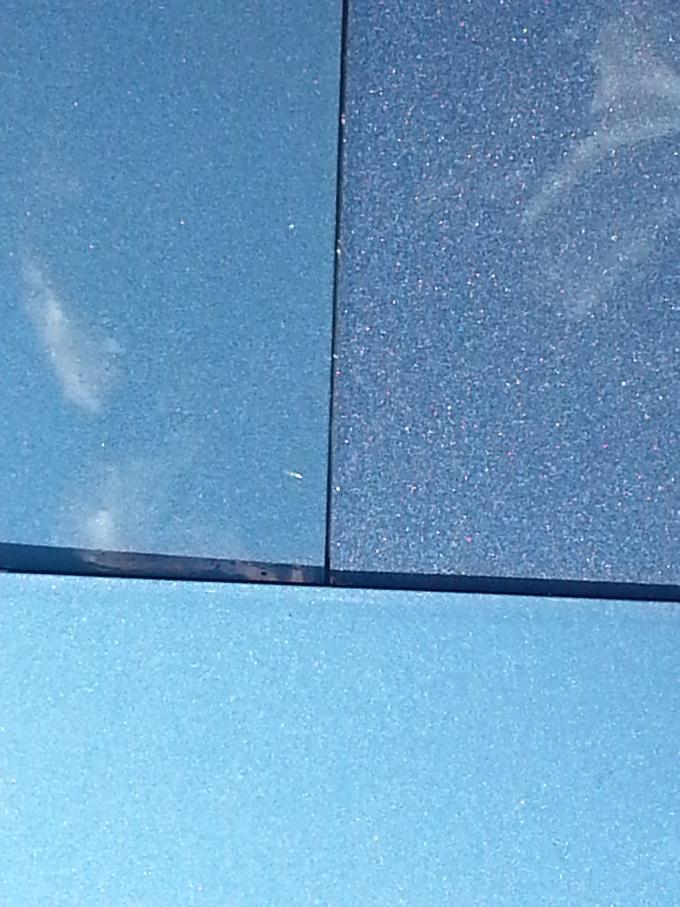

And here is a couple of pics of the three samples I got... I understand light, angle, camera, monitor will play tricks and you will not be able to see it the way I see it:
On the first two pics with direct sun light:
The RM sample is the one at the bottom, nice clean blue, but a little light. Very fine metallic particle.
The Standox newer formula, upper left, has a bit more grayish or even Golden tint, so the blue is not so bright, I coudl say it looks like dirty. It has very fine metallic particle.
The Standox older formula, upper right, shows more blueish and slightly purplish tint. It is really nice, and resembles what I remember... my only question is the metallic particles, as they are noticeable.
On the last pic, inside the shop, on shadow:
The RM is on the left, Standox new in the center, and Standox old at right.
That is how different the cameras capture them.
Anyhow, I guess my final question would be about metallic particle size. Was the original Baikal blue a color in which you could actually see the metallic particle (medium silver) or is it supposed to be a real flat and smooth metallic (very fine silver), the type of which you know they are metallic but cannot see the particles unless you really get way close?

The metal flake is measured in Microns, can they tell you what size it is? Back in 60/70s it was 1 Micron or thereabouts, US manufacturers used 5 Microns, quite a difference! I think here smallest is best.
Third Picture in your left hand looks very nice in contrast-just my opinion through my screen but reminds me of the old BMW's from the 70's most.

You can see the metallic in the paint, very fine metallic, the early one listed is correct, the dirty or grey one is NOT, FROM WHAT I KNOW, THE RM sample is correct, my 72 tii was this color and also one of my favorite colors.....we had an NOS panel to match from, the earlier formula was made from late 60's to 1970 something.....
