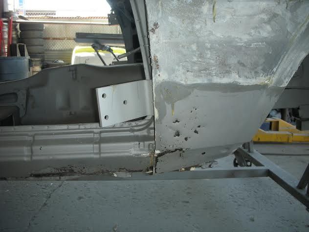

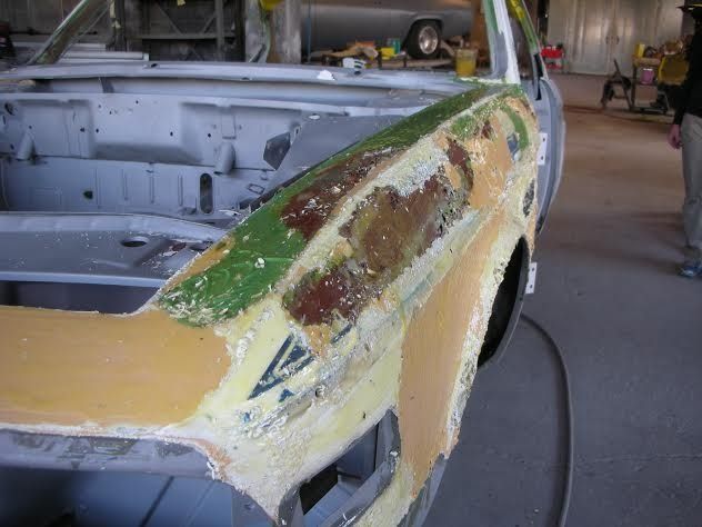

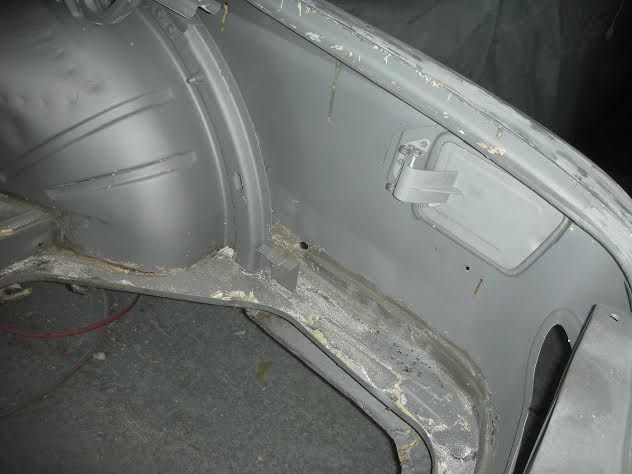

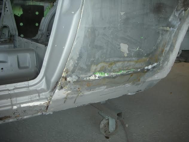

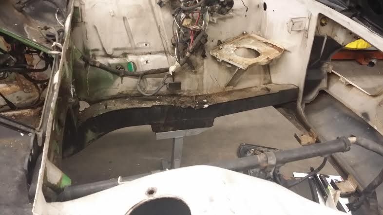

Peter, you are NOT kidding! Here is how you can easily be fooled by a "made over" coupe as opposed to a restored coupe. Here are a few photos of how the car looked when I bought it. Looks like a pretty nice example!
http://smg.photobucket.com/user/ronperry/library/CSL2275483?sort=3&page=1
Yes, it is a blue stripe but not correct in any way.

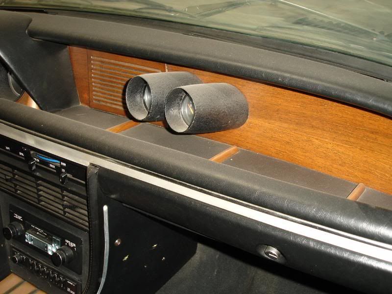

aux gauge pod
Hi Ron,
Thx for sharing pics, I came across the dash's aux gauge pod and am curious if you know anything about them. I believe they are a euro aftermarket accessory, mine originally held period VDO metric oil pressure and amps guages in the same location.
I stripped its black paint to find a darn close matching wood then relocated and re-purposed it ;-) It now houses (covertly) Autometer shift and red failure lites.
Curious if other coupers have encountered this gauge pod in their ramblings.

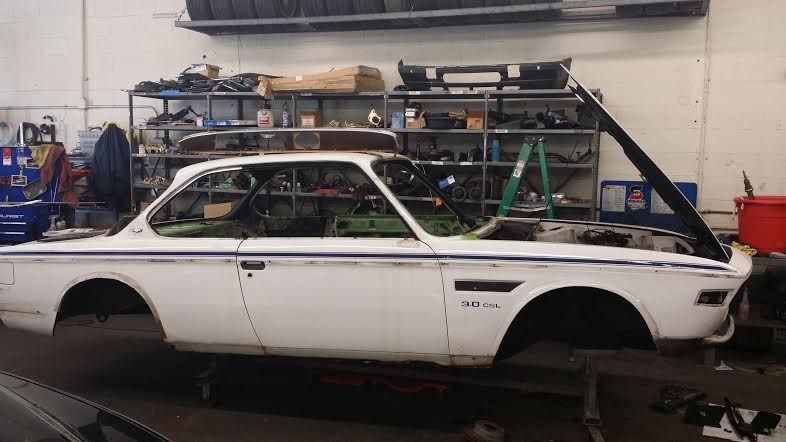

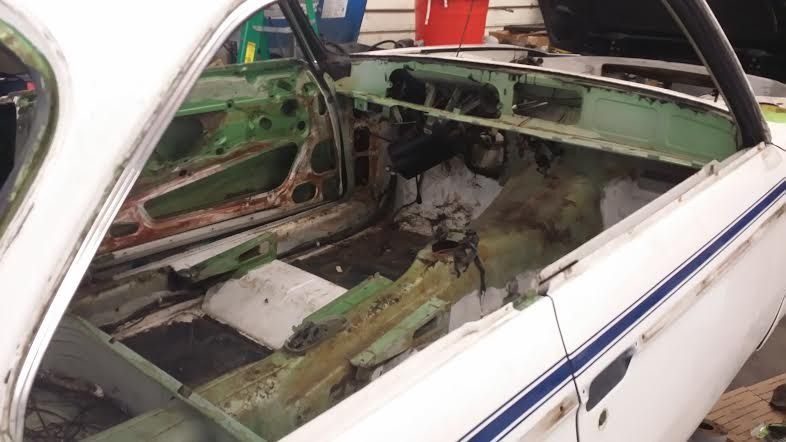

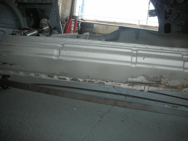

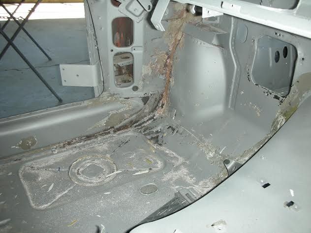

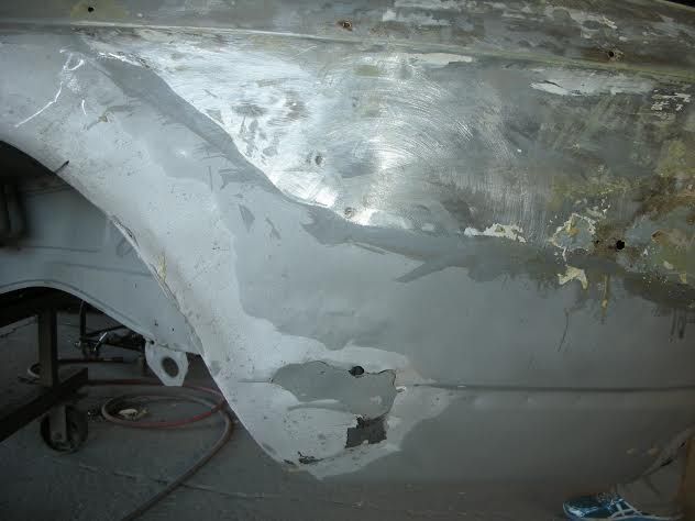

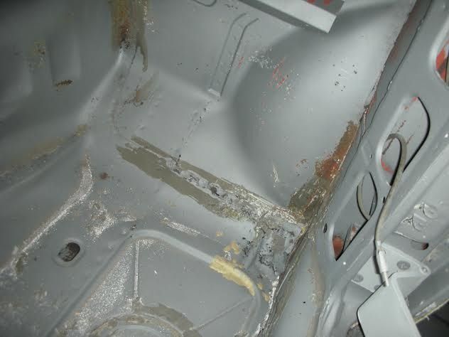

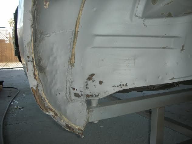

Time for an update! Car is stripped down and found very little "visible" rust. I expected some around the the window rubber, but it was all very dry. Still concerned about the strut towers and the leading and trailing edge of the wheel arches. Elvis is ready for the paint shop. Got a quote for $30k...ouch!! Going with it anyway as I know the end result from previous work.
Photos:

Does $30k include all the stripping and necessary metal work? Any additional rust preventative measure included? That and all the paint prep, spray, wet sand and final details sounds like $30k to me based on what I've seen in Canada.

Yes, it includes everything you mentioned.

Truly- thanks! That picture and that $ figure answers a lot of questions that have plagued many on the site!
you have to wonder what the premium is because its a BAT, and everything has to be done just right because everybody paying the kind of money necessary for that car ... expects it to be done right with no shortcuts. also, the metal is thinner on the roof and in other places, and you have to use less invasive (read slower) techniques to get it ready.
