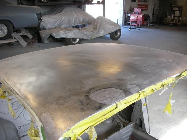

Ron, very smart to do the doors, trunk, hood with stripper. They can be done by a good blaster but I ended up with some fairly warped metal and needed more filler than I would have liked to get the surfaces flat on my blue coupe. The inside of those pieces can be allot tougher than the outside flat areas so you may want to consider some kind of combination if the stripping gets too messy. Just a thought. Also, from what I can see there is some pretty bad rot in some places but those areas are fairly standard so the pieces should be available and the areas where previous work was done may need to be re-addressed since it looks like you are going full bore on this thing. Good luck and keep on posting those pics, they are really helpful.
Thanks-
Peter, the panels Ron chose to strip are aluminum on this car so all the more susceptible to warping.
-Richard

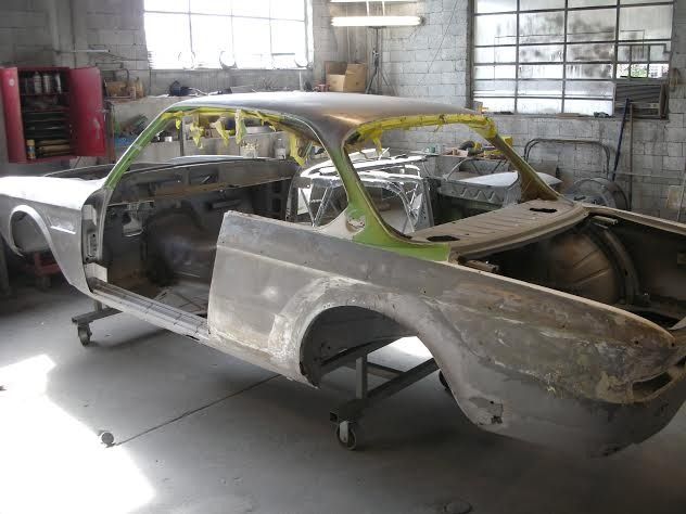

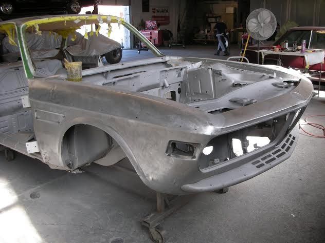

Happy Friday everyone! Thank you all for the positive sentiment. Well, as Tod pointed out, this is a pivotal time in the restoration process. As you will see, there is rust in some of the usual spots, but not in others? Strange, but true. I had anticipated the rockers needing to be replaced, so NOS units were sent with the car. As you can see, the RF lower fender is toast. Luckily I had ordered (VOR) 2 NOS front fenders for the CSL Group 2 Race Car that we will be restoring next-I will start another thread on that one. The fenders are on the way from Der Fatherland and I will order yet another replacement for the race car. The two rear fenders will also need some work as someone did a hammer and dolly job on the wheel wells, most likely for some wombat wheels for the "Miami Vice" look back in the 80s. What sucks is the RR fender is still available, but the left is NLA. Oh, the wonders. We will cut up another car for the sacrificial lamb.

can you elaborate? Does the soda blasting cause warping?
i would be very afraid of blasting a CSL as some of the surfaces are thinner than they are on a standard coupe ... or at least that's my understanding ... especially the roof.
I had my coupe blasted prior to paint. There are pros and cons to the process. One of the cons is that the media goes EVERYWHERE and gets in to every nook and cranny. Hours need to be spent vacuuming and dusting out all of the media. The last thing you want is to have the painter stir up some of the hidden media only to have it land on your nice sticky paint.
Another con is that media blasting uses a lot of force and can stress the surface of the metal. In the case of my coupe this caused the trunk, hood, and roof to loose the shape/memory. We had to heat and cool the metal until the hood, trunk, and roof tightened back up and took shape again. it added to the already long list of work that needed to be done and took hours to do properly.
The pros are that you end up with a clean ready to treat/prime surface that is void if rust. This surface needs to be prepped right away before rust starts to develop as the metal is now virgin and vulnerable.
Another pro, and this is also very important, is that media blasting doesn't require the use of a chemical stripping agent. Chemical stripping is a very good approach but, and this is a big but, you need to be absolutely sure that all the chemical stripper has been removed and neutralized so that you don't have a reaction to the primer or any other chemical used to prep the car for paint. I have seen some paint jobs that ended up with defects from residual stripping agents left on the surface prior to prep and priming.
