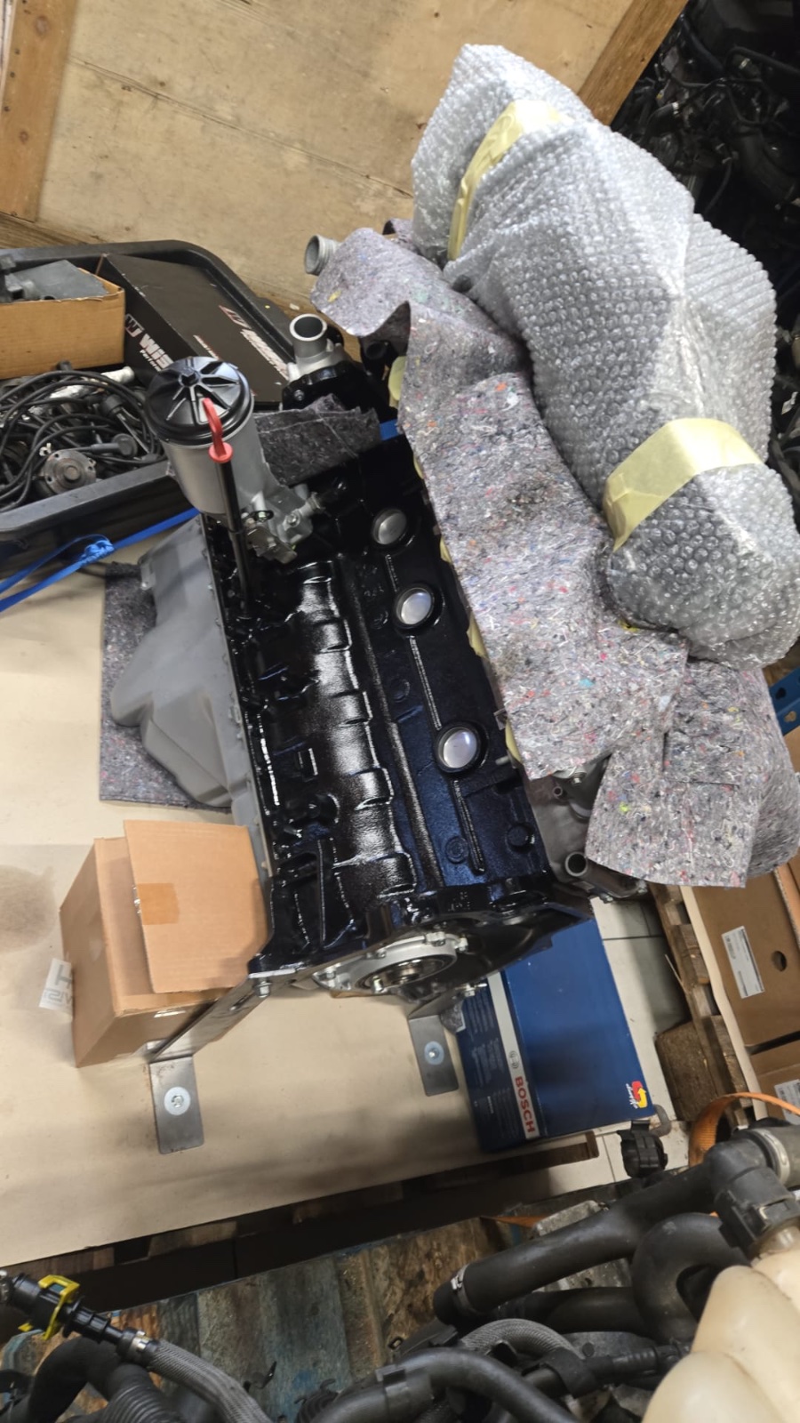

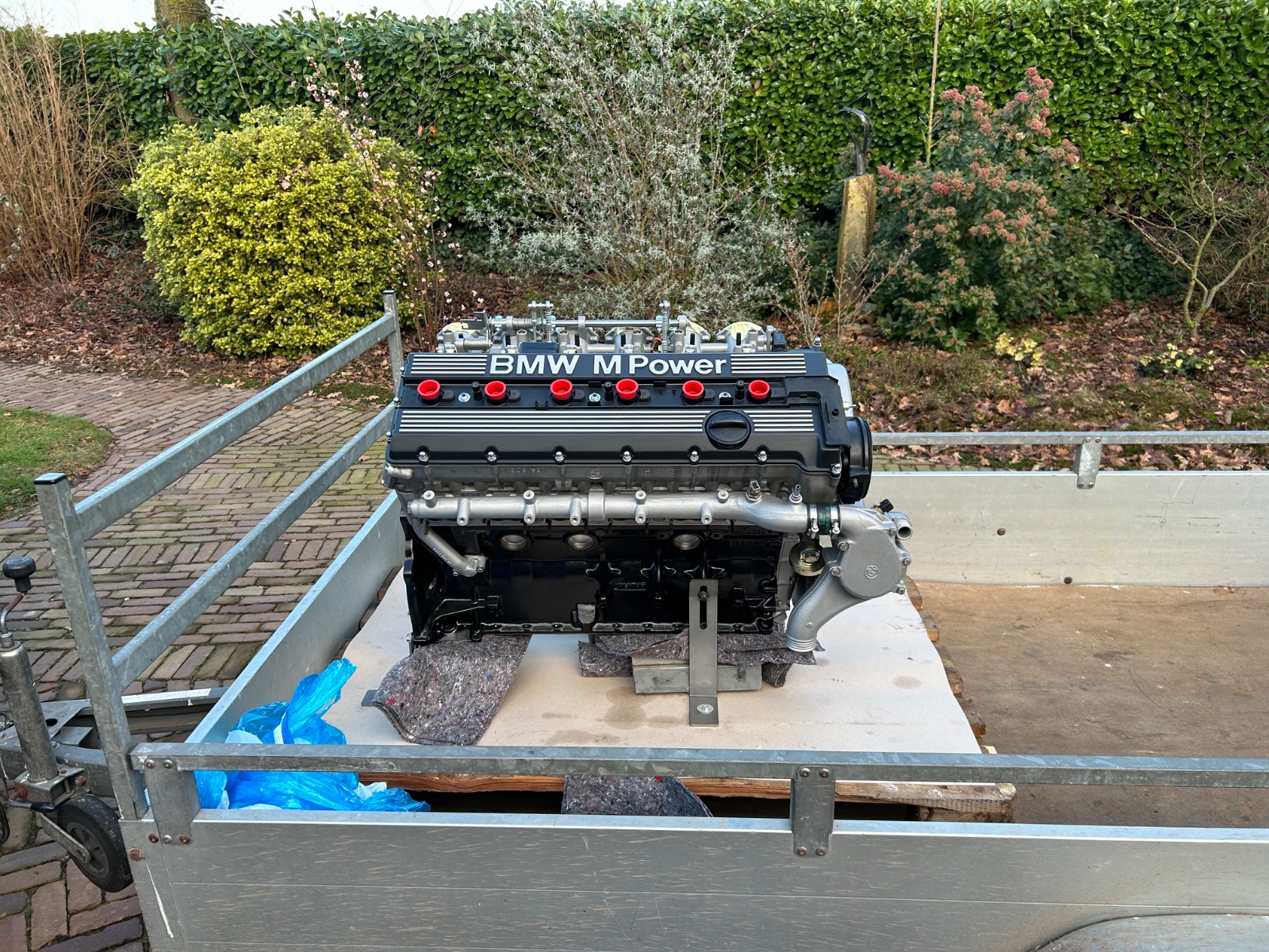

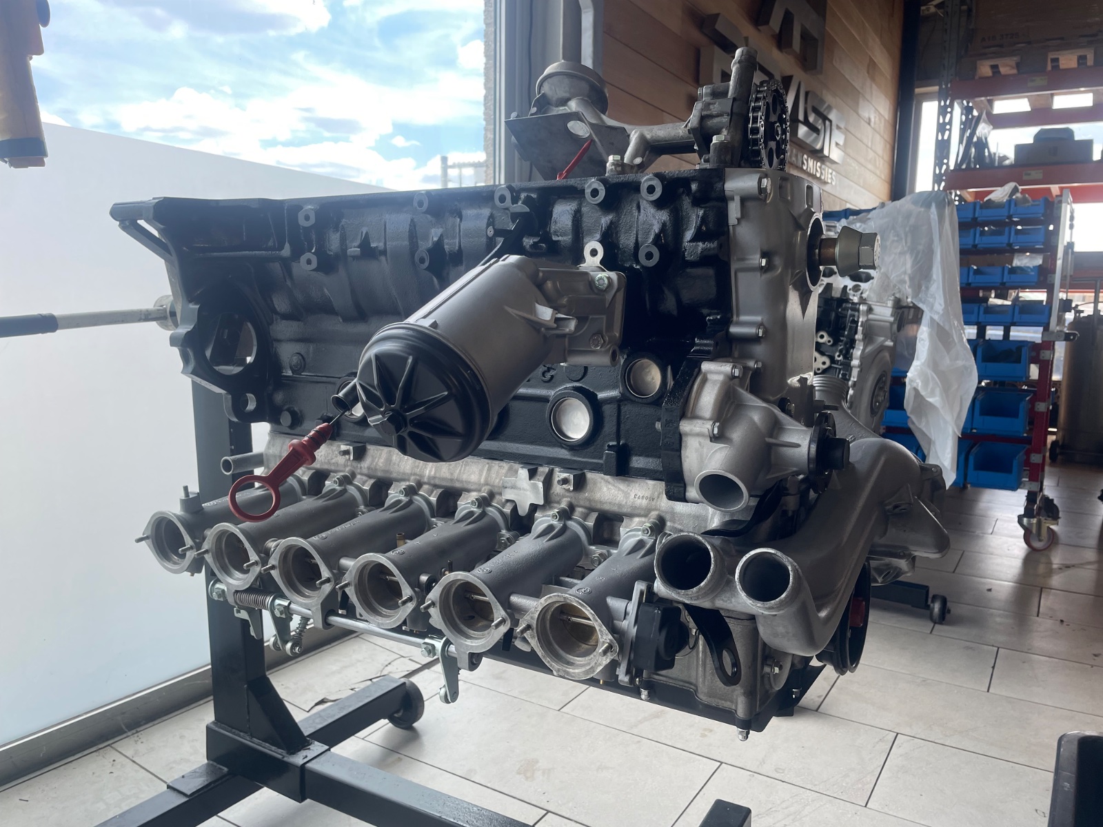

I have my engine finally back, it is really an amazing engine to watch given its potential and how ‘fresh’ it now looks like!

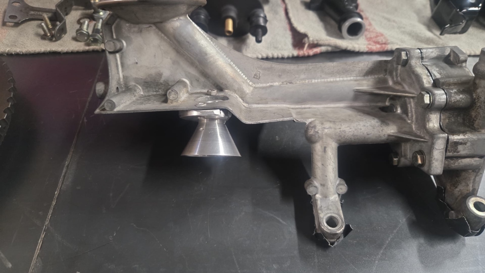

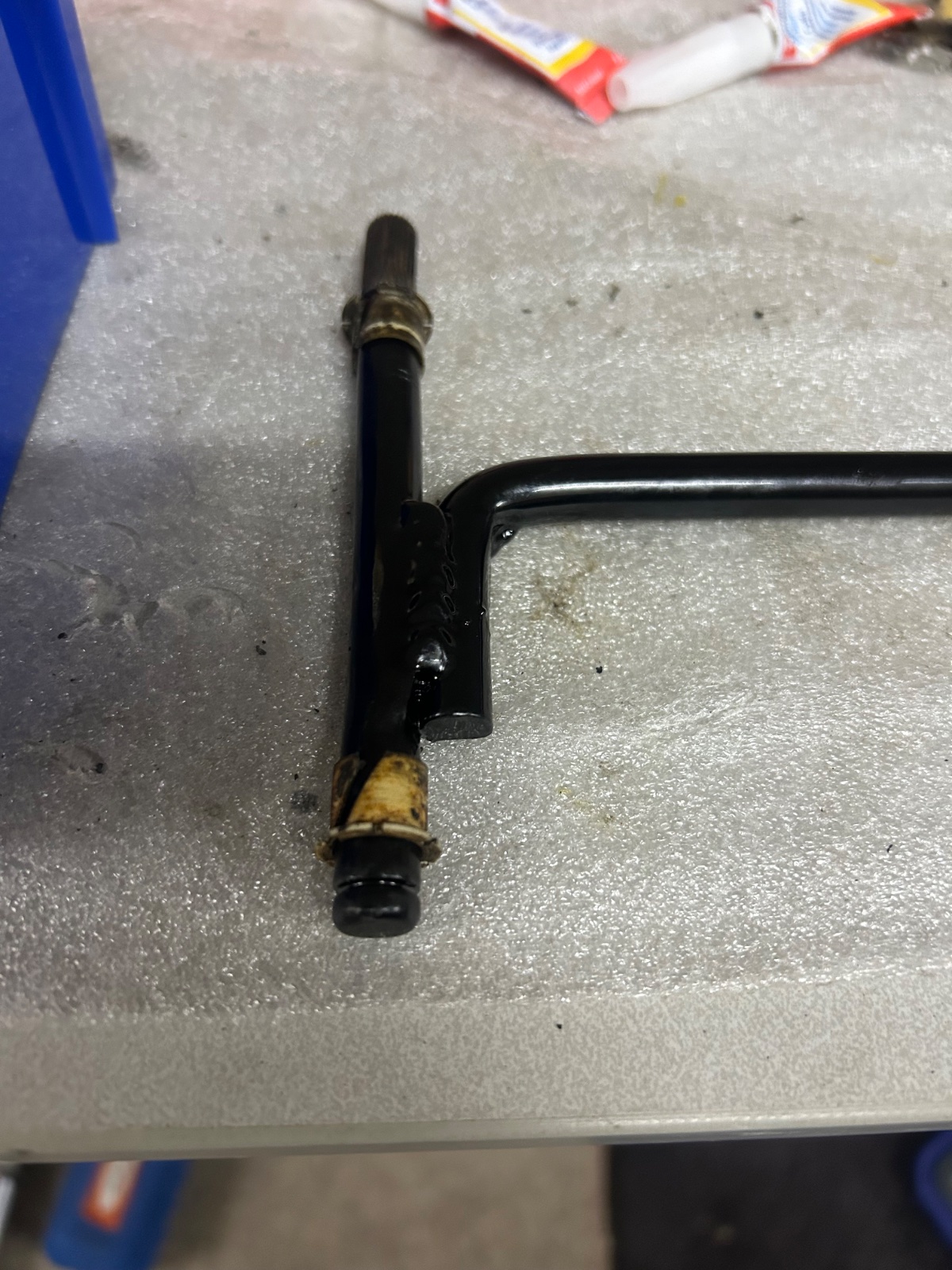

Took a bit longer due to issues with the oil pump. Needed to source several and the oil stick didnt go through the hole because I use a e24 style oil pan. And because the rubber stick guide is not available anymore we made something ourselves.

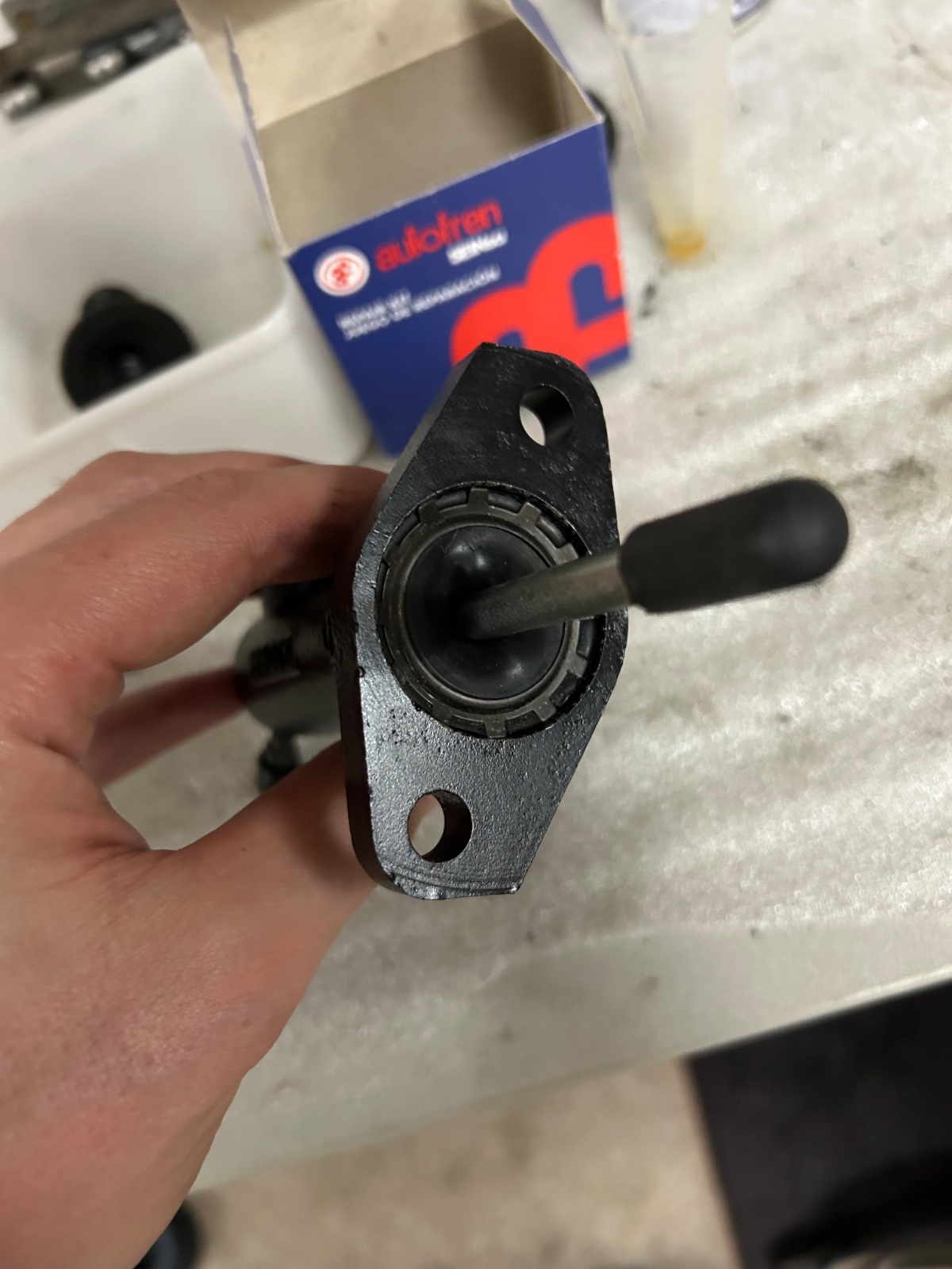

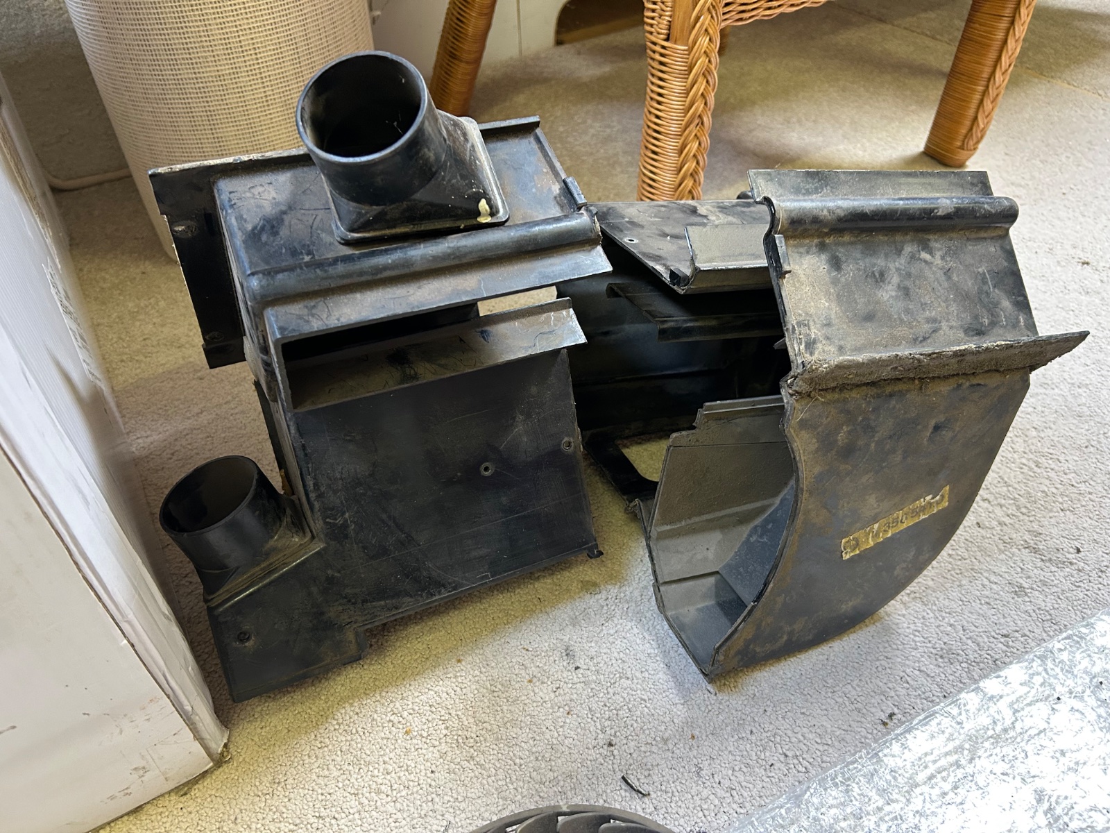

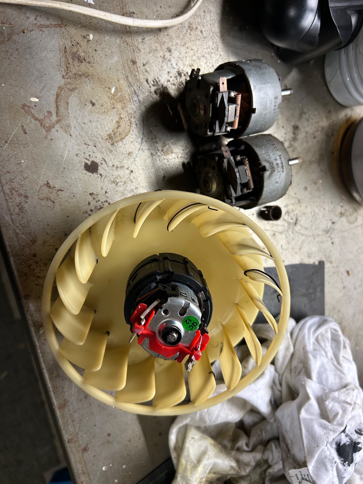

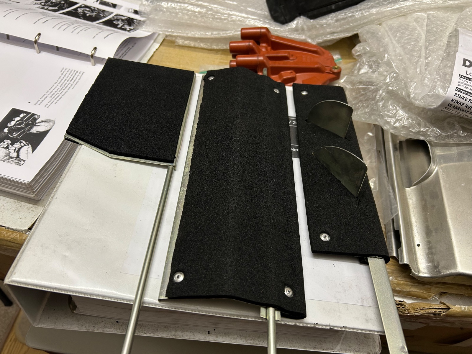

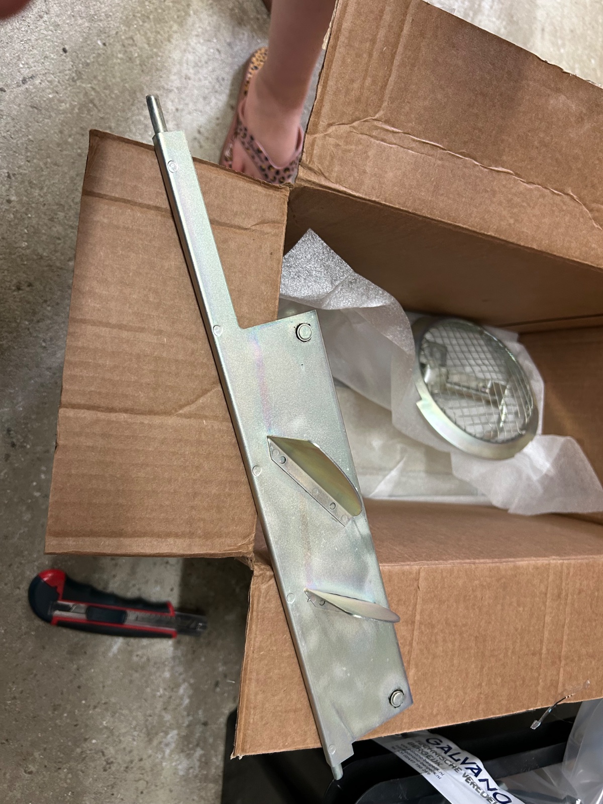

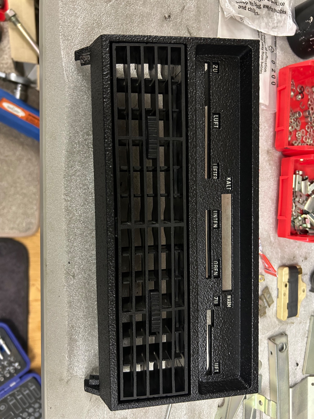

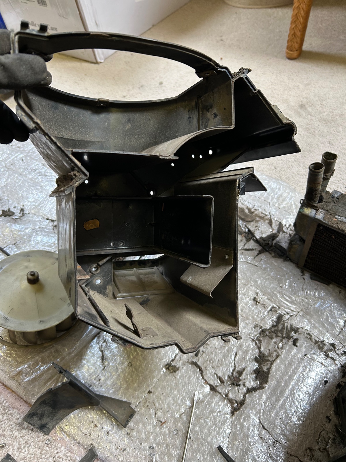

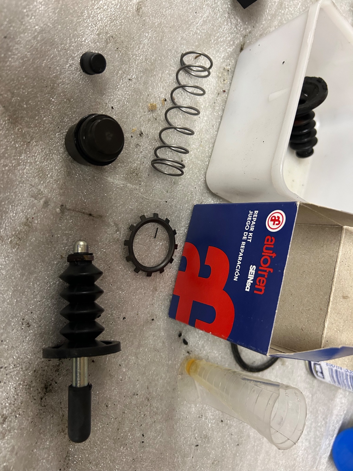

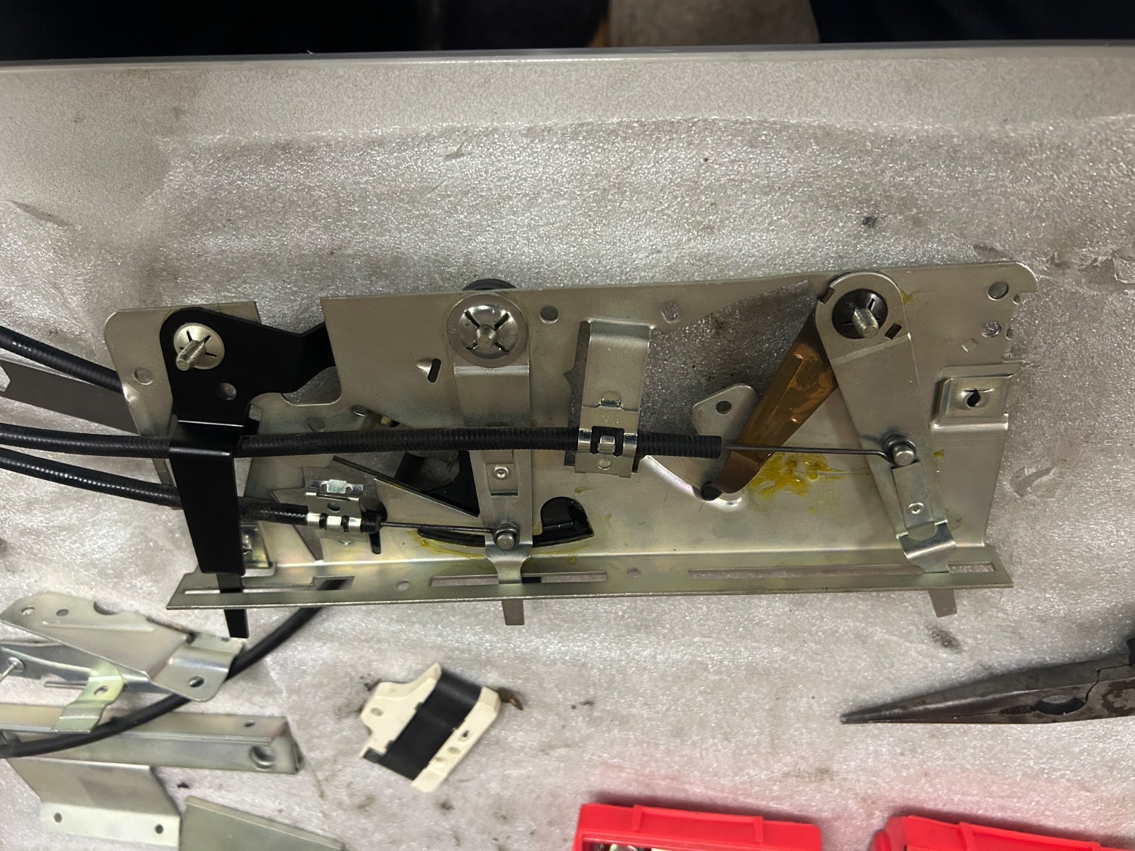

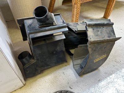

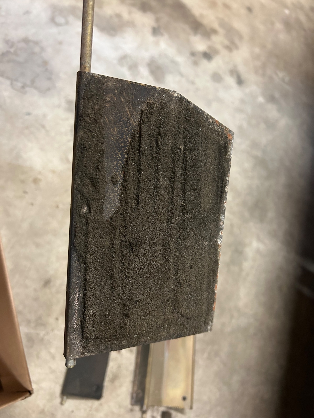

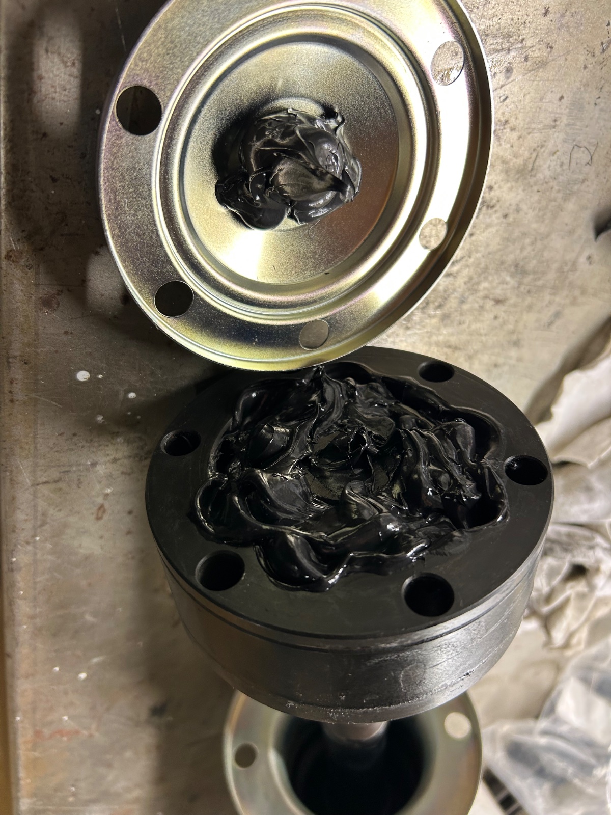

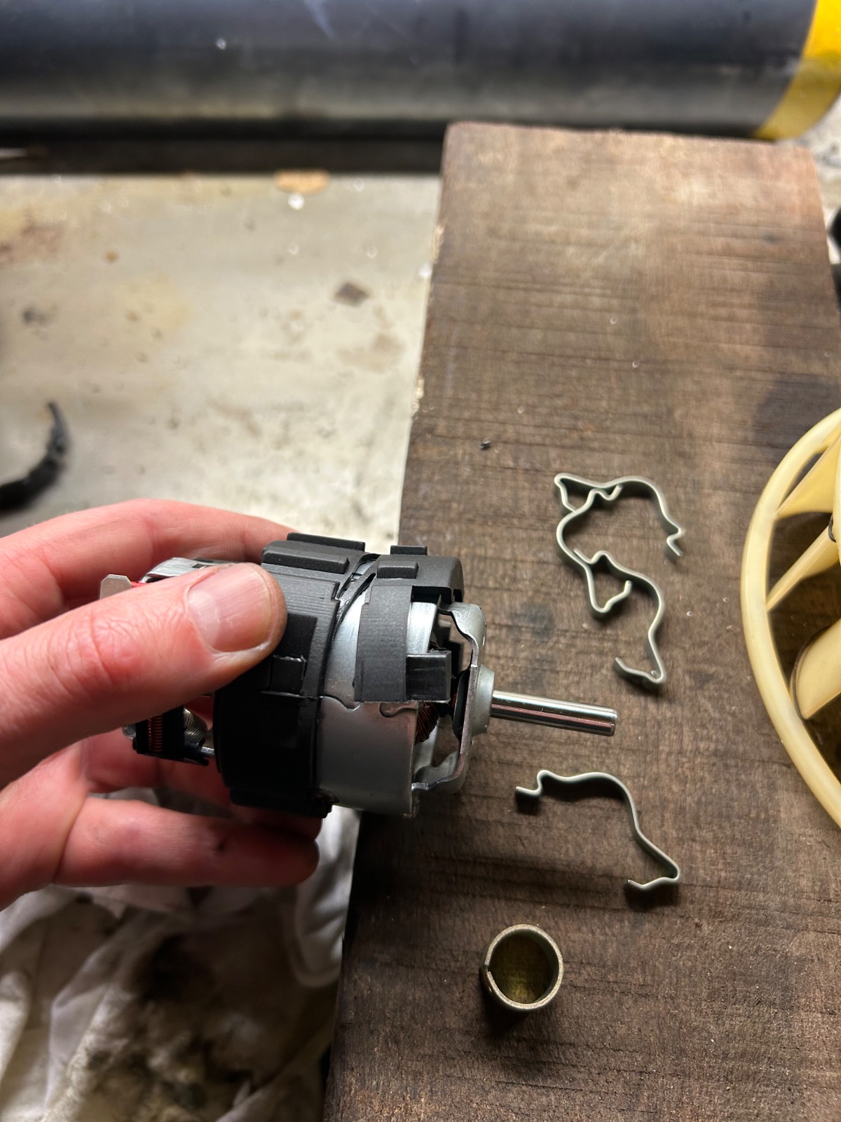

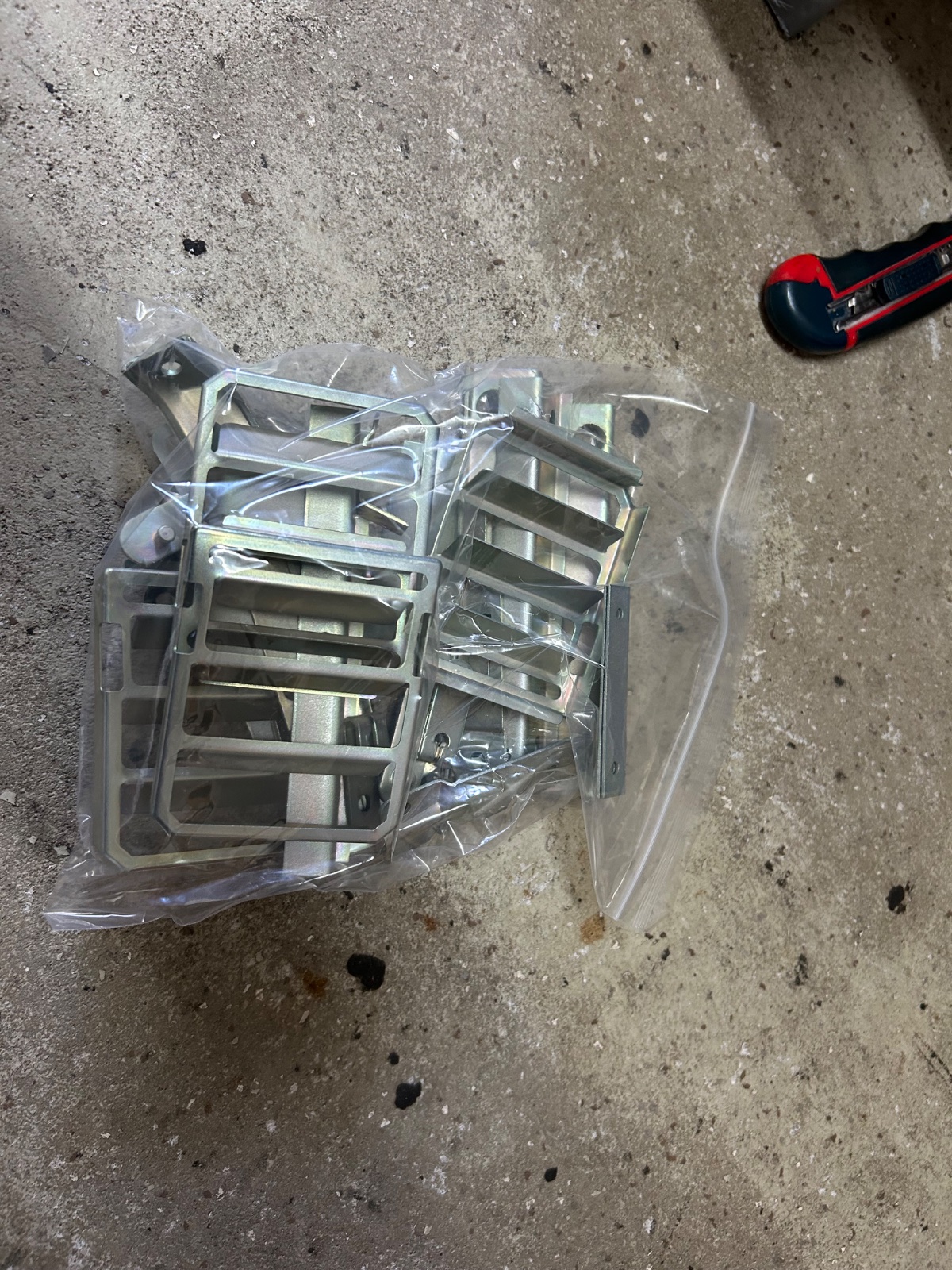

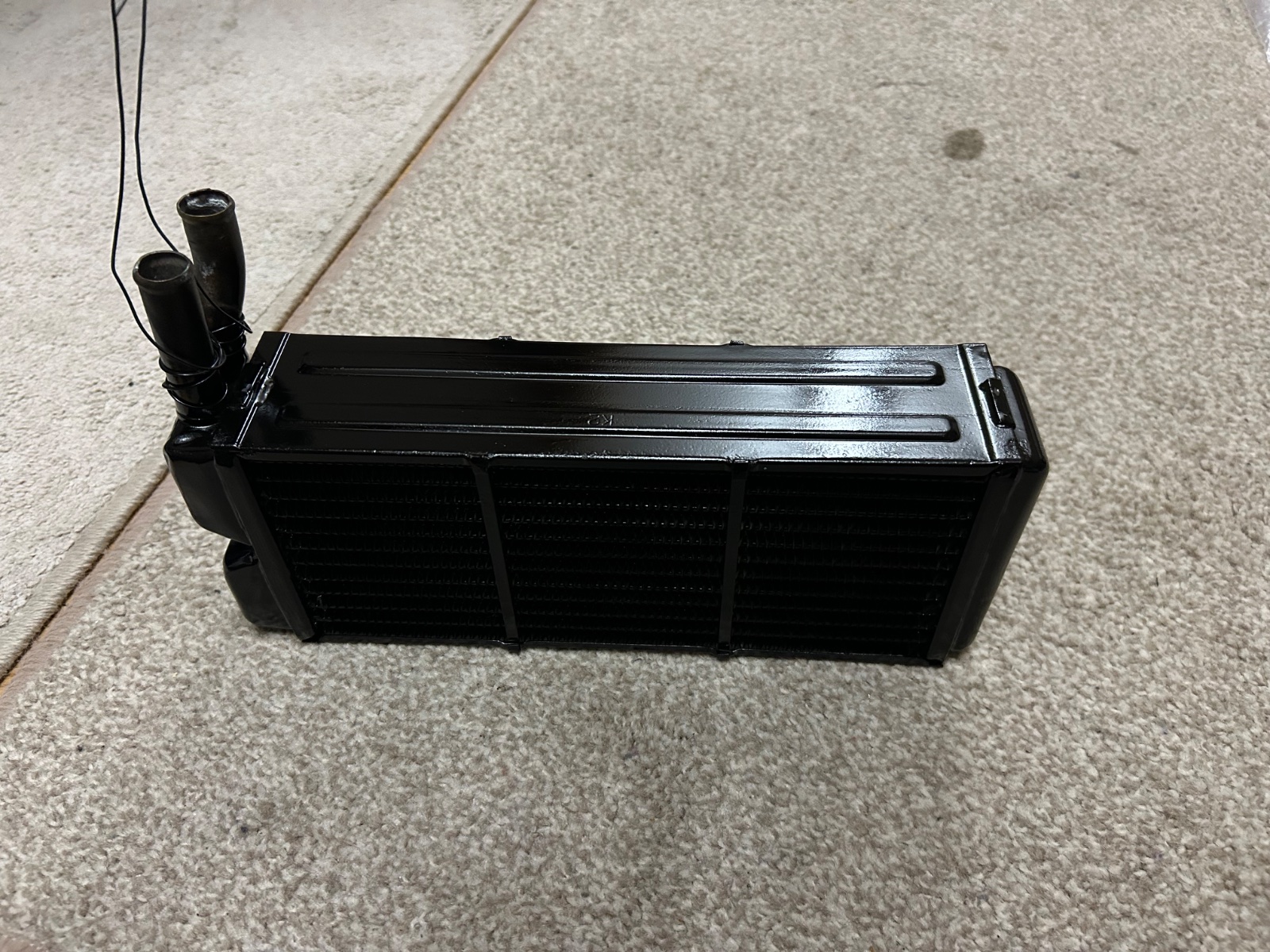

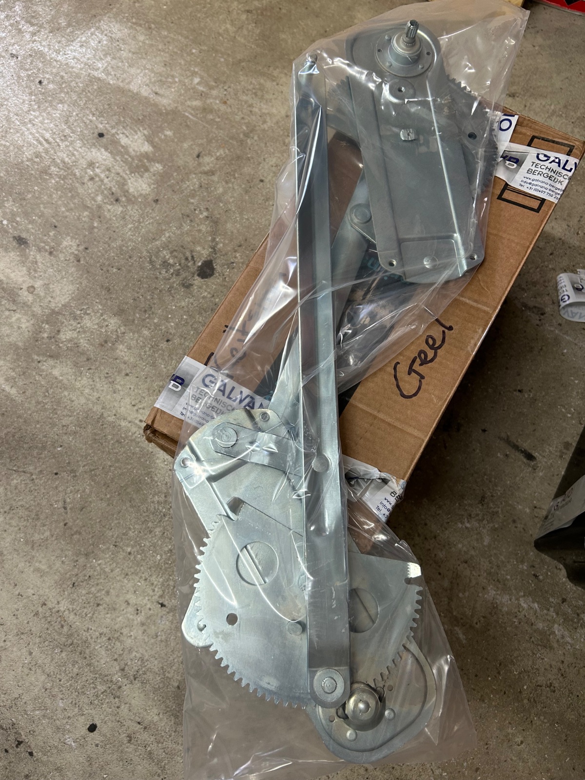

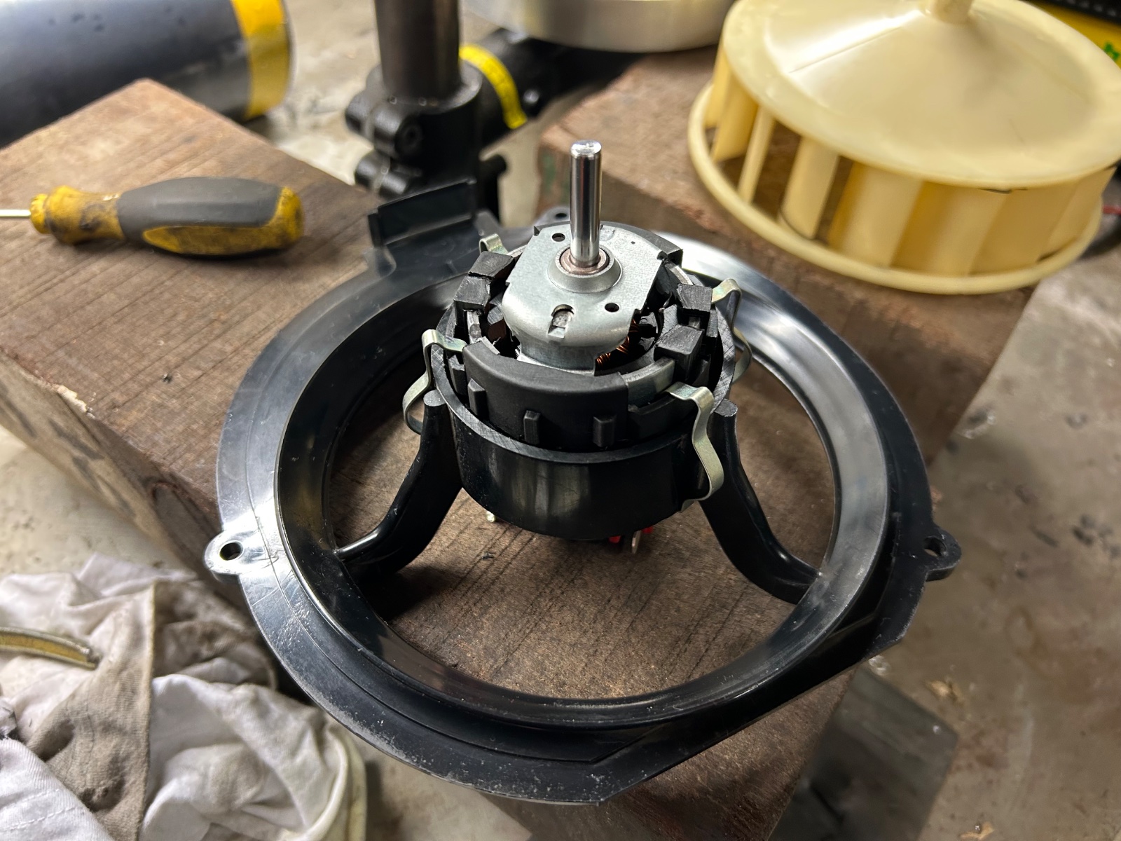

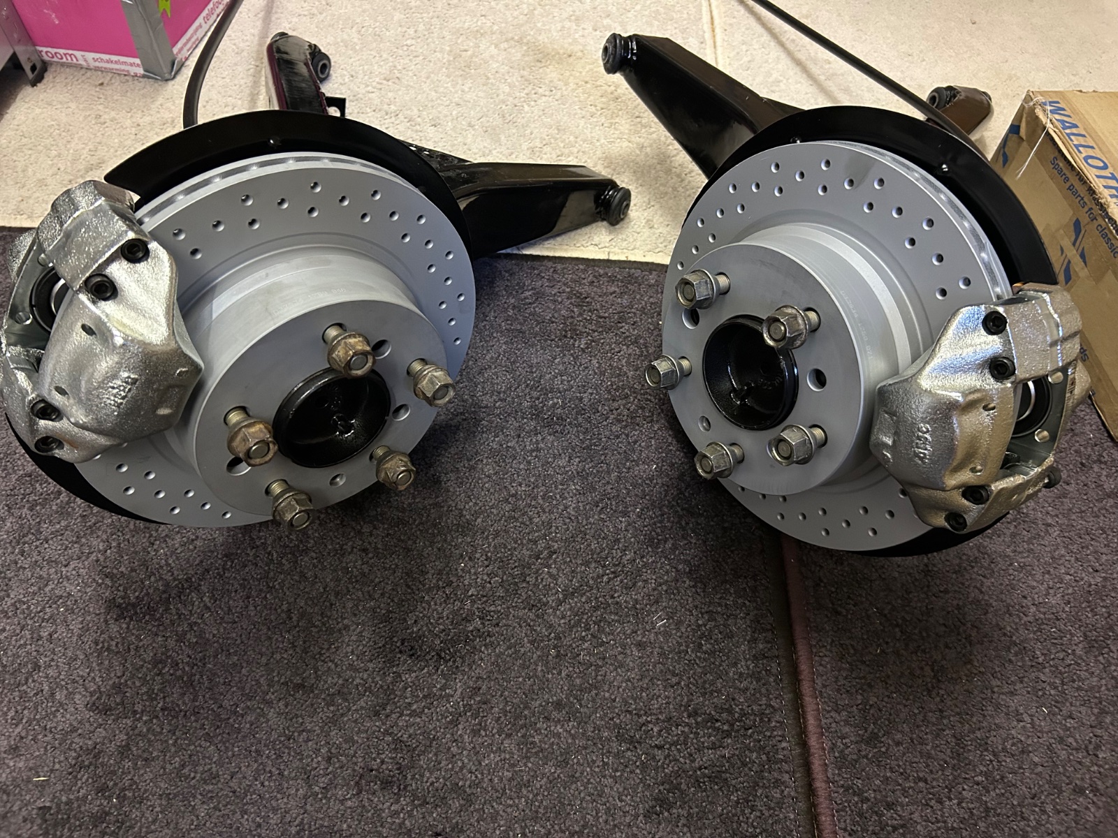

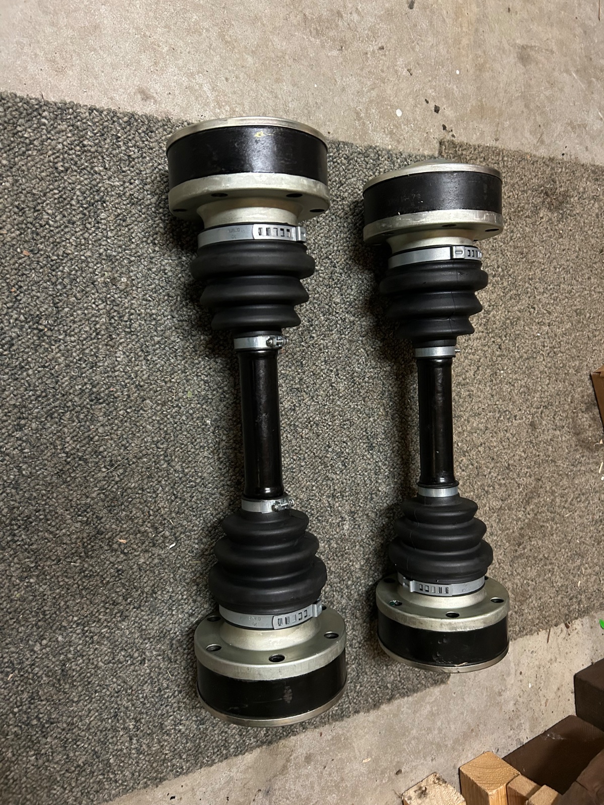

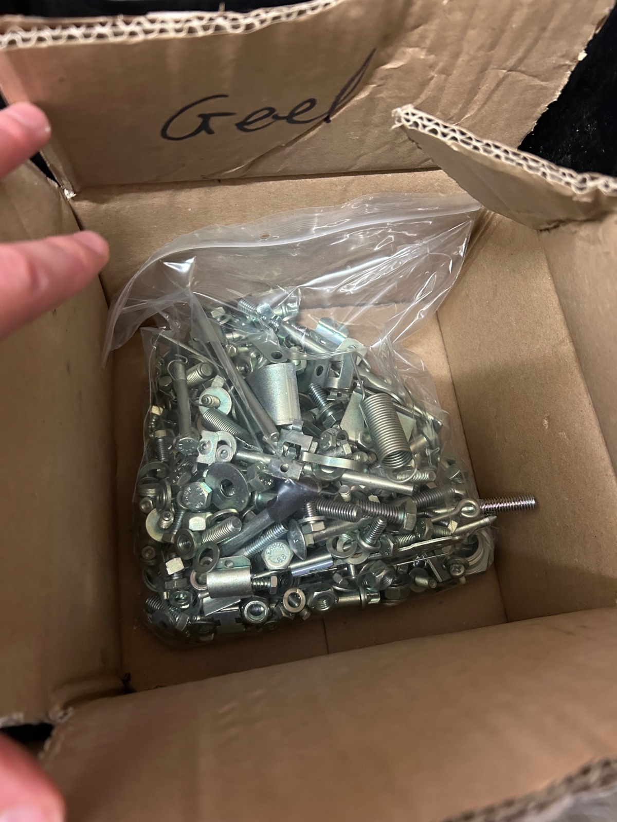

Refurbished also some parts, like the rear axles, clutch slave cylinder, window lifters, heating unit/radiator and fan like Eric also described in his DIY post.

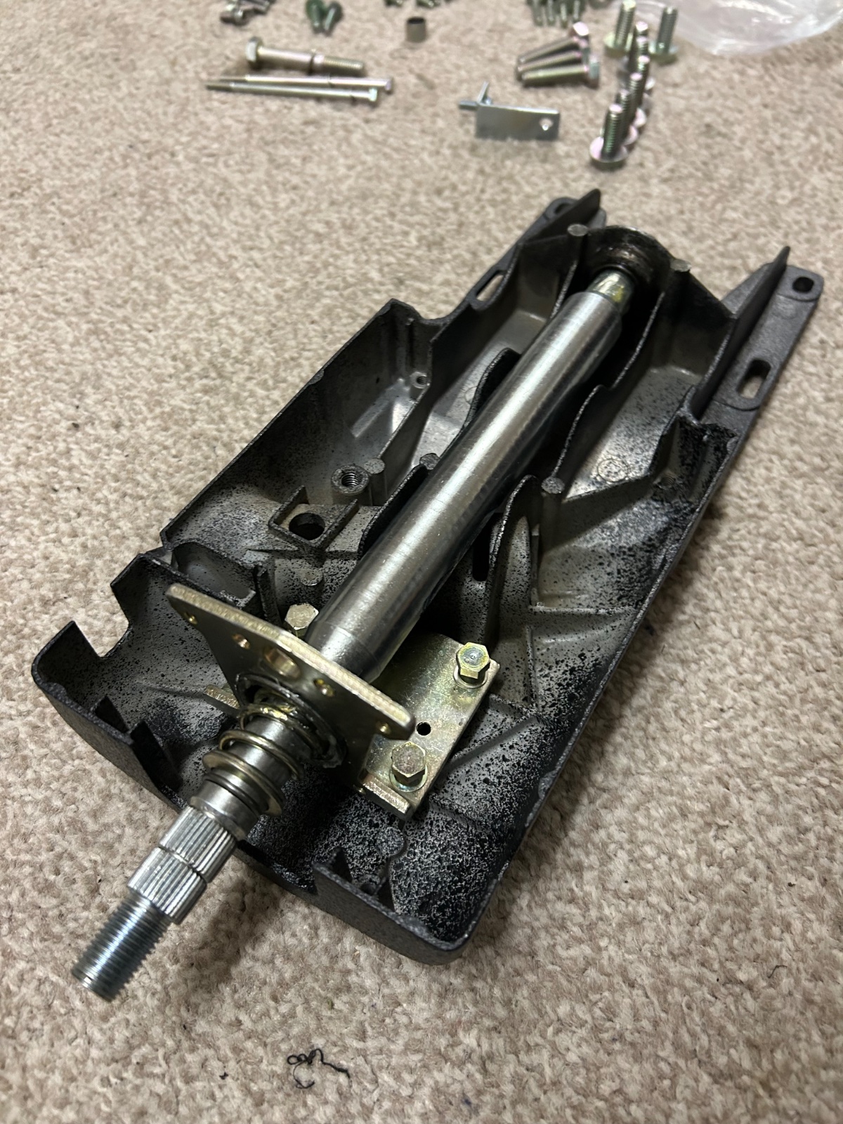

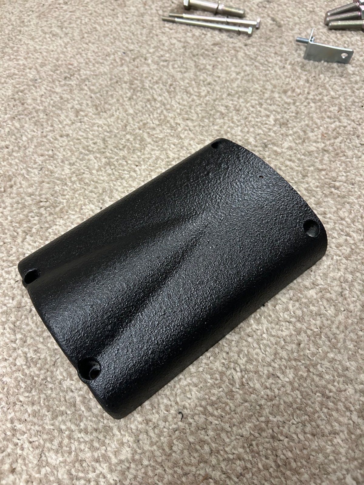

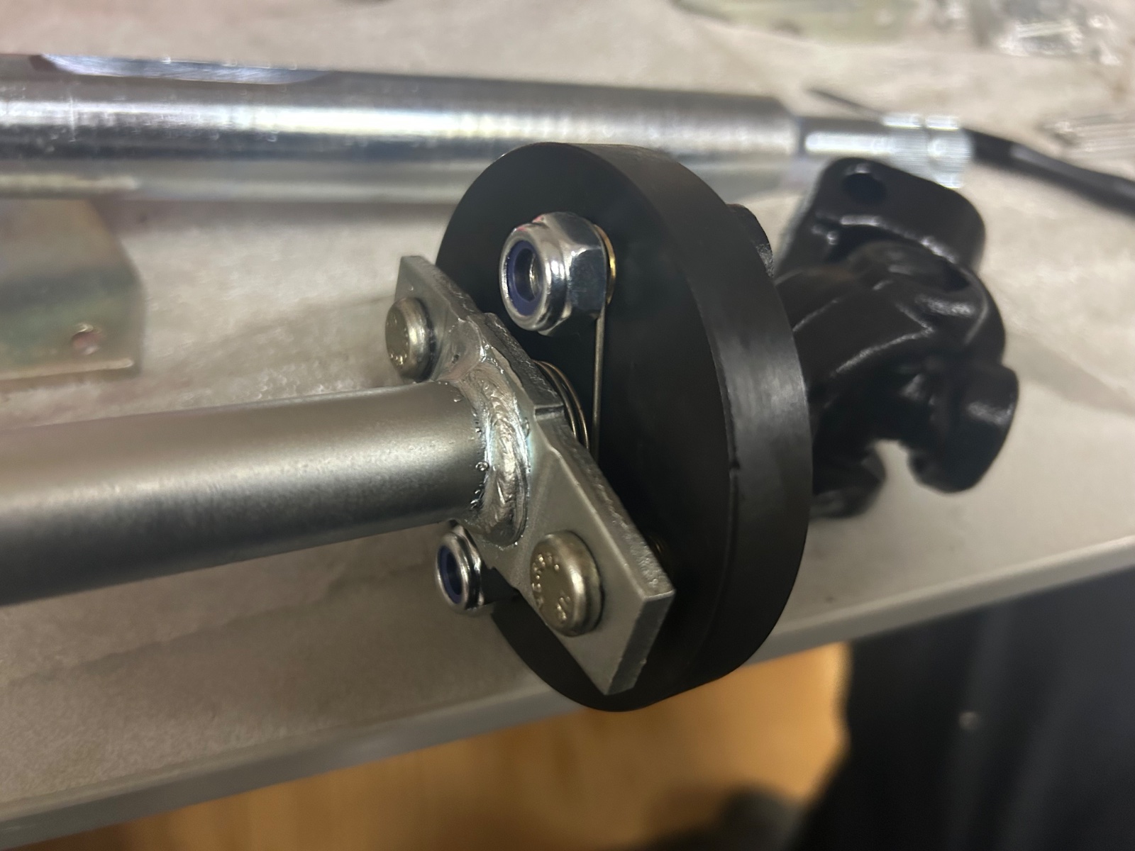

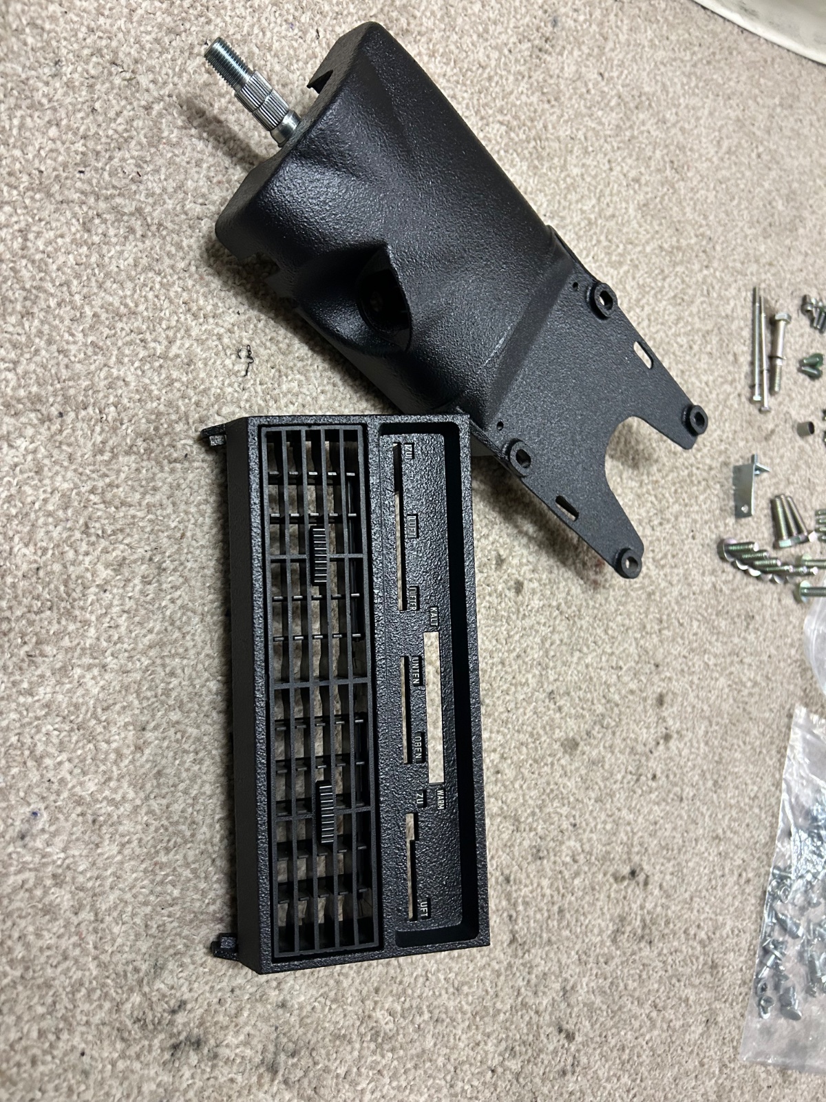

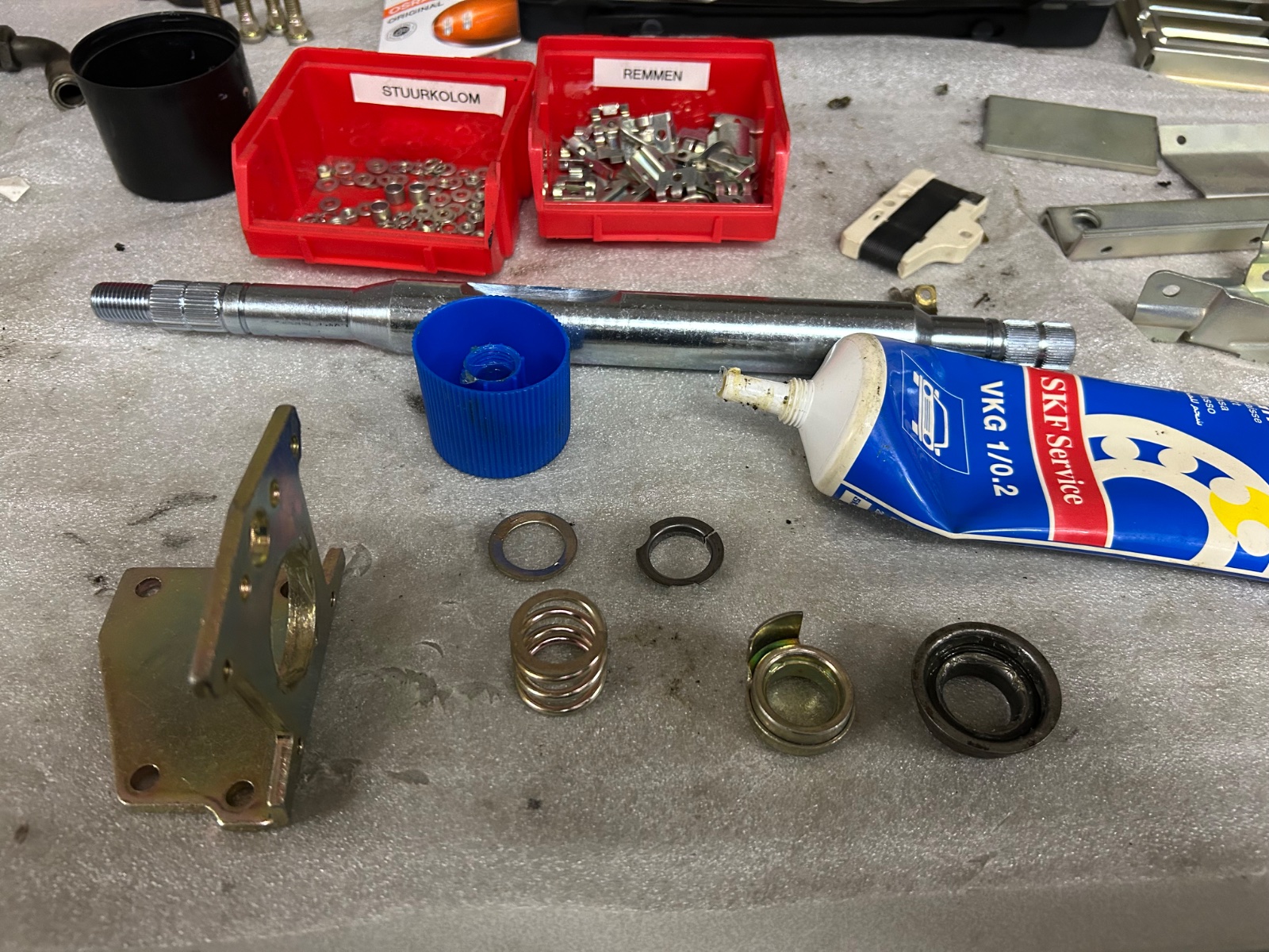

Latest thing is the steering column, the raptor 2k coating mentioned somewhere here on the forum I can really recommend! Very satisfied with the result :)

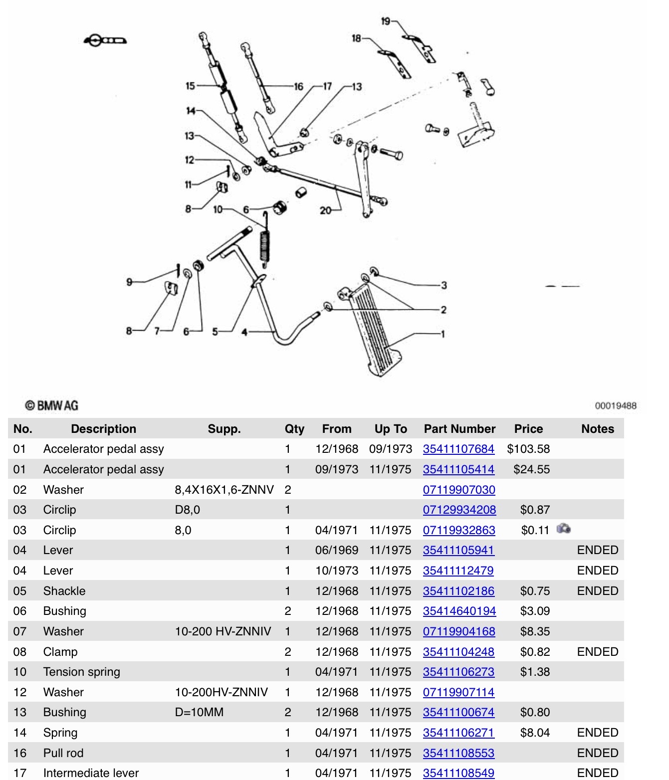

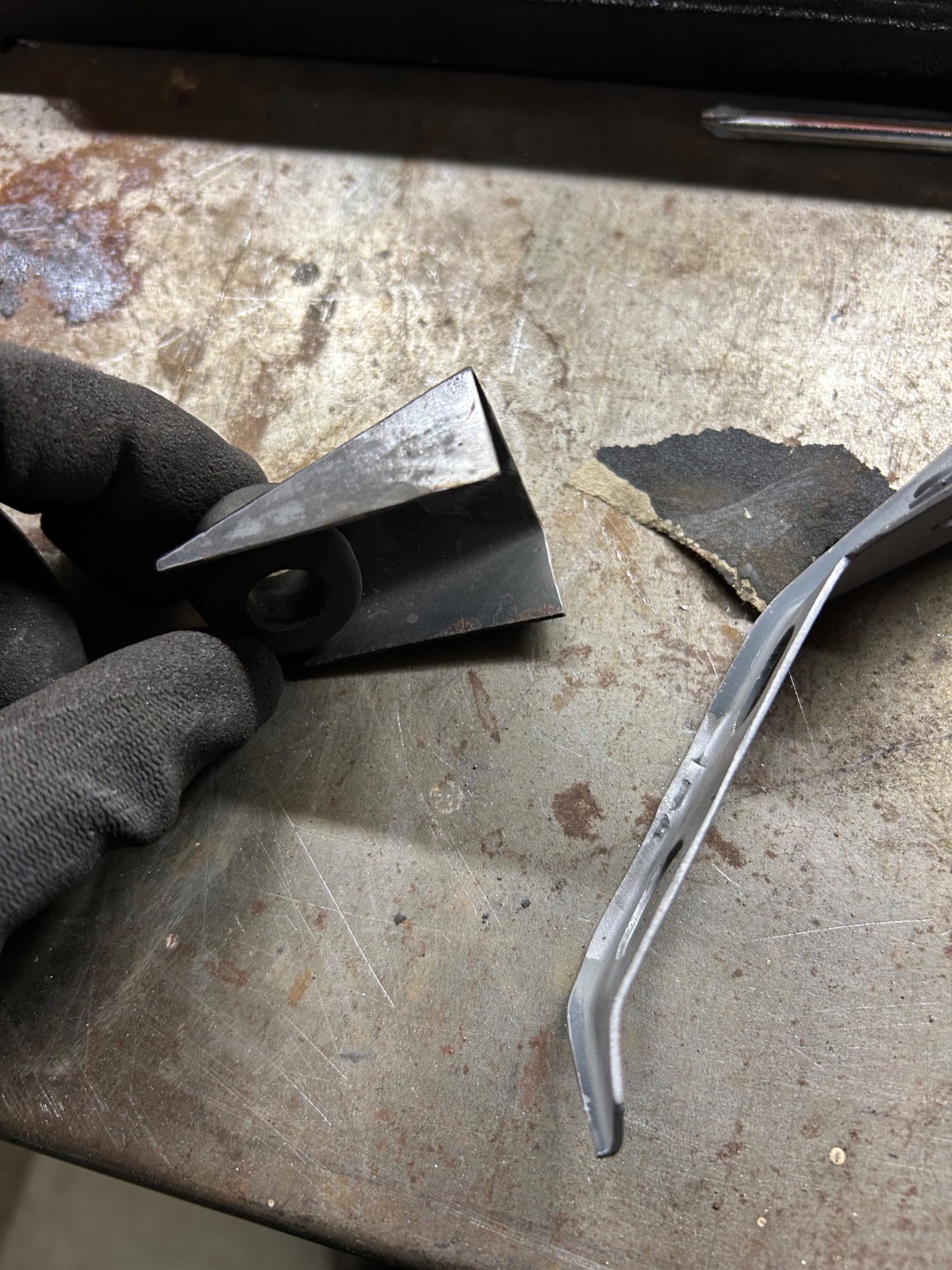

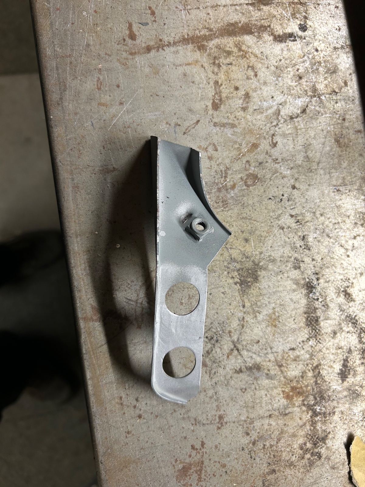

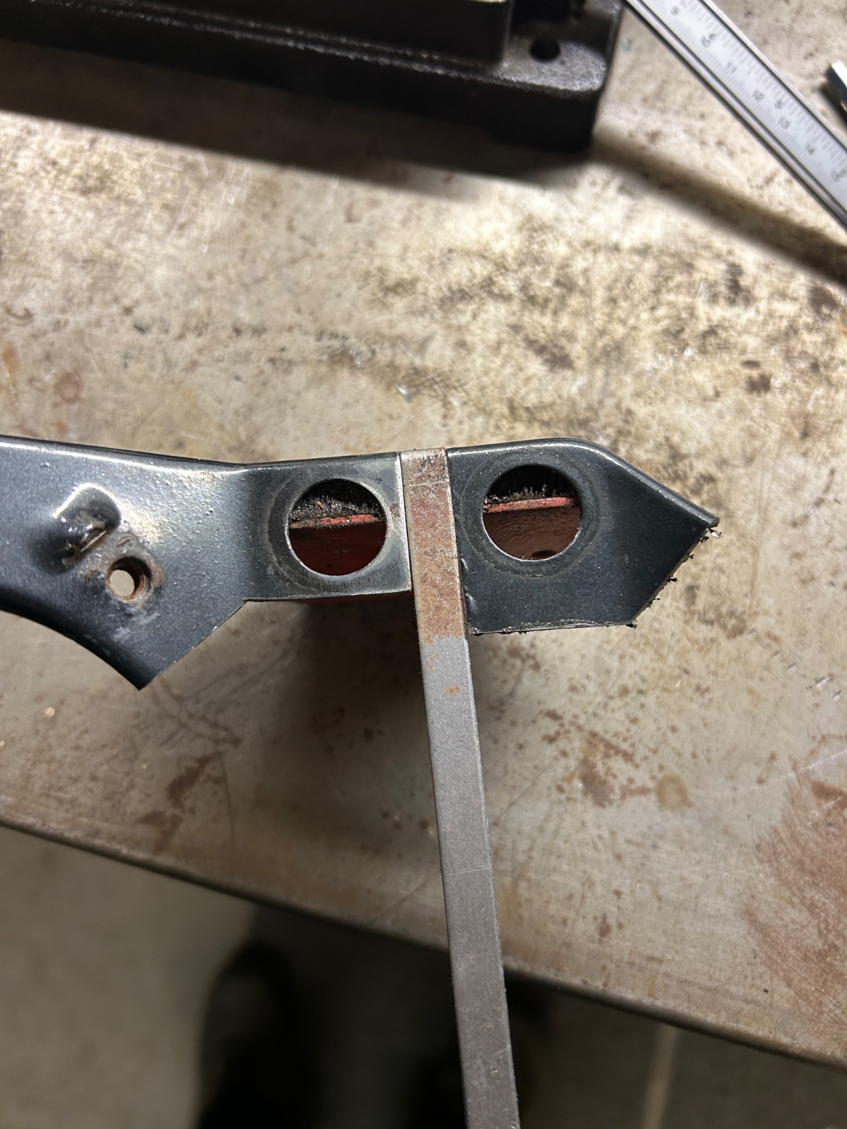

Does anyone recognize where these bushings belong to actually? Made a lot of pictures with disassembly but forgot these two. Was it for the gas pedal as on the photo or the clutch/brake pedals? Thx!
It is for the gas pedal, it fits into the booster mount with a plastic bushing on each side. When the bushings wear out the pedal gets sloppy and will squeak.
Thanks Chris, do we or you have a picture of that here on the forum? Did a check via the search option, found one with a guide on top of the pedal assembly were it looks like to have my bushings. But my pedal assembly does not have this welded on guide?
Look in the engine bay at the booster mount, it rotates the long arm that attaches to the horizontal rod to the bell crank and then to vertical to the carbs.

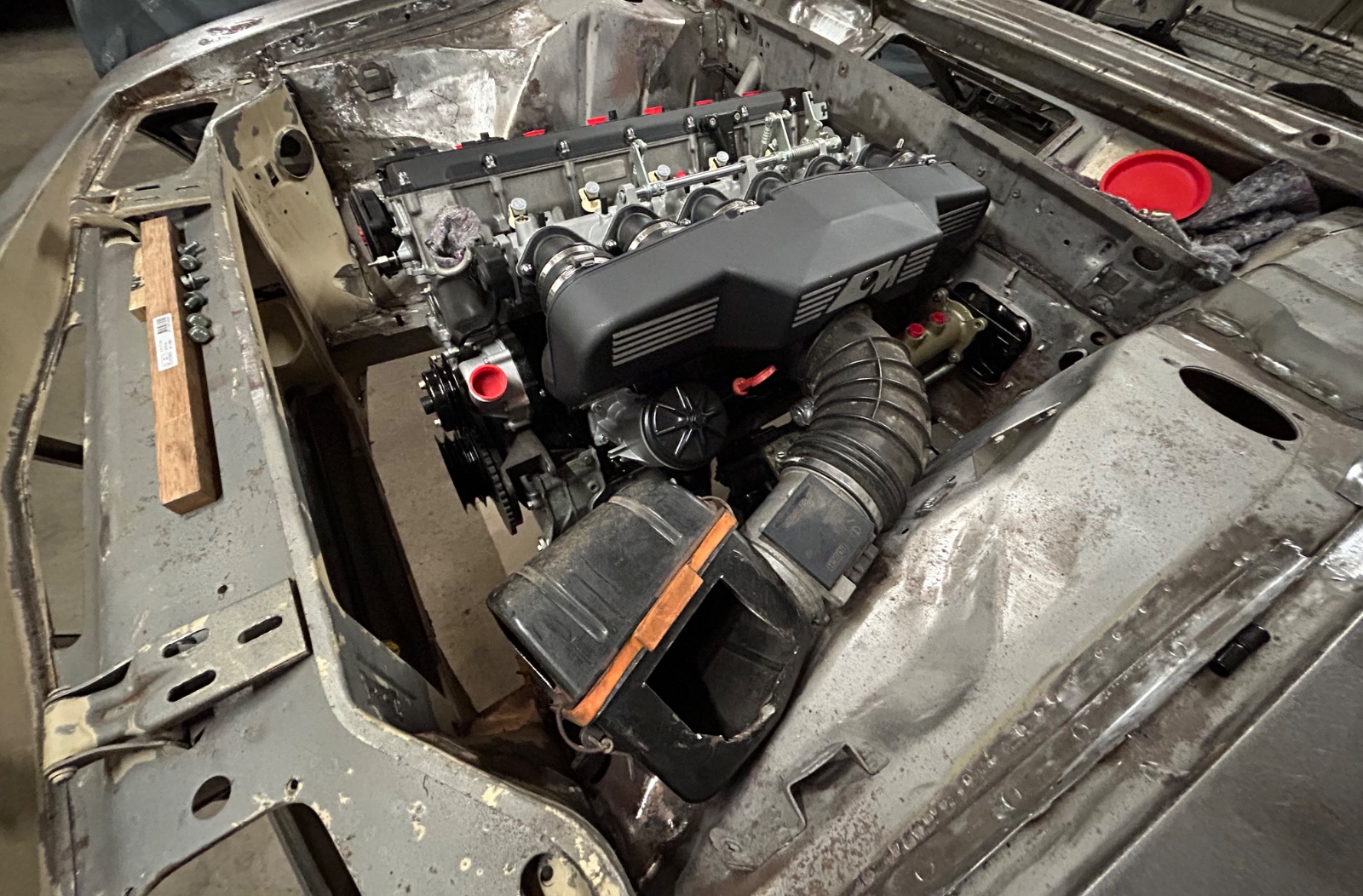

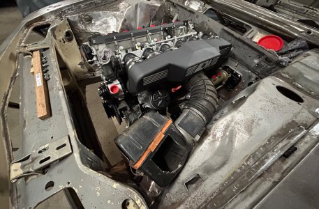

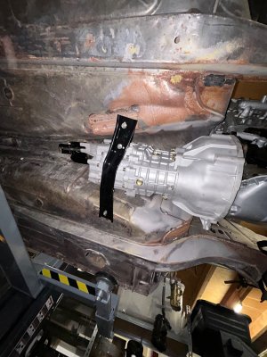

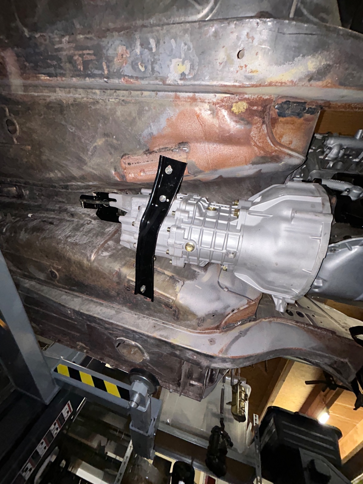

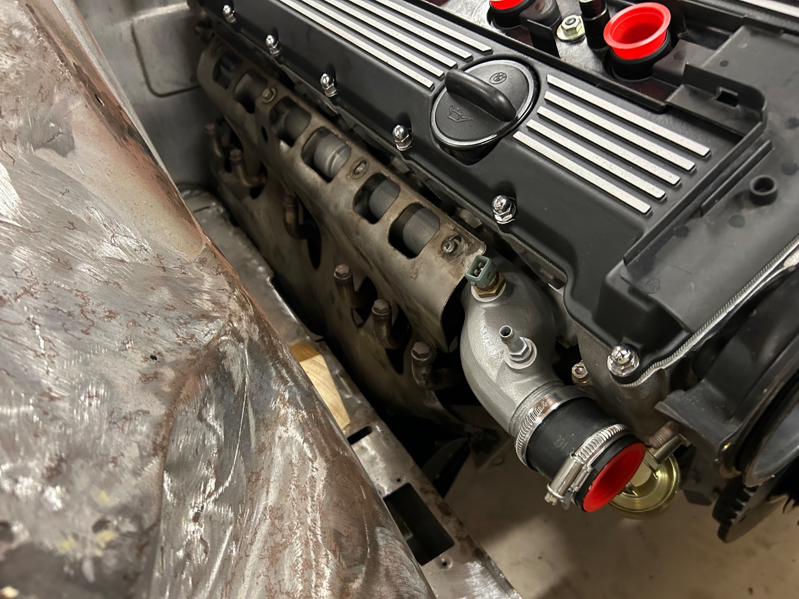

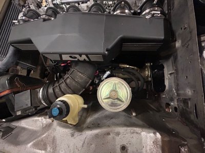

Progressing step by step. For the first time that I installed both engine en gearbox plus gear shift support. That is really a perfect line up I must say.
Need to shorten the gear rod or is there a direct fit from another model which I missed? This one I got with the gear support in the past. I red here somewhere that an e21 rod would fit/line up perfectly?

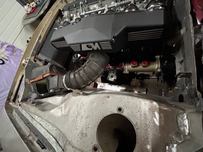

Now working on installing all components and make it all fit.
As you can see I want to use an e24/28 air filter box, need to modify it a bit. Metal, no plastic!

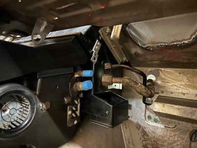

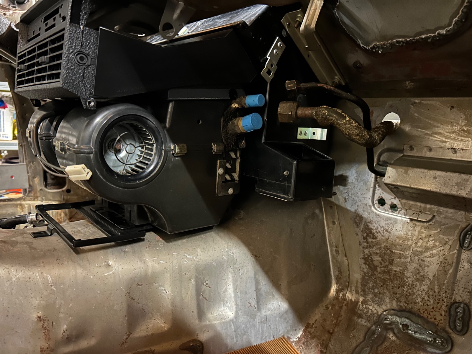

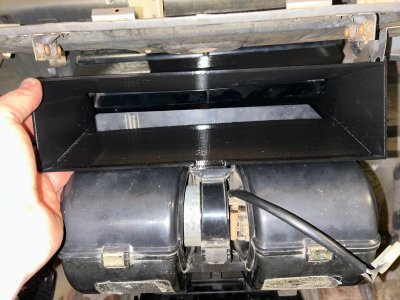

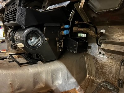

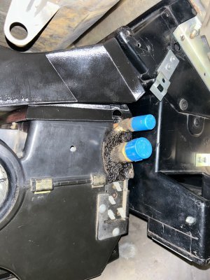

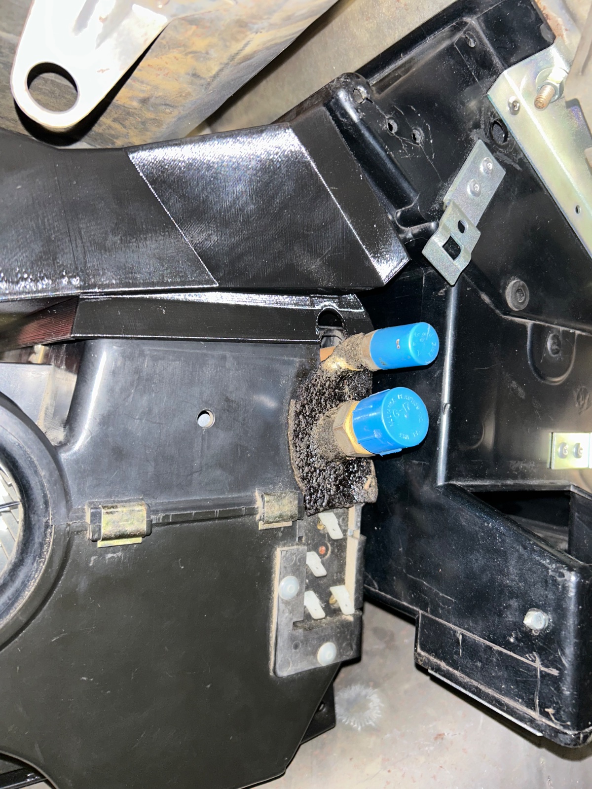

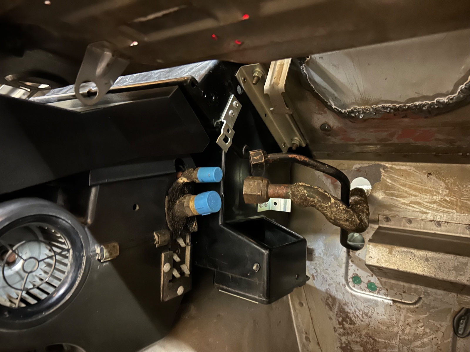

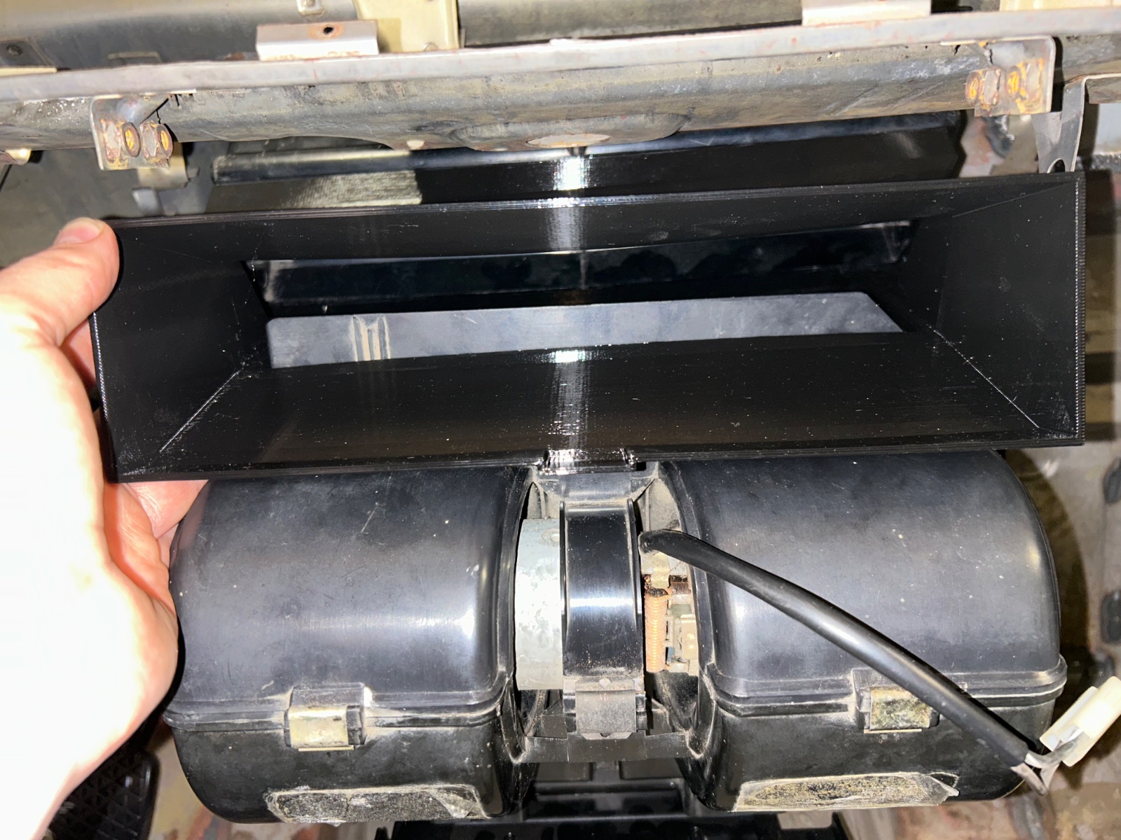

Progressing further, installed the interior heater housing and evaporator housing to see how the AC lines match up which are from an old AC installation and will be used as a reference only before installing new ones.
Was a bit surprised by the fact that the intermediate part on top of the evaporator housing was so much ‘blocked’ by the edge of the evaporator housing as you can see in the pictures. Should be normal I guess? And I still need to re upholster the edges of the intermediate part.

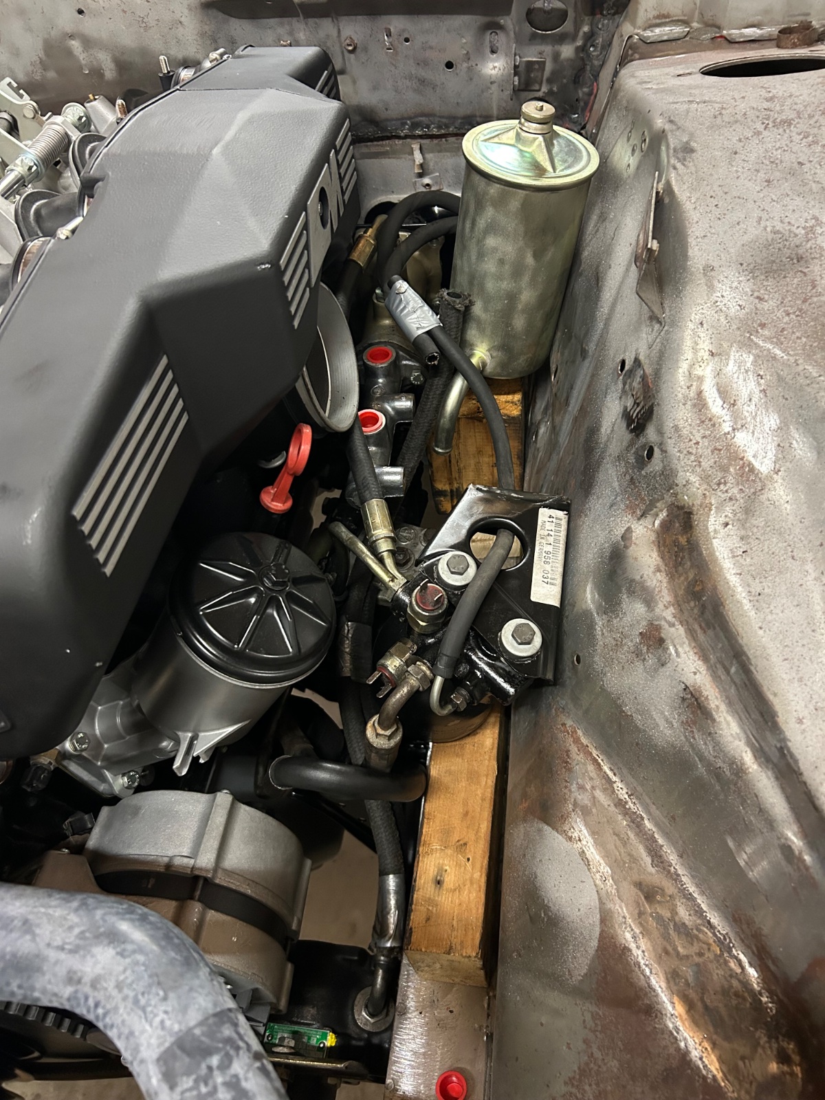

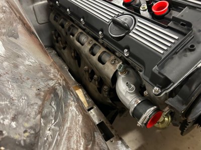

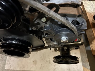

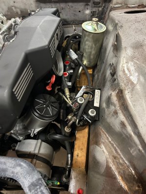

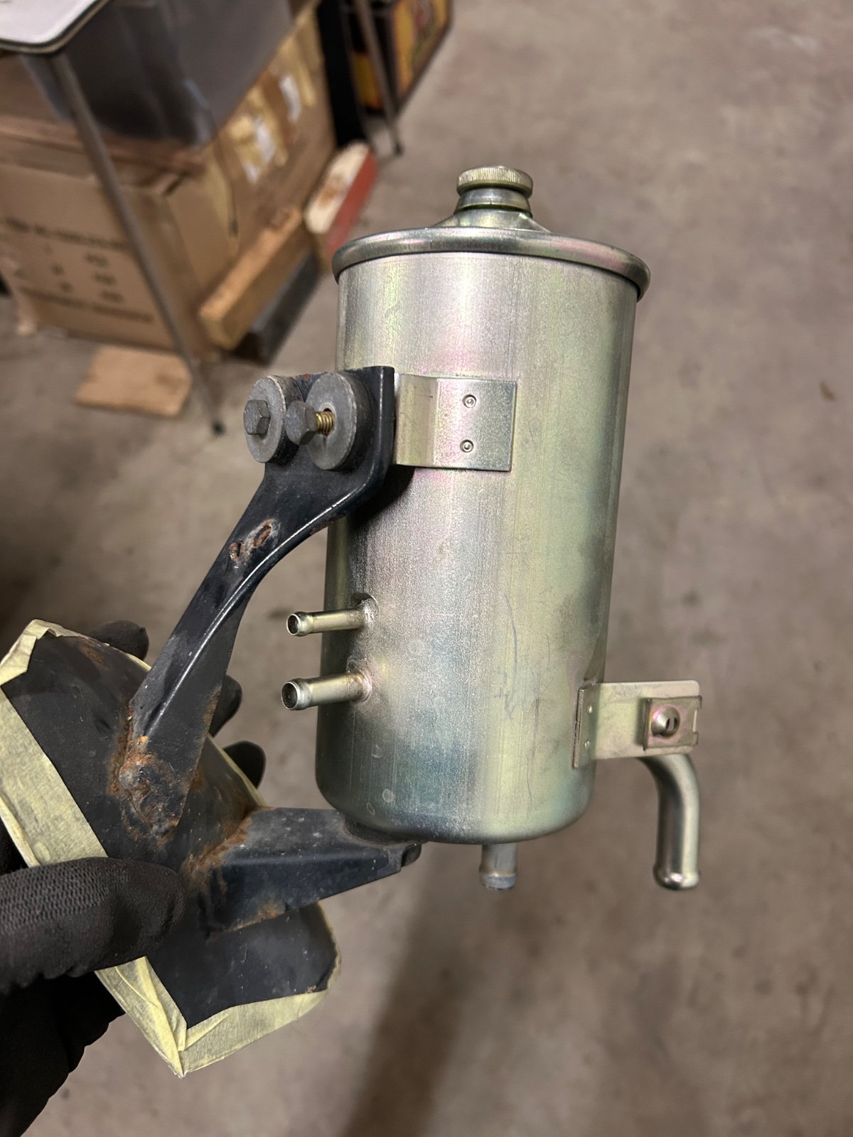

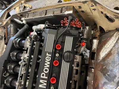

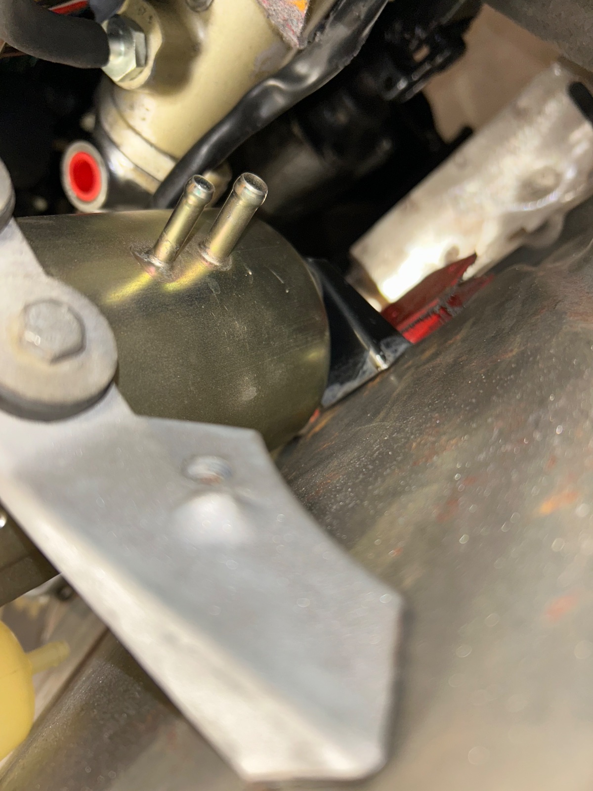

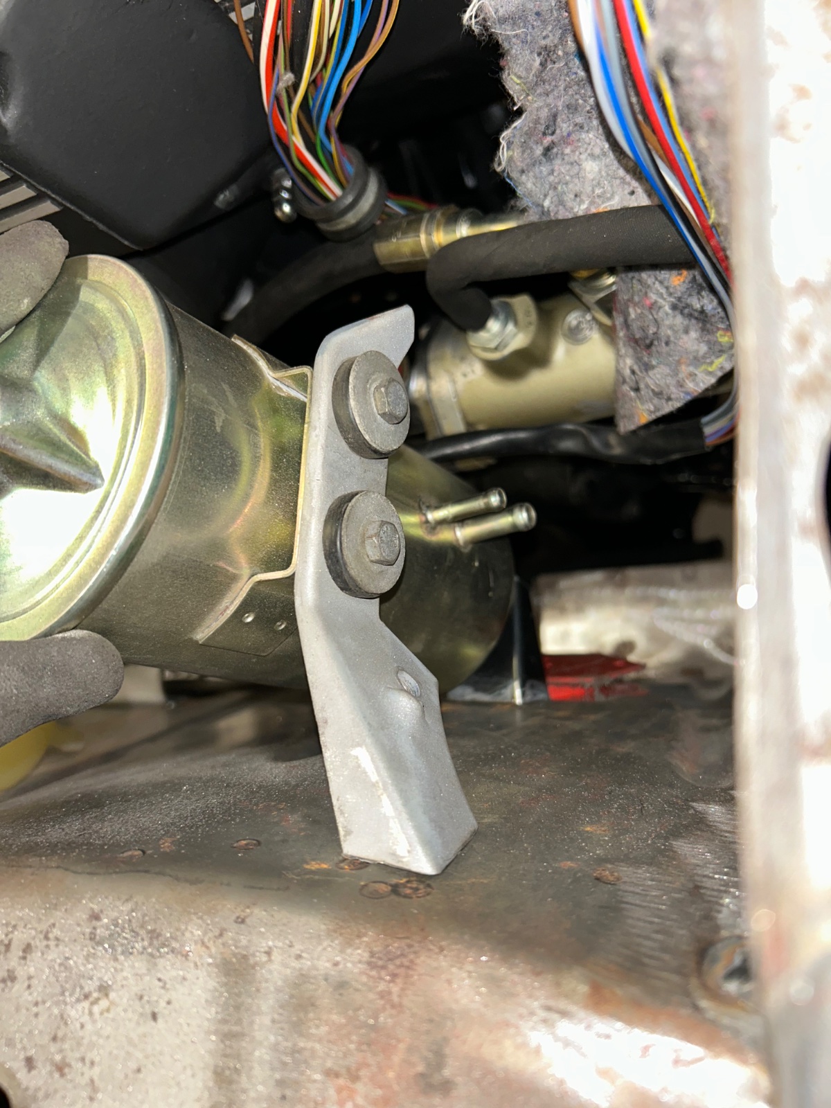

So, some progress again. AI in terms of MS Copilot seems to become a good help for certain items, for instance in finding the right selector rod, apparently the e36/46M3 rod fits exactly and it did. This instead of cutting my original one and rewelding. Copilot also clearly explains how to integrate the e9 wiring harness with the s38 engine harness which I checked, but not yet working on this one.

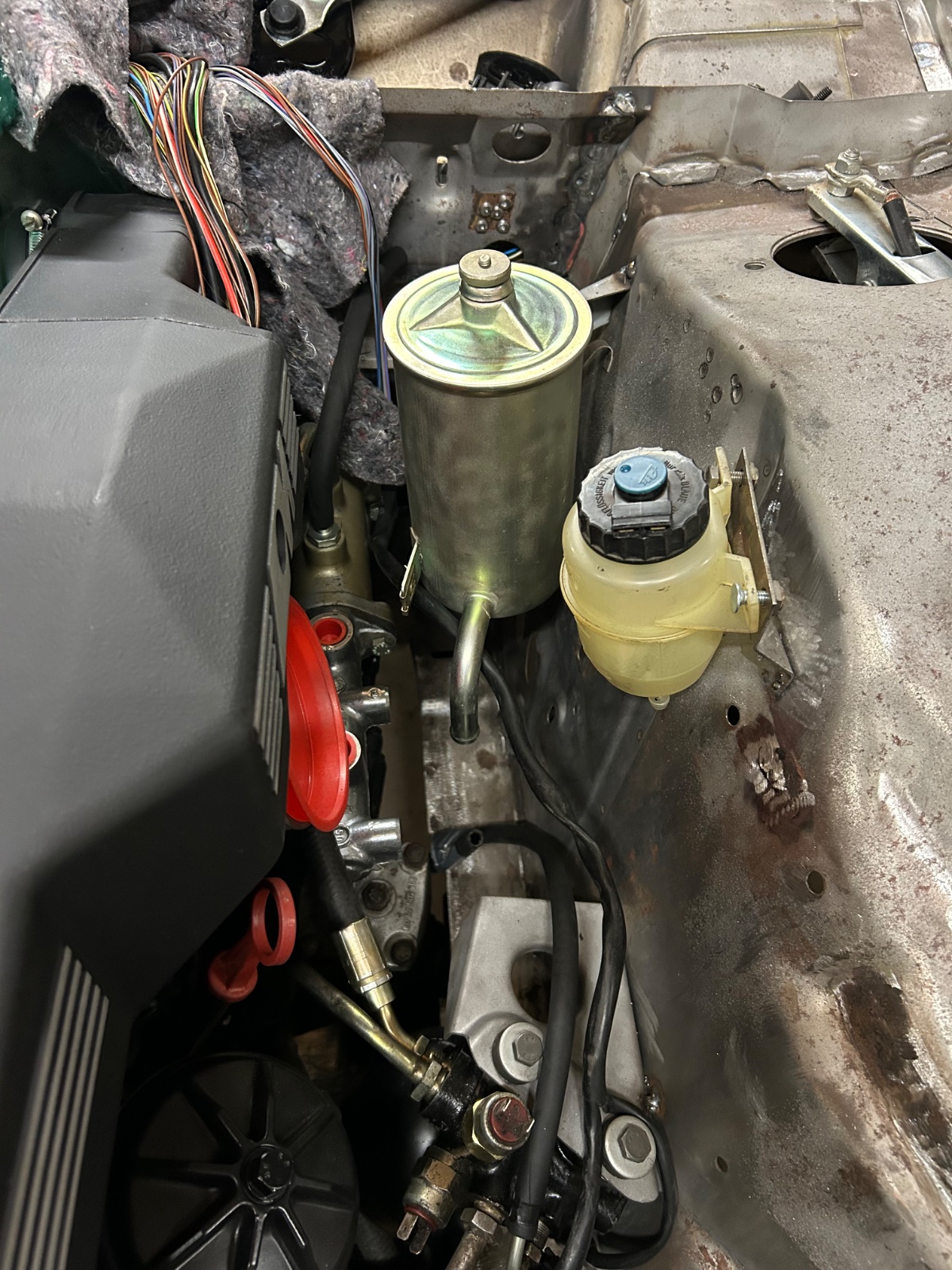

Worked out the position of the ‘bomb’ of H31 system with some old pressure lines and tubes as a reference for making new ones and welding the bracket on the chassis.

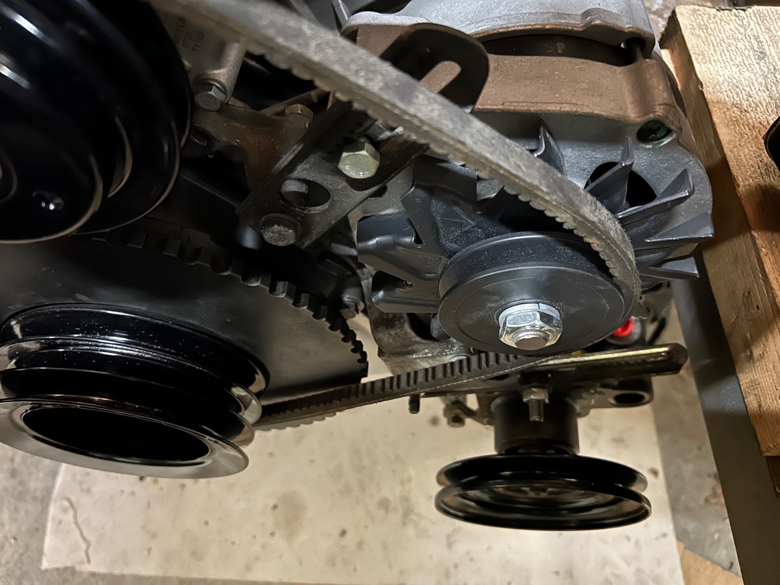

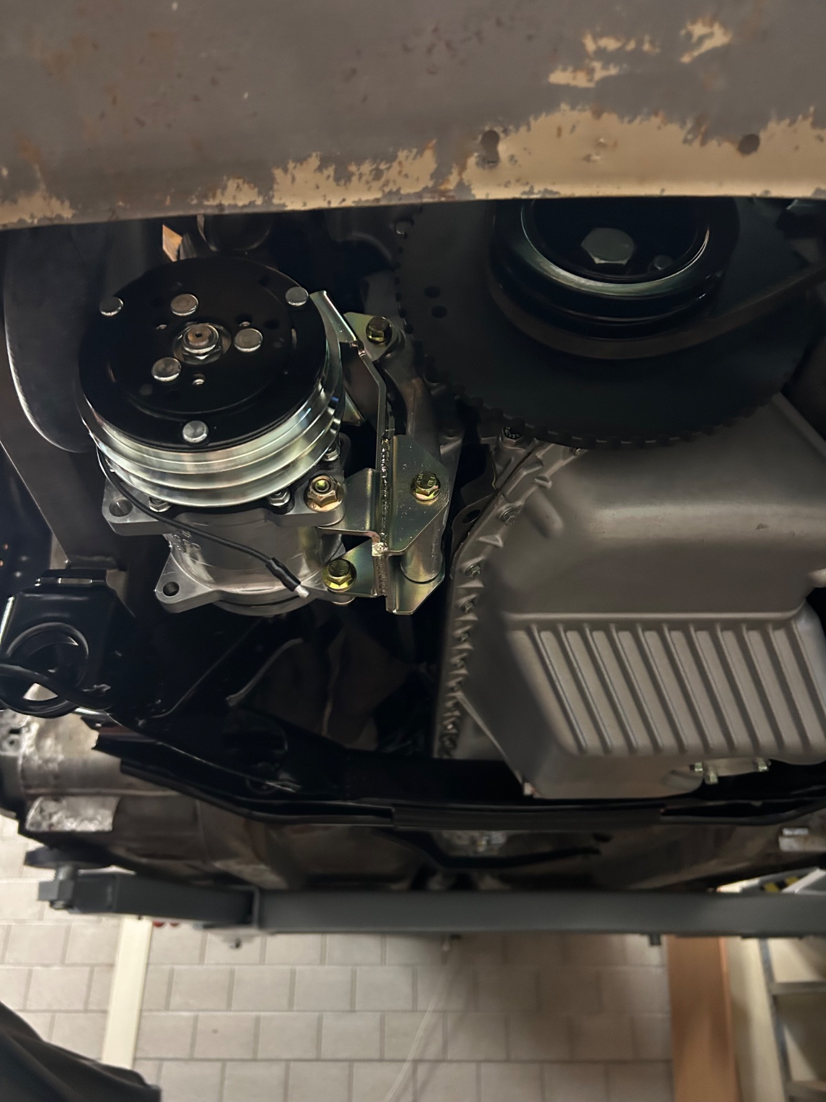

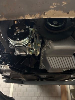

Installed a new Sander compressor with bracket from AC solutions. Also the heat shield of the exhaust tubing fits in without being an issue for the AC compressor or AC lines. Small adjustments to make (bending a bit) but fits in properly. I also took out the secondary air pump/intake with parts of Angry Ass.
Finally also found the several right brackets to match up the alternator and hydro pump.
Next thing is to make a bracket for the cooling water tank and ignition coil, also need to find of proper location/solution to install a secondary water pump, which is originally also on the M5, but that is also in combination with a webasto pre heating system and the internal heater box. That doesn’t apply for the e9 of course (the webasto) but given the fact that heat transfer is an issue for this engine I want to try to install it.
for the rest working on the drawing of a custom made radiator because both original M5 and e9 do not fit. They hit the thermostat housing of the engine. Also the original fan will hit the radiator core.
Also the oil cooler will need to have a creative solution to be able to attach the oil cooler lines.

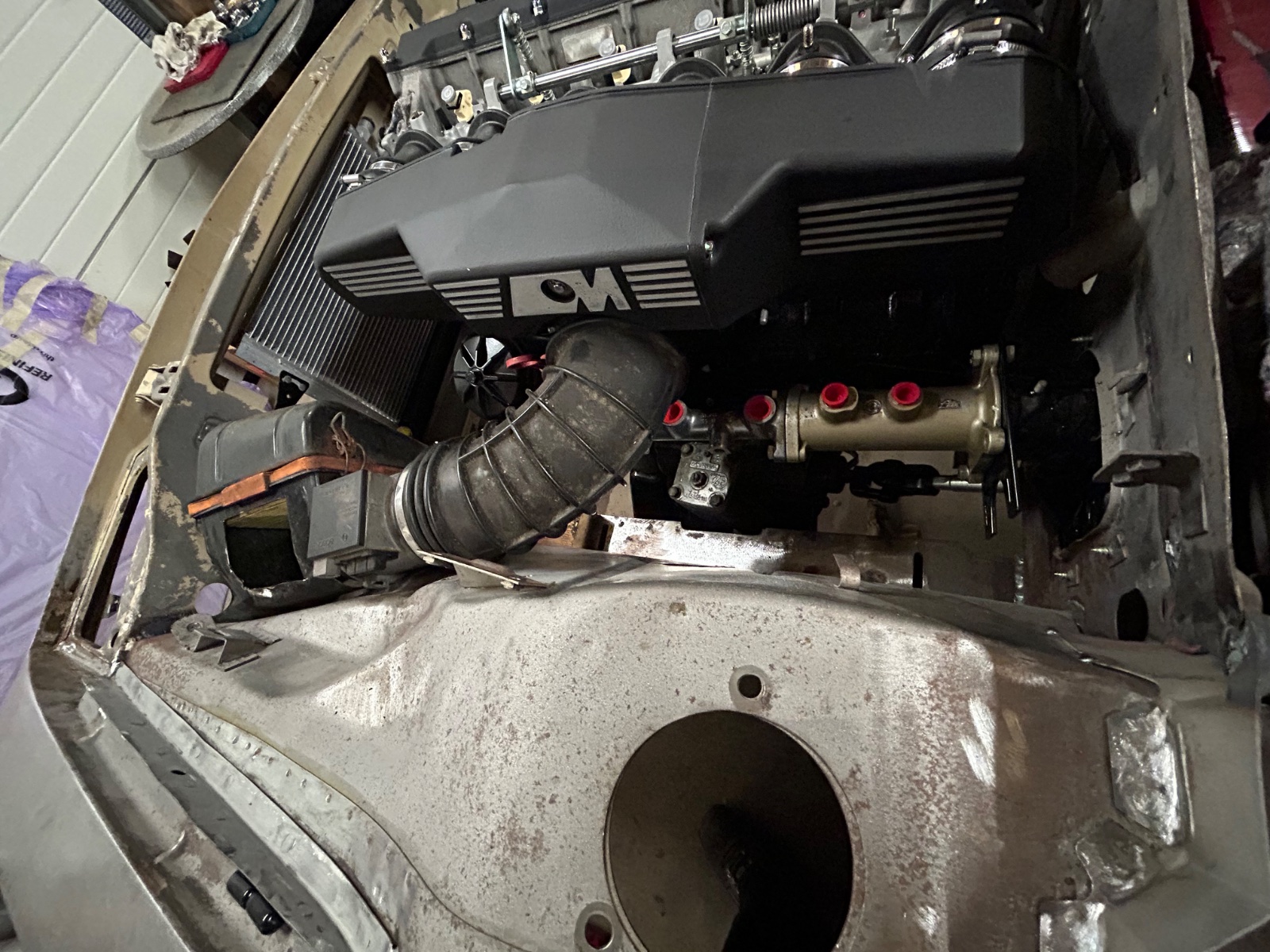

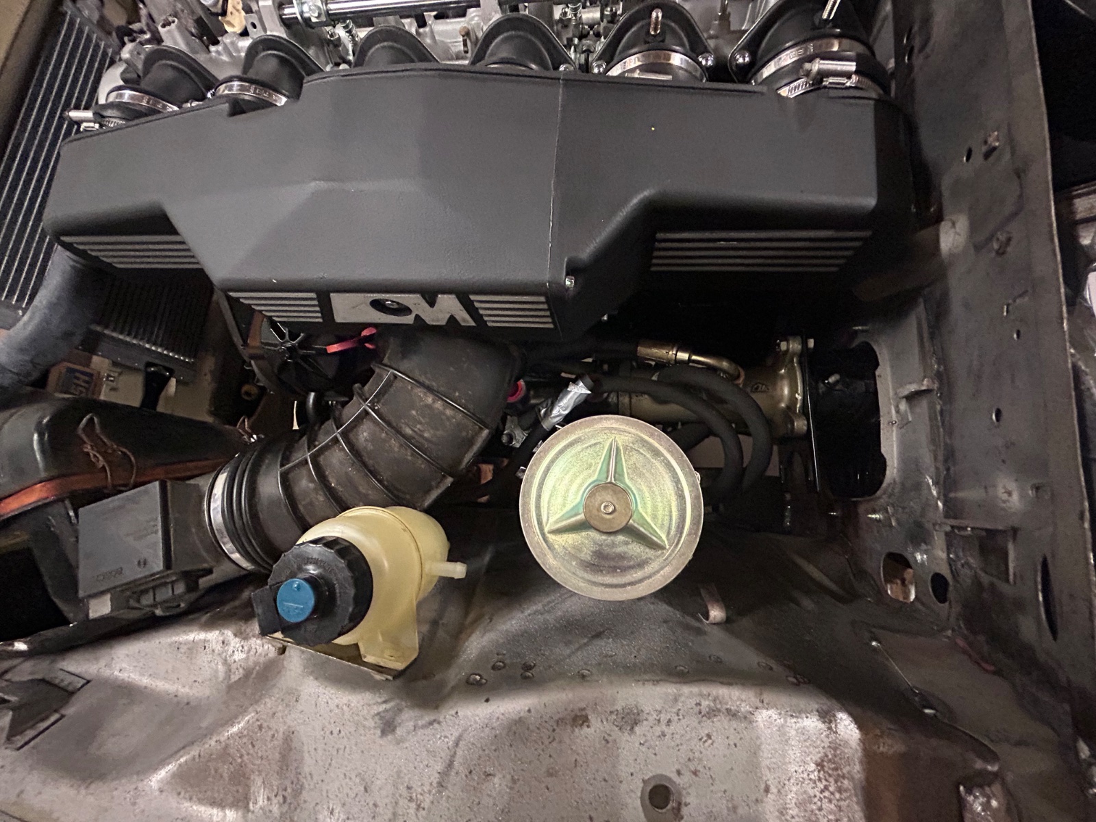

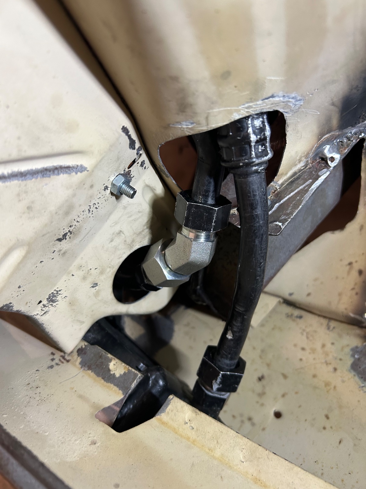

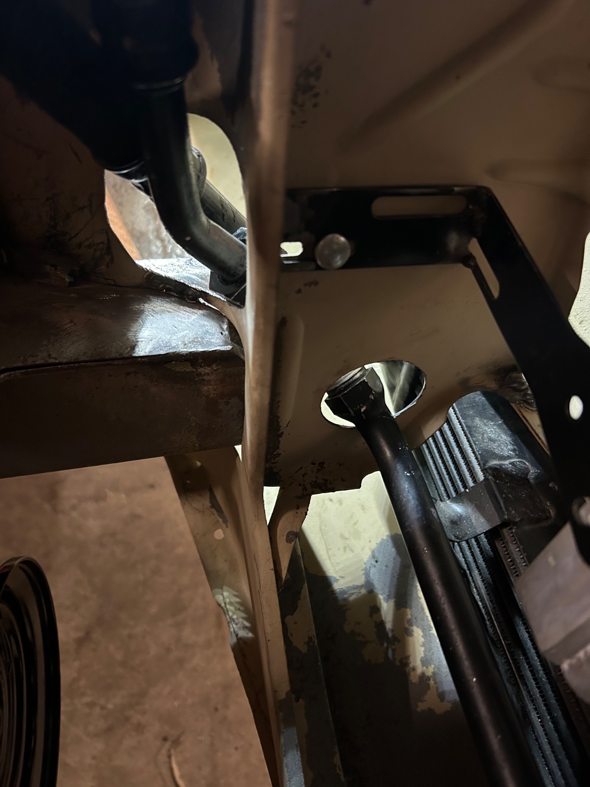

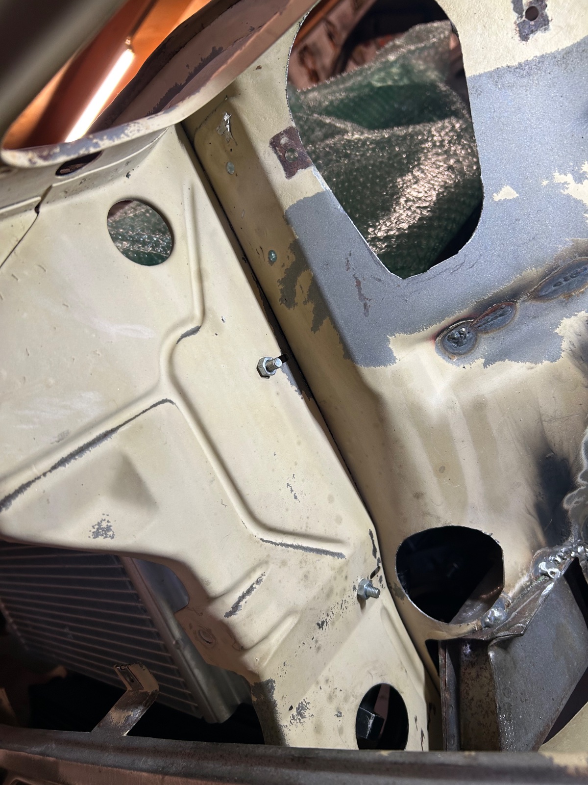

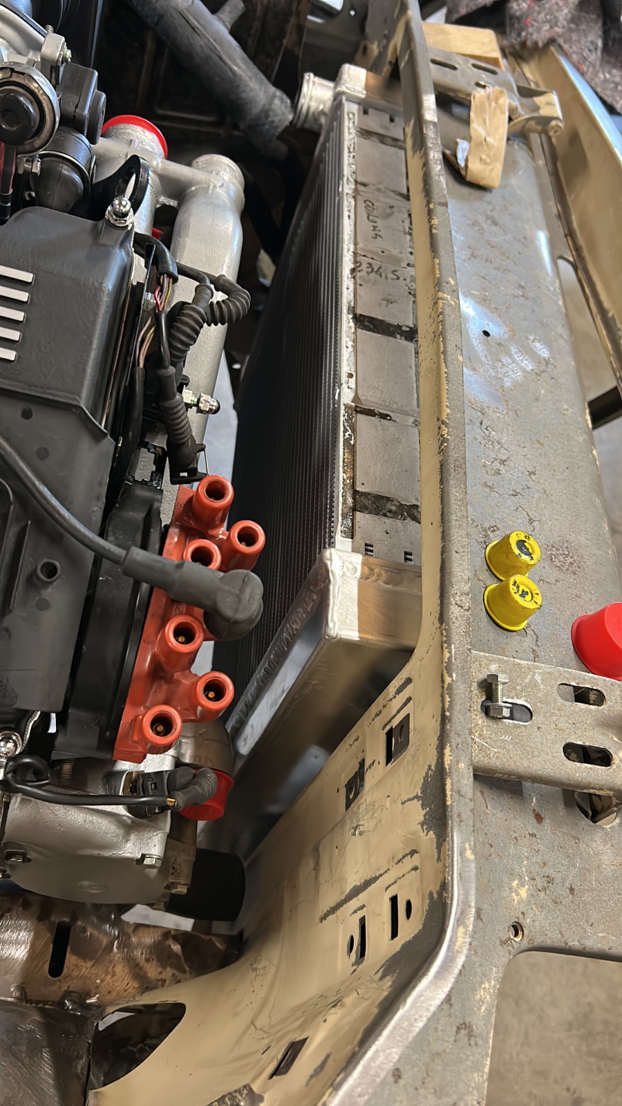

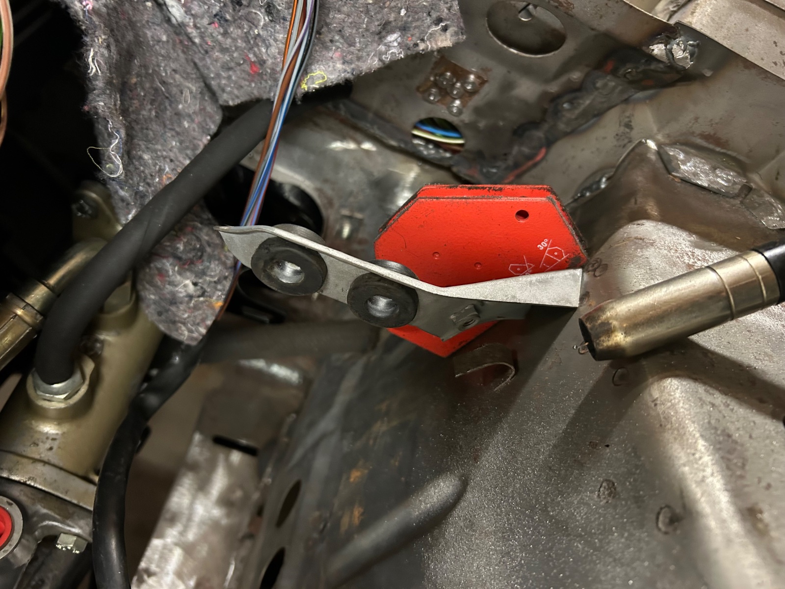

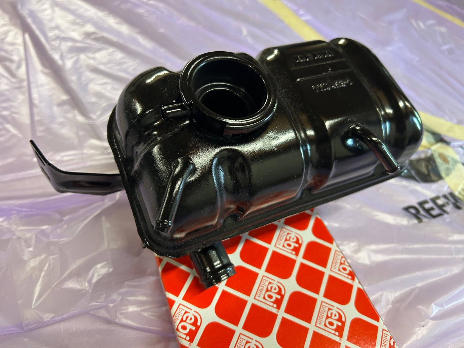

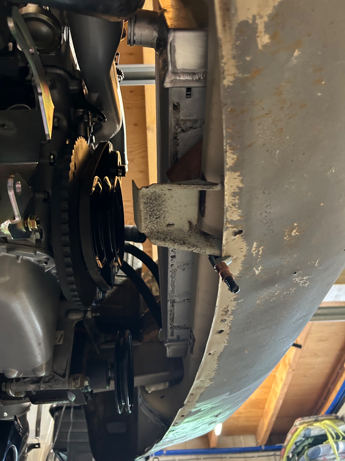

Update again, this time on the cooling part, oil cooler lines are now put into place with the original cooler and lines while I needed to bent them a bit. Also made some holes through the chassis to make it work in relation to the cooling water radiator.

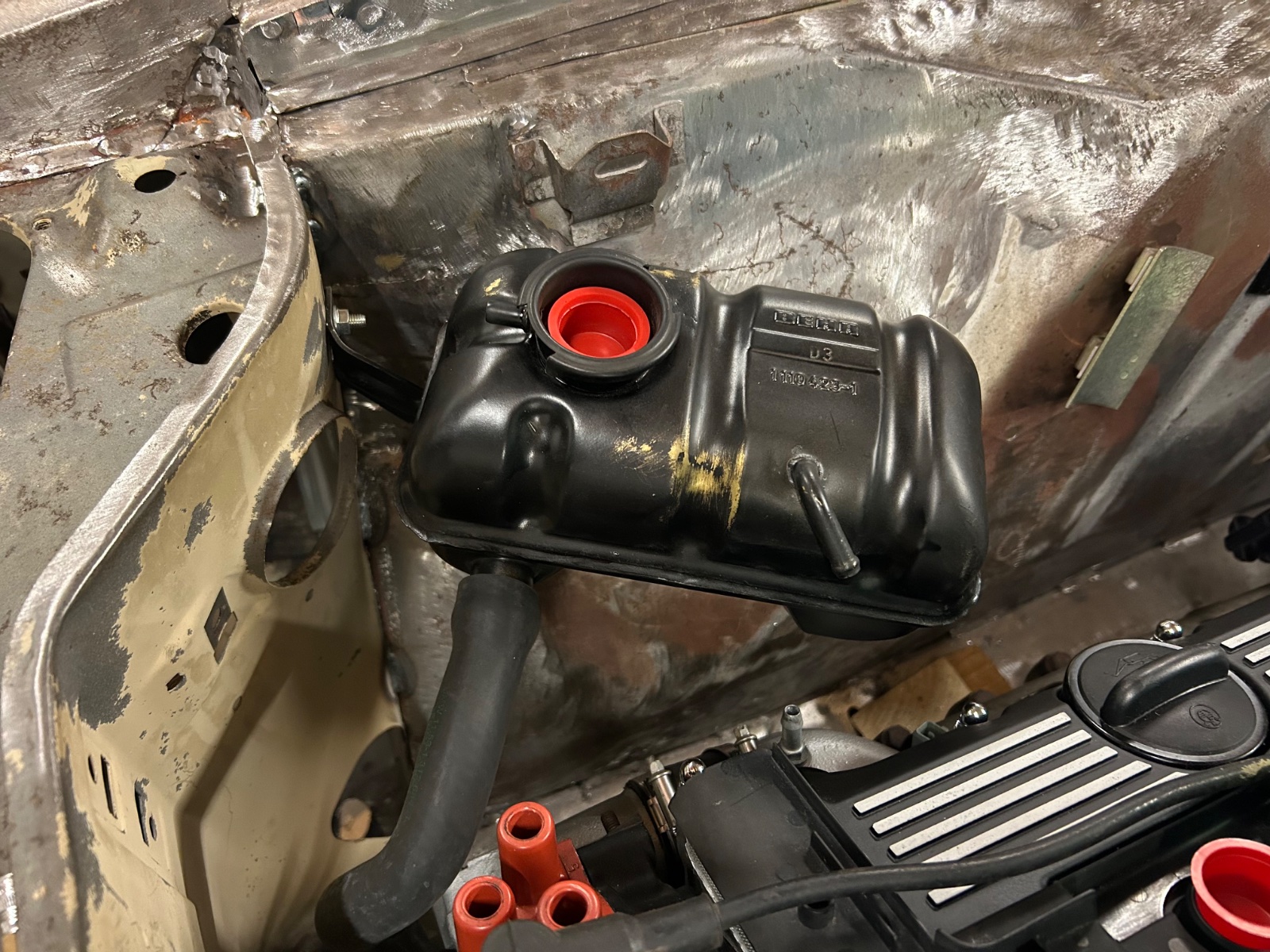

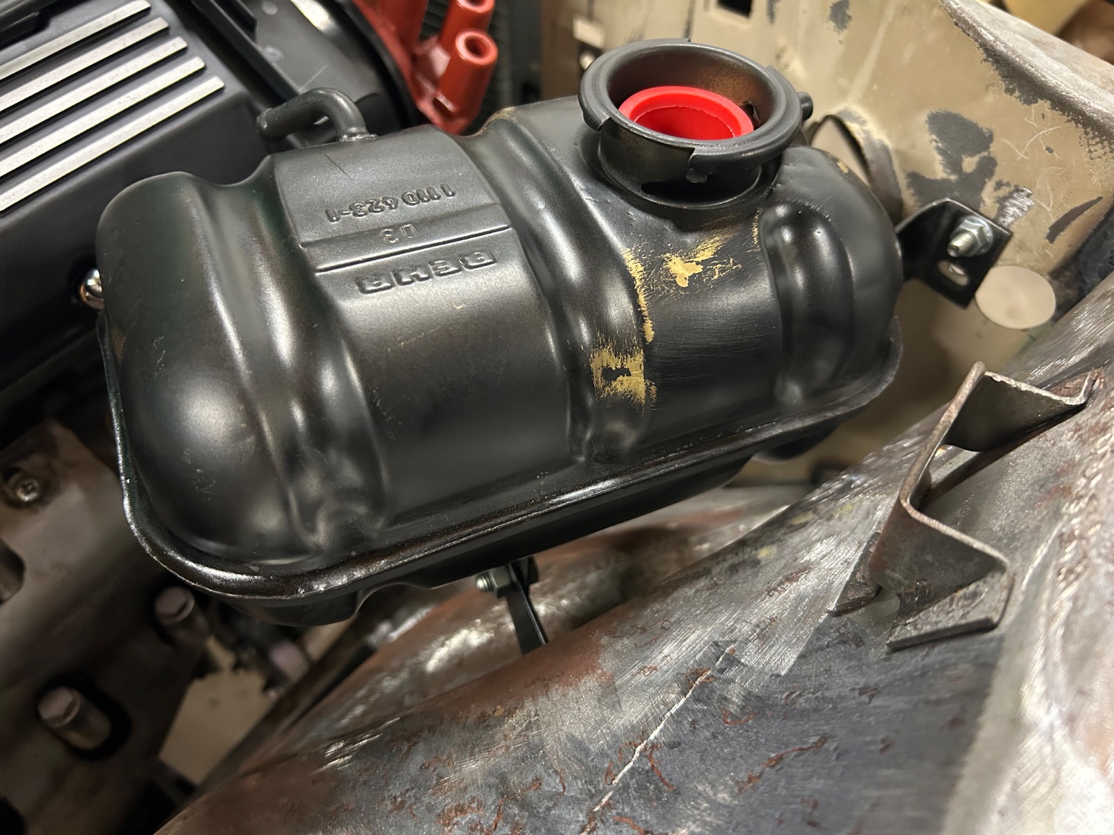

Cooling tank is also put into place, need to weld the small bracket on the underside of the tank to the chassis for sufficient support. Tank will get a double feed for the overflow of the s38 cooling lines.
After some puzzling with an original s38 radiator, a so called new ‘sport e9 radiator’, and a 2nd hand original version it came out that I have to let build a custom made radiator that fits partly in the noose. Decided to also go ahead with two SPAL cooling fans instead of the original fan of the S38 for more cooling capacity.
Also the drive train is sent to a professional shop to get it shortened to fit.
With that I have almost everything in place now to were it should fit and also make it fixed to the chassis.

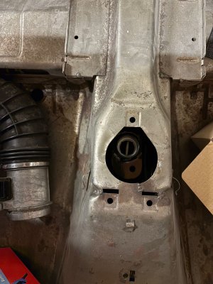

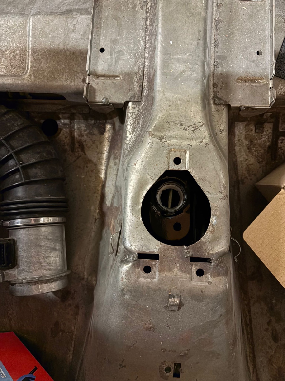

Unfortunately I need to move the brake fluid holder 1cm to get the air intake fit. Made a hole through the chassis for intake air to the filter unit.

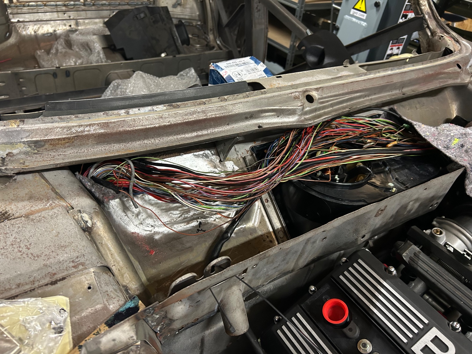

Started last week also with stripping the engine wiring harness to get it fit into the engine bay.

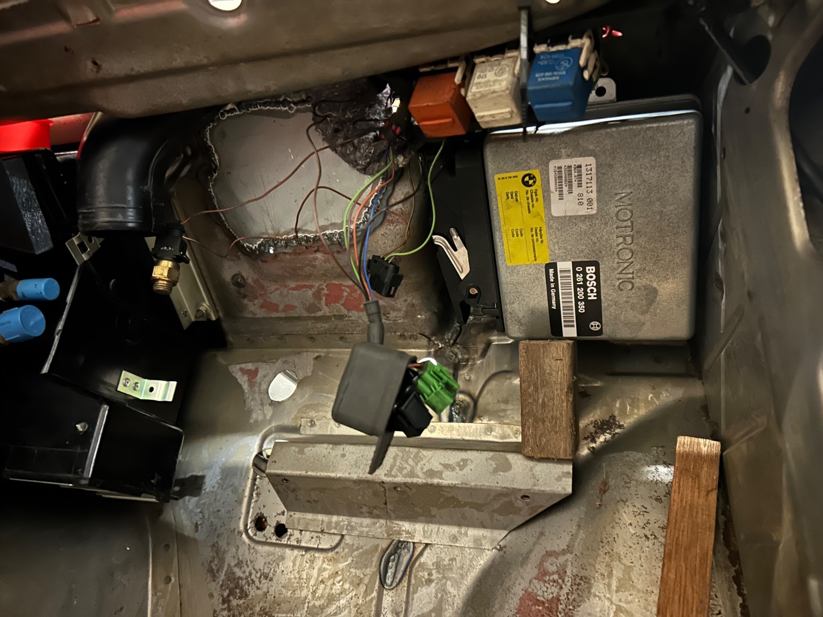

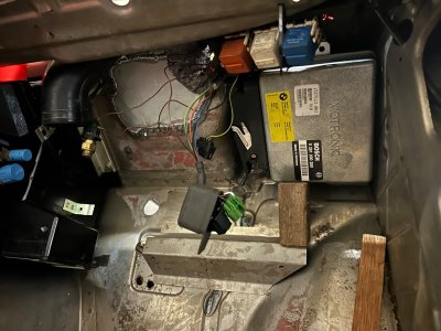

Working on the wiring harness and we’re to place the DME, relays and air accumulator control unit. Pre fitted it all above the glove box, need to make some brackets to hold it all in place.
Relays fit good besides the defroster part.
Made a hole through the cabin wall. Might have to adjust the inner trim part at the A-style a bit, but that is not visible because the glove box is in front of it.

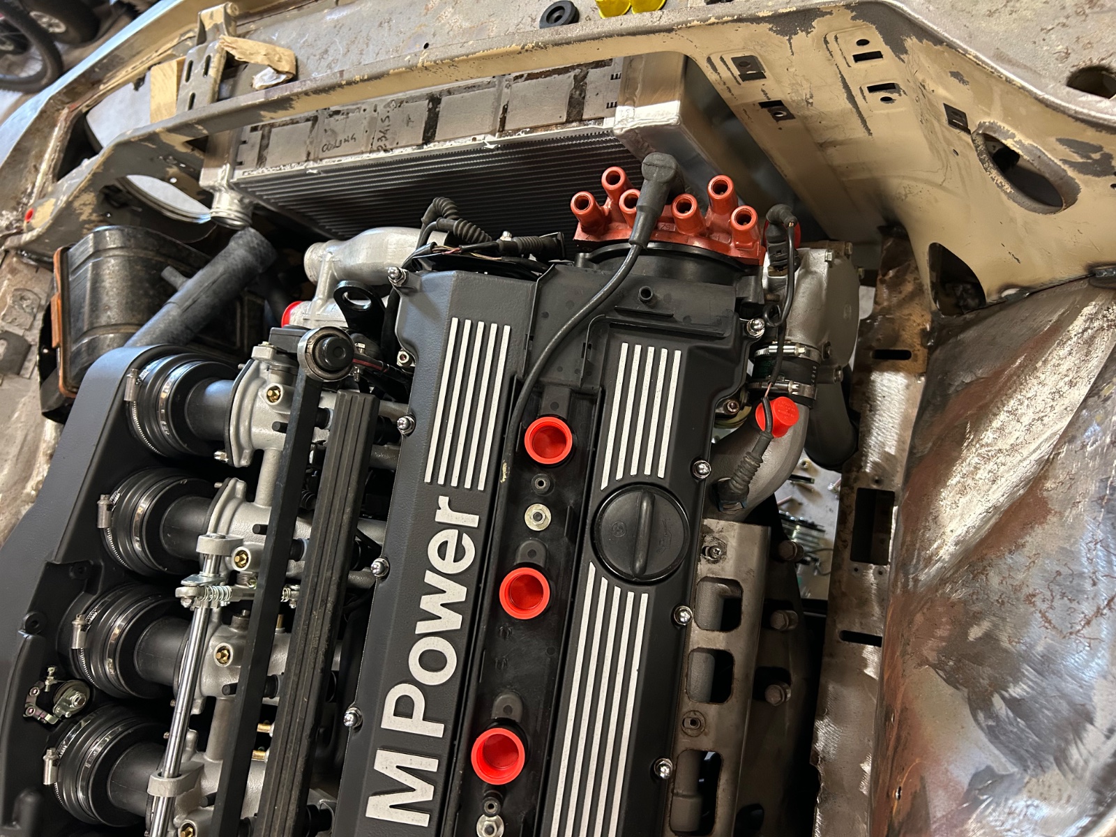

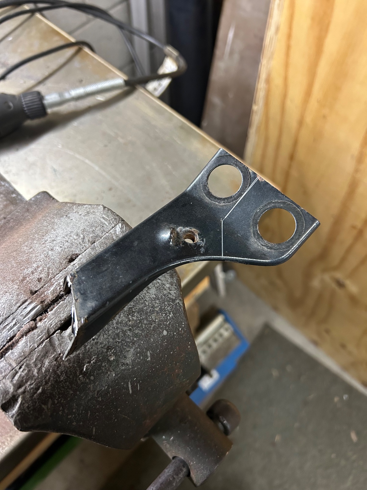

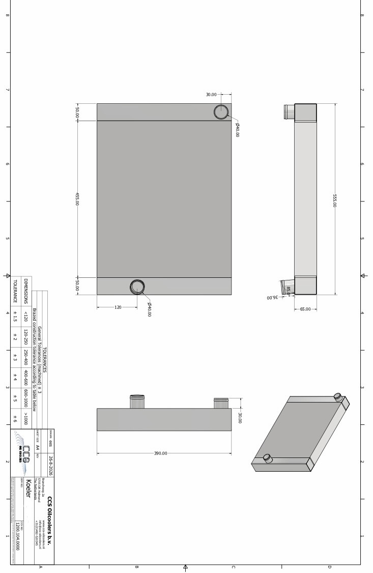

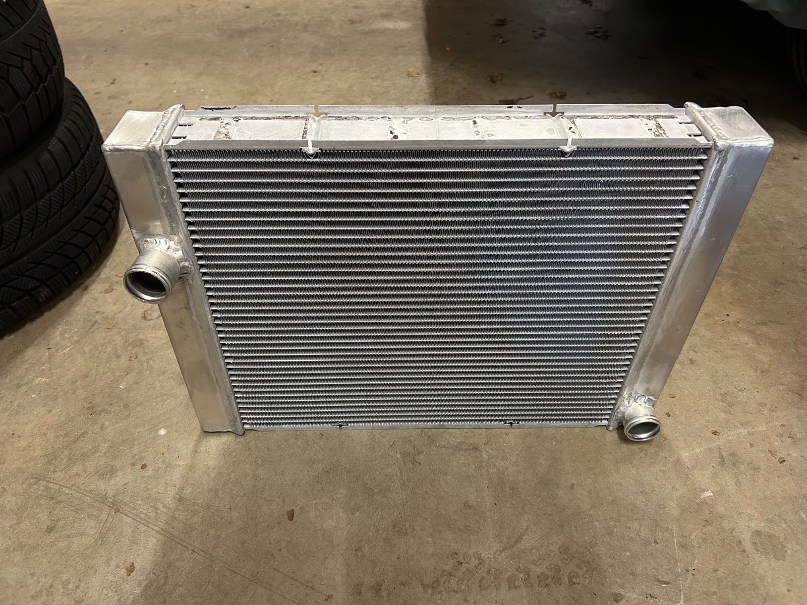

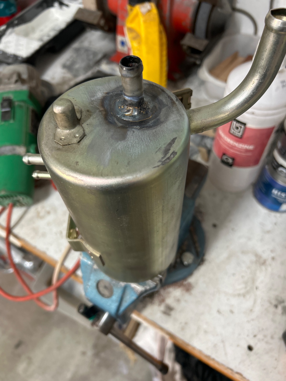

Picked up my adjusted cooling tank, it now has two small return pipes as the s38 requires.
Also the custom made radiator is in, for those who want to know what dimensions I used, see the attached picture.

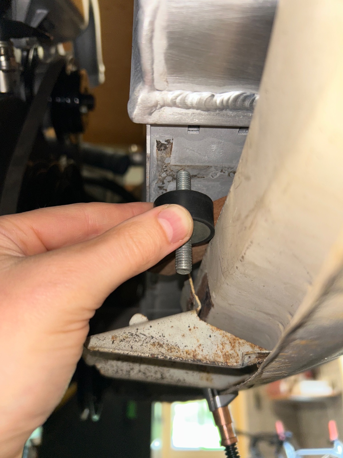

Not sure yet how to attach the radiator to the chassis, underside with rubber bushings in combination with adjustment of the original brackets and on the top side I think I will make it from within the noose so that it is not so visible. Need to weld something to the radiator for that still and it will be painted black in the end.
