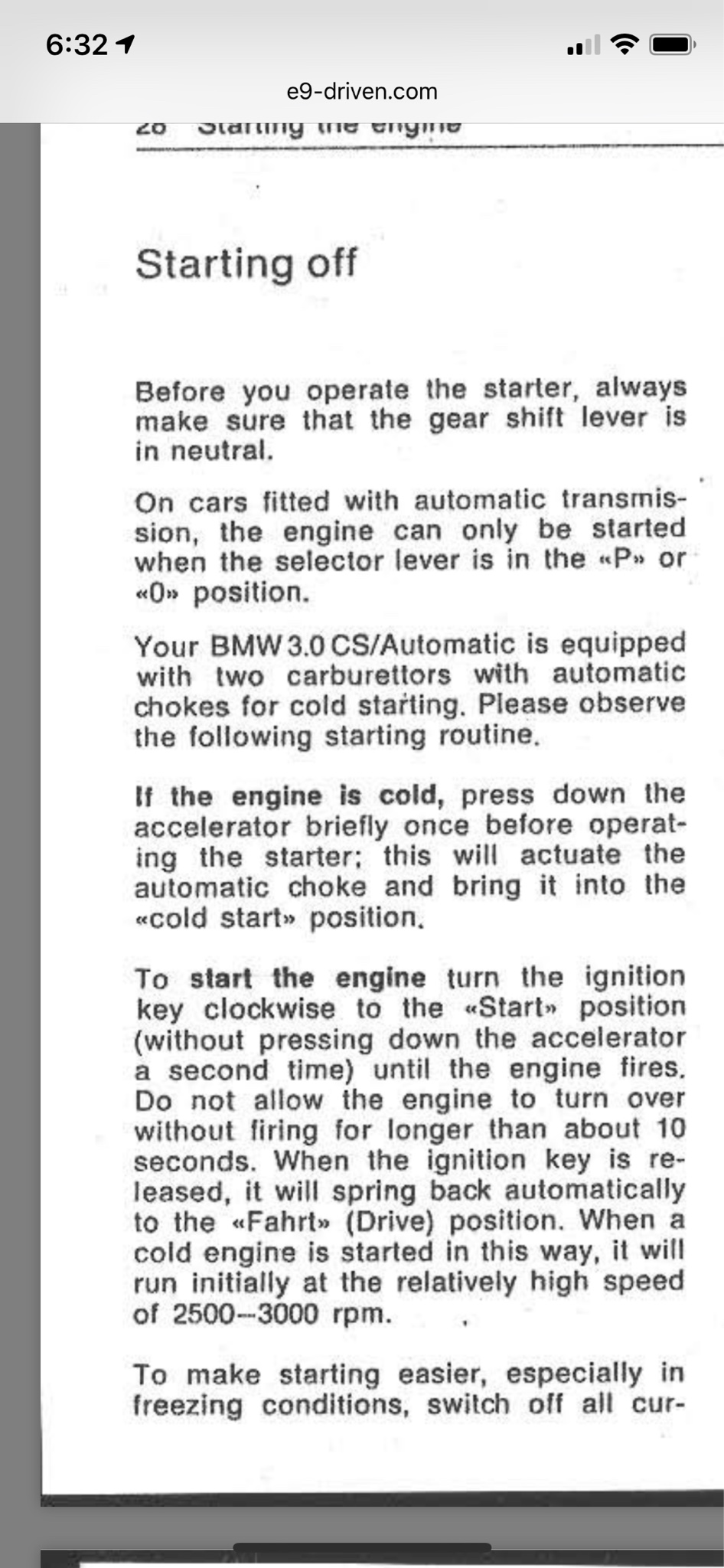

What is the correct way to start the car? I have heard mixed responses on this. If you read the e9 owners manual it says to press the throttle briefly once and then turn the key. I have heard others say floor the throttle once and then turn the key. I have heard briefly press the throttle once and turn, if doesn’t start then floor throttle once and then.
There are so many different responses. I like to go my the owners manual but let’s say the car has been sitting for 6 weeks and we use the owners manual method and briefly press throttle once and turn key. If it doesn’t start then what? I had this issue recently, so it didn’t start first turn, so I cranked it long another 4 times and didn’t start.
What is the correct method assuming your car is set up perfectly?

Thanks for the response. My only concern is that the process you describe is not what the manual recommends. If the car was perfect I would expect the description in the manual to be the correct process.

yes, valid for the next day cold start
but we were mentioning 6 weeks after last start

to me if the starting is after less than one week, i would only do the choke engagement, so 1 slight touch + 2 crank (@Boobouna , just what the manual says)
if it is more than one week, then 1 slight touch + 2 floor the pedal once + 3 crank
