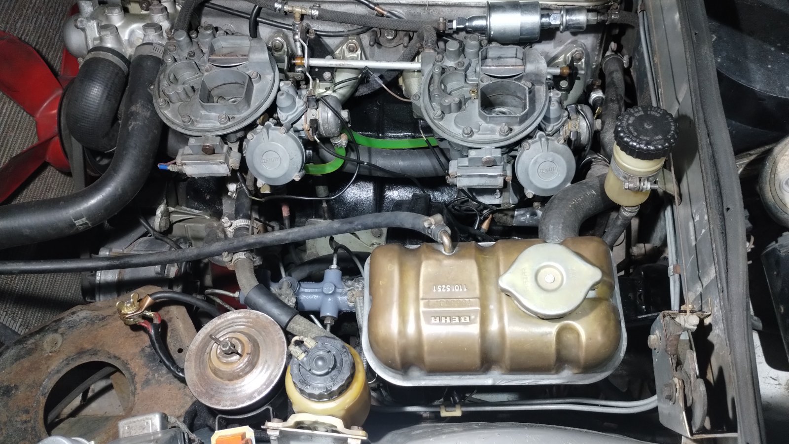

Update #8
- Getting ready for the first road trip: water circuit
Once we got it moving on its own, I was already dreaming of taking it out for a spin, but there were still several things to check on the car before I could do so.
One of these essential things was connecting everything related to the water circuit, which, to no one's surprise, didn't have a single hose in place and several connections were disabled.
Luckily, by reading various threads and looking at photos, I'm starting to understand the logic of the connections and how everything works together.
Once I had the entire circuit clear, I checked all the hoses I had from the car to identify any missing ones. Luckily, only the ones that connect the carburetor glow plugs and the one that goes from the coolant reservoir to the base of the rear carburetor were missing. Since the latter required some special bends, I reached for my stash of E23 parts to find one that would fit, and with a few adjustments, I found one that's a perfect fit. As I continued, I also noticed I didn't have the hose that runs from the thermostat housing to the bottom of the radiator. Looking through my things, I found that E23 hose, but unfortunately, the radiator had a different inlet, so it wouldn't work. I ended up improvising some hoses along with a galvanized metal pipe for the straight section. For the heater hoses, I got some clear ones. At first, I wasn't keen on the idea, but then I thought, "It could be really cool to see the coolant flowing through them, plus I can see any bubbles that get trapped."
Now, with all the parts in hand, it was time to start assembling. I began at the back with the heater hoses. I discovered that the fitting coming from the cylinder head and going to the heater core inlet was badly corroded at the end, but luckily I was able to push the hose in far enough so it wouldn't leak. The outlet fitting successfully into the base of the rear carburetor.
Heater hoses: successfully connected.
I continued with the awkward carburetor choke hoses. Several fittings were deteriorated, not to mention the awkward connection coming out of the block above the starter. With great care and patience, I was able to work on them one by one. From the block to the rear carburetor -> from the rear carburetor to the front carburetor -> from the front carburetor to the base of the front carburetor.
Automatic choke hoses: successfully connected.
We continue with the thermostat housing. Here, I also adapted the hose coming from the carburetor base to the thermostat housing. Luckily, I found one with the perfect curve. I continued with the hose going to the water pump and finally to the radiator. All easy up to this point.
The hose coming from the thermostat and going to the lower part of the radiator was more of a challenge until I could connect it. I also had to find the right angle because it passed very close to the fan blade (which, by the way, doesn't have a clutch; it's fixed to the water pump pulley, which makes it even closer to this hose). Now, everything's done up to this point.
Radiator hoses and thermostat housing: successfully connected.
Now, all that was left was the reservoir hose, which I realized had a rather unusual curve. I had to combine two hoses, and I was able to replicate it quite well.
Water reservoir hose: successfully connected.

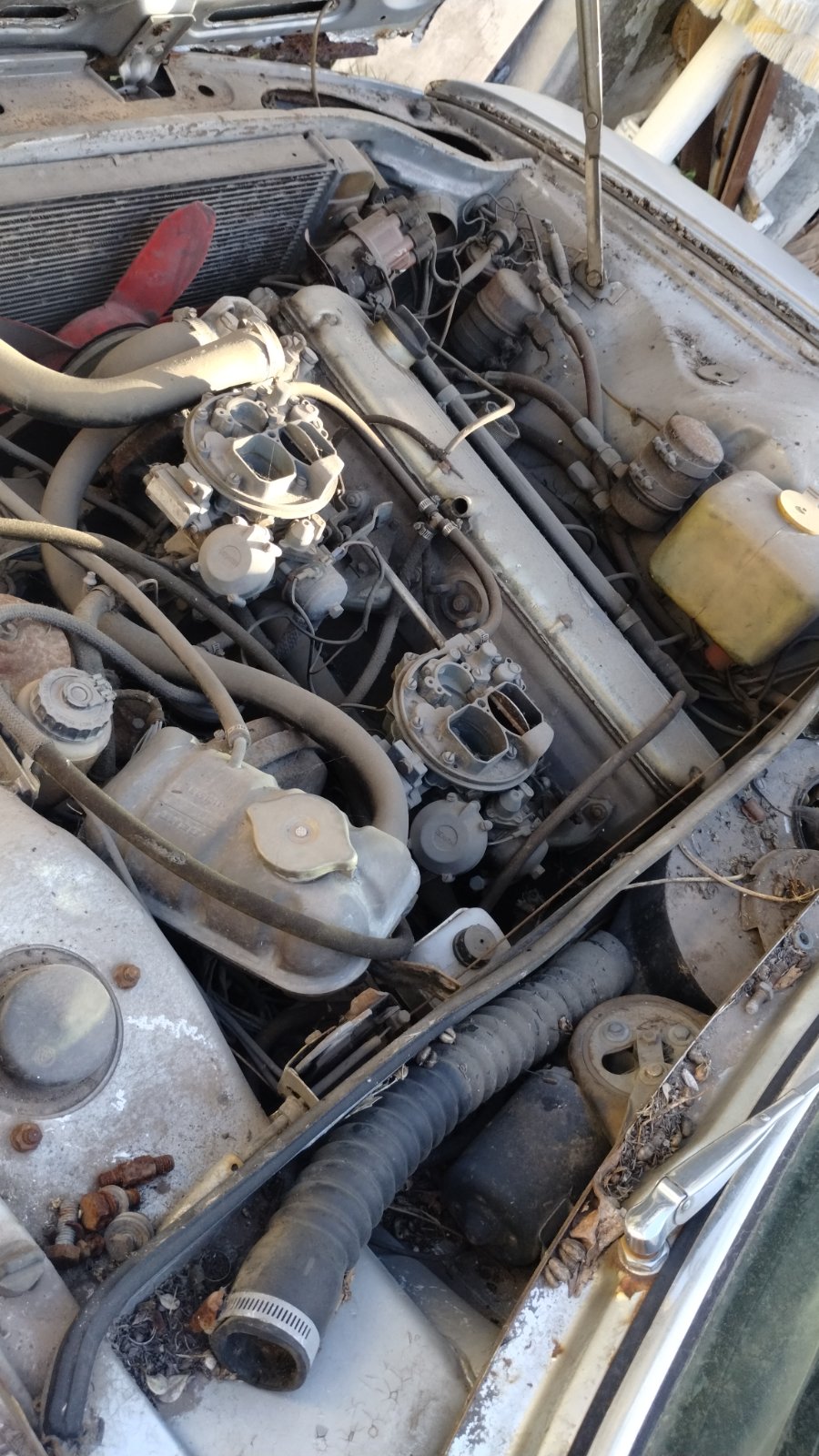

Now for the moment of truth: starting to add coolant and fix the leaks. It was literally the most stressful time I'd ever experienced with the car up to that point; literally every hose was leaking. Some were leaking from loose clamps, some from worn clamps, others from damaged fittings, and still others from the intake manifold mounting bolts. It was a two-day job and several liters of wasted coolant, but after a lot of patience, some repairs (and a bit of sealant on some fittings), we were finally able to get the system leak-free!
Unfortunately, I don't have many photos of this process, just a before and after.
Without realizing it, while reassembling the water circuit, I saw the E3 engine completely assembled for the first time. It had several adapted parts, of course, but it was complete at last. I can only say, what a beautiful engine the M30 is.
