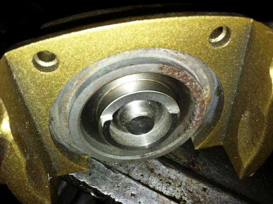

A word about painting and coating calipers; here’s a caliper (the gold one in the thumbnails below) from a popular retailer that offers “Polymer Coatings”. Everything looks fancy on the outside and the marketing hyperbole runs thick on their site but, it’s the inside that counts when it comes to calipers. Thick coatings can encapsulate heat and the raw, untreated steel in the bore has already began to rust. This caliper pictured below is from another customer who decided not to use these calipers on his car. Wise decision as you can tell.
We were fortunate enough to grab a batch of core calipers from a shops inventory. They were calling it quits and selling their remaining inventory. The little gem we found should spell it out for you. Look at the pictures below. From left to right; the first caliper is a re-plated caliper, you can see the bore and all received plating and this one is ready for final assembly. The second caliper is a big-box vibratory polished and oiled caliper. The third caliper is the same type caliper from the same big-box rebuilder after some time exposed to the elements. The last caliper was never even installed. It was found in the big-box rebuilder shipping container with a tag on it. No zinc coating = rust and a ruined caliper.
A final word on plating to sum things up; It should be obvious now, you will want to have your calipers plated. Remember, zinc is a sacrificial coating that has protected your cast steel calipers for this long. It will do a great job of protecting them for another fifty years. Even if you want to paint your calipers red in honor of the real big red caliper used, plate them first and then rattle can to your hearts delight. You wouldn't put a rusty crank back in your $15,000 engine rebuild. Hit Google and find a competent metal finisher in your area.
If the car is driven regularly and hard, the brakes can get hot enough to get rid of some of that moisture but, over time, your fluid will be bad and will not work as well as it once did. This is why you should change your fluid annually “especially” if you only drive it in the summer months. Sitting for an extended period of time will cause the rust and fluid shellac buildup to begin.
One other cause for rust inside the caliper is “damaged dust seals”. These are the seals that snap on top of the pistons. As you can see in the example on the left and in the middle below, all of the rust on these pistons is also “above” where the bore seal would contact the caliper. Because the dust seals were damaged (cheap aftermarket seals do not have enough anti-ozonates and they crack and crumble) water came in from the top as well. See the rust on the dust boot flange?

Before you take your calipers off the car we’ll want to know a few things about the pistons. Has the car been sitting for a long period of time or, is it your daily driver? This will help determine the condition of the calipers and pistons. If it’s been sitting, chances are the pistons are stuck or binding. If this is the case, you probably will not be able to free them up using the simple “compressed air method” (more on that as we progress). If it’s been your daily driver and you’ve changed the fluid annually then chances are compressed air should work. We've torn apart thousands of calipers and this is almost always the case.
If the car has been sitting, now is the time to get the pistons moving. By leaving the caliper attached to a fluid system (your brake system) you should be able to free up the pistons. Fluid does not compress and air does. This is why the compressed air method won’t work on a stuck piston. Use a buddy and press the pedal until you hear the cracking and creaking of the pistons moving. Remove the pads so they will have some room to travel. Place an old brake pad backing plate or a ¼” of plywood in the bore so the piston won’t come completely out. Bottom line, we need to get the pistons moving using fluid. If they are totally frozen there are a few things we can do on the bench or, you may want to consider professional help at this point. Calipers that have been sitting in adverse climates for too long can be damaged beyond repair. The pistons have been known to completely rust/bond to the dust boot flange causing a failure (see picture below). When this happens, the caliper is a good door-stop. The good news is, most of these steel calipers can be found as cores rather inexpensively.
If the car is a daily or occasional driver and you’re certain the pistons are working, take a few stabs at the pedal to make sure everything is freed up and remove the calipers from the car. These should be good candidates for a compressed air removal.
