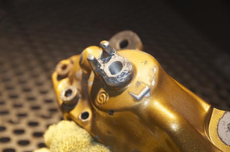

Bob, with those Brembos, I would glass bead blast the bodies and then re-anodize vs. alodine. Anodizing is a "much" stronger finish and it will last much longer. Alodine is fairly benign and won't offer much protection in the long run.
It's hard to tell from the description but, I think I might leave them as is and reanodize and repaint. If there's enough of the 10x1 thread to hold the fluid line, you may be better than trying to weld etc. It depends on the caliper as well. Some of these Brembos we call "throwaway calipers". Brembo is asking $18.50 for a rubber bore seal (yes, that would be one). Then there's $36 for a wiper seal. Now add it all up and times that by four. Now times that by two and, then by two again if you want to do the rears. Wait! They kind of insist that you buy a bottle of "seal conditioner" if you want to buy their seals. Ummm Okay...
Add to that odd pad plates that have small M4 hex head M6 fasteners that have been loctited into place. These steel fasteners in the aluminum bodies with the smaller hex head are almost always a disaster. Strip a head and you won't be able to get the calipers apart. Then you'll have to grind the head and send them off to Jim for EDM. This is why the other companies simply spray them with paint and put Centrix seals in them. Then the pads don't fit right. And... The aluminum can corrode under those plates making them impossible to get pads out... Heard enough? These can be very difficult and expensive calipers to fix properly. Especially if they're corroded.

Sorry for the thread drift fellow E9'ers, but I wanted to post a photo of my Brembo issue for
Our generous PMB expert to scrutinize
This is the worst one by far. I don't have access to any type of anodizing and was thinking I would clean it up till I have solid metal and give it a coat of G20 Epoxy caliper paint. Every year or so I could take it apart to clean it out and see how it is holding up. This Gold finish is ultra tough where it is still intact. I thought I would clean this well, scuff the finish and recoat with Silver Epoxy paint. I really don't want to be driving around with Gold calipers or Brembo logos, as Turbo Subarus are about the most stolen car in Toronto and I have been struck twice with daly driver project cars.

1. Like the broken bleeder analogy, decide at what point it might be better to get a core caliper.
2. I'd be inclined to leave that, re-anodize and be on the hunt for a good caliper.
