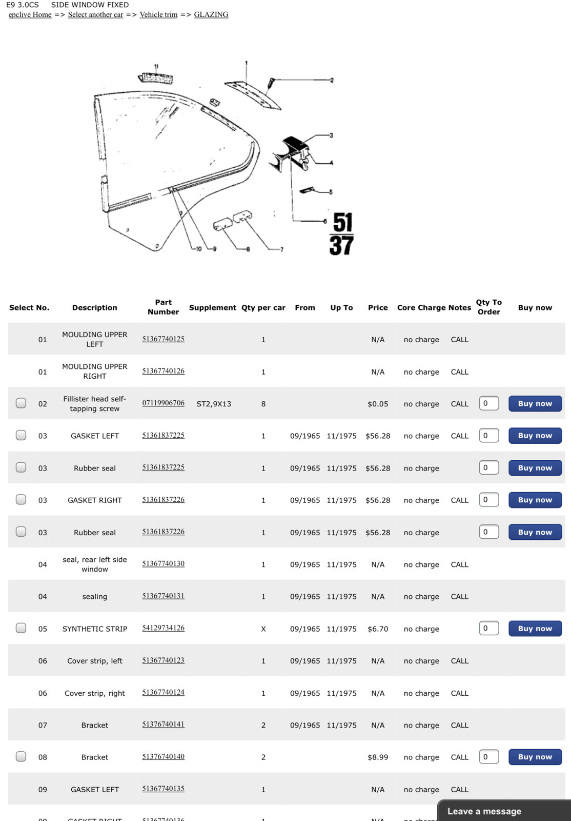

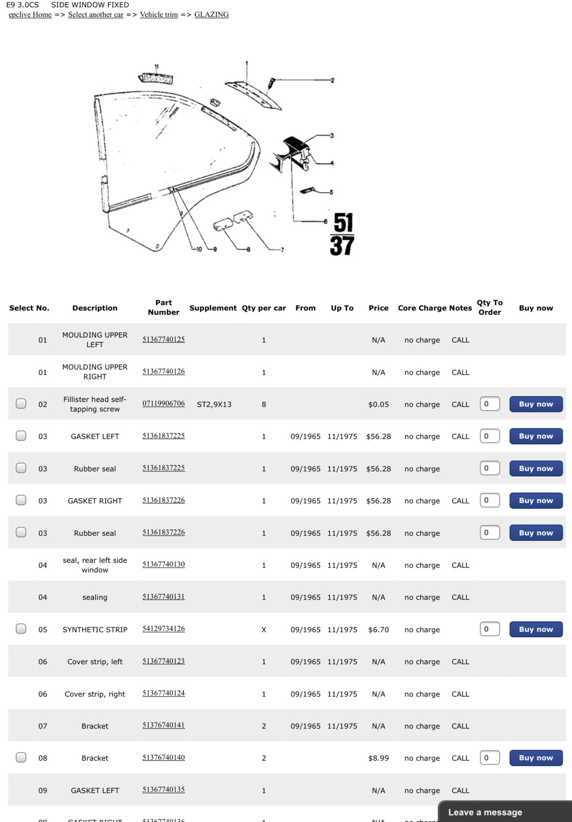

    Thanks Bert, don't know how that got by me, which part #9 or #10? Kind of hard to tell from that drawing, or is your answer in your post....#9?
