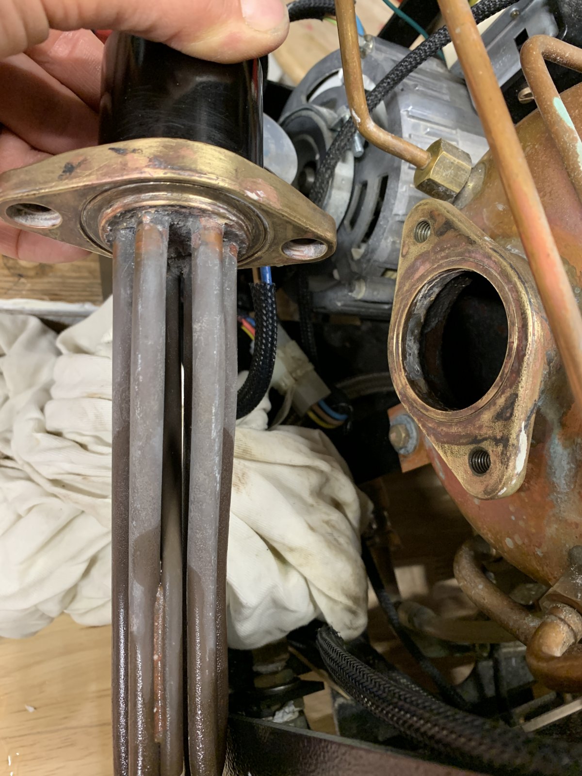

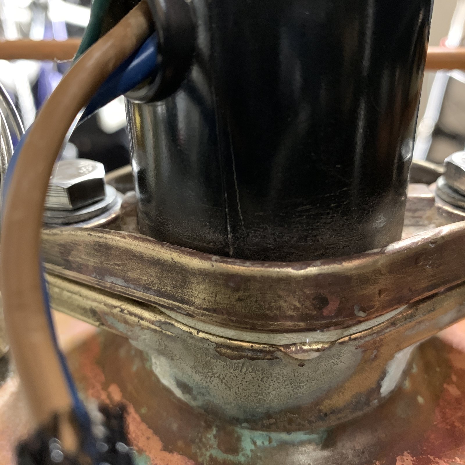

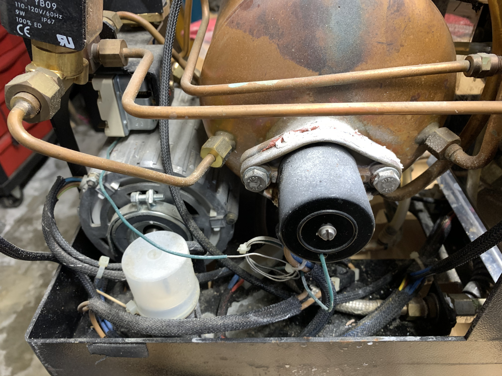

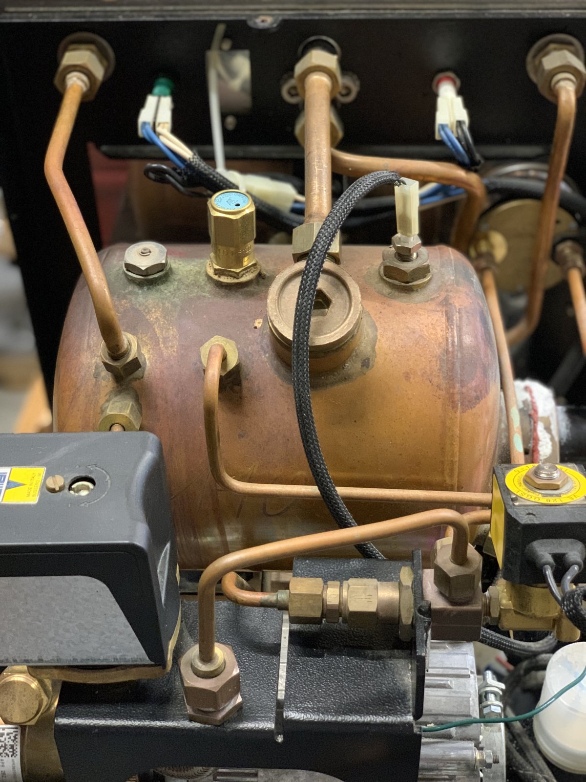

My Elektra started leaking from the heater/boiler last summer. The replacement gasket wasn't sufficient as the soft brass bolting faces were not flat. After attempts with different gaskets I applied a hi-temp, food grade sealer to fill the cracks that wouldn't seal. 5 months later and it still works well. There is nothing like home made cappuccino in the morning. Cheers!

Thank you for the post deQuincey! That was amazing. You have a talent for sure and a lot of patience.
that is very nice, that elektra is really a tight design, everything is packed there, is the big alternator kind of thing a water pump ?
you solved very well the issue; i am now in a similar animal, and i found a very similar leak, the PO said it was in the main boiler gasket, but no, it was the heater element gasket, just like yours, i will have to work on it, but we will see

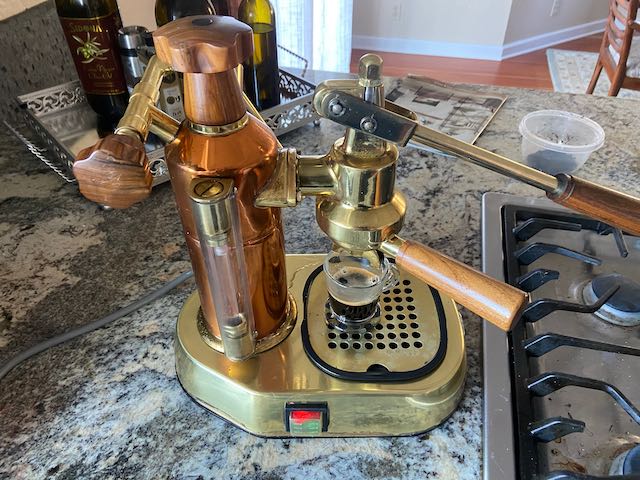

Well DQ's initial La Pavoni post has just culminated in a transcontinental project. DQ found and sorted a Europiccola in Bilbao from 1994 or so, and all I had to do was unpack, replace the heater element with a 120V skew, check my work and pull the first espresso. The result was fantastic, I used my usual Peerless Espresso Maranello beans and it is a completely different taste now, one that lingers in your mouth for hours. I nominate DQ to the status of "the Don Lawrence of La Pavoni machines".
Five pictures from unpacking through first use...
