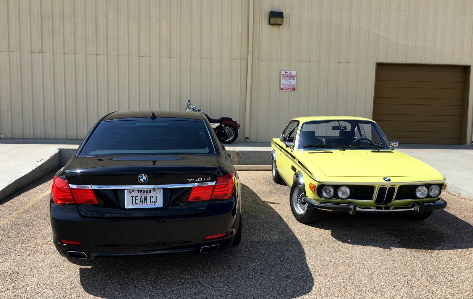

Couldn't help noticing how diminutive and lithe the CSL looked parked next to my 7 series. Still makes me chuckle that we used to call the E9s 'big coupes' :D
That picture is why I haven't bought a new BMW in 12 years and have no plan too (however I'm hearing good things about the new M2)
So hard for me to believe the company's cars that I fell so in love with in the 70's became what they are today ...
Ford makes Lincolns ... BMW should NEVER !!!
Be Safe All, Jimmy

Couldn't help noticing how diminutive and lithe the CSL looked parked next to my 7 series. Still makes me chuckle that we used to call the E9s 'big coupes' :D=QUOTE]
When I got my coupe I checked the dimensions against my e92 335i. The coupe was five inches longer, but five inches narrower, two inches shorter, and 200 lbs lighter than a 3-series!
