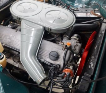

D-jetronic injection unit for 3.0 CSI

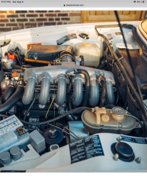

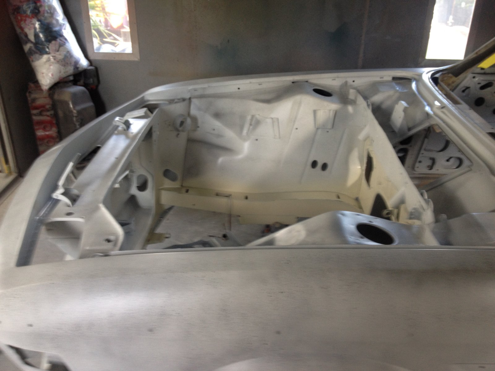

Well- give us a flash pic in focus of that area and a pic of the passenger inner fender!
I'd love to but that's the best pic I have and we're locked down here and I can't get to the car for probably another 6 weeks or so...
Also, it's RHD - so will that change the location of the 'passenger fender'?

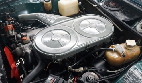

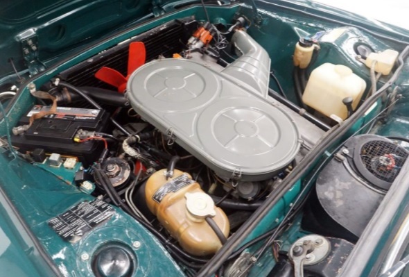

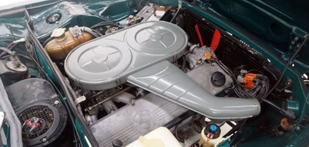

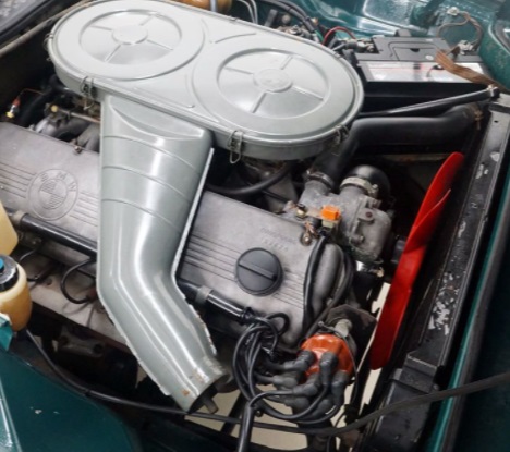

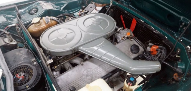

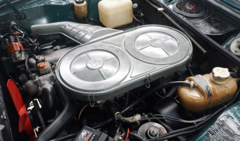

Ok, do any of these help?

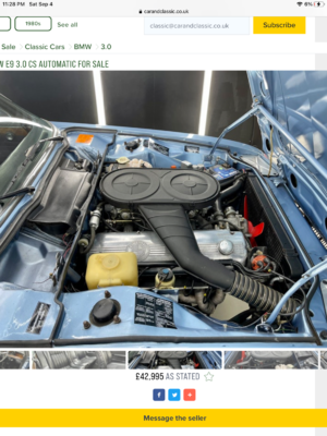

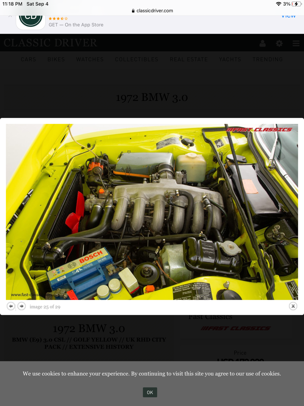

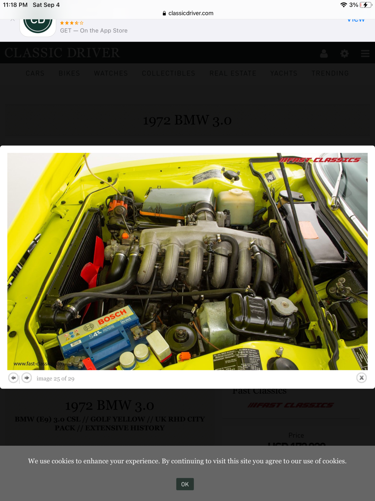

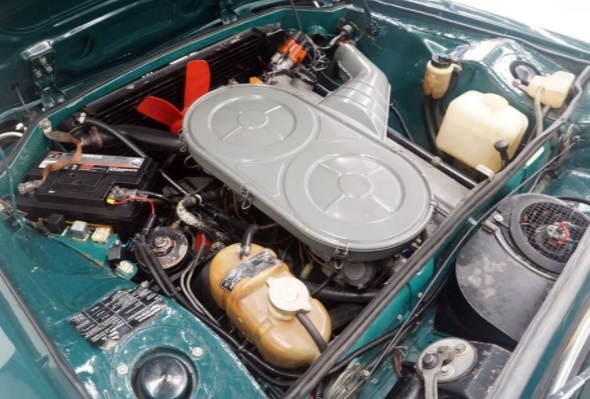

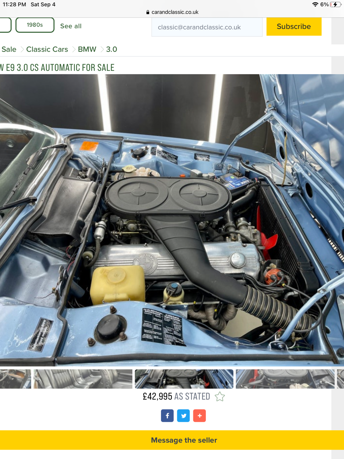

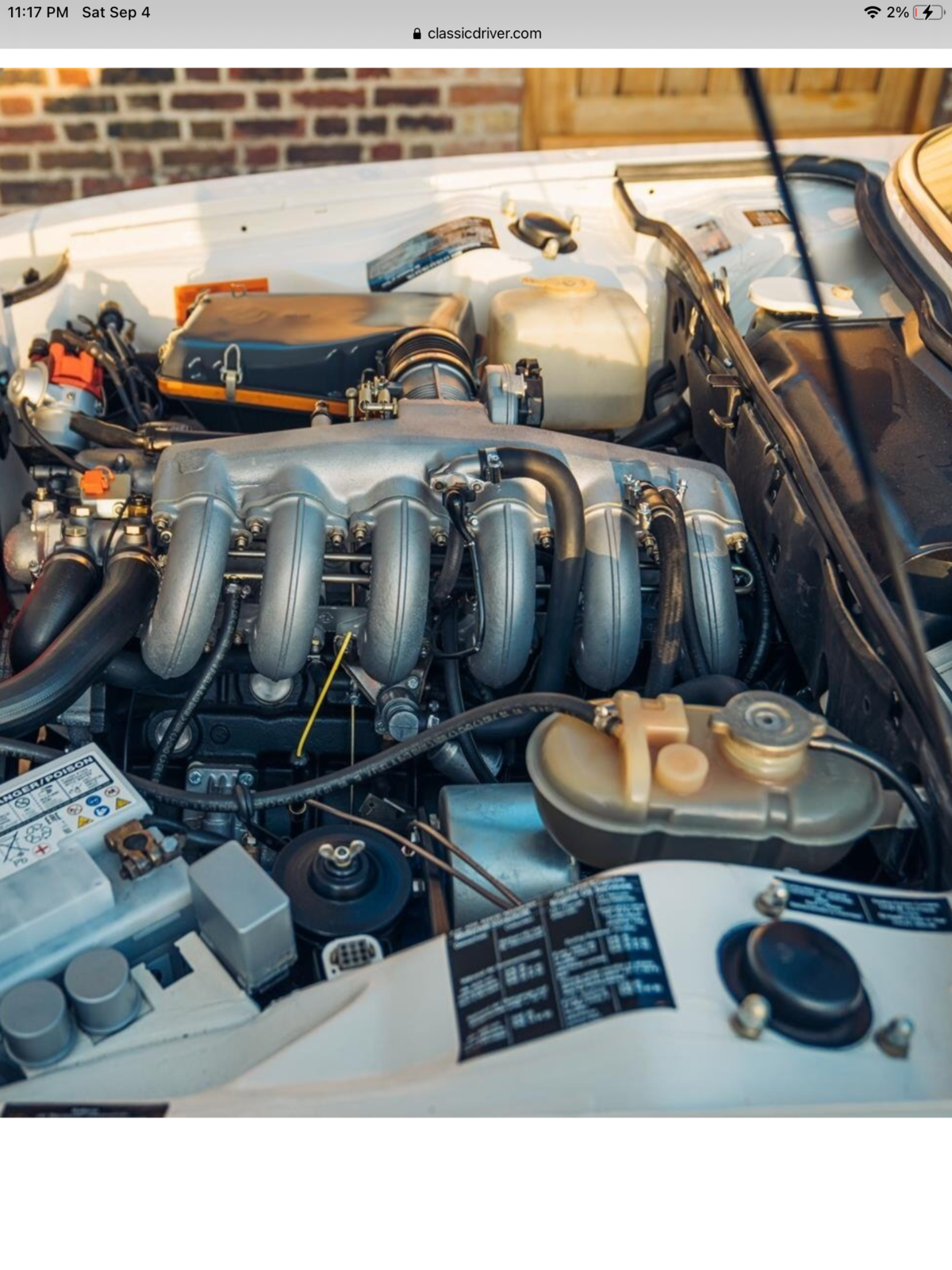

Lots of pics out there for csi and Csl RHD
RHD carb car

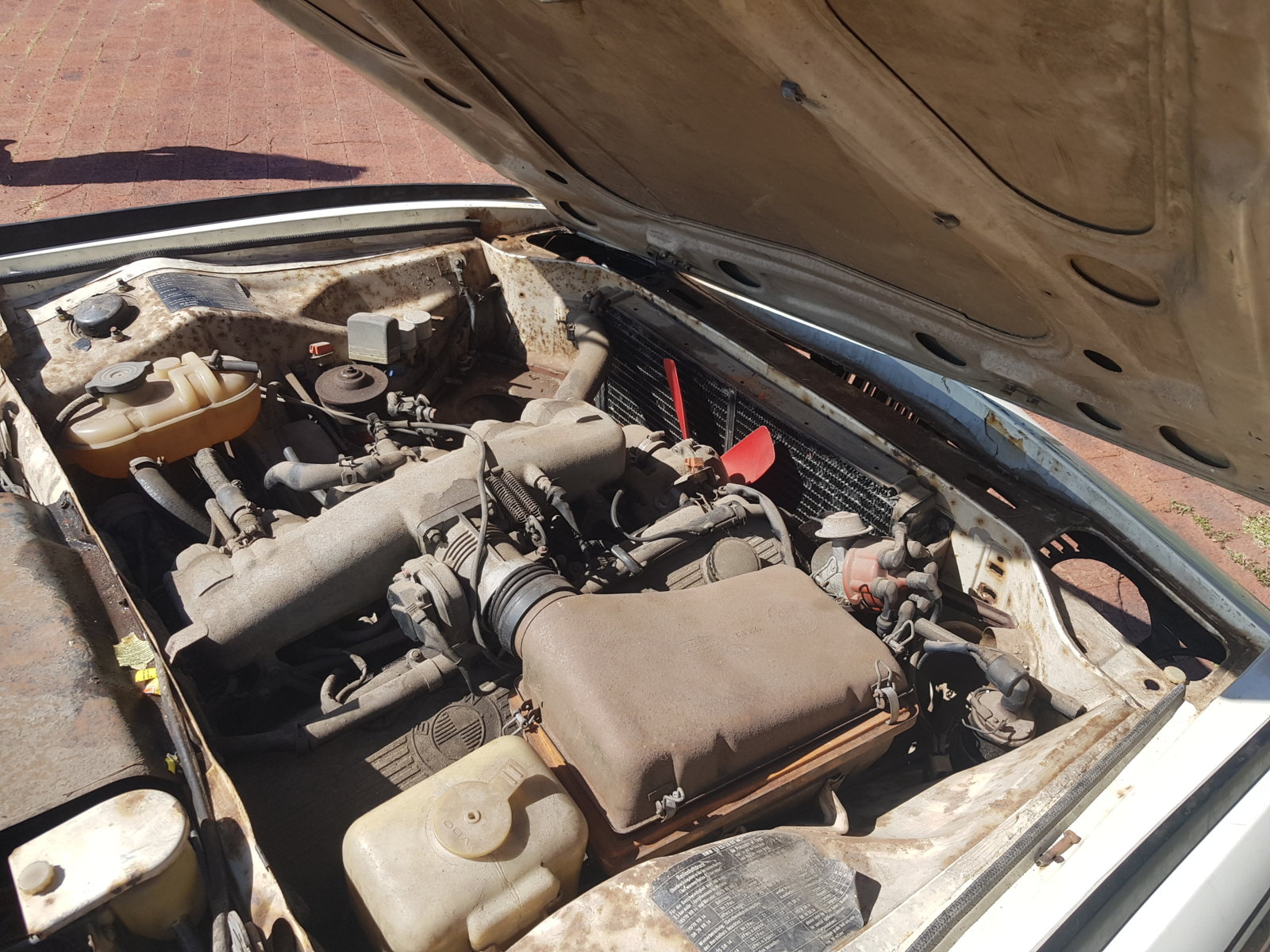

Well only because I like @sfdon and Kiwi's are kind of like Tasmanian's but sound more strange..

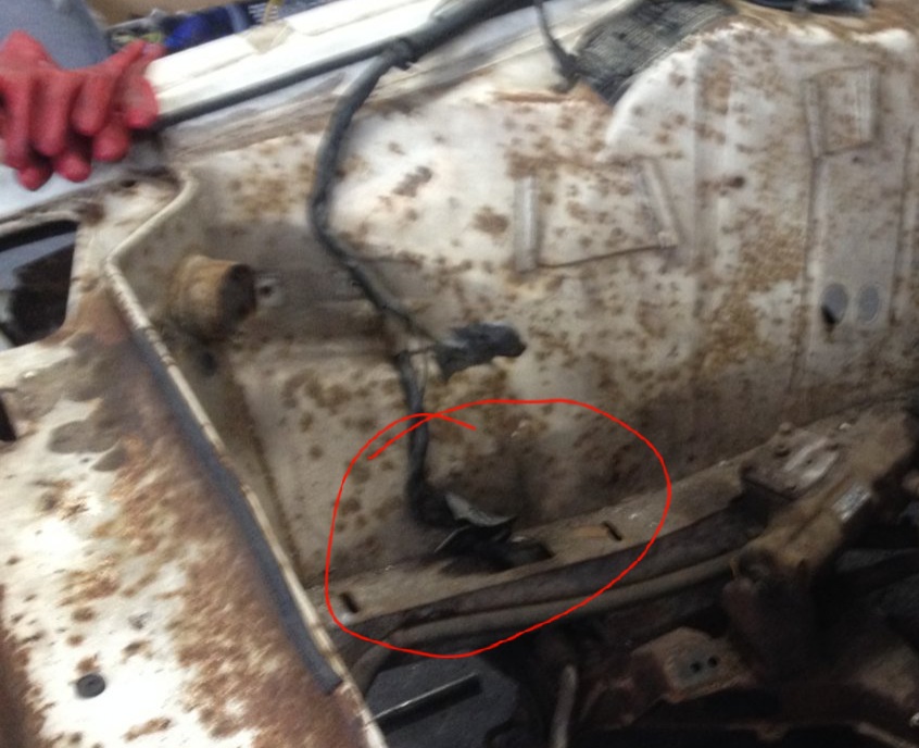

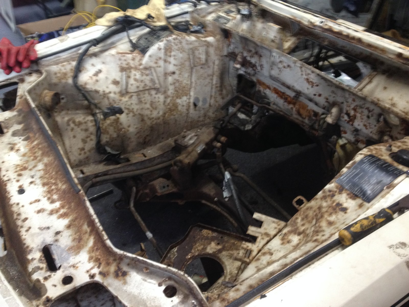

Here is the engine bay of my CSL (RHD) as I found it. You can just see the air box mount sticking out from the inner fender in the middle bottom of the pic.
Here's another shocker of the CSL - sorry it's out of focus. You can see the EFI harness coming out of the chassis rail. If your was was a CS you don't have the middle slot. You can also see the airbox bracket.
This is a better shot of the slot and bracket.
if your car is matching number and confirmed as a csi , it's definitely worth the spend to reinstall a D-Jet system , particularly as genuine rhd csi's are thin on the ground and very desirable ( at least here in OZ )
That pic above is your map. Just so it's crystal clear, what you are looking for is the hole in the frame rail where the injection harness runs into towards the ecu, below the rear passenger seat(LHD). I've circled what you are looking for...
