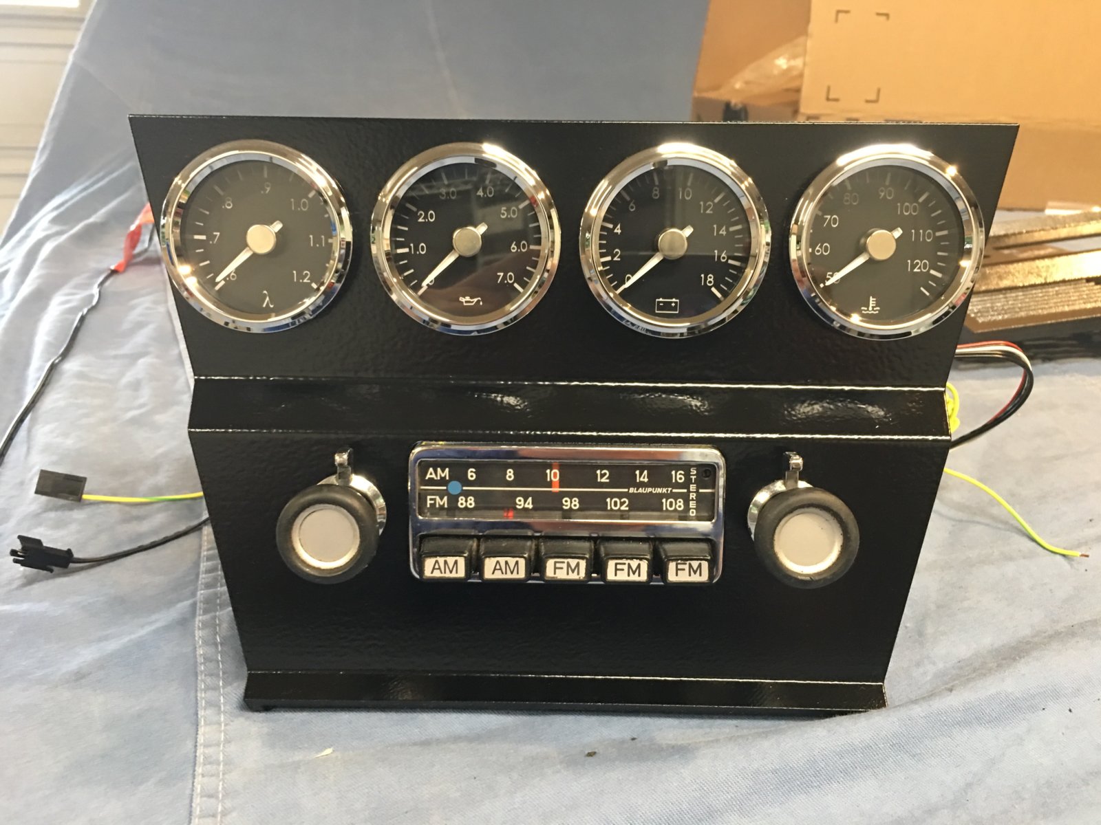

This is my over-the-top setup. Like everything of mine, they are just parts in a bin at the moment. There is something about four gauges that looks less appealing than three. As mentioned I like data, and I’m keeping my original non-AC console and wood tray.
I’m using AC console sides, as the gauge plate is based off of an AC face plate. The AC console puts your gauges at about a 45 degree viewing angle. I’m currently in the process of filling the AC vent holes on the side and having it professionally recovered.

I thought about doing that but those slats are fragile and to me doesn't look right with the gauges, also with all my period mods I want the option of going back to original unmolested.

I have to agree with the "do the grille or do the gauges", but not both.
And, yes you are right Markos, design class 101...odd numbers always look better than even ones.

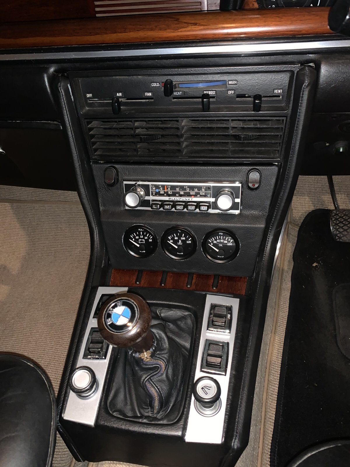

Here's my simple Alpina style, I like the stock speaker grill or gauge cluster in this spot, seems to break up the otherwise large swath of wood IMHO. Whichever way you choose to go, I am in favor of the extra gauges, the volt meter has already saved my a$$ and I am hoping the oil pressure gauge will warn me of impending grenading of engine before the idiot light indicates it already has.

For oil pressure, VDO makes a sender that installs in place of the stock BMW sender that has a terminal for the gauge and a terminal to keep the idiot light.
For oil temp, I used a stock VDO temp sender, installed into the flat boss on the side of oil filter housing. In order to do the install, I had to drill and tap a hole for the sender.
